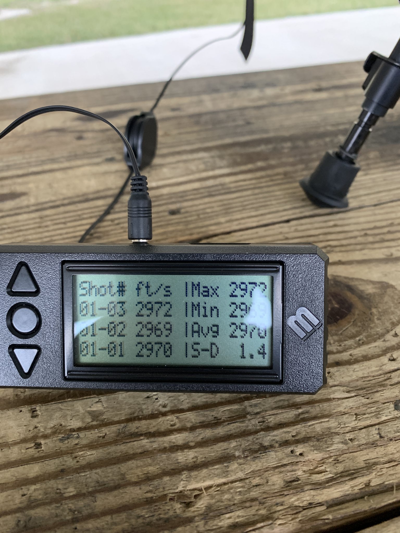

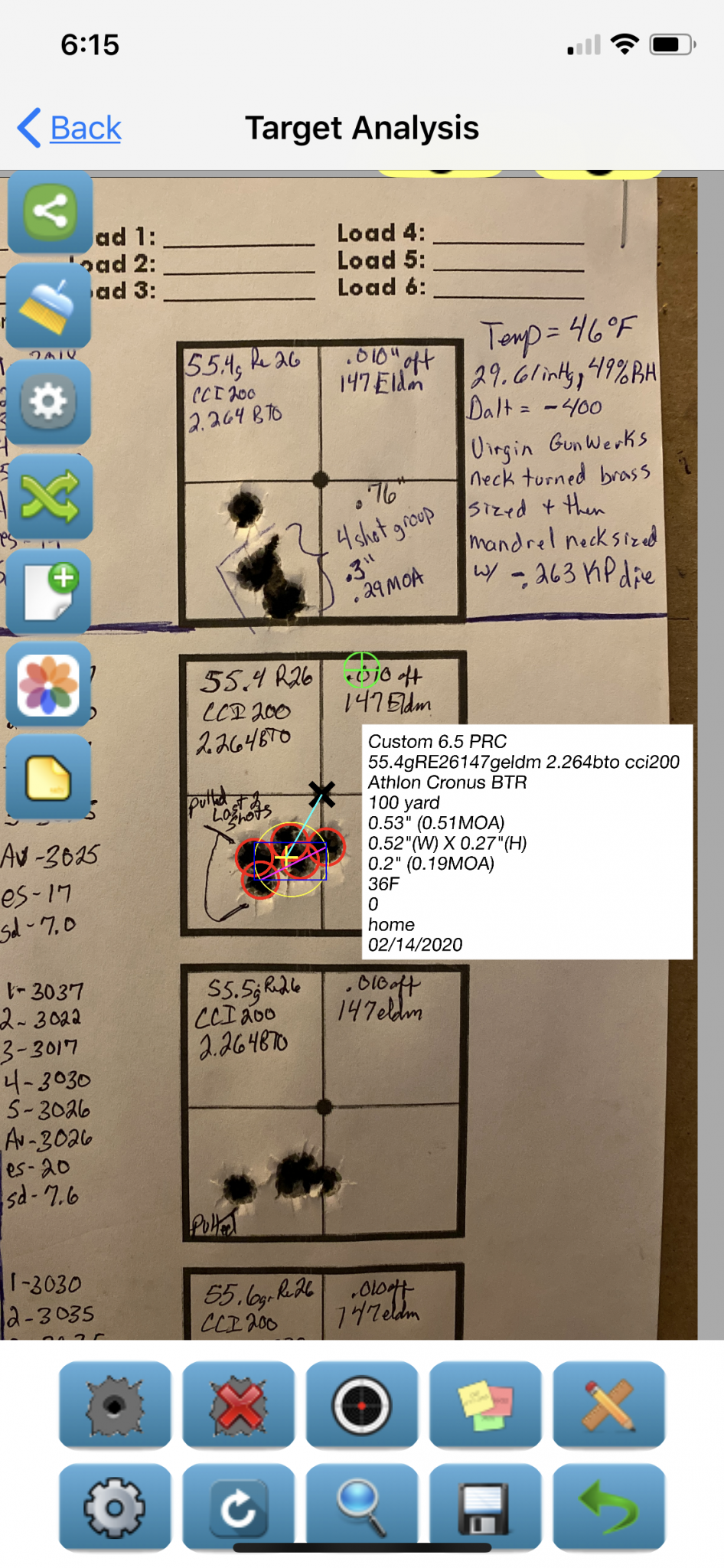

Shot some loads to see if I can find pressure and see what velocity I can get today with Rel26 and IMR8133 all at a CBTO of 2.264 which is .010” off. Rel26 seemed the best between 55.3 at 2990-55.6 at 3016 with virgin Gunwerks brass and cci200 LR primers using a MS V3.
Quick Load predictions using ADG’s average H2O weight of 66.9gr yielded a 2950 for 55.3 and 2965 for 55.6. At 56g of reloader 26 I got 3022, but to be nice to the barrel I’m going to stay around 3000fps, so I didn’t need to shoot the 56.5g re26, I did not see any pressure signs of any sort.
It shot the 55.3, 55.6, 55.9 into a 1.44” group at 300. Probably be playing with 55.3-55.6gr loads at differing cbto’s.

Heres the first outing on seating depth test on a powder charge that I thought would be close to my goals for velocity.
Not sure but for now I’m going to try the 2.264” cbto 55.4gr load(top right) again to see if that flyer wasn’t a fluke and then 55.5 and 55.6 at 2.264” cbto to see if I can shrink the group maybe, idk. If that don’t pan out I may retry the 2.224” cbto and 2.234” cbto(top two on the left) with a tenth or two more of a grain on those and see what that gets me. Idk hopefully I can find something without using up too much of the pixie dust powder!

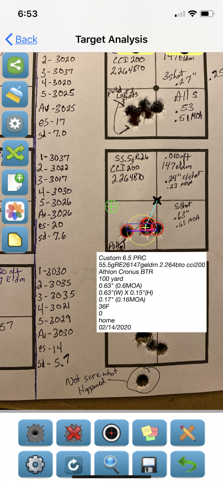

Welp today was great after work, went out to confirm a load and to possibly better it.....not only did I confirm the load from before but a tenth of powder more didn’t seem to faze it....
On this one I know I pulled the last two, but it is what it is.
Pulled the last one here too, just couldn’t catch a break, might have been too excited about how I was able to find a load in under 50rnds that checked out, around a half inch or less, good es and sd numbers!!!!! Ready to test out at 600 then a grand and then maybe 1760yrds???!!!

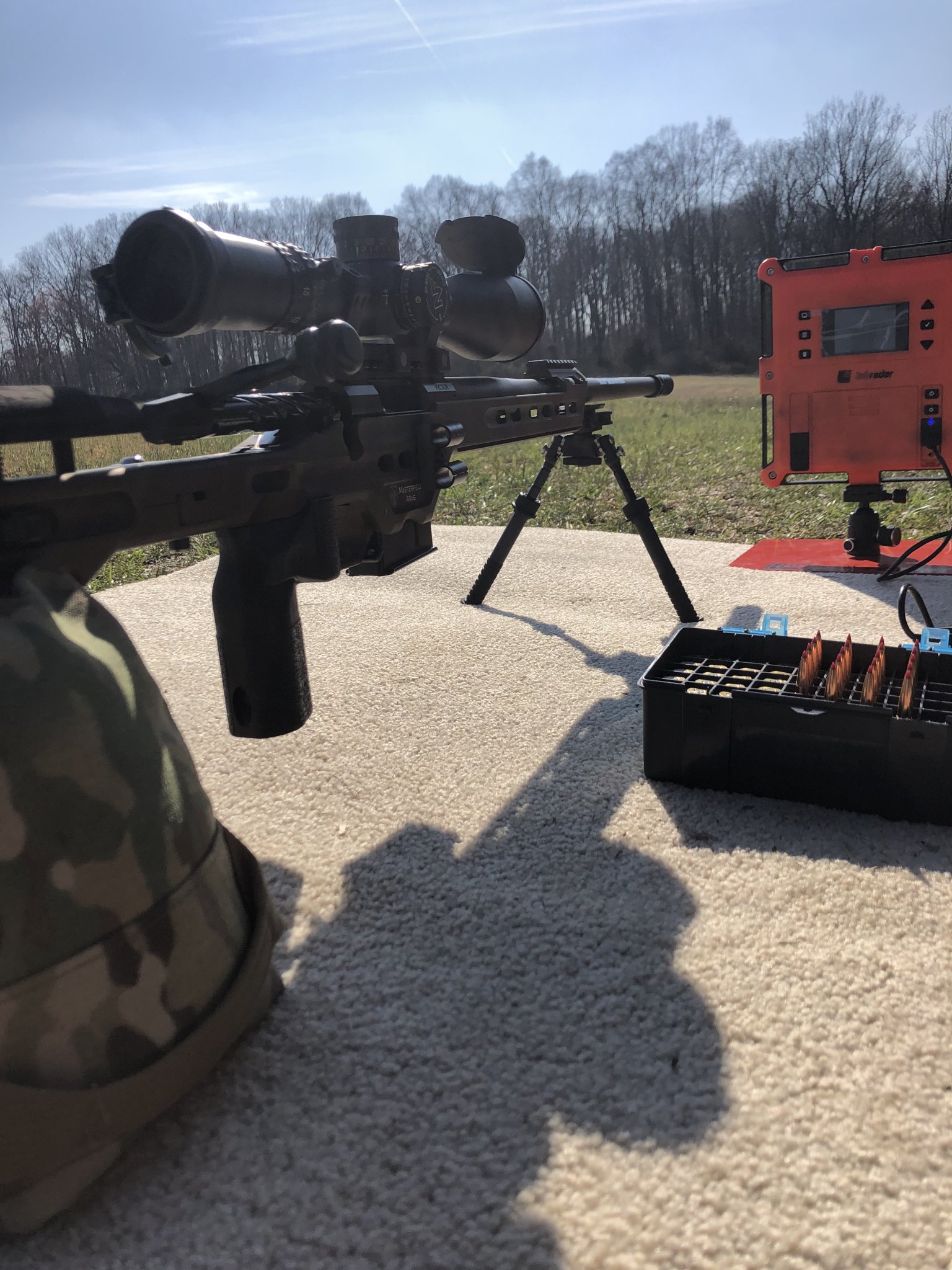

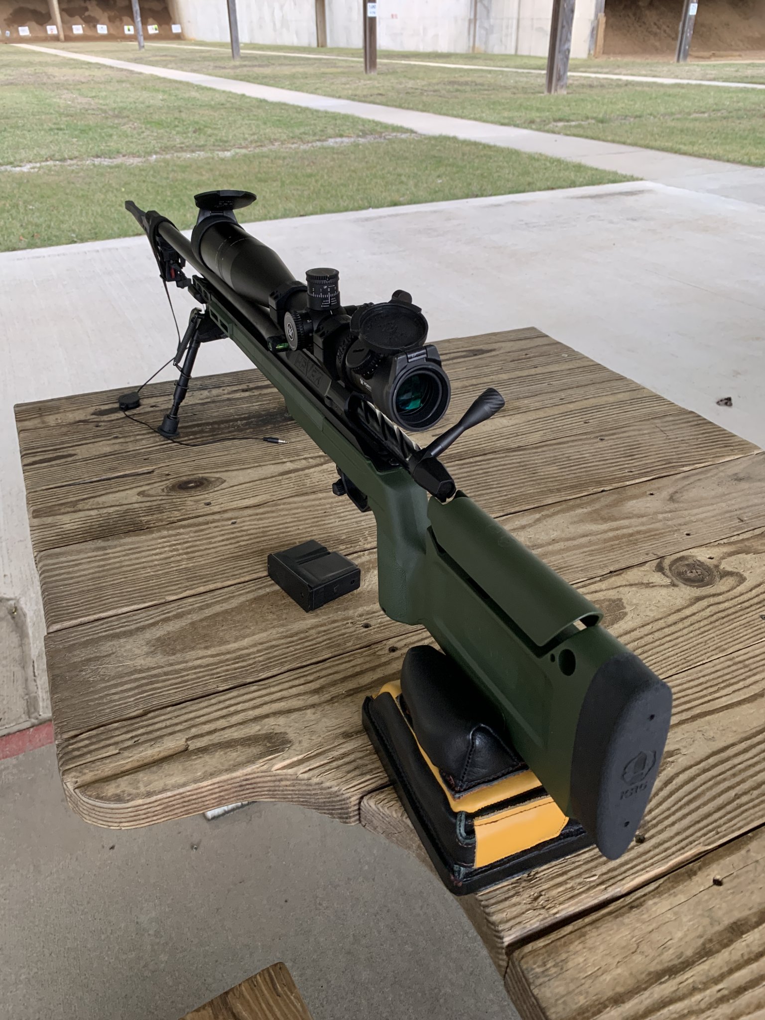

6.5PRC, WTO switch barrel Bighorn Origin, 26” Krieger LT Palma 1-7 4 groove, Athlon Cronus BTR, Nightforce rings, KRG Bravo.
42*F, 29.76 inHg, 54%RH, -908 Dalt, environment taken with kestrel 5700 ballistic/link model.
55.4gr RE26, Gunwerks neck turned virgin brass, CCI200, 147 eldm at 3023fps avg. logged for shots. I have velocities for these four but not here at this time. 650yrds taken with sig 2000, 3.4mil of elevation and .2mil left.

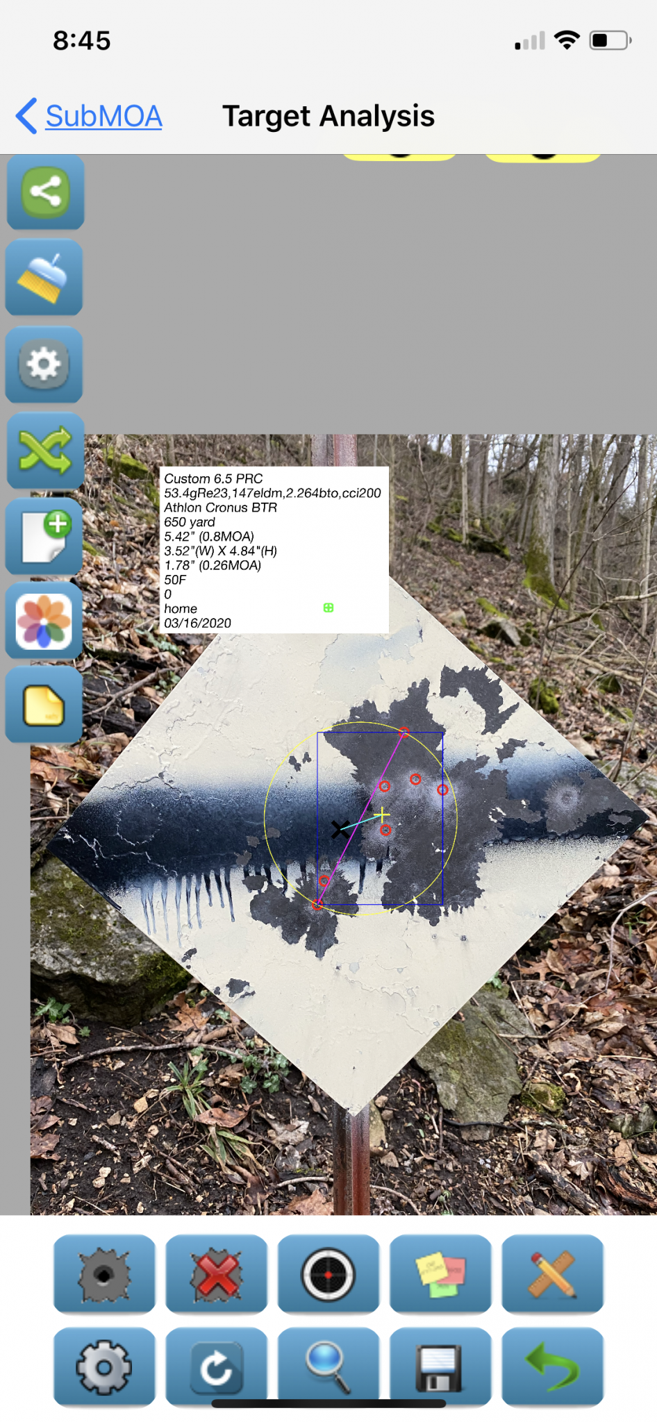

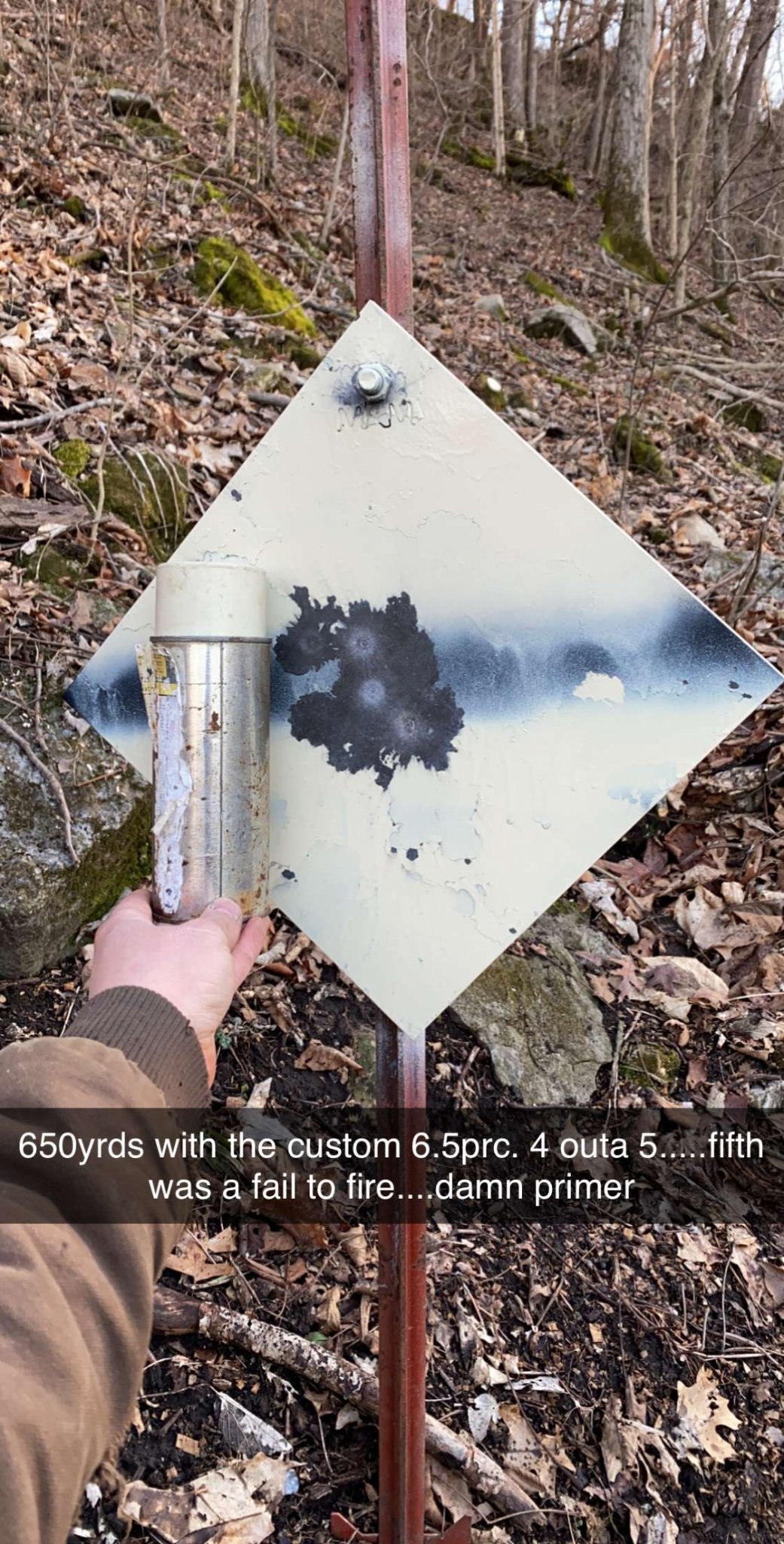

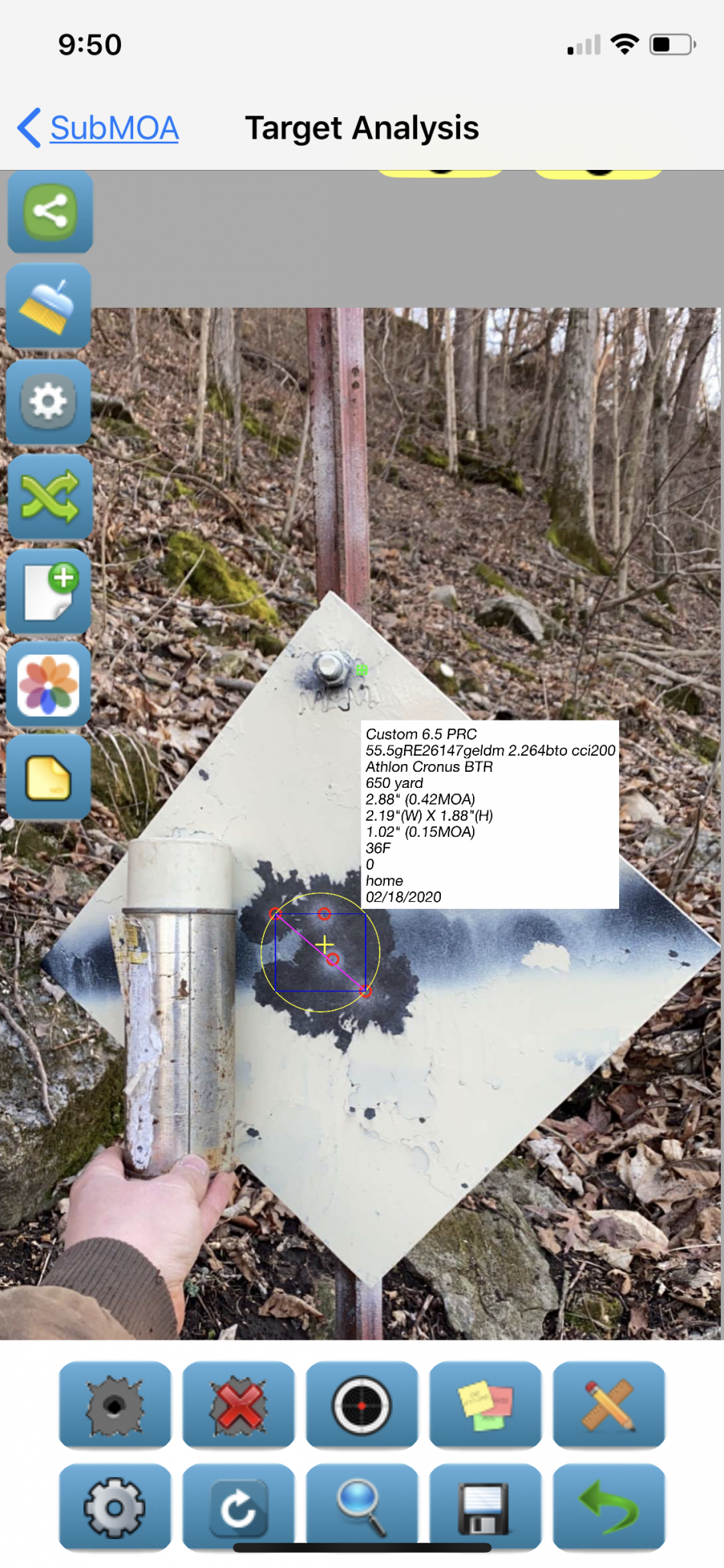

Took the ol girl out tonight, 650yrds was ok, had cleaned the the powder residue out because I had a bullet blow up so I thought I would clean it a bit, didn’t clean the copper out though and the first three rnds were all sorts of wonky getting it seasoned, that’s why the one wide and right didn’t get counted and the rest was the scope correction. All rounds were loaded, realized I fucked up on charge weight, pulled bullets, resized, recharged and then seated same pulled bullets.
weather:50*F, 29.59inHg, 66%RH, -117 Dalt
53.4gr re23, cci200, 147eldm at 2.264bto, 10 shots were taken at this target.
1-2977, 2-2988, 3-2992, 4-3003, 5-2994
Av-2990, es-26, sd-9.4 these were loaded for a longer period of time)
1-3004, 2-3003, 3-2996, 4-2997, 5-2997
Av-2999, es-8, sd-3.7

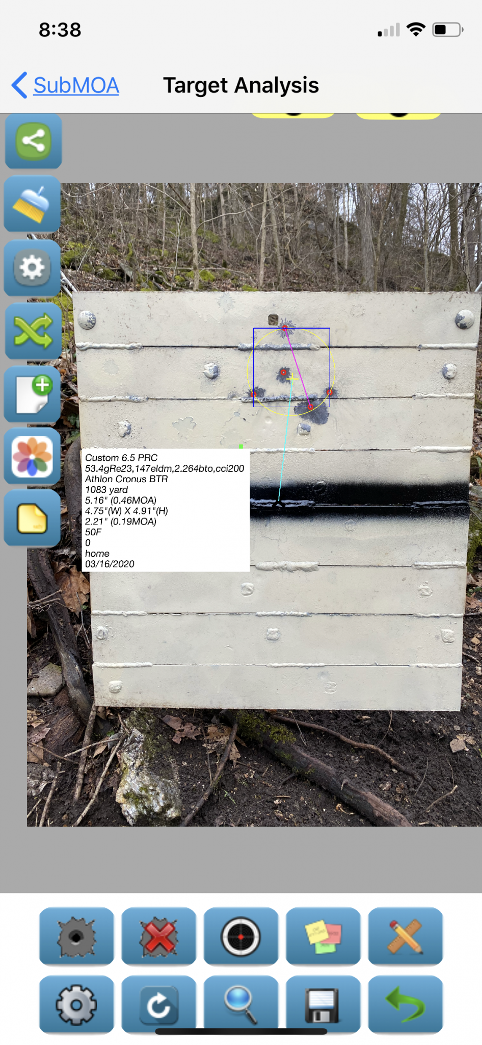

1083yrd target......same load as the one just above here. It started to mist and target was starting to get blurry from the mist.
1-3009, 2-3003, 3-3004, 4-2998, 5-3003
av-3003, es-11, sd-3.8
Annnnd a little fun took two shots at 1083yrds with my re26 load....first shot was at the handle and second shot was a .2mil correction and hit great, no explosion though☹️. 54.7g re26, fed 210m, 147eldm at 2.264”bto. Both shots were at 3013fps.
