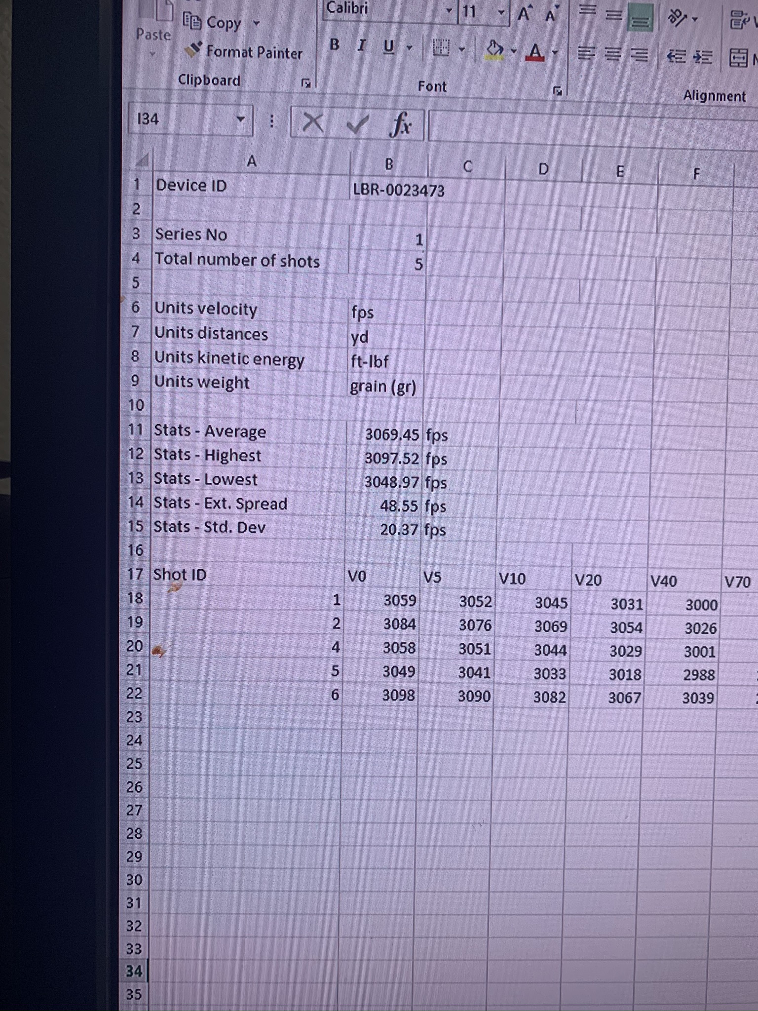

Factory 147 is running 3080 out of your barrel?! That is the fastest barrel I have heard of.

Interesting—if I keep velocities <3000 FPS (25” barrel) I am getting 6+ reloads from Hornady brass with decent primer pocket tension remaining and only the occasional split neck.
Had a high of 3098. Average has varied from one lot to another. Low average has been 3069 and high was 3081

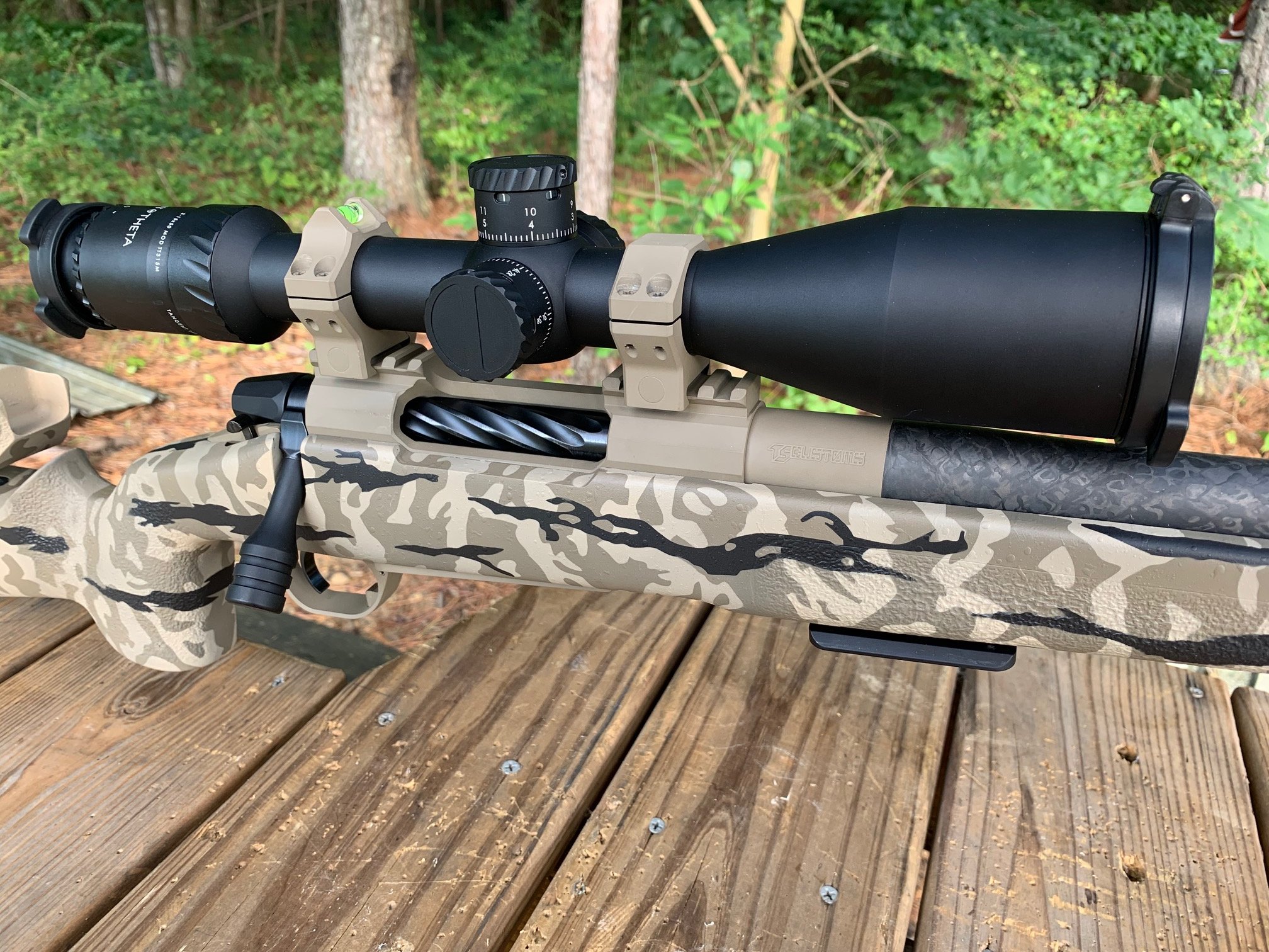

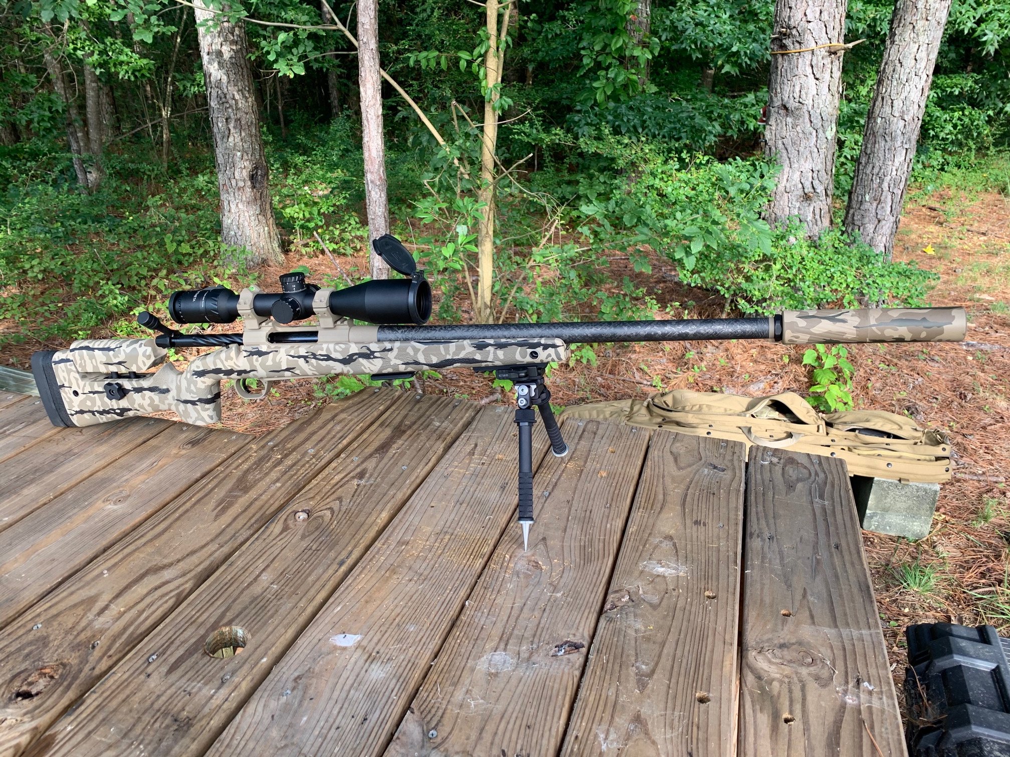

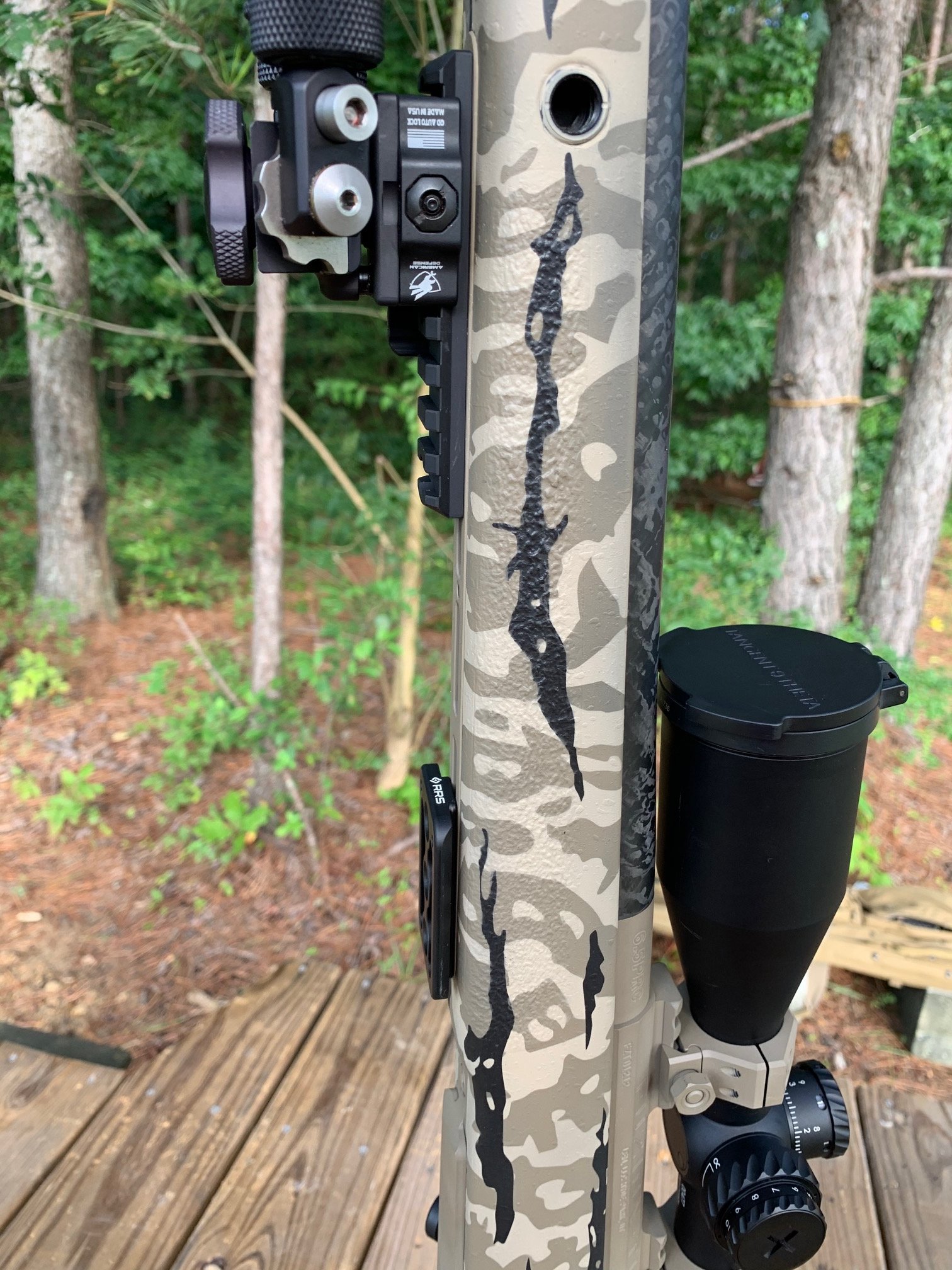

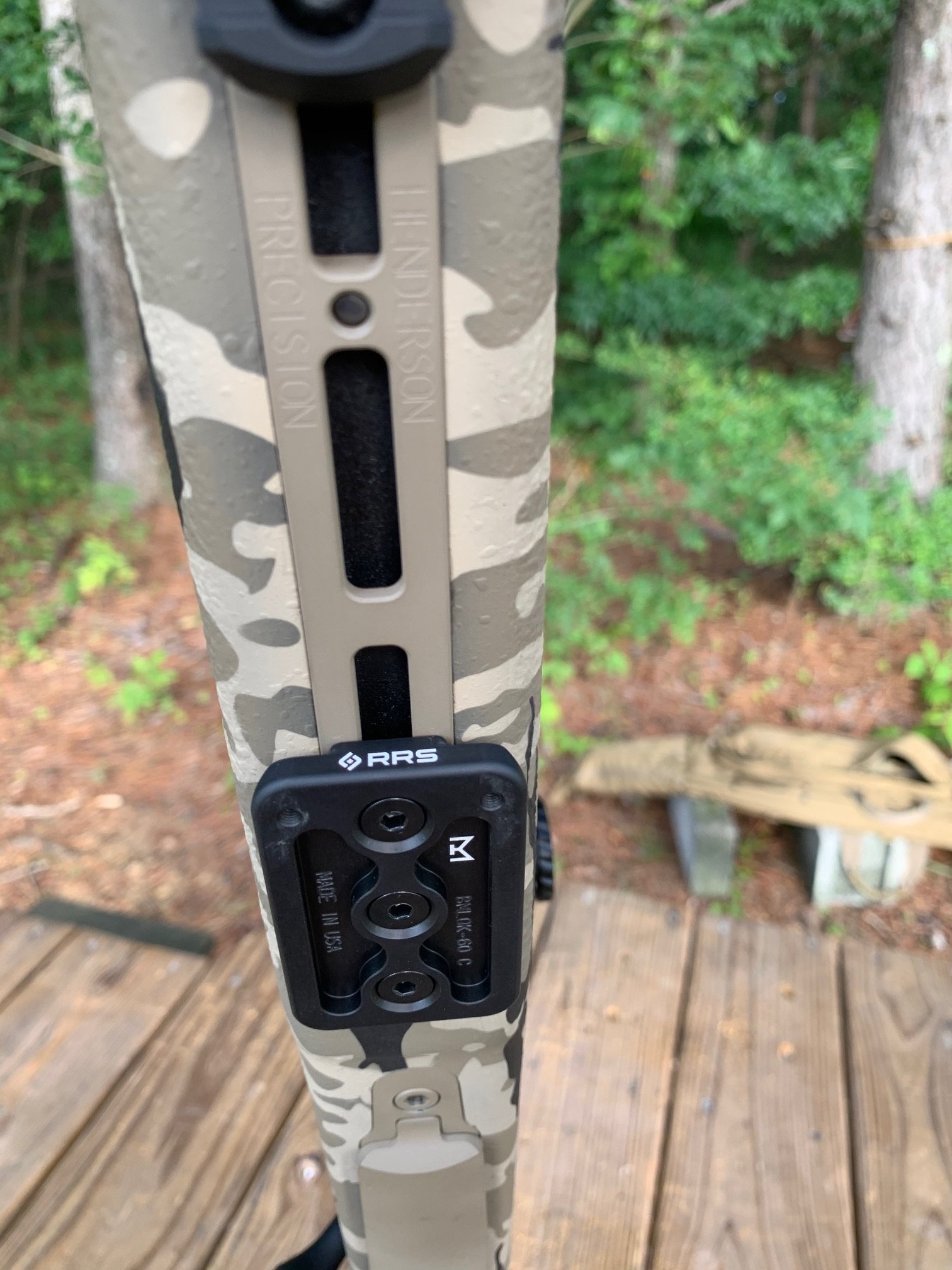

I just finished my load work on a new TS Customes 6.5 PRC with LP TI Action, 22" Proof Carbon today.
I have around 200 round through the barrel. Never shot more than 1/2 MOA no matter what load I used. Very impressed with the accuracy of this round.
Settled on:
156 EOL
Hornady brass
58.6g H1000
.030 off the lands
Fed 210M
2942 FPS - single ES - not awful being a 22" barrel
Did run into heavy bolt lift and ejector swipes at 59.4g groups were still very good velocity readings.
Rifle weights 10.5lbs without bipod and the recoil is very nice on the shoulder. Think I will really enjoy the PRC. Looking forward to stretching it out a bit.
Few Pics

Few PicsView attachment 7396103View attachment 7396105View attachment 7396109View attachment 7396110

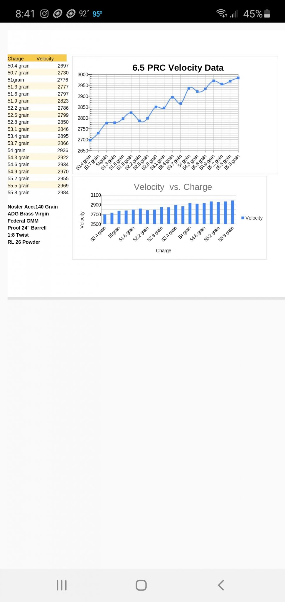

Here is what I got so far on my new rifle load development. Powder used was RL 26 on this one. I'm thinking I have to step the charges up closer to max load. Brass was also virgin ADG when shot. Need your guys advice on all data, and what i should do next, and if I'm missing anything. Thanks
Nice node at 54.3 which gives you a .6 grain flat spot. I am sure there is another node in higher velocities if you get the charge weight up more. Pretty sure you didn’t see any pressure at those speeds with a 140. You can go higher and look for a top end node but I would load at 54.3 and test accuracy and es sd then adjust seating if needed.
Yeah my intentions are to continue going up in charge weight until I hit pressure signs. I believe also there is another node up above where I left off. Also will try out that 54.3 as well.
