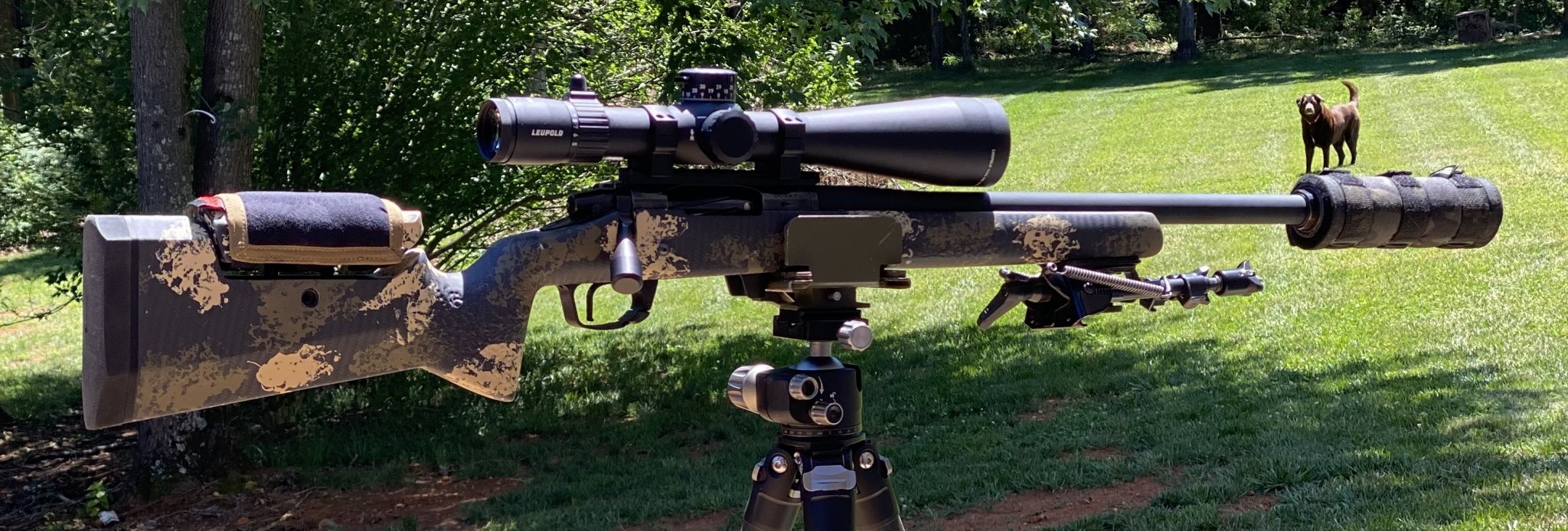

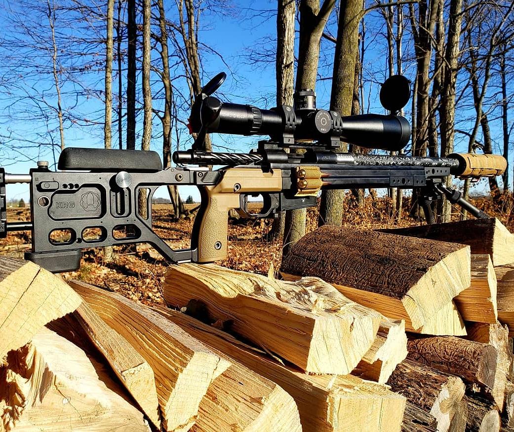

Just got this rifle put together and ran some rounds for barrel break-in. I started with a Pierce Engineering short action and attached Proof Research 16.5 carbon fiber barrel. Dropped the barreled action into a KRG whiskey 3 chassis. Also Attached the Timney tactical trigger which is set to about 6oz. Decided to go with Schmidt and Bender police marksman 2 in American Rifle Company m10 rings. Screwed on the Thunderbeast and attached the atlas to finish it up. I am so impressed with is Proof barrel, just during the break-in process I was getting .4-.5 inch groups at 200 yards. I love this Short Rifle.
Beautiful rifle! Estimated weight with and without scope?
12.7 lbs as it sits. We did not get a weight before. I think you could save another pound off by switching the metal chassis hand guard to the plastic one and switching rings. I was going to keep some weight on it for gathering dope and then probably see how light I can also make it.

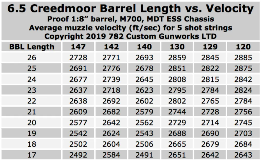

Absolutely perfect setup I’ve been on fence to go with a 18in or shorter but with those velocities I think I’ll keep a tad longer for my prs rifle. Just reason enough to just build another to have best of both!

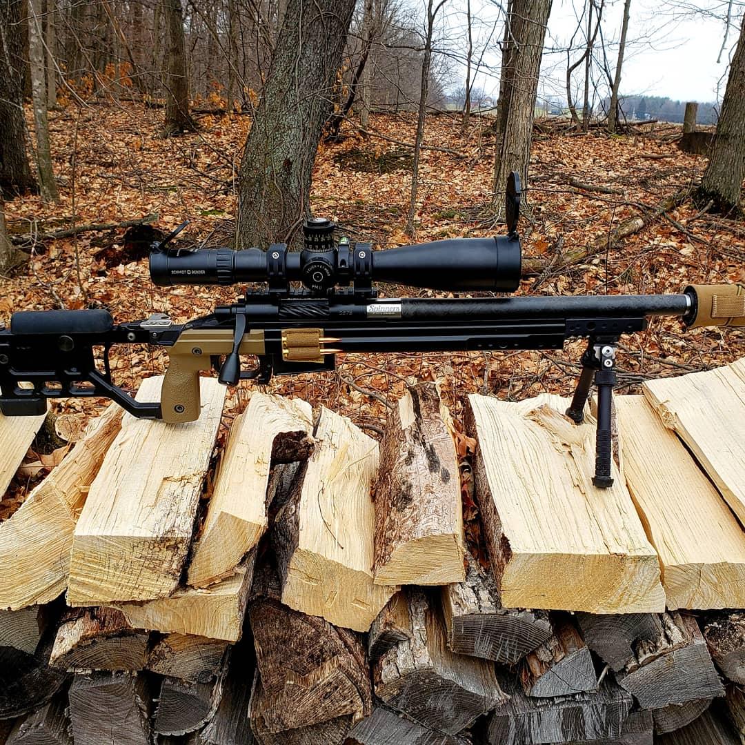

This is awesome. Looking to do a setup almost exactly like this. Curious what the weight is on it? Any specs or details would be great too!
12.5 lbs
Pierce Short action Repeater
Proof 16.5 barrel
Timney tac 8oz
Atlas bipod
M10 rings
Thunder Beast can
S&B 5-25 PMII
Absolutely love this short and handy rifle.

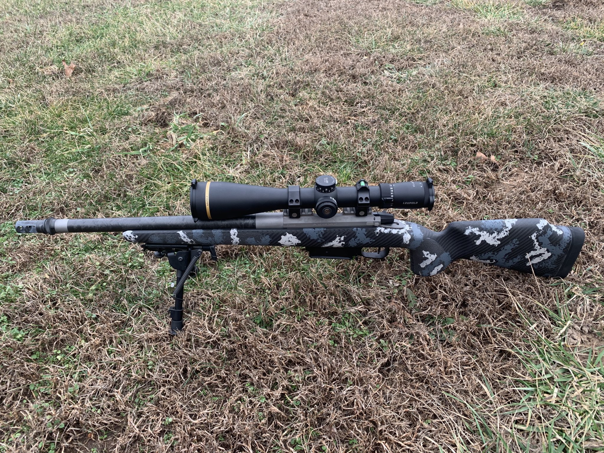

My shorty, 18” krieger custom contour about a #4 sporter, 6.5 creed, manners with cdi bottom metal, fn spr action. Leupold vx5 hd duplex retical and thunderbeast ultra 7. My hunting rig shooting handloaded Barnes 127lrx

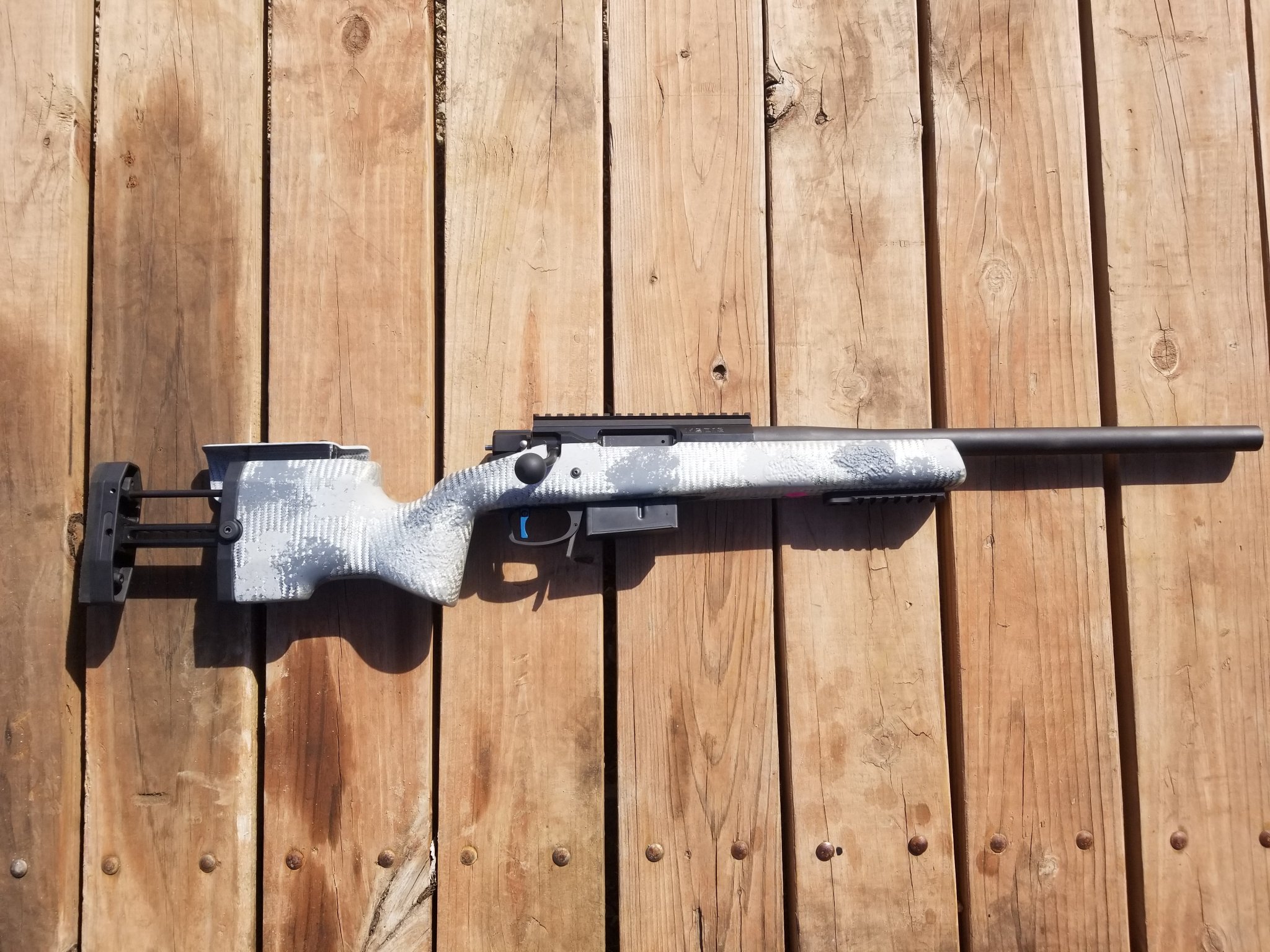

This one comes in right at 8 pounds. It has a Badger Ordnance 2013 action, 18inch Bartlein chambered in 6.5 Creedmoor with a C.G Jackson trigger and it's all tucked perfectly into a Manners MCS with a Minichassis. It's perfectly built rifle.
Badass. I love that carbon fiber peeking though, especially on a hunting rifle.

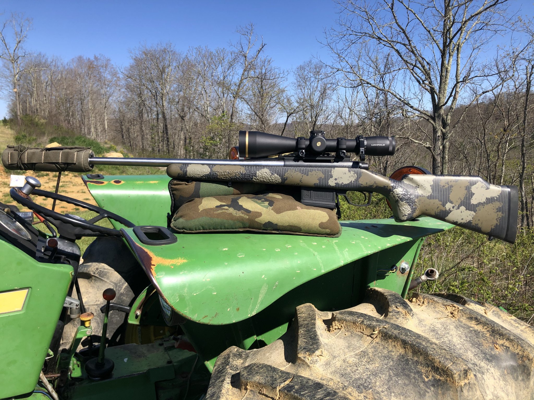

Thanks man! It’s a kick ass rifle really happy with the way it turned out. It’s actually a vx6 don’t know why I put a 5 that day to much Leupold in my brain. That was my first build I did myself and one of my friends liked it so much he had me do one for him but with a 24” krieger here’s a pic of his.
