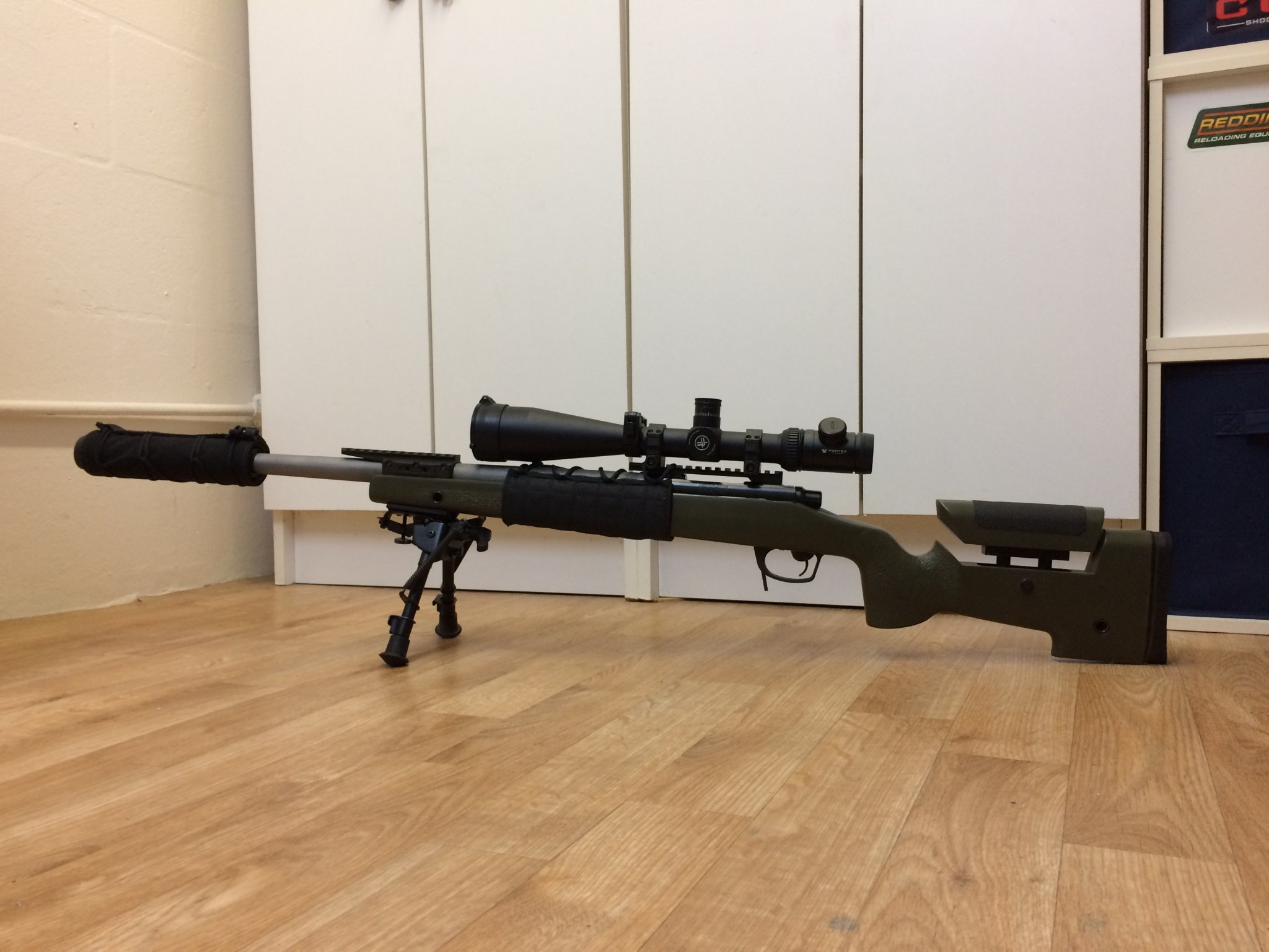

Finally got my stick chopped down to 16.5”. Took a quick trip to the range today between baby feeding times to zero and get some ideas on velocity. All #’s are with factory Hornady and Federal ammo.
X
Reactions: daleo8803
Is that a carbon barrel? also what can is that? Would you mind posing the set up’s total weight? Congrats on the baby by the way. I have 4 and I love them (though they make the shooting budget slimmer haha)
It’s a Kreiger Light Palma, originally cut to 21” by Beanland. XLR Evo, with a TBAC Ultra 5. NF ATACR 4-16 F1, RRS unimount.
This was already my favorite rifle combo of all time, and it’s even more so with this barrel chop. It’s mostly for hunting out to 600 or so, and the local range only goes that far anyhow.

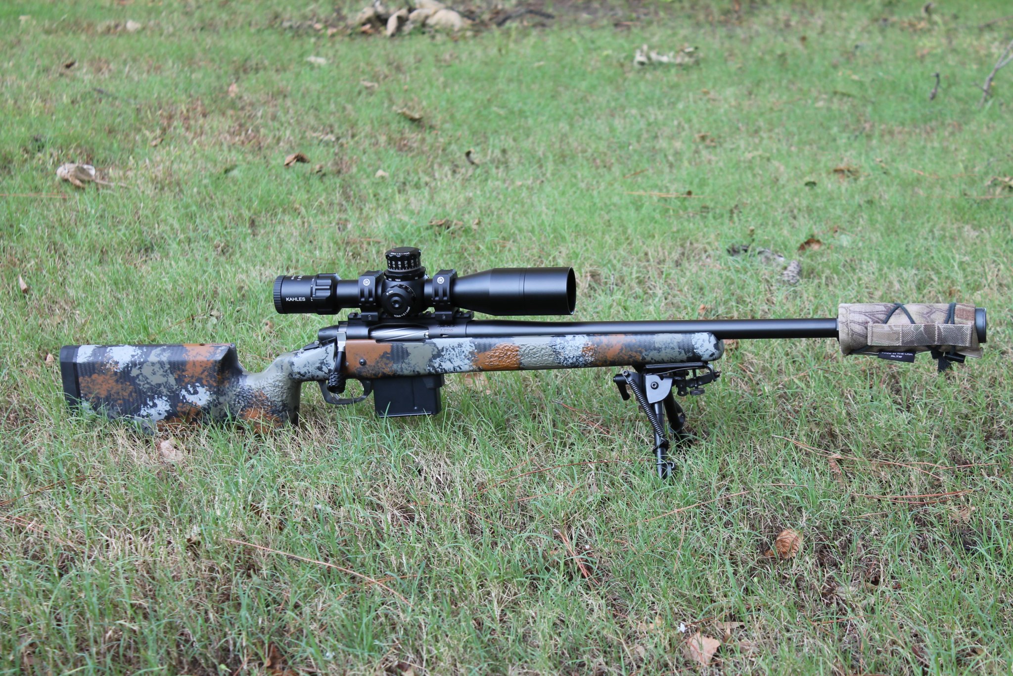

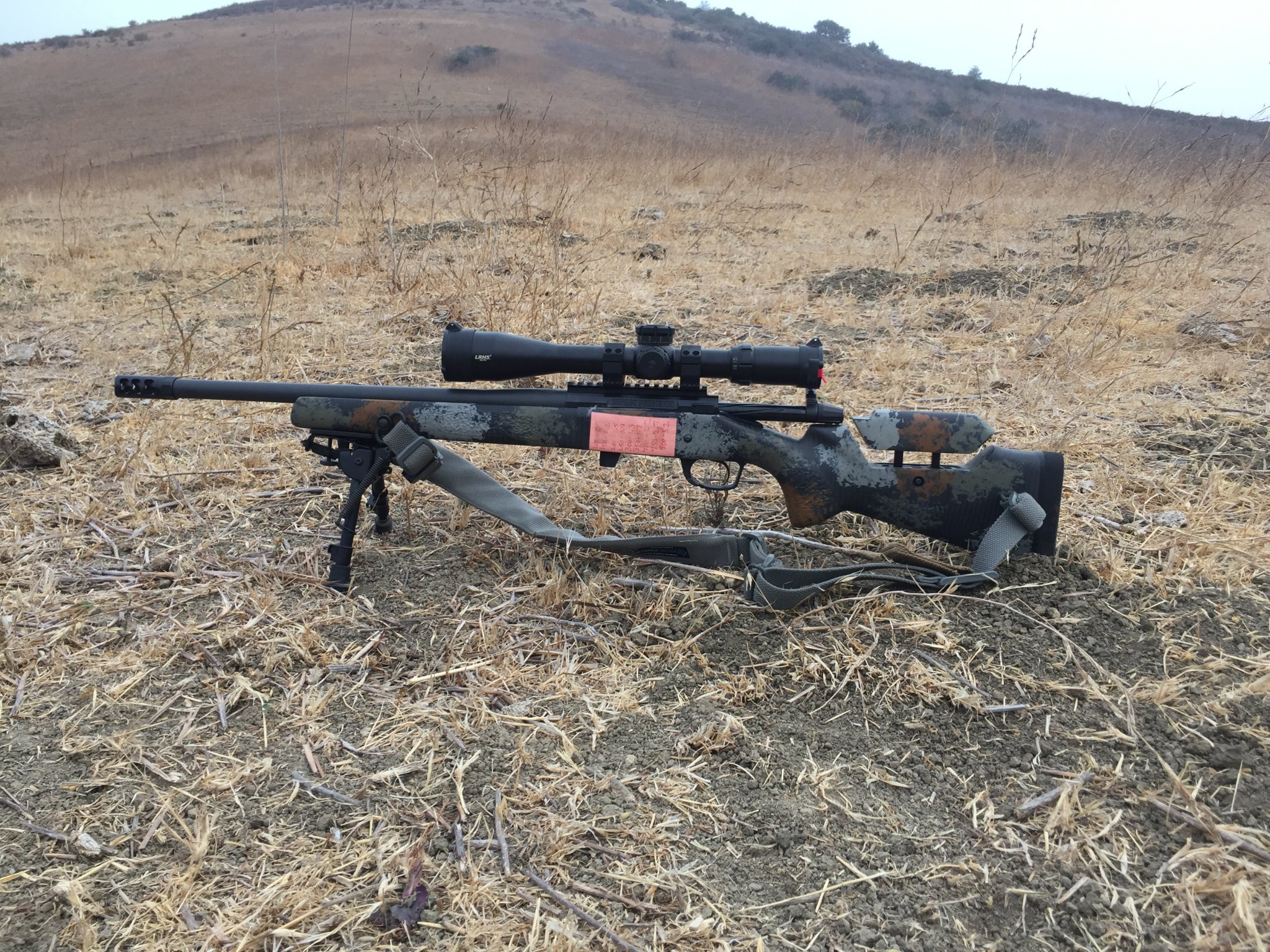

This was my .260R, Rem 700 trued action with a 18-inch, 1:8 twist, Bartlein Heavy Target contour barrel.
It was in a Mc Millan T3-5A stock at the time this was taken, but it was usually in a Manners T5A stock.
I ran 6.5 ELD-M 140 gr. bullets loaded with IMR4350. It was a slow load - 2560 fps, but at more than one match, it easily hit 12 and 8-inch plates at a 1000 yards. Even in a stout wind. It hit plenty of other plates, of various sizes, at ranges of 200-800 yards, too.
That particular PST Gen I scope was problematic, but with a decent scope, was a nice rifle! Unfortunately, I didn’t figure out that it was the scope that was causing some accuracy issues until the barrel was almost at the end of it’s life. I’m wiser now.

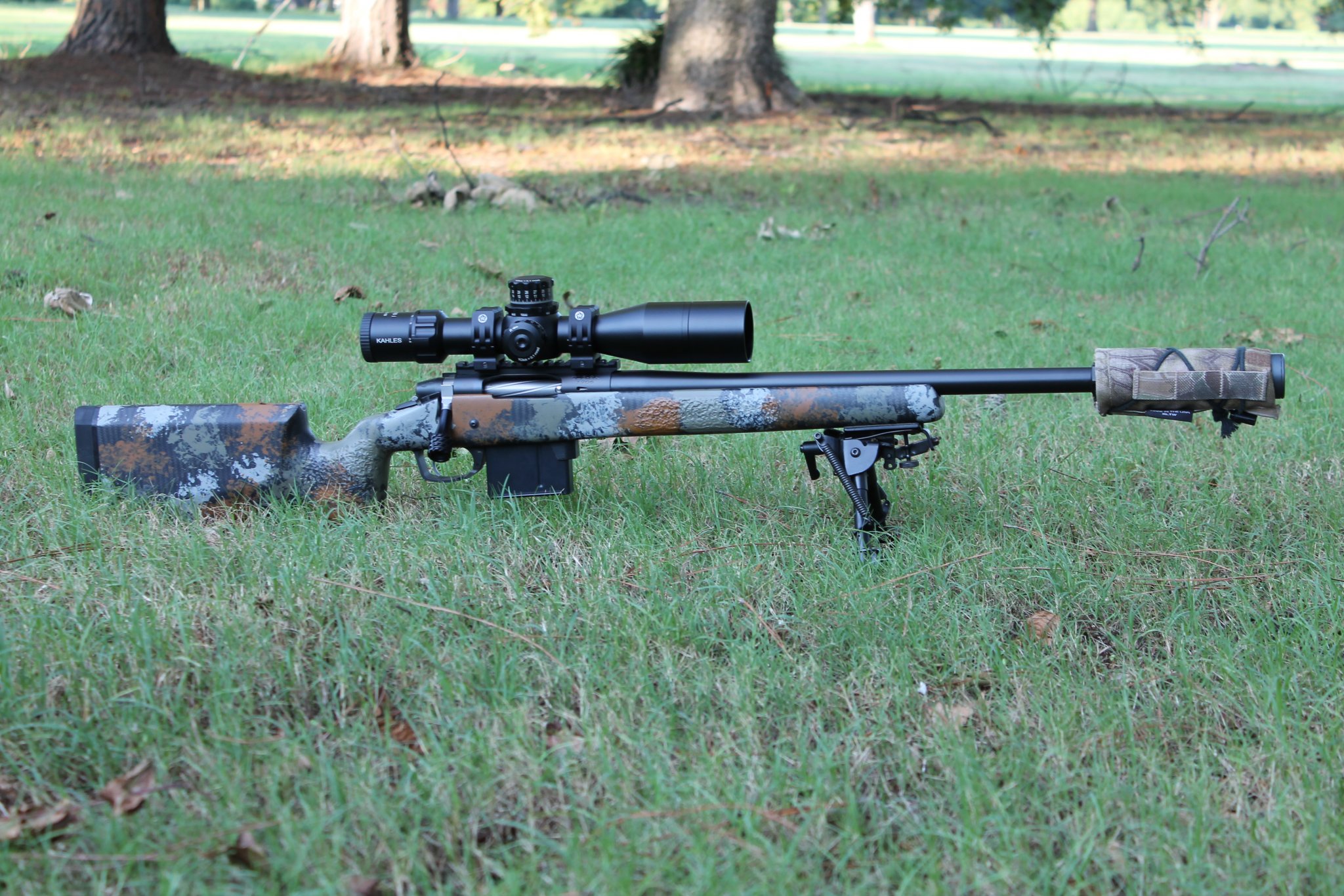

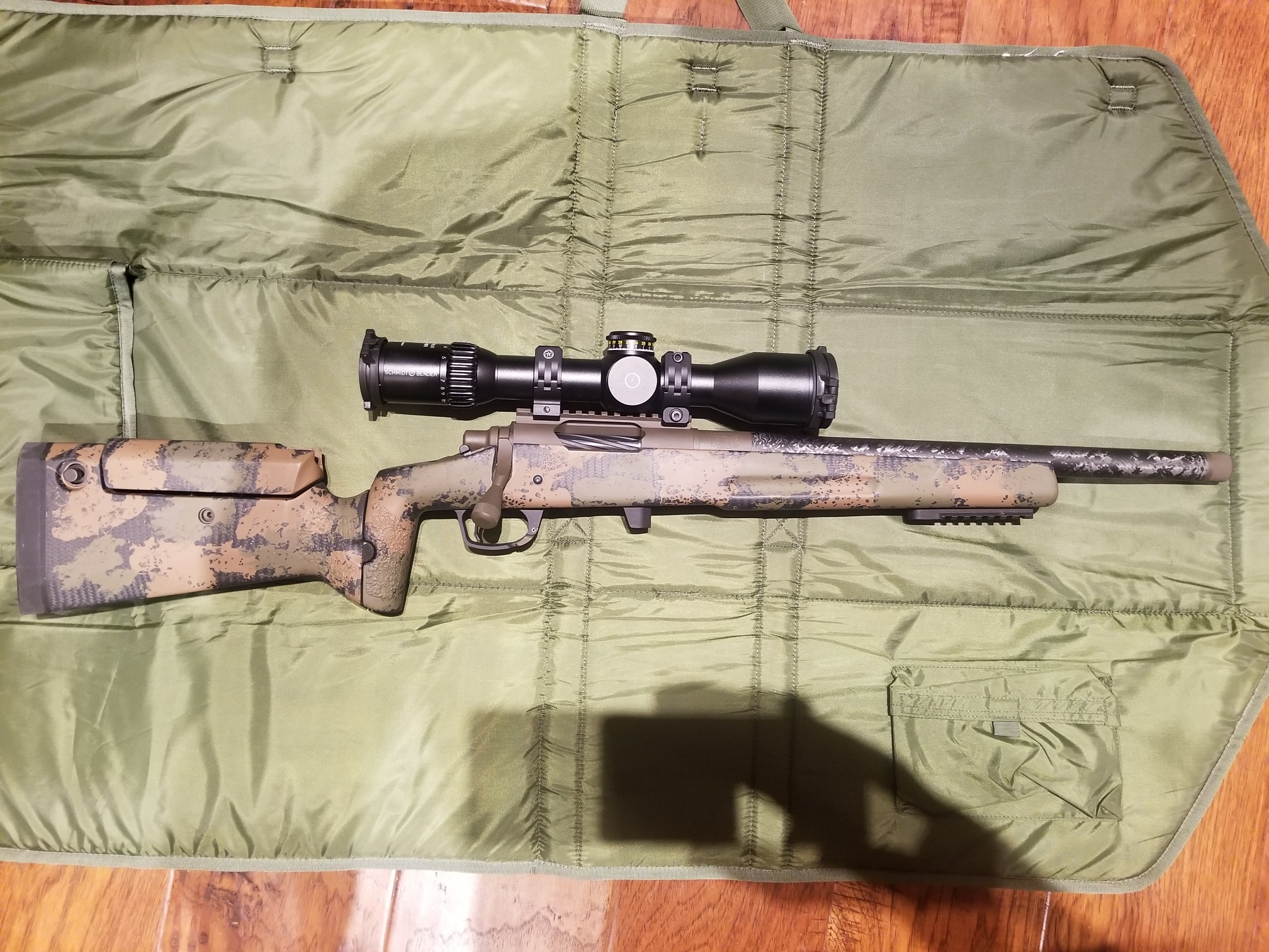

Bighorn TL3 6.5X47 finished at 18"
Bartlein sendero/RV contour
Triggertech special (soon to be diamond)
Manners EH1 CORE custom elite Highlander
Kahles k318i
My build will be very similar when done.
Impact action
PVA Remington Varmint/Sendero 18”
TT Diamond
Manners Ta Core Highlander

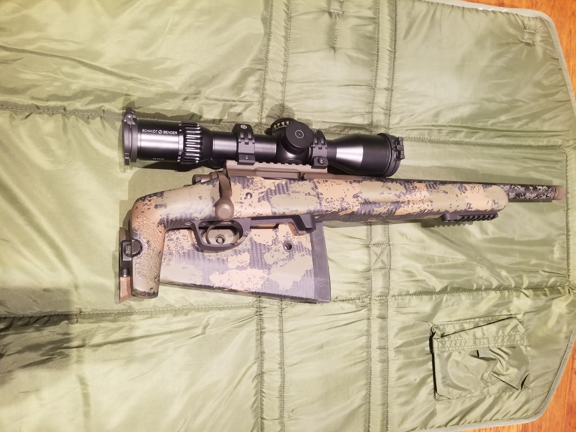

What twist are you running on your 16.5" Creedmoor guns?
I was running 1-8” twist. My current 18” is 1-8” and I’m really happy with it. I do have some 1-7” twist 5R Bartlein barrels on the way to see how they do with shorties and short mags.
SD isn’t anything to brag about but it shoots tight and moving 140’s pretty well.

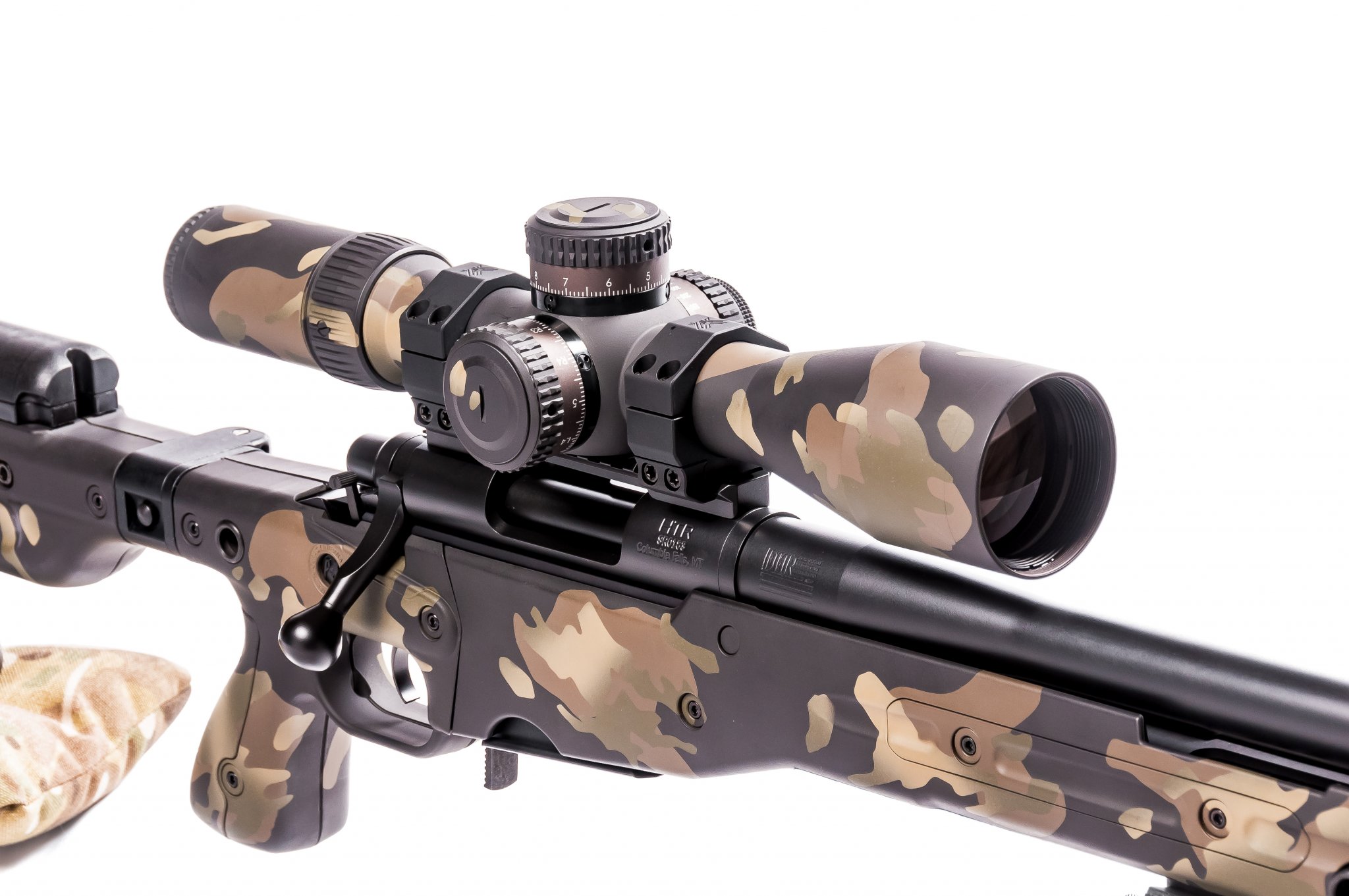

What’s the details on it? Proof barrel? Is that a Stiller action? Caliber and length?
Stiller Tac30
18 inch Proof chambered in 308
Manners tf1a
Timney Calvin elite
I know it’s not a 6.5 but don’t really seen any other shorty build threads. About to start loading some 178 grain eldx for development.
