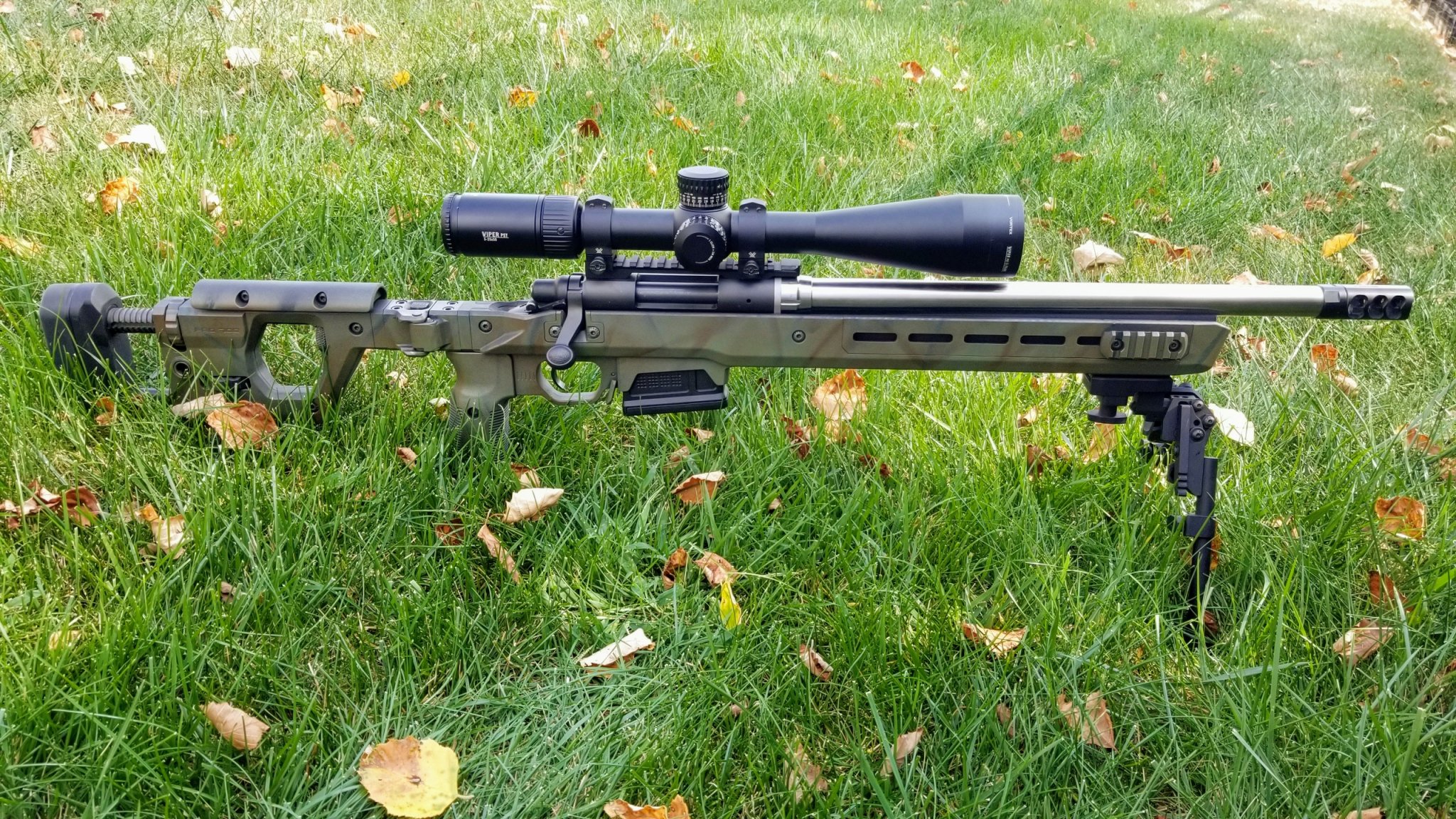

6.5 "Shorty" Rifle build
I have a 23.5" medium palma Bartlein on my CTR that I am thinking about cutting down to 18". Getting 2835fps with 140 ELDM and 143 ELDX now with Rl16. If I could still get 2675-2700 with a 140, I would be happy.

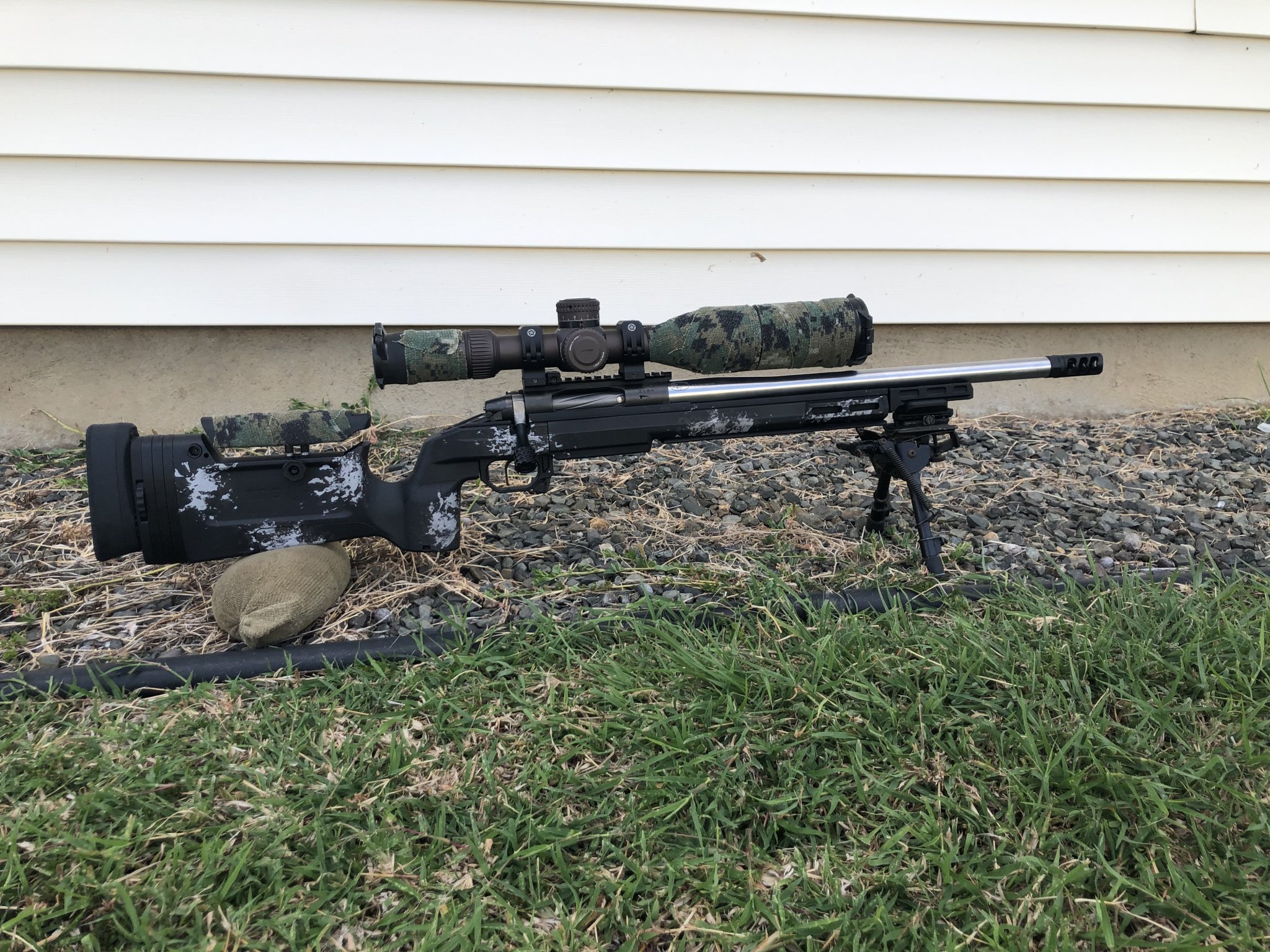

Threaded 5/8 or 9/16? Considering a Bart #3 on my next barrel, but wasn't sure about threading size for my Tbac.
5/8x24. George wanted to be on safe side, I might could have gone another inch but decided to go 20”. Could have gone 22” with 9/16 but they had a 5/8 TBAC CB on hand so that’s how we rolled.

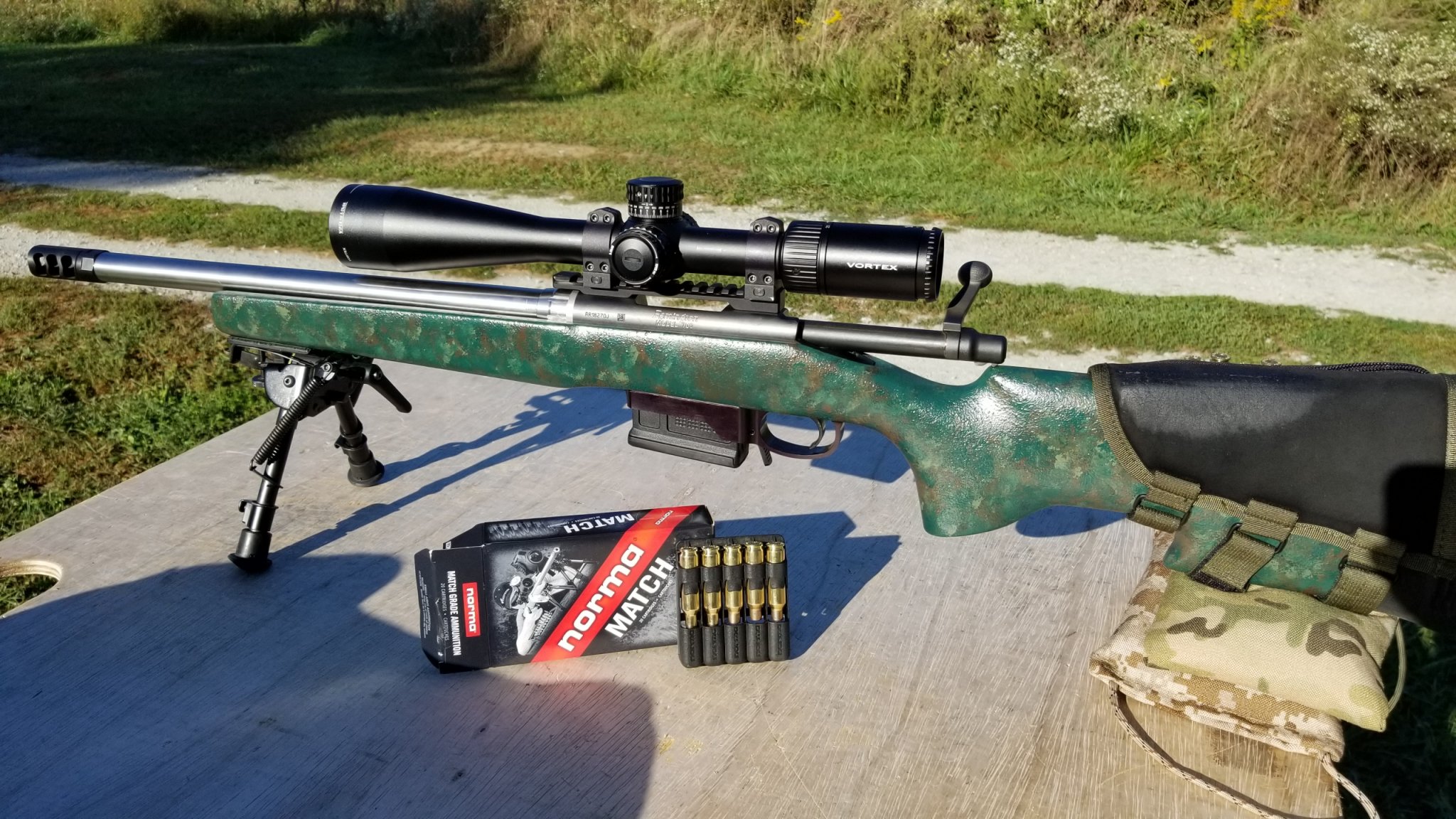

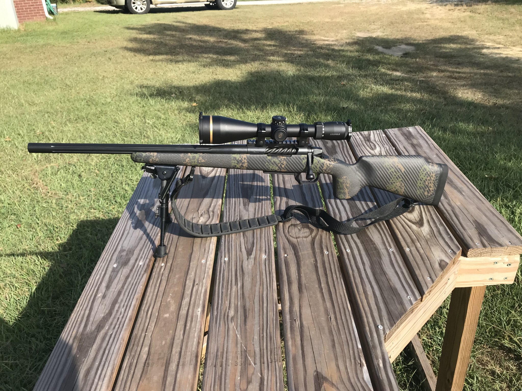

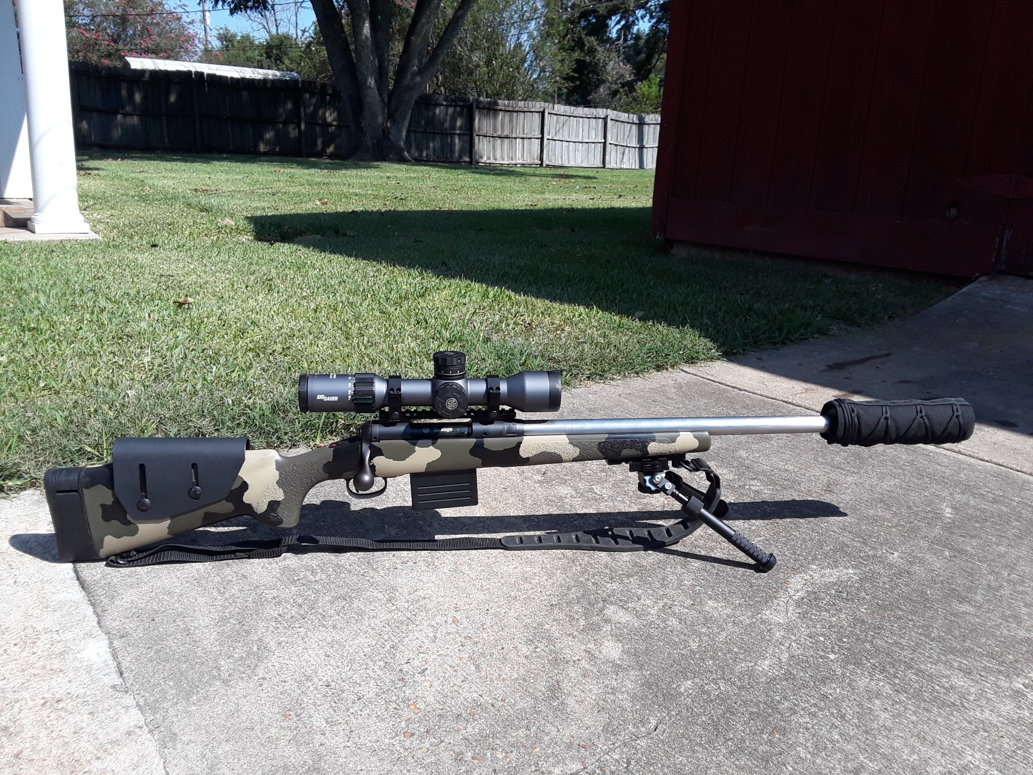

Took the new 16.5" PVA 6.5 Creedmoor to the range today to zero at 100 and shoot some groups. Factory ammo was Norma 130 match and Nosler 140 Ballistic Tips. Started with 130s 5 rounds to zero. 10 shot group at 100 yards shots 6 to 15. (After round 6 was fired, raised elevation up 2 clicks. Then fired 9 more)
Then fired 1 full box 20 rounds of 140 BT at 100. ( black target/ red bull)
Factory 700,
Timney
BC hook stock bedded.
Vortex 5-20x50
Ready for deer season!

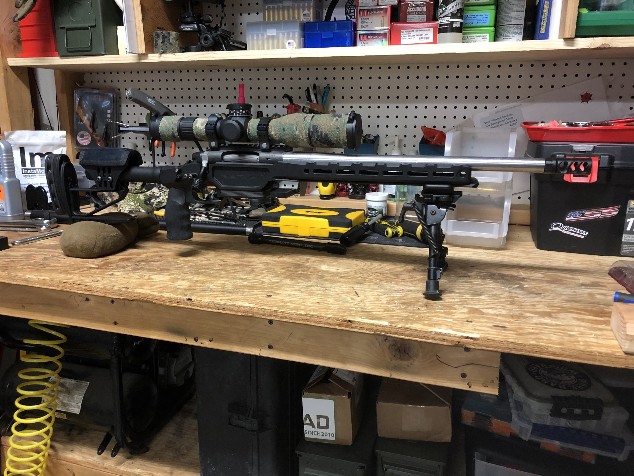

I've got a PVA 18" 6.5 Creedmoor barrel on a Nucleus/Bravo combo...after selling off a 18" Rem-Age the siren song called me back.
With 85 rounds through it I'm getting 2590fps from Berger Ammunition 135gr Classic Hunters...which appears to be 'aight'.
664454cd-eb5c-4f7d-b914-b034d518dc2f-jpeg.7139161
Got some 130gr ELD-M loaded up with Varget, hoping to find a good node @ 2700+ otherwise I'll *just have* to buy more Berger ammo...

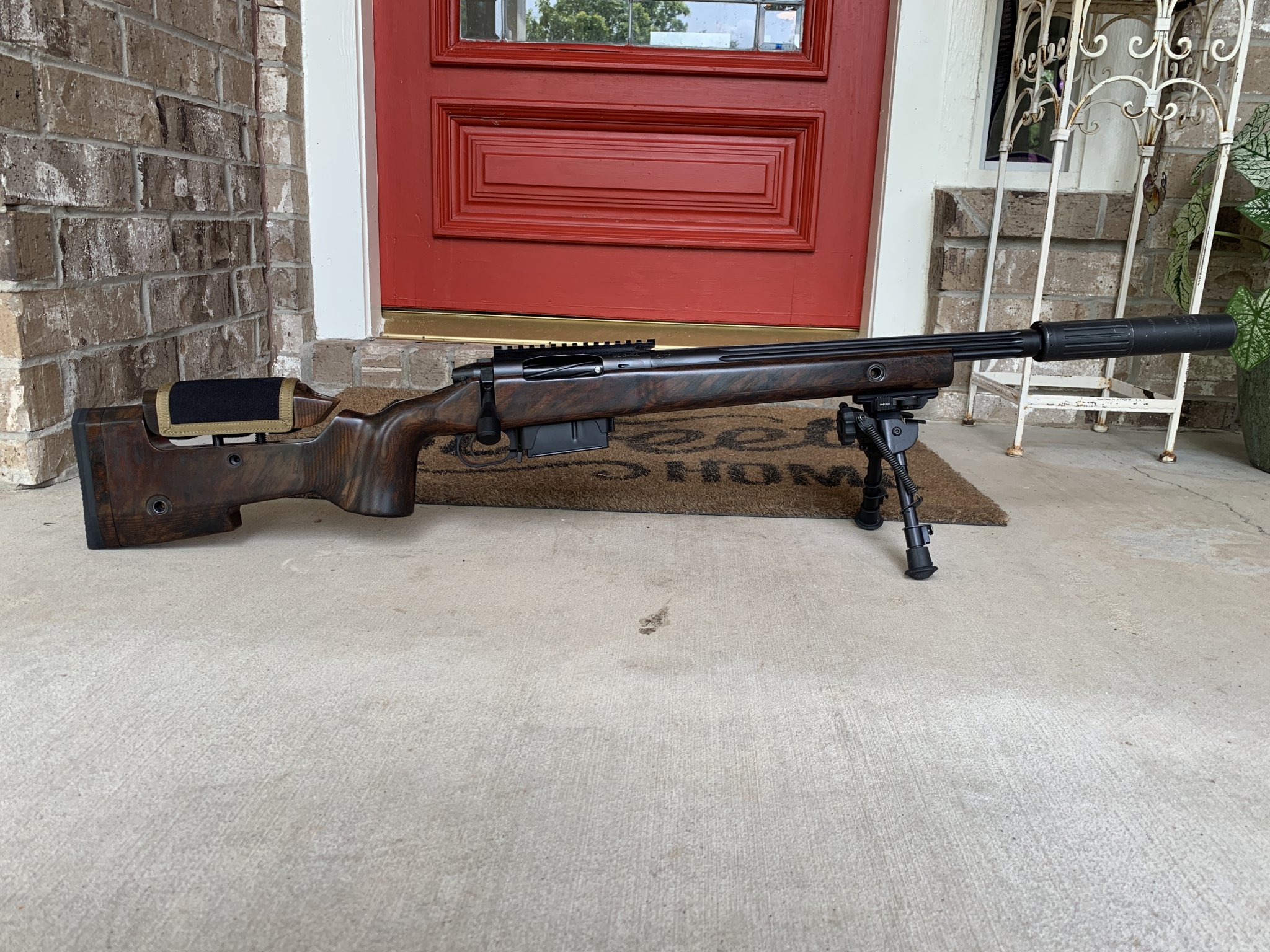

Just finished up this build for my 12 year old daughter. 16.5” Proof CF in a 6.5CM for hunting and a 22” Krueger SS in a 224 Valk for training. Been shooting factory Hornady 140 ELDM’s. She bangs steel at 600 no problem. 15.25 MOA at 3440 DA.
First 3 rounds she fired out of it measured .280” @ 100
Bighorn Origin
16.5” Proof Sendero 6.5CM
Manners MCS-CS
Area 419 Hellfire Brake
Trigger Tech Special
Atlas Cal
Nightforce NXS 3.5-15 NPR2 Reticle

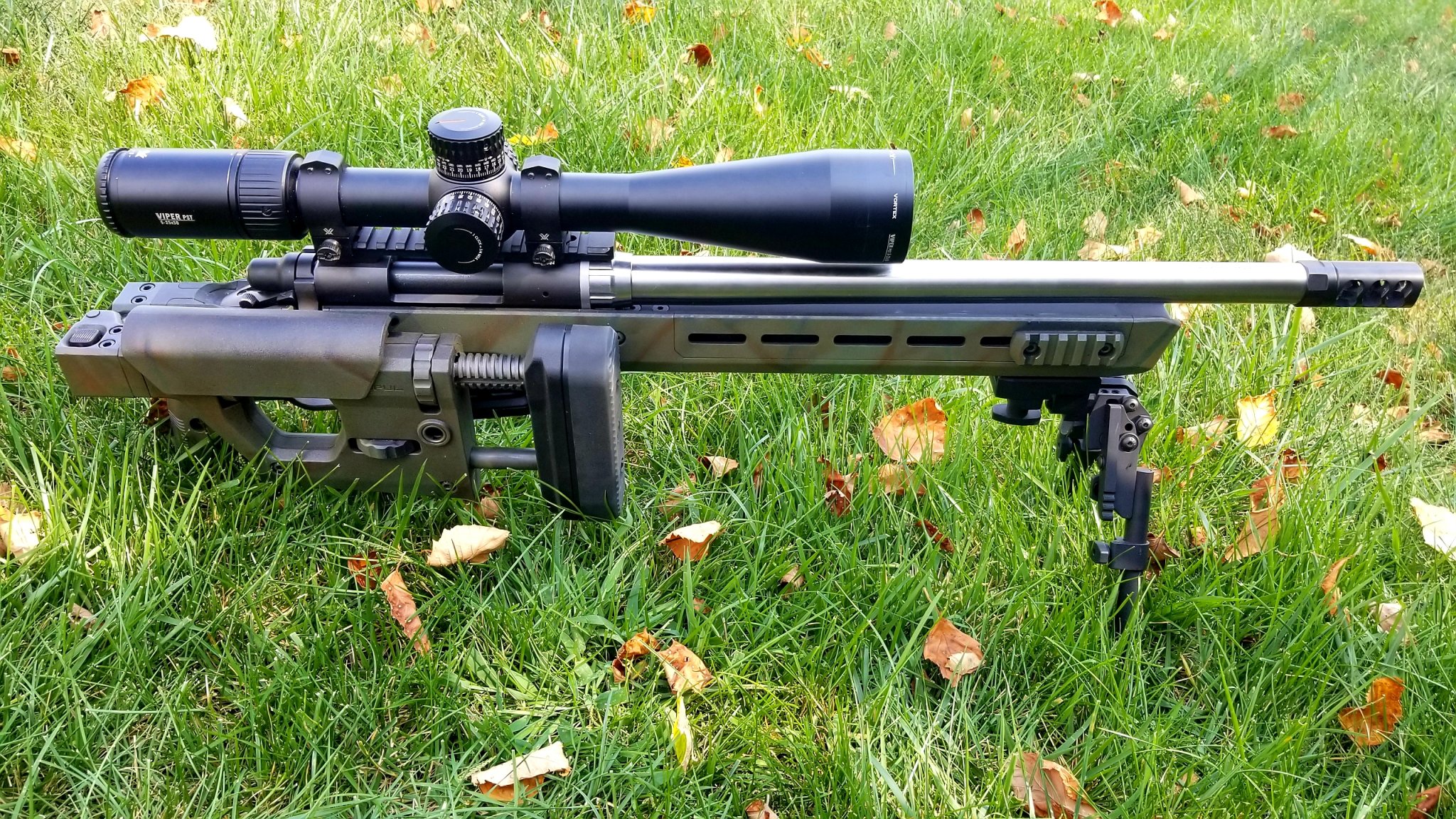

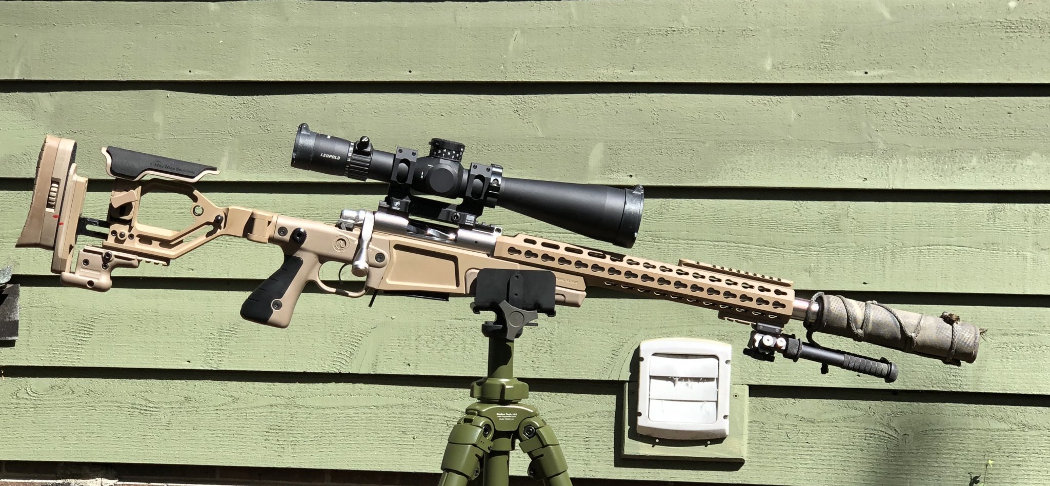

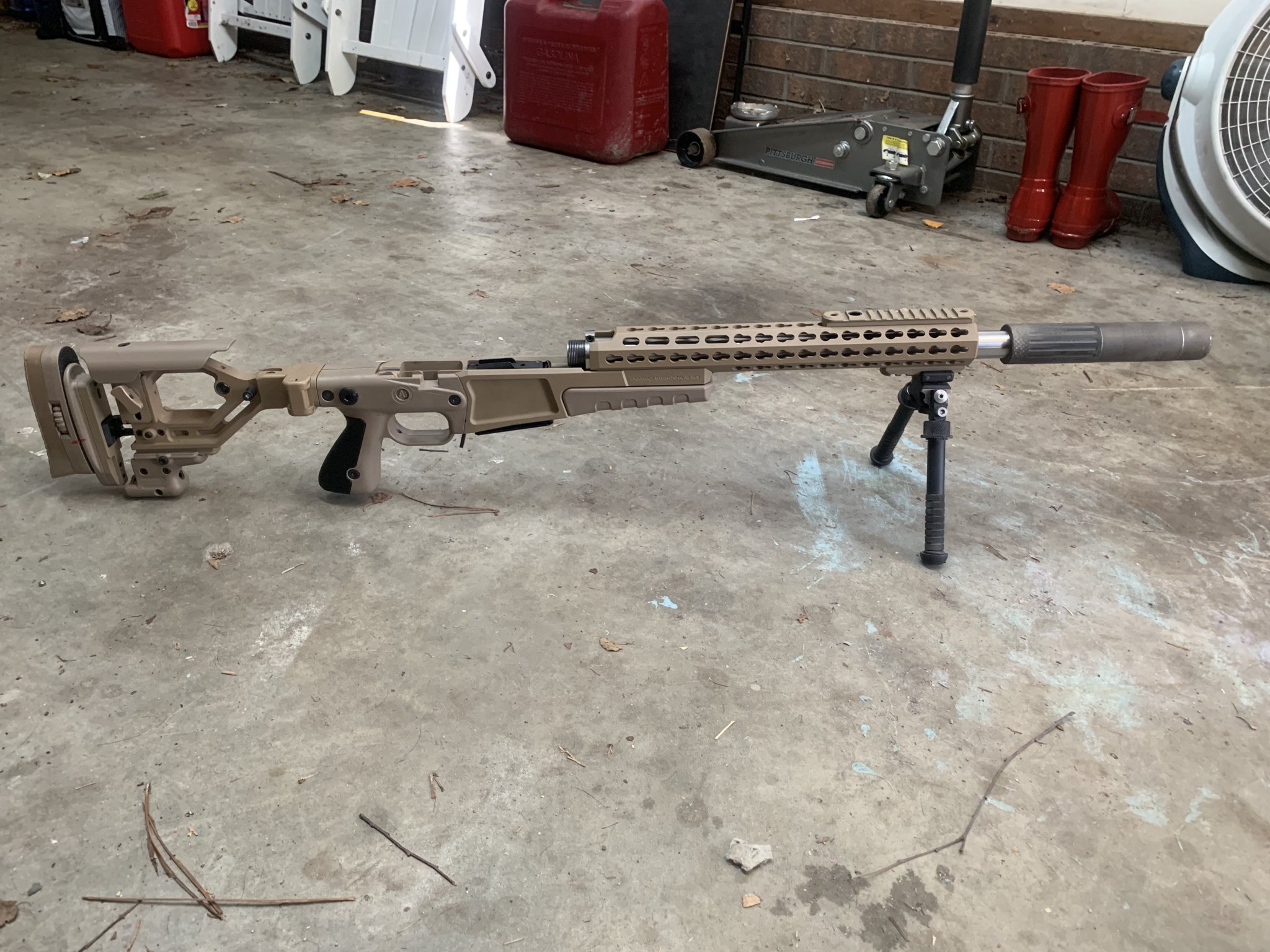

Reviving an old thread? Just upgraded from the old bravo to an XLR envy pro, and took off the razor put on a leupold mk5. Got some 140’s sitting around and will see what I can do with them out of this

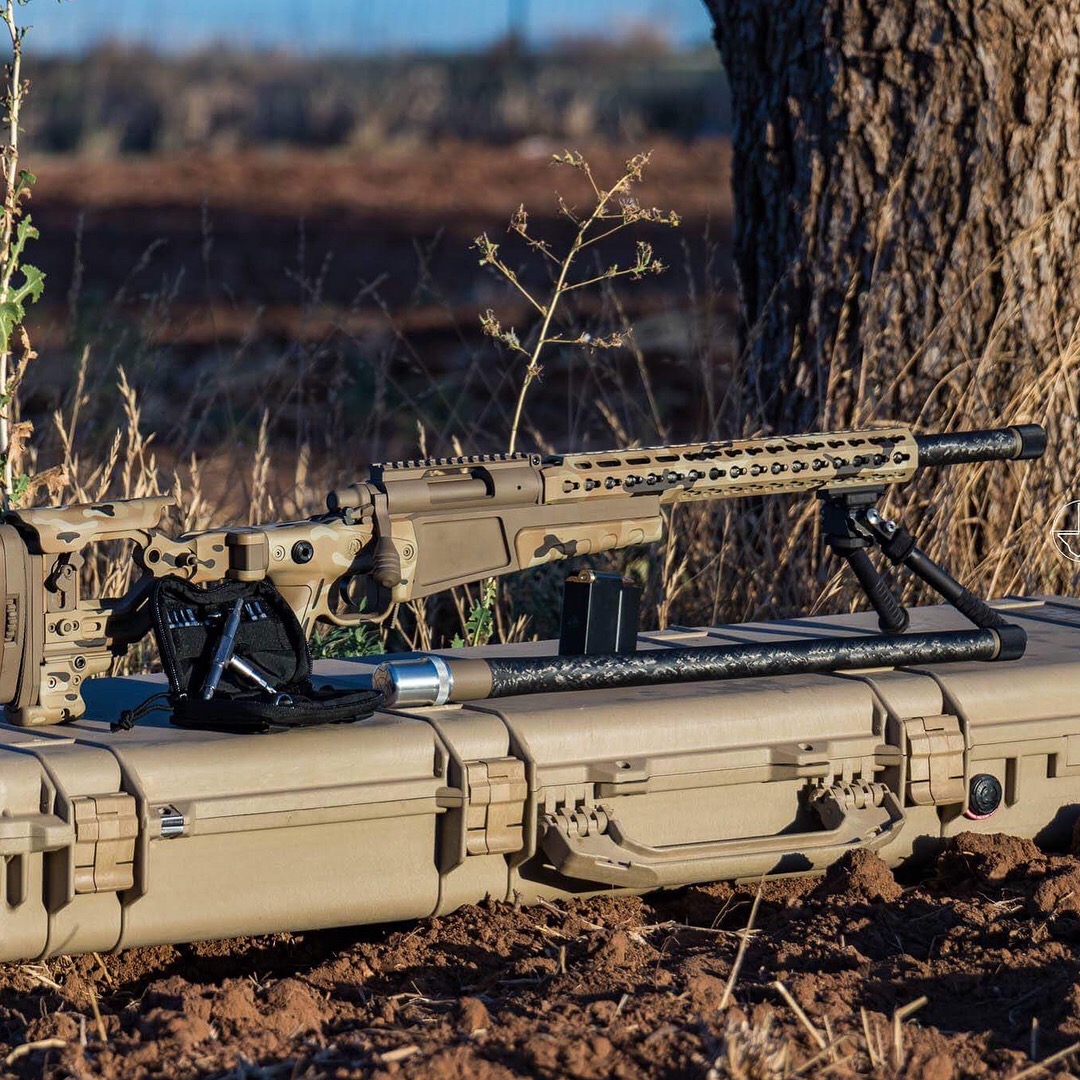

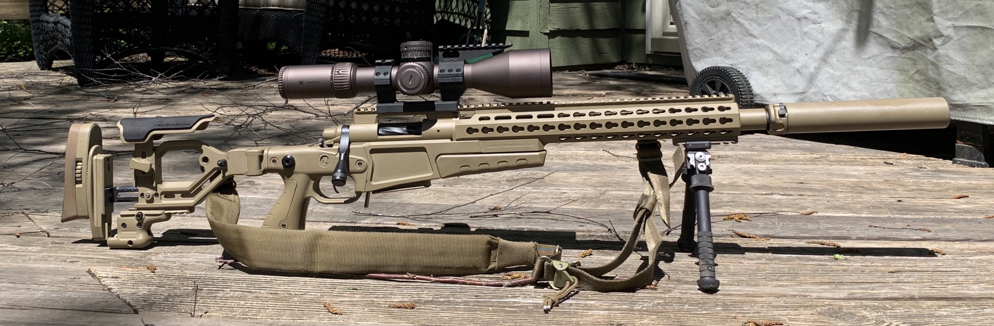

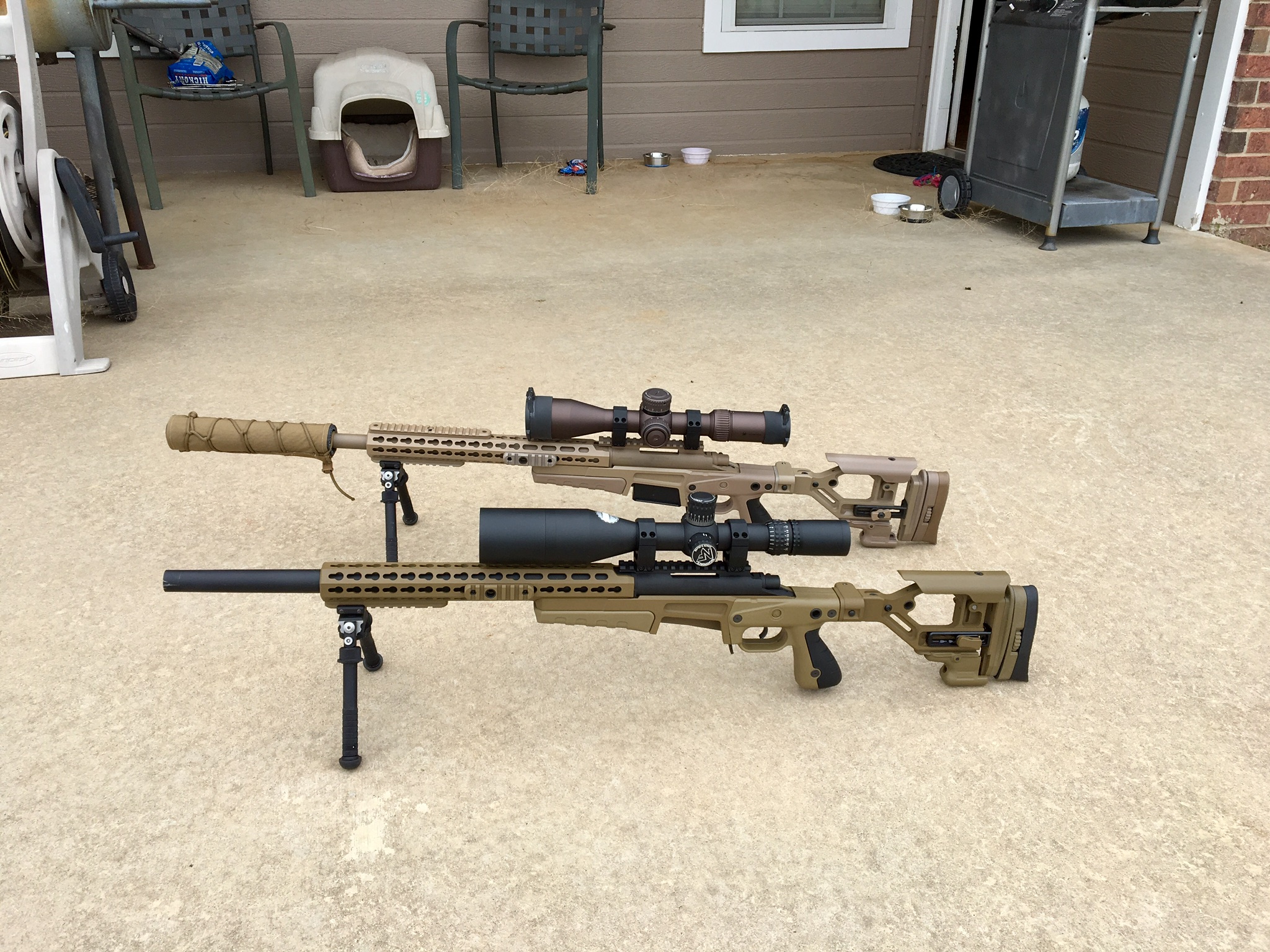

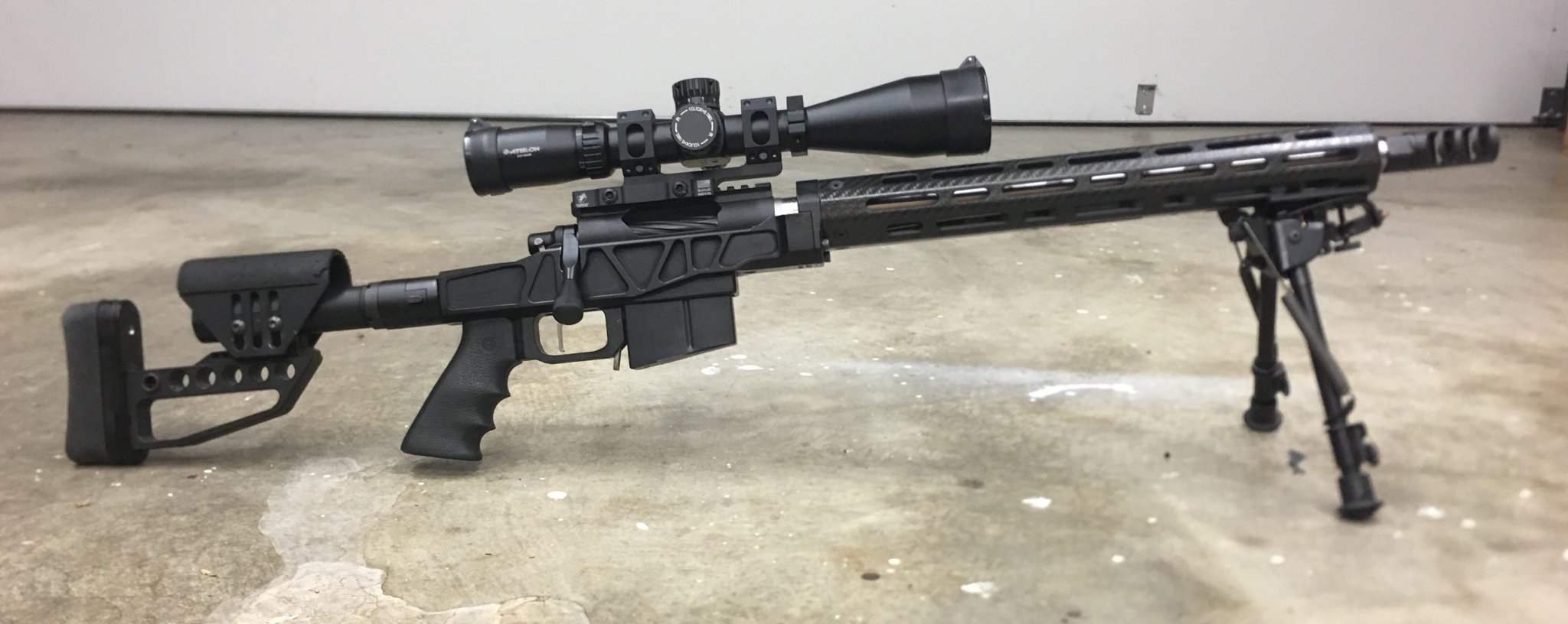

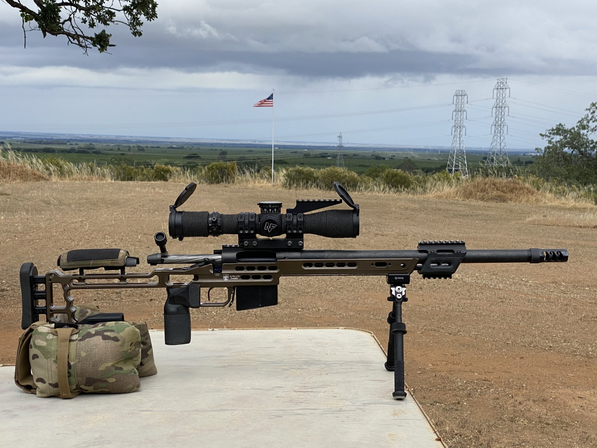

America Fuck Yeah!!! This 18”6.5creed/TL3 setup has been a half moa platform with multiple shooters beyond 600yds thus far.... One of my favorite configurations.... It now sits in a Manners CS2 for a donor/intro rig that can get newer shooters Comfortable fast.
