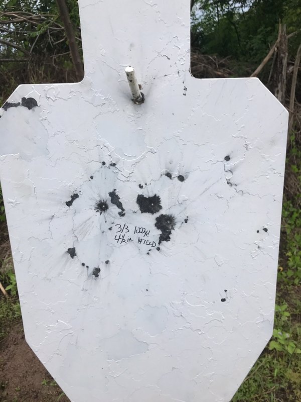

By contrast, I can't seem to put 5 rounds of the 147 on target at 1330 to give you a picture, but here's what it will do at 1000:

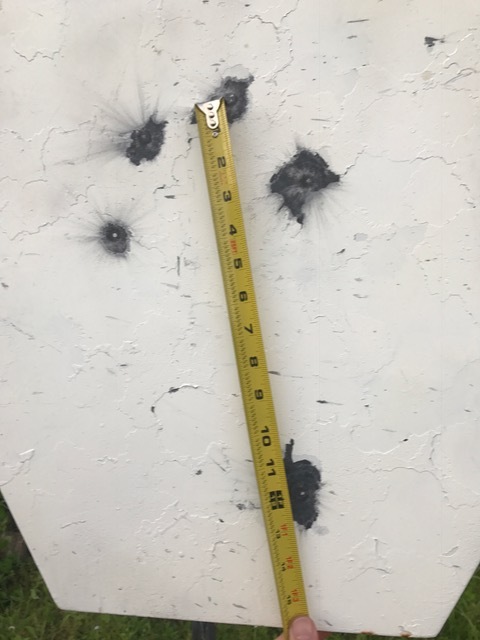

...and at 100:

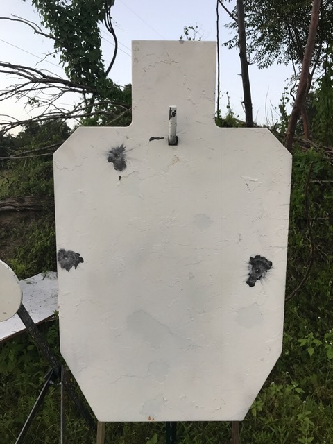

Any thoughts on what might be going on? By the way, I forgot to mention that I tried to do a test yesterday, and with the DA and conditions virtually identical to today, I think I put 4 out of 5 of the 140s on the first target, then went 2 for 2 on the 147s before the downdraft from a nearby T-Storm swept in instantly, and made shooting the rest of the test invalid. Those two hits were slightly low, but only 6 inches apart. I used the same dope today for elevation.

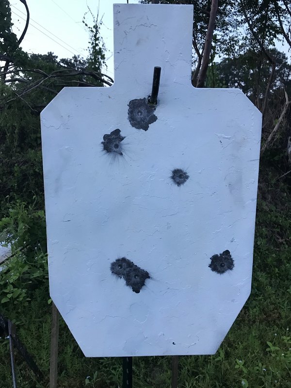

First shot with the 147s was on for elevation, but 0.2 mil Right. I decided to cheat the group a bit just in case it went off the right edge, so I dialed it back 0.1 to the left and fired the second shot. It impacted 0.2 High, and 0.1 Left. No changes, I fired third shot and it was on for elevation, but 0.2 mil Left. I decided to remove the slight correction I had put in and and moved it one click back the other way where I started. Shots 4 and 5 were misses, and I have no idea where they went. So, I was 3 for 5 with the 147 @ 1330, 15 inch "group" from what made it onto the target: 1471330.JPG

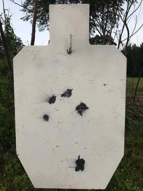

I immediately switched over to the 140s, re-indexed for the proper dope for that load (i.e. added 0.3 UP, no change on windage) and fired a five shot group. The first four landed center-mass in grouping just under 6 inches. The final shot went a bit low, and extended the 5-shot group out to 12 inches. (I don't know if I got cocky or complacent, or if the large 50-ish ES of the factory load just caught up with me). 1401330.JPG
