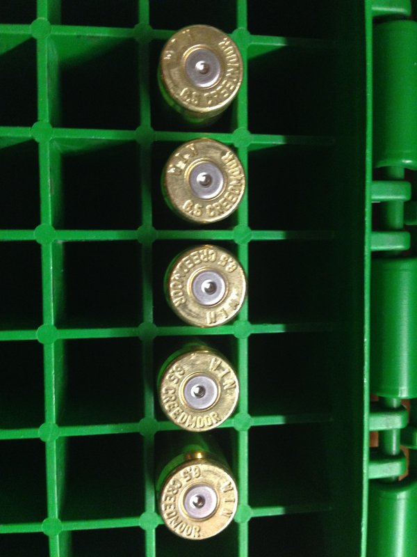

    image.jpeg Doing a load workup for a new Tikka. Barrel is 20" 6.5 Creedmoor.
    Started out shooting the Hornady american gunner 140's and got great accuracy and decent SD so I started the load development with the 140 hpbt match (since I already have a box of 500). When shooting the Hornady american gunner 140's, im getting 2600 fps with my suppressor.
    I started at 41.6 grains of IMR 4451 and went up to 42.8. Accuracy was fantastic and the SD from 42.0-42.6 never went above 10... However, velocity was low for these charges. 42.8 grains gave me 2547 fps and was the worst group. Im looking to get closer to 2600 fps like with american gunner. Yes, I understand that with a 20" my velocity will be a good 120-135 fps slower than a 24". Just looking to get a little closer to 2600.
    My question is... Should I try and push for the next higher node? Start at 43.0 and go to 43.6? I had zero signs of pressure. All primer/brass looks the same from 41.6 to 42.8, zero flow or lip and no issues with bolt lift. I appear to still have case room left and my oal is only 2.840. Anyone else have to go into the 43's to get the node/velocity they were after?
    I have attached a photo of the 42.8 charged brass.

    I don't know man. Chasing 2600 fps from 2550+- is a 2% gain. Admitedly I don't load for th 6.5 Creedmoor, so I can't offer any solid advice; you might just load a few and see if it's really worth chasing. Good luck!
    If you are getting good es/sd and good groups i would start on the higher end of the node and make sure the load is consistent with charge variation. Make sure the poi is in the same spot and still producing good groups and maintains the low es/sd... i would settle in the middle of the high node so that your load wont be much affected by weather variations and let it ride. If your getting around 2550 out of a short barreled 6.5 with 140's then you are doing good.
    So, 42.2 was my best group at .322". Velocity was 2495, SD 7.8. On each side both 42.0 and 42.4 were 1/2 moa and SD in the 10's, so 42.2 is a solid load. That said, think I might try and find some RL16. I have RL17 but I know its got temp issues.
