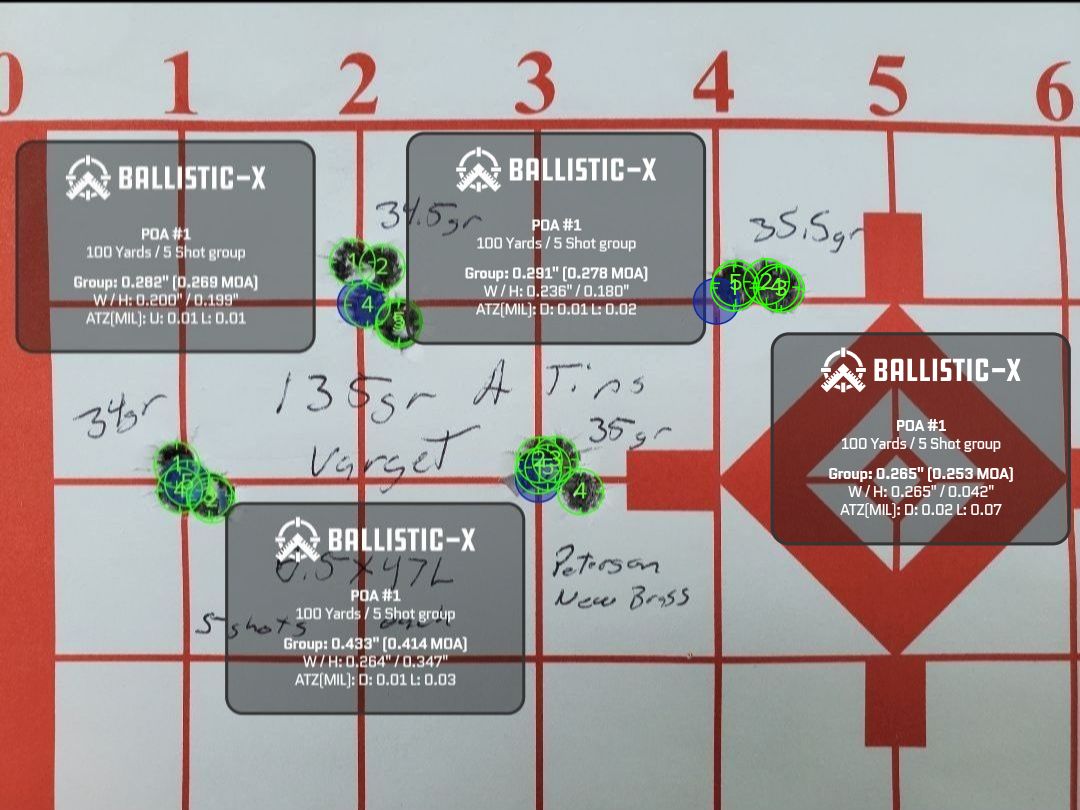

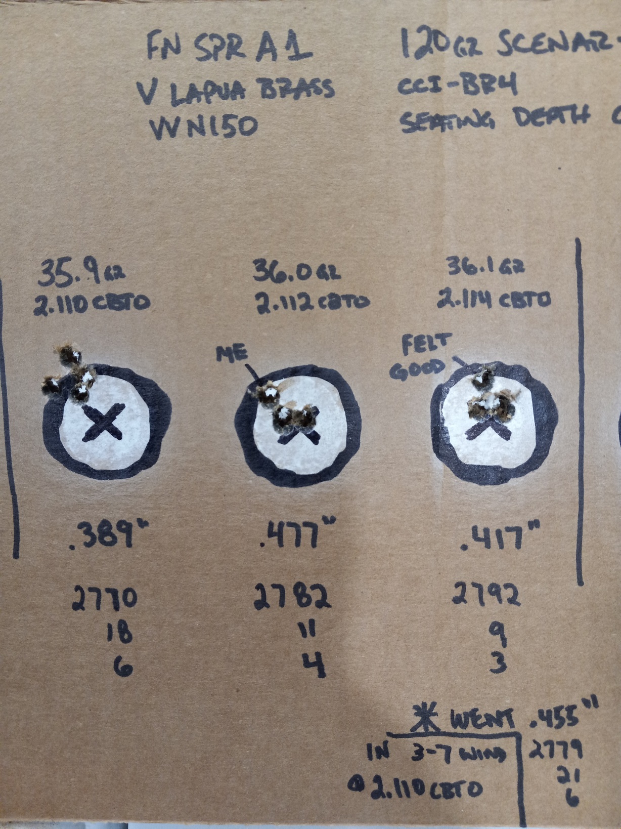

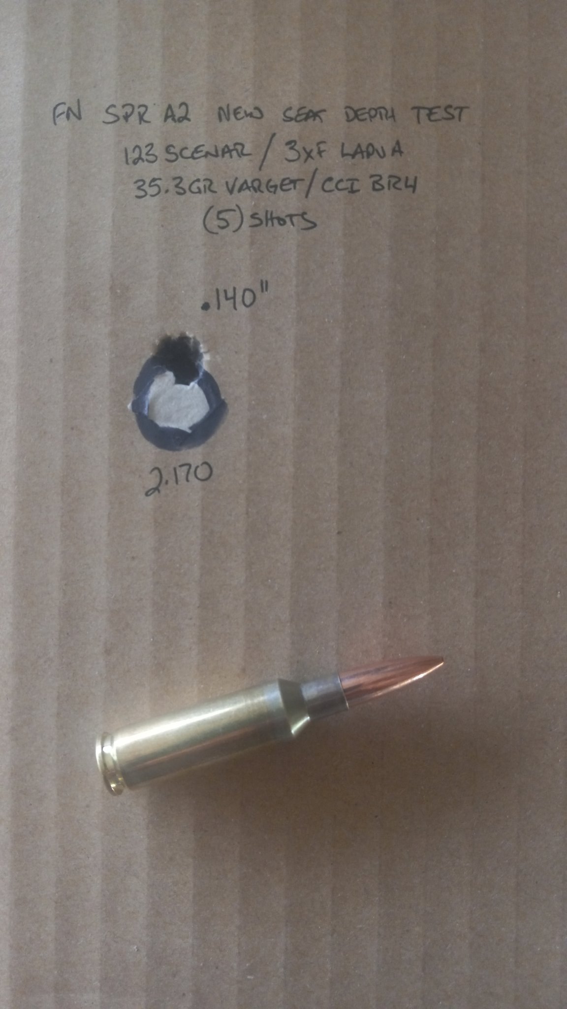

The only 120 grain bullet that I shoot in my 6.5x47 is the Nosler ballistic tip. It’s pushed with H4895 to 2910 fps. That’s my hunting load. I’ve shot thousands of the 123 Lapua Scenars pushed with RL15 to 2930 fps. Velocities are from 24-26” barrels. I tried several different powders but these worked the best for me.
I shoot the 120gr Scenar-L out of one of my 6.5x47s. I have it going a bit slower than most, but I'll need to get my firing pin bushed with the next rebarrel. If I get much hotter I get some ridiculous catering.
I don't know where the photos went on my phone, but this combo holds up well at distance too. Below I was just checking my windows of optimal seating depth and charge weights. Just five shot groups.
Reactions: Hetzer
What weight powder charge of 4895. I shoot 120smk’s out of my x47 sometimes because I have a bunch of them. I have been using Varget.
I’d hate to give that information out. That load is shot out of a well worn HH marksman barrel that is only used for hunting now. It was my first 6.5x47 barrel for competing in PRs. You will need to work up for your own safety. Probably start around 35 grains.

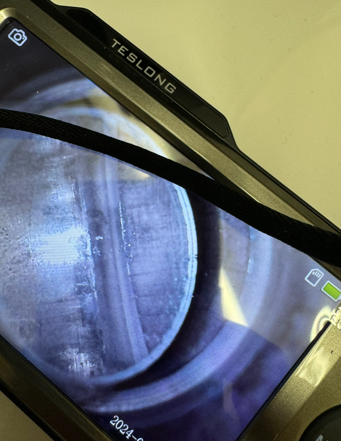

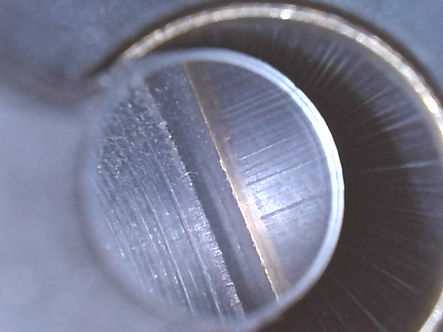

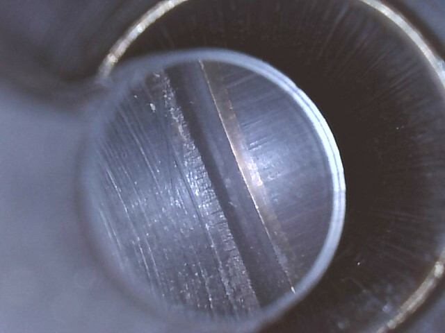

Hello again!
I've made some measurements about the space betwen the mouth of the brass and the start of the porction of the chamber for the ball.
The carbon ring area.
What are the correct space to leave for a correct expansion/delongation of the neck and prevention or minimum formation of carbon ring?
Attacched two snapshoot from the borescope.
Thanks!
Hello again!
Thanks!
Since you've chambered a piece of brass, and looked again with your borescope, let it "stretch" a little on you after firing before you trim again. You actually are fairly close right now as it is.
Trimming back to the length recommended in reloading manuals usually creates more of a gap there, while leaving your brass closer to the 'maximum case length' closes that gap a bit.
Don't forget to check that gap with your longest piece of brass each round of firing *after resizing*. You also never want to fully close that gap - because you want a little wiggle room for inconsistencies.

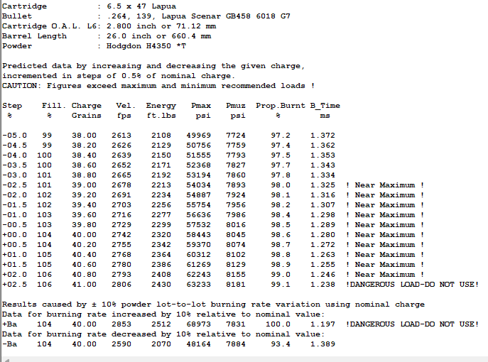

After reading topic several times and analyzing loading ELDM 140 Gr (H4350) ammunition, here's the breakdown:
1. .010 off the lands - - 2.742 COAL
2. COAL is 2.736" to 2.716"
3. COAL 2.723" (.010" off lands)
In my situation, the point of contact has a COAL of 2.825”. And the point of safe bite (longer charge, the bolt is closed 10-20 times, while the length of the charge is reduced by resting on the rifling) has a COAL of 2.914".
Hence the question. Look for pile in the jump, smaller (.010" off lands) COAL 2.815" or go far into the jump, say below 2.800" and move down? If so, at what pitch? By the book, .003" even from 2.800” to 2.700 ” will be more than 30 steps. I want to understand how to be.
So far I've gone from 2.885" to 2.805" in 0.005" increments, but couldn't repeat a consistent and good result.
I already thought that the size of COAL was too large.
I would like to understand in what size to look for +- a good result.
Update: My "go-to" load for my favorite x47 opened up to a little over half-MOA for several consecutive groups at 100 - 300. Tried seating back out another .010, and it appears to be back to normal. Looks like I'll have to stay on top of seating depth every few hundred rounds. Some guys get a depth and can keep it for the life of a barrel apparently. I got accuracy degradation at about 300 rounds with this one.
It's a picky barrel, but when you get in the window it hammers.
I'm sure a fluke group due to only 5 shots, but it typically hangs around 3/8 minute...which is all I'm good for as a shooter off a bipod and rear bag. I shot the old depth just before this and it was a .6 almost on the nose.
150 rounds down the new rebarrel from Fosnaugh Custom Rifles. A Bartlein Barrel mod400 at 25 inches and 1.20" straight no taper.
My Hornady 135 grain A-tips arrived today so I loaded up some with Varget, set the jump to .055" in brand new Peterson brass and lit them off with CCI 450's. Four groups of 5 across 2 grains averaged .303 moa 👍 thanks for a sweet shooting rig Eddie!
