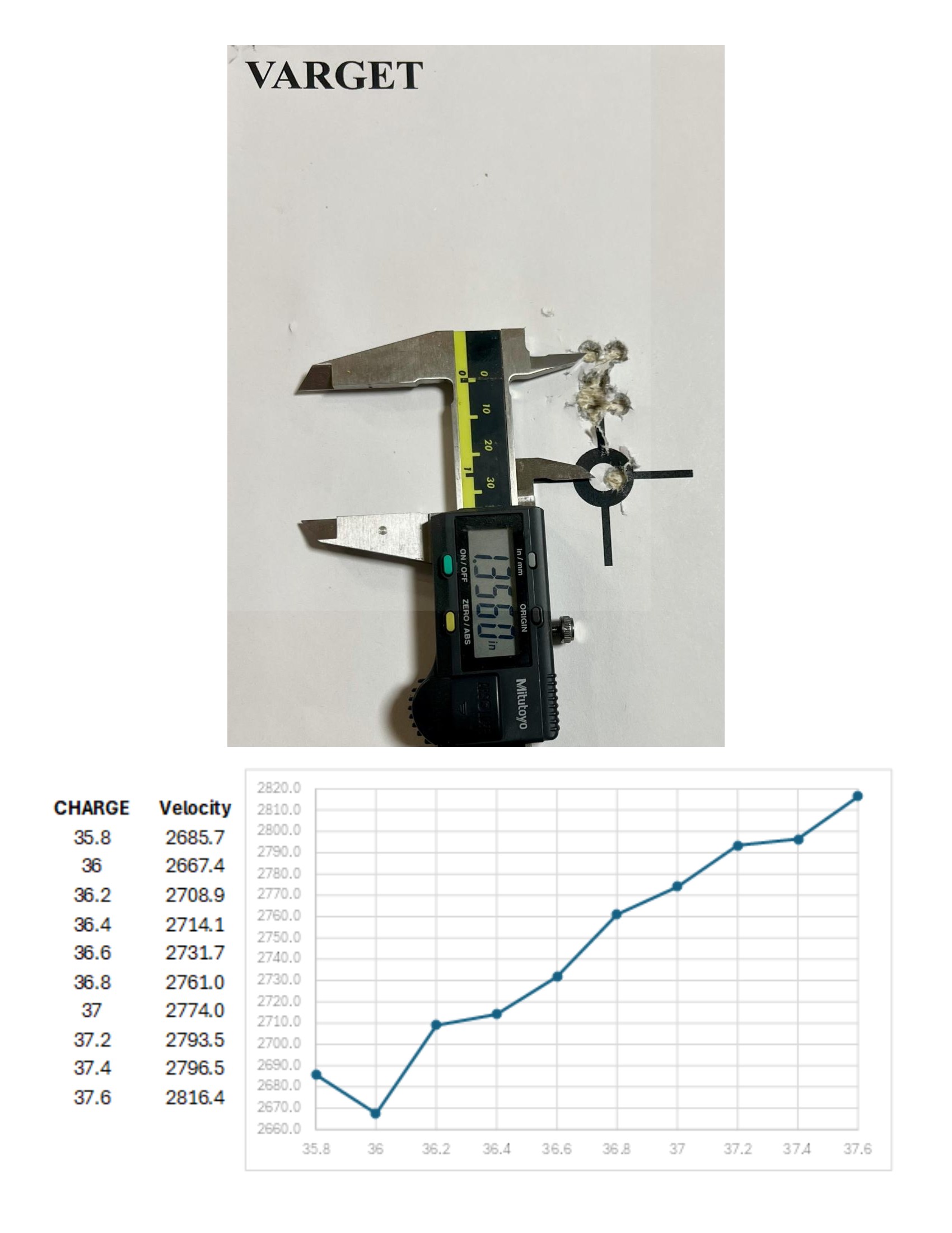

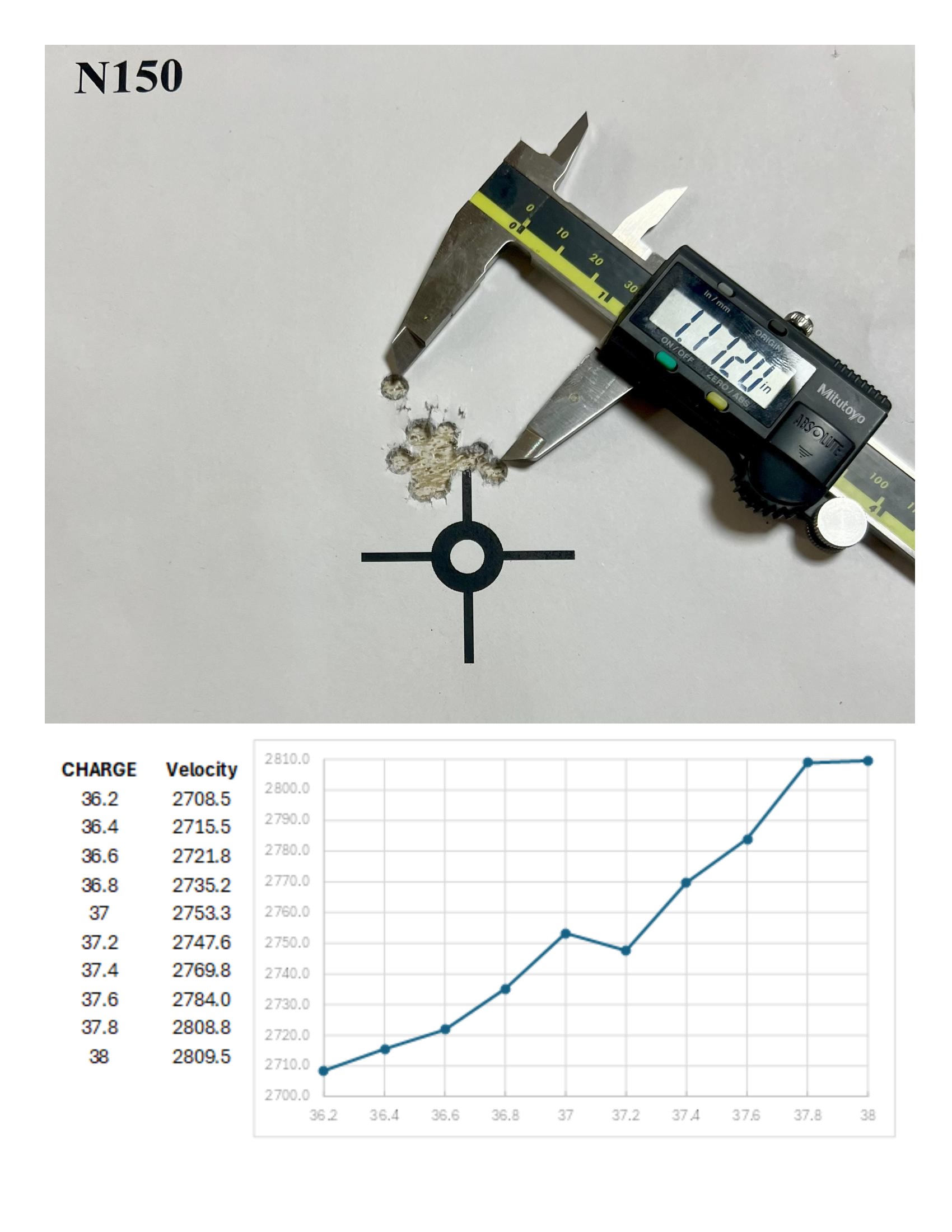

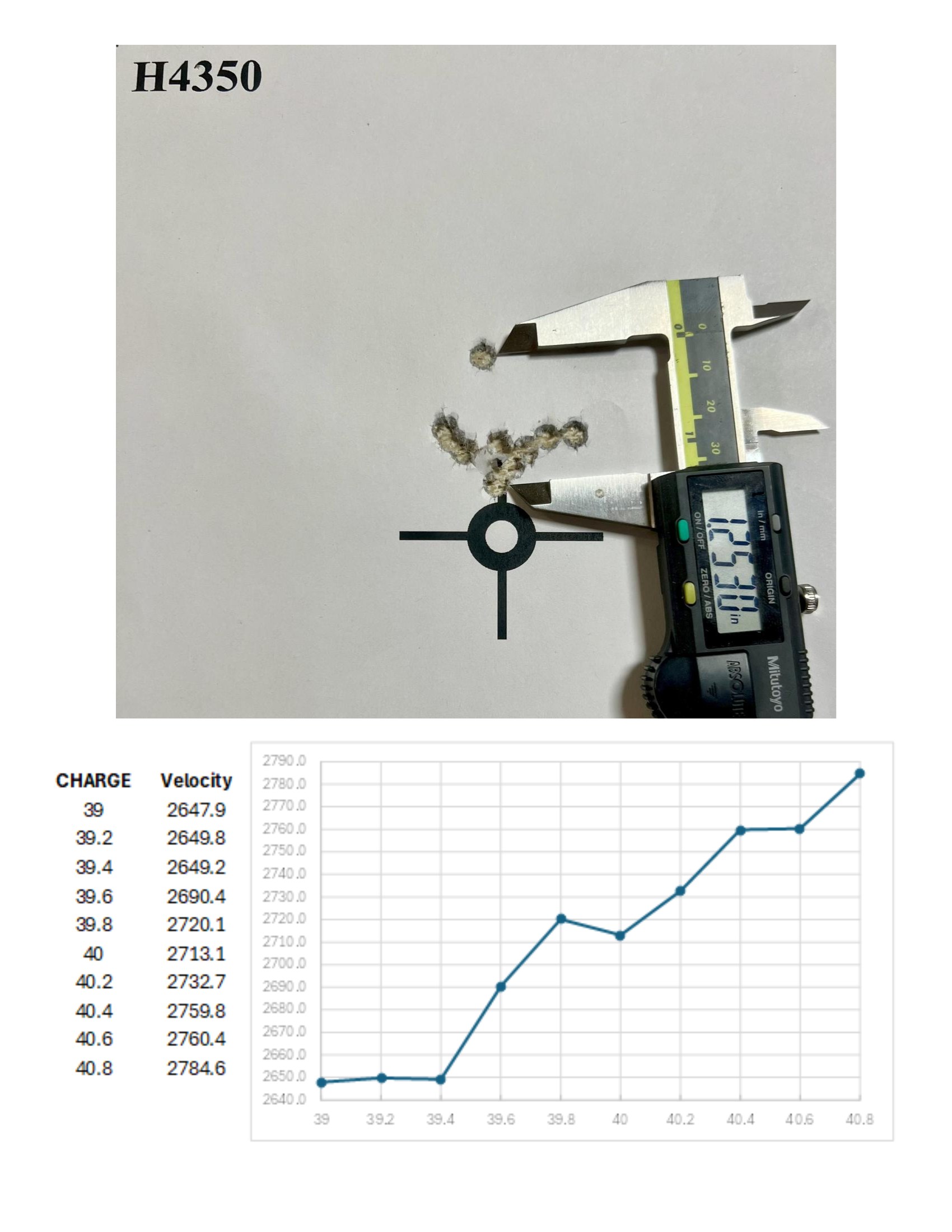

I did a test with three different powders - N150, Varget, and H4350 using Berger 130gr HVLD. I loaded up ten rounds with each powder in 0.2 grain increments. I shot one from each powder, let the barrel cool, then moved to next higher charge.
I was hoping to find a powder that was noticeably more consistent than the other two but there were not huge differences. The groups range from 1.17 to 1.36”. I was surprised they were this tight considering nearly a 2 grain spread in charge weight. I will be using the N150 to continue load development with.
That probably says more about the consistency of your barrel with the bullet than it does the powder.
N150 did well for me in one of my x47Ls.
Possibly. I have seen similar tests though where there are significant differences between the powders. One might group 1” and the others are 3-4”
Everything is going to be on an 'individual' basis. I've had examples of barrels that loved/hated certain bullets or powders. Usually with those the other variable played significantly less of a role in consistency/accuracy.
The only exception is that through (3) 6.5 barrels now, I can't get the 130gr SMK to shoot worth a damn, regardless of powder... which is surprising because that bullet is a laser for other members.
If your x47L is groups 3-4" something is very wrong, I dont care what powder it is.
I have shot tons of H4350, IMR4451, Varget, 4166, 8208 and others in my x47L barrels and they ALL hammer. So consistently accurate, its hard to pick a charge weight because all the groups are small and the same POI and low SD's... All the x47L barrels Ive had, were Bartlein, Krieger, Mullerworks, Rock Creek Cut rifled... Stupid accurate.
