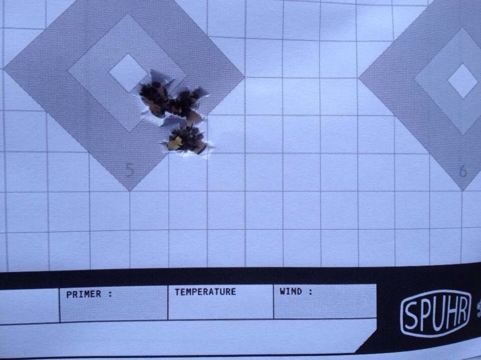

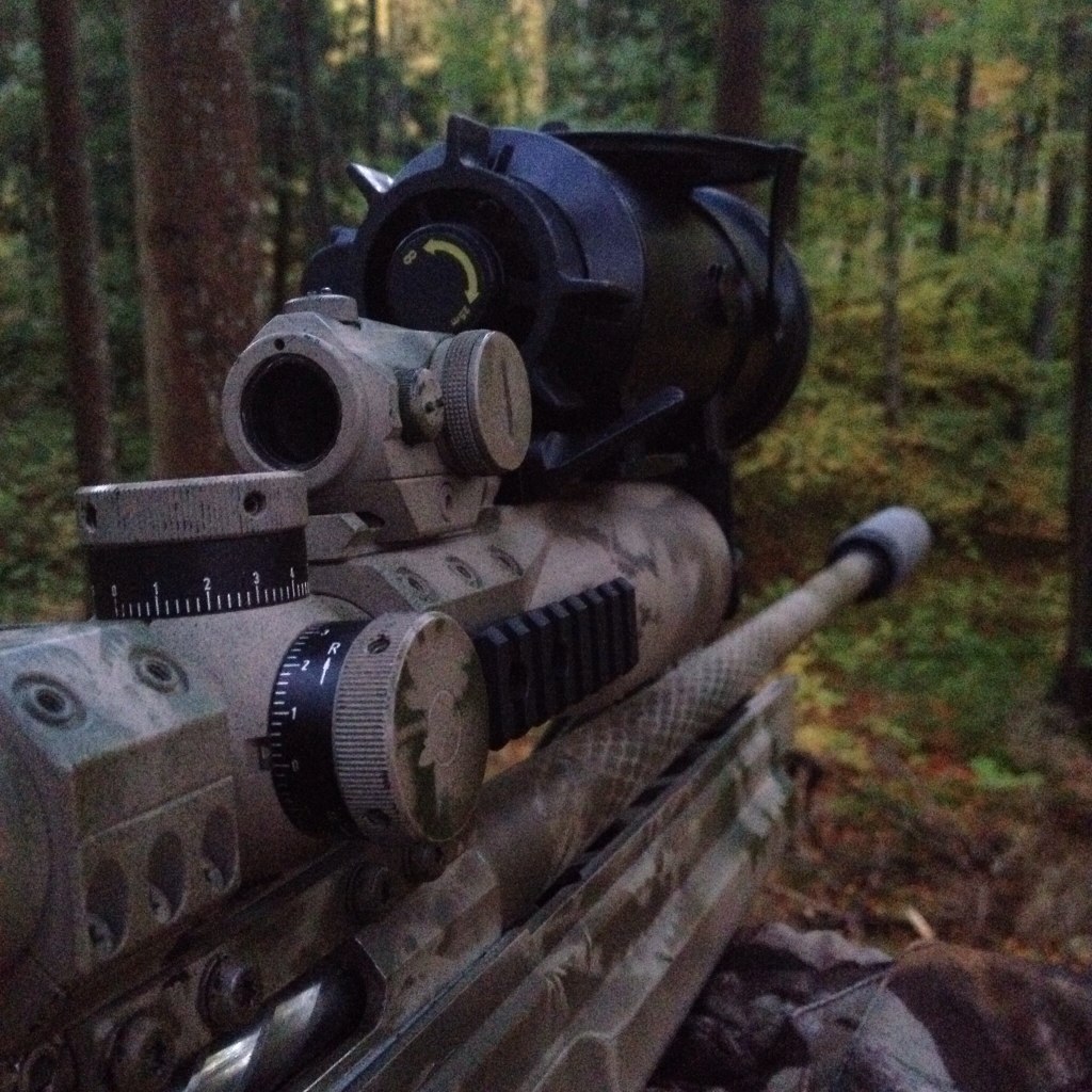

As i live in Sweden the access to low priced high quality 6,5 ammo makes the 6,5 a must!
I am both using standard and AI 40 degree and have shoot out a number Of barrels with them both.
First AI barrel i had was 24" lilja and I used to shoot 140 gr bullets at 3150 and 85 gr af 3770.....
That barrel had a rather short barrellife....
Now i am using 24" barrel with 130-140 bullets at 3000fps and barrellife seems to be up to 4000 rounds in Tikka original barrel.

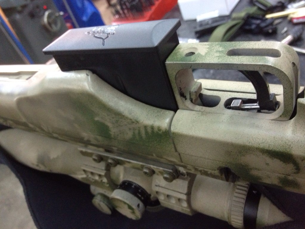

I'm wondering what kind of chassis options there would be for the 6.5x55 and also if it is gonna be possible to get a custom LA with .750 bolt diameter with a standard bolt face...just in case you'd want to go up to 300WM with and extra bolt. Any answers for that gents?
That's gonna be sick! I wanna see that when you're done. I would like to do this in either a cadex, JAE, or AIAX. It's gonna be a complete new build for me, so I guess it's time to start window shopping. I'm hoping to get a defiance LA for it tho. What twist is gonna be most beneficial...I'm leaning towards 1/8
Layton: thanks! I'm new to this caliber completely and could use all the help I can get. I've always stuck to the NATO caliber a and now am trying to venture out a bit. It seems as tho this choice has a great balance between competition and practical use...without breaking the bank on components or having to wait forever or beg borrow or steal for them. I'm just hoping of putting this all together in a very modern package that I'm use to shooting behind...ie the chassis option with magazine fed capabilities.
