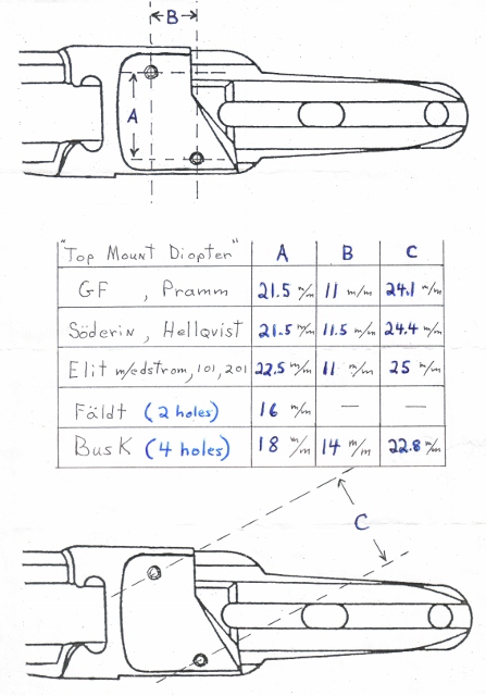

If I may ask, what peep sights are you running on these and how hard is it to install a set?
