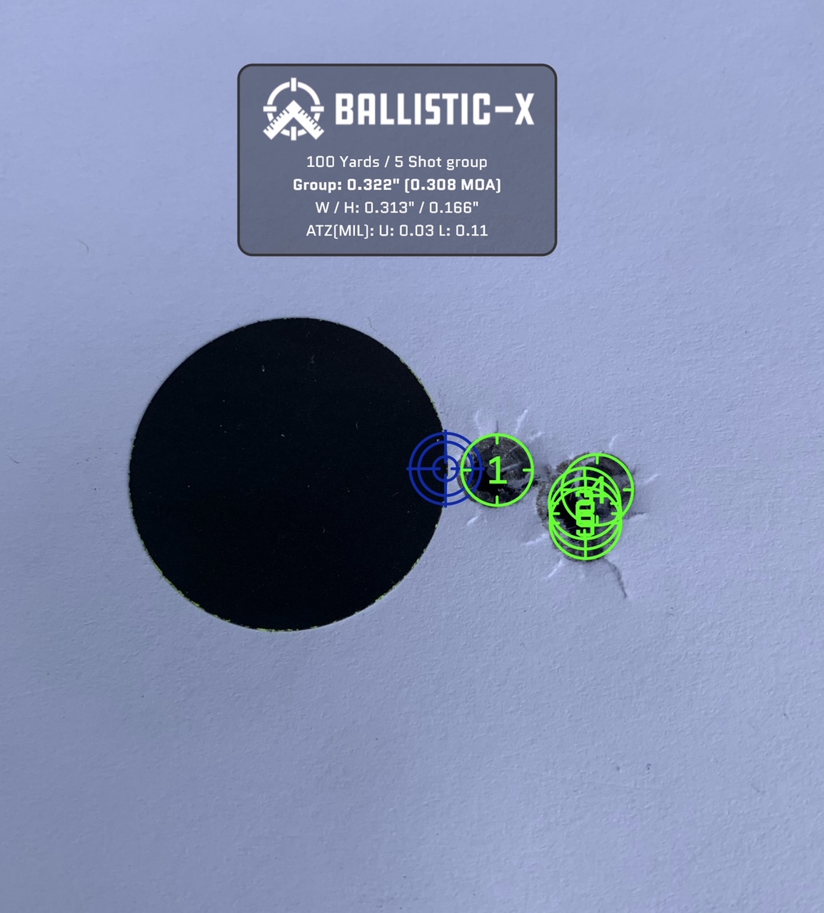

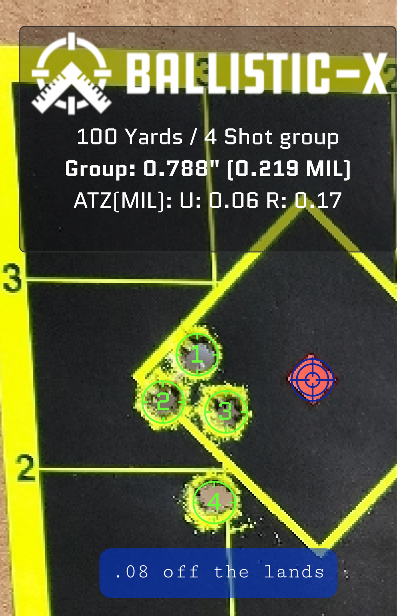

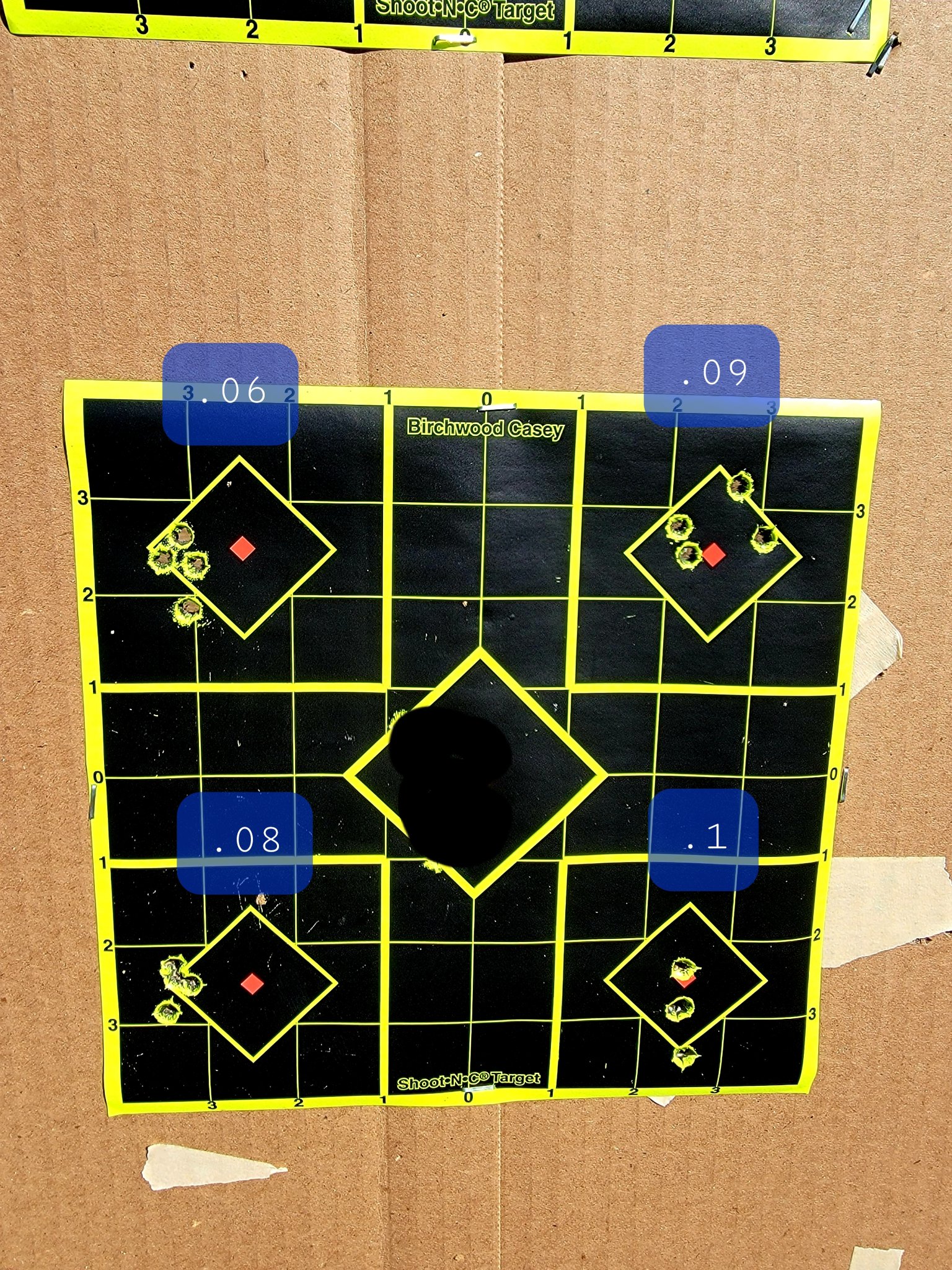

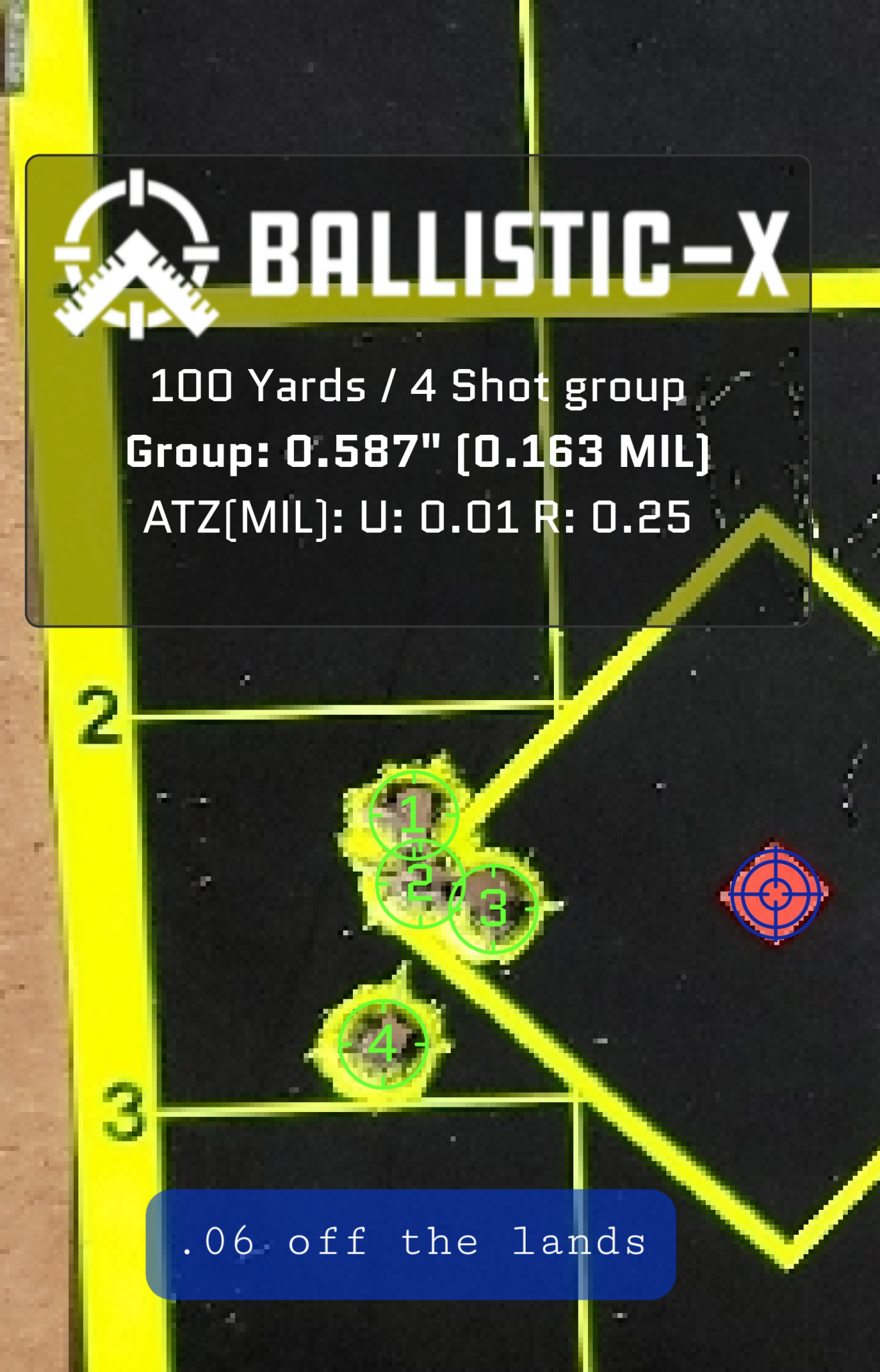

So I took my rifle out for load development today with the 112 match burners. I shot at .06, .08, .09, .1 and .12 off the lands.
Origin action
proof 6mm CM 1/7.5 26"
KRG bravo
Lupua brass(new). Used a 21st century neck mandrel on them.
CCI 450
H4350 40.5 grn for the groups shot. Shame on me, but that is not the charge weight I am going to use. I was trying to do all of my load development last week but only got the ladder shot due to poor ( windy) shooting conditions. After the ladder test I picked 41.0 grn and I checked that today as well. When I tested a 5 shot group today with the 41.0 load I got an ES of 7, at an average of 3034 fps.
Here are my groups. The.06 and .08 were the best. The first 3 on the .6 group were that tight bunch and I threw that last shot low. The .08 group was good. I don't know that I consciously threw that flyer, but it looks decent without it. They did not shoot well at all at .09. I was really thought the .1 group was going to be magic. The first two shots were almost in the same hole. Right after that second shot my target stand blew over and I took about a 20 min break between the first 2 and last 2 shots since I had to wait on the range to go cold so I could fix my target.
I wish I would have shot qt .07 because I think there is a node between.06 and .08. I am going to caveat this all with the fact that I am newish to bolt gun shooting and probably not the best shot. I was shooting prone off the ground with a bipod and a bag.
  • Ballistic-X-Export-2021-03-20 12:13:30.247484.png
  • Ballistic-X-Export-2021-03-20 12:16:27.797110.png
I think you might be right. Regardless you should check it since if there is a small group range between .06 and .08 then that will make your load more tolerant to jump changes as the barrel wears.
Without changing anything else, I would load 0.06, 0.07 and 0.08, and shoot 5-shot groups of each.
Or, another way to go would be to load in .005 increments (not overkill) and load 0.06 through 0.08 and shoot three shots each.
Either way, you get more statistical confidence because you are firing more rounds.
At the risk of sounding preachy...
Focus hard on doing everything the same way every time. Same hand position, same bipod preload with the shoulder (unless you are shooting free recoil), same trigger pull, same breathing, and stay relaxed. Take your time, and if something does not feel right, stop, reset, and start over. That will help prevent flyers.
Also if you have parallax adjustment, CHECK YOUR PARALLAX! Do not depend on the distance markings on the adjuster since they are frequently wrong. Adjust the parallax until when you make very, very tiny left-right and up-down movements with your head, the crosshairs and the target move together. After you do this a few times you will get the hang of it and it will become easy.
That ES is excellent. I say you found your load, and you did it with a high quality, very temp stable powder.
Reactions: freeflyingchris

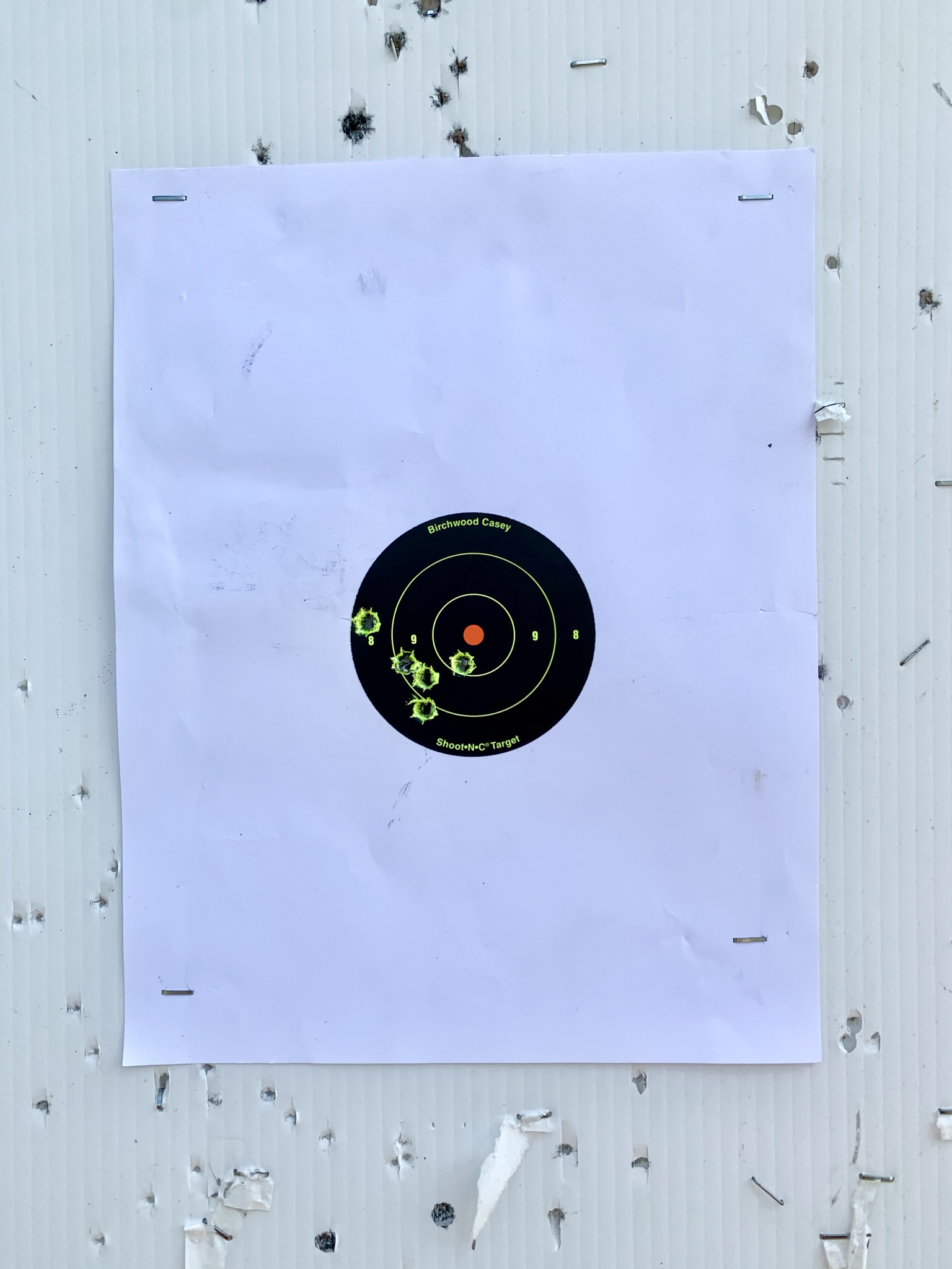

Origin action
KRG bravo
CCI 450
I agree with above in that you might need to double check your parallax... those groups look a lot like ones I used to see before I got in the habit of checking it lol.
Plus, JMHO here, but if the red dots were really your aim points, then you might need a better (calmer) day to really see what you've got going on. It's tough to figure things out when the wind is pushing you an inch or more off at 100yrds, been there too lol. I like to be as confident as I can possibly be in my zero, so I try to set it on a good/calm day if I can, and then I verify it on good days to make sure nothing changes.
Looks promising though in that .060-.100" jump-range, and an ES of 7 is excellent.
Looking at the pics though, at .100" the windage looks great, vertical not so much, with an ES of 7 it probably shouldn't look like that and give you that much vertical stringing in close (if it's just parallax, which it kind of looks like, those holes might've been on top of each other)... you might want to load up a few more and revisit .100-.120" to see if there's something nice there (without the target falling down and an unscheduled "intermission" bahahaha).

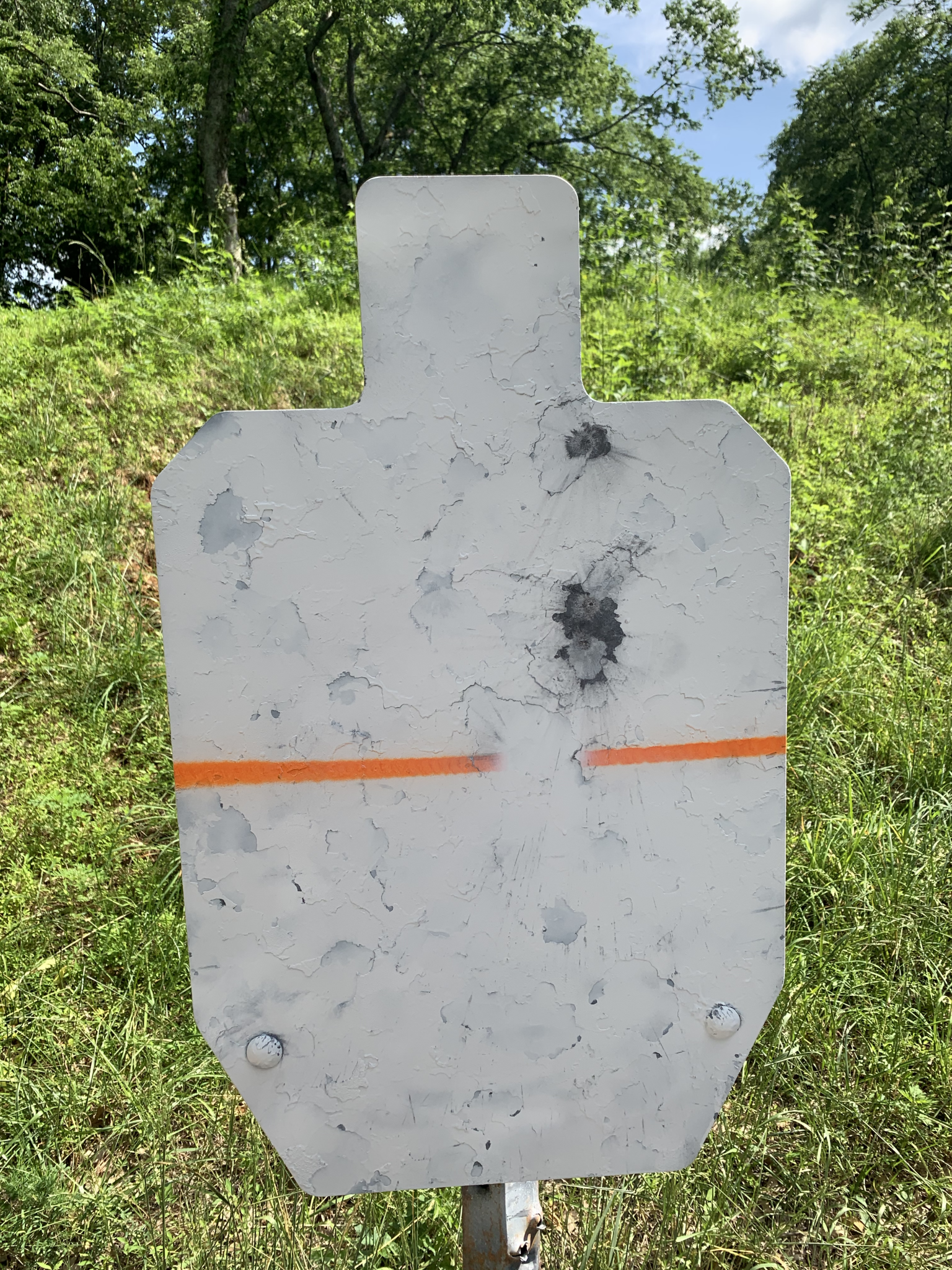

I shot exactly one group at 100 then went straight to fun and steel at 400 because I was sick of load development shit, I'll take it out past 1000 hopefully this week. My bullet-jump still seems to be working, somewhere between .100-.120" of jump, no idea where the lands are and don't care. Felt like I pulled one... ;-)

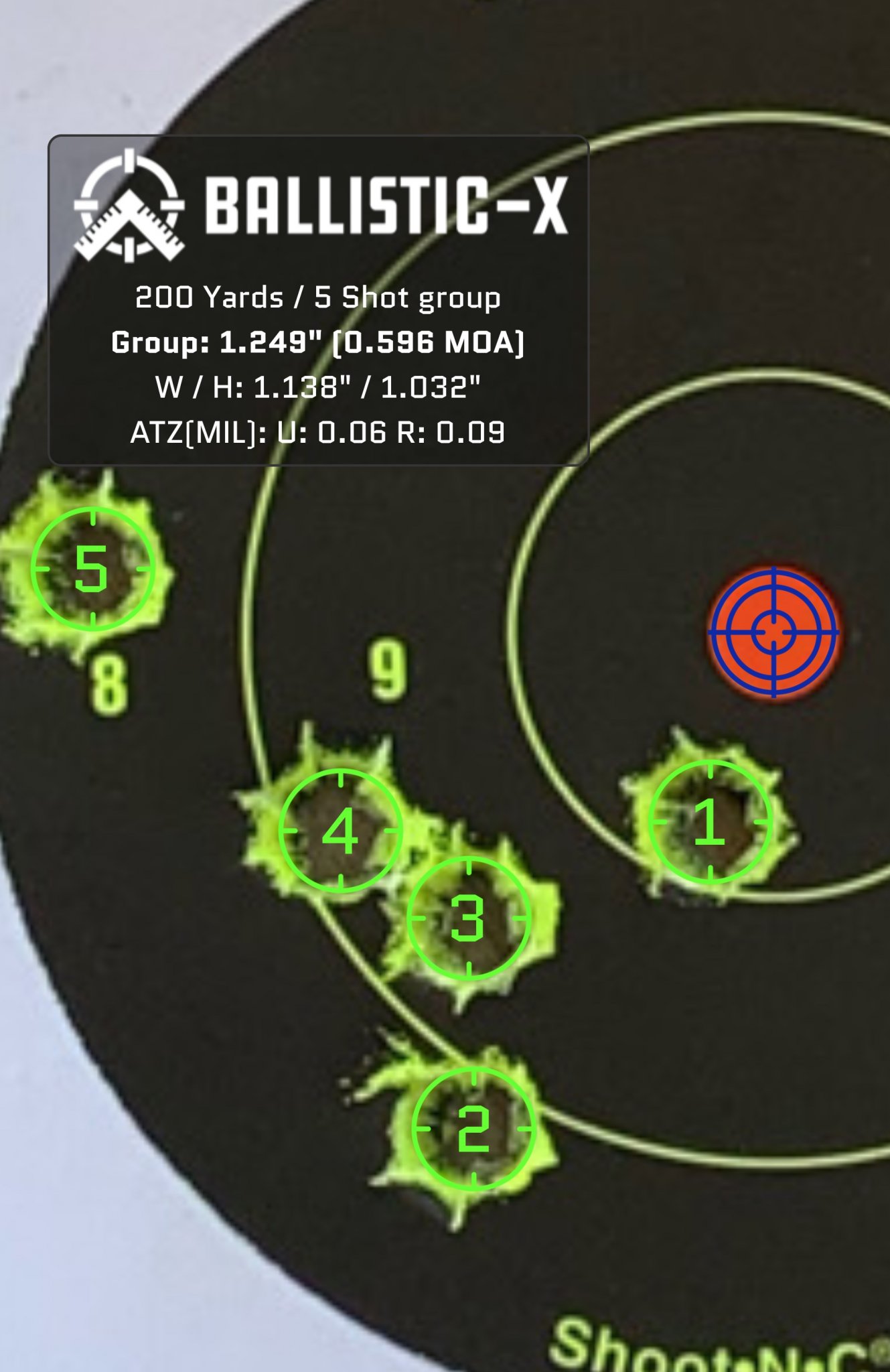

Ballistic-X-Export-2021-04-17 11:22:47.862724.jpg

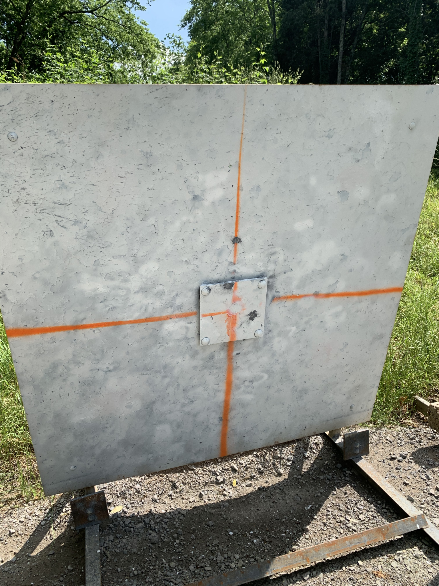

Wanted to update the thread now that my barrel has somewhere around ~700rds on it since I had posted about the load development for it a couple months ago...

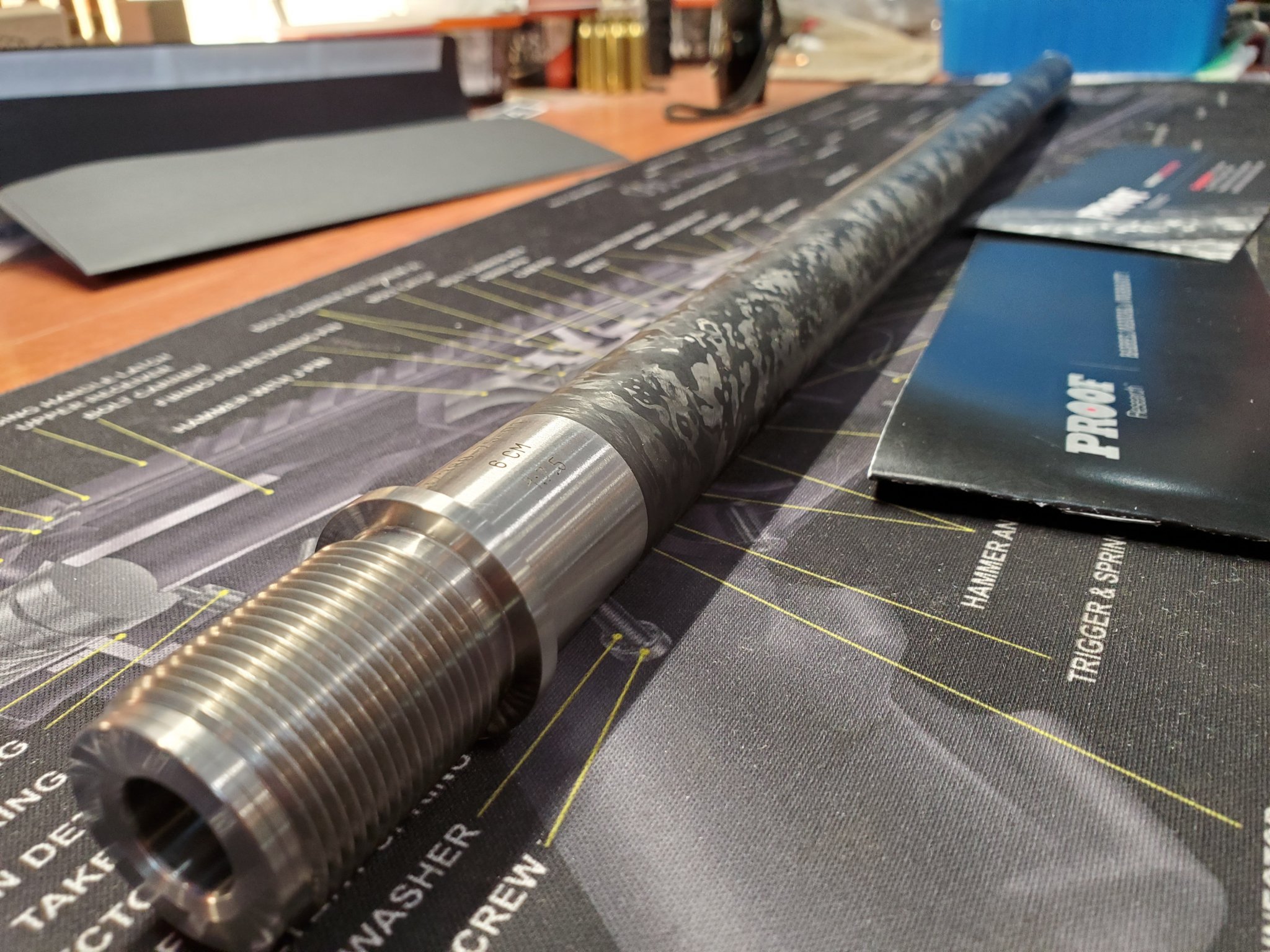

FWIW/TLDR, I used a fairly unconventional method: no barrel break-in whatsoever, no OCW nonsense, found my bullet-jump range first, then picked a speed second (then picked a slower speed because summer). Traditionally, it'd be powder followed by seating depth, nope.
Didn't go anywhere near the lands and didn't want to, found a jump range of 0.080-0.120" off-jam that looked good (0.100" looked great) and haven't touched it since (for me it's the same CBTO 2.215" as at the start).
I don't know exactly how much the throat has eroded and don't care as it's given me no reason to measure it. I don't have a borescope (and don't want one thanks, too OCD to have that kind of torture around), but I have shined a bright ass Surefire in there and the throat looks freaking great!
I also did something that might sound a little odd to some in that I stuck with what is considered a longish SAAMI 0.183" freebore. Based on how the throat looks and how the gun is shooting I've pretty much decided I'm going to go to an even longer 0.200" or longer freebore next time I order a barrel (I've already got a second copy spun up of the one I'm shooting now, which hammers, so that's fine).
Why longer freebore? Well because instead of 6CM meaning a short ~1500rds of barrel life: I think with a reasonable powder charge, longer freebore, and a healthy bullet-jump, we're looking at more like 2000+ maybe even 2500rds before a barrel is KIA. My super complicated theory is: the further away the throat is from the fire, the slower it cooks, and since I already know my gun shoots good with 0.080" of jump and great with a 0.100" jump, instead of starting at 0.080" and cooking/eroding until 0.100", why not just start at .100" and stay there longer.

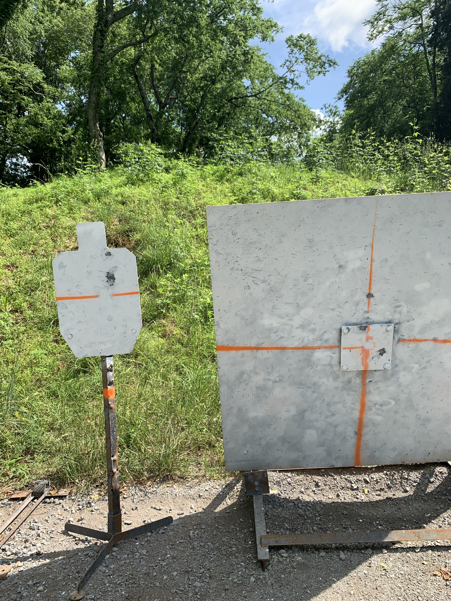

OK, so how's the barrel working? I haven't shot a single group at anything closer than 500yrds in like a month, and today I decided to check my speed over the chrono for 5 rounds. I shoot all my chrono rounds right into the berm/dirt and never put up a target, but someone left a target up on the 100yrd zeroing board at our range and it just happened to be right in line with my chrono so I picked an orange dot and casually lined it up each time as I fired my rounds. I shot all 5 rounds at only 6X power on the scope (so I could avoid shooting my chrono)... I should've taken a picture, but, it was one fucking hole, couldn't do better if I tried.
This is 7 rounds off bipod/bag at 1250yrds, 3 on the big plate, 4 on the IPSC (2 on top of each other). I'd say it's still shooting ok.
I'm going to update the thread periodically as things go, see how long I go before I have to adjust my seating depth (IF I ever even need to), and how long it goes before it dies, etc.

If those Proof barrels are SAAMI freebore I'd guess you're somewhere in the ~.020" off-jam neighborhood at 2.844"?
I haven't touched mine and I know it's jumping a mile (I was ~.080" off-jam 600rds ago) but the rifle has just been hammering... Super consistent at distance and think the only thing that keeps me from keeping all the holes touching at 100 is me.
...wanted to add: I think I'm going to try to break the habit of using 100 yard groups as the absolute defining metric to make load decisions. I've been thinking about it and I believe there comes a point where one's group size at 100 isn't really telling you anything.
I mean we all have good days and bad days, and some of us (like me) kind of suck a shooting groups sometimes (and maybe don't really care to practice much at getting better at it when it's way more fun to do other stuff). And I just feel like sometimes there's only so much that can be gleaned from one's 100yrd groups anyways, because it's not like we fire them in a lab with the gun locked in a mechanical rest and fired remotely in perfect conditions, there are just so many other variables in play.
I think aside from initial load work-up, if I'm going to shoot paper, from now on I think I'm going to get in the habit of shooting at 200yrds more, not just for keeping tabs on how my rifle/load is shooting, but just as better and more interesting marksmanship practice. Still close enough to where wind isn't really much of a factor, but I feel like it's far enough where I'm not going to be bummed when the first two rounds aren't touching or whatever, and it'll actually be a better distance to make a better judgment on what the gun/load is capable of vs what the shooter is capable of... I feel like we probably don't compare what we get at 100 with what we get at 200 nearly enough.

I'm totally doing the 200yrd group thing this week sometime. I'm going to try to remember to shoot a couple groups at 200 and/or 300 on paper each outing instead of just hitting steel. Better practice, still get to keep tabs on the load/gun.

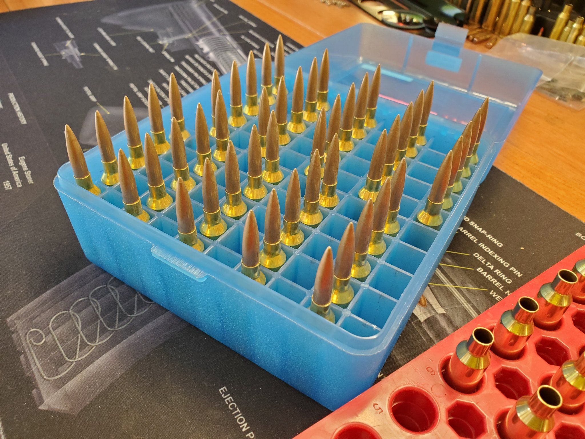

Loaded up 30 rounds.
Stuck with 41.2 grains of H4350 in resized Lapua 6 Creed Small Rifle Primer Brass. Berger 109 LRHT.
Had to up the G1 BC to .584 from advertised .568 for AB solver to line up in Vortex Fury 5000 AB app.
Getting my sd/es down a little more each time a load some rounds up. Here are the numbers for the 30 today measured over a Labrador.View attachment 7645844
That's about as good as it gets. sick.
Went out to the farm today to true up BC at 600 yard steel.

Those are some great numbers, but how does it shoot? I've had some loads that shoot 1 hole groups with 20+ SDs and others that looked like a shotgun 00 pattern with single digit SD's. Also with a Labradar. So I'm not 100% convinced that low SD's are the end-all, be-all of load dev.
Only did one group on paper to confirm zero before going out to steel to true up BC. But, it’s shooting decent. Not quite as tight as the last trip out but I did have a whole pot of coffee before this and had just done several hours of bush hogging in the Alabama heat lol View attachment 7645882
That's enough to tell you what you need to know. I'd say they're going where you want, and if it wasn't windy you need to come over a click. (y)
