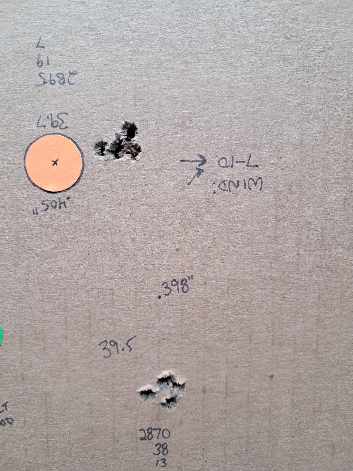

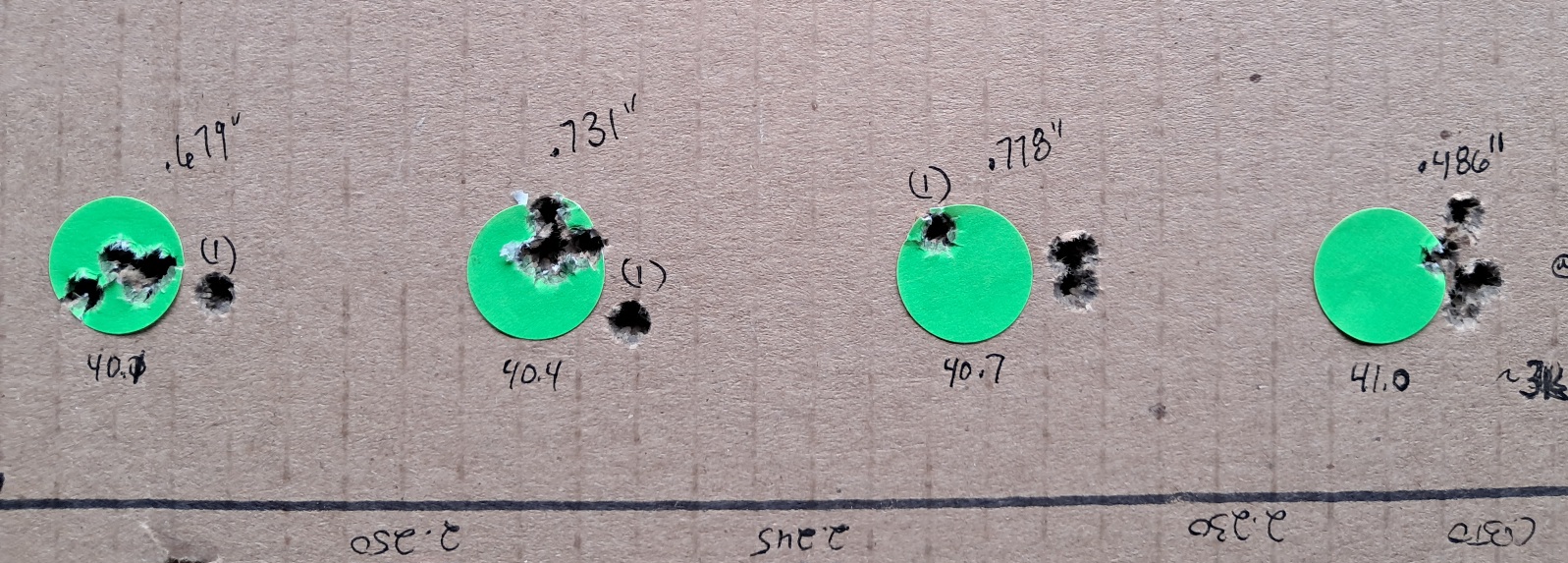

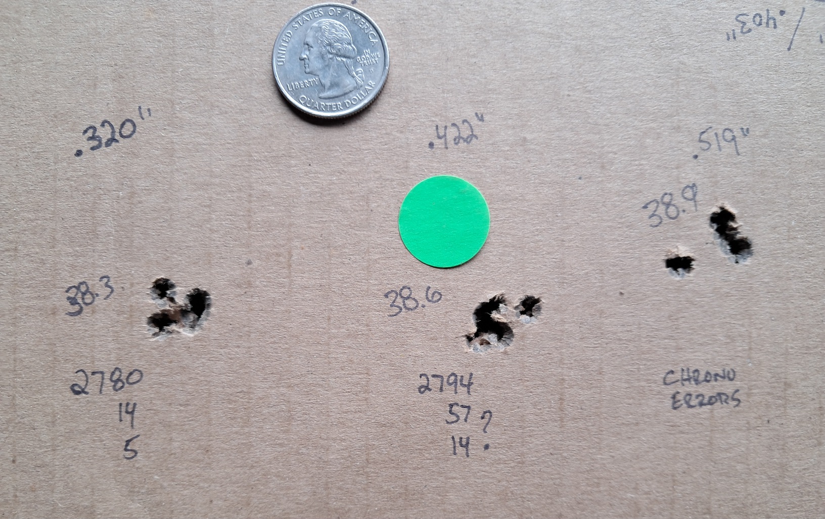

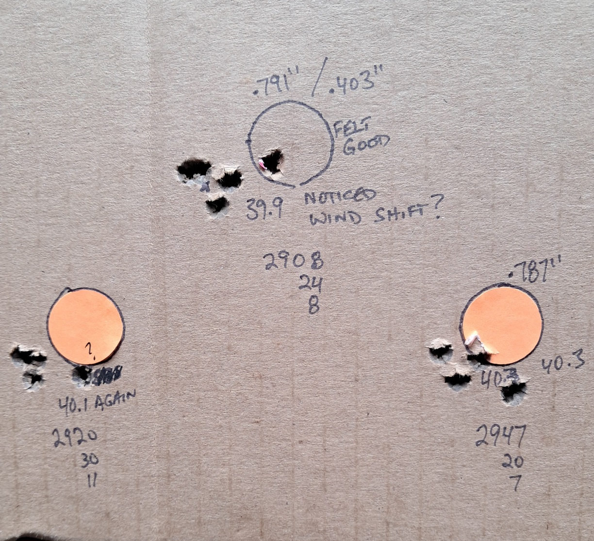

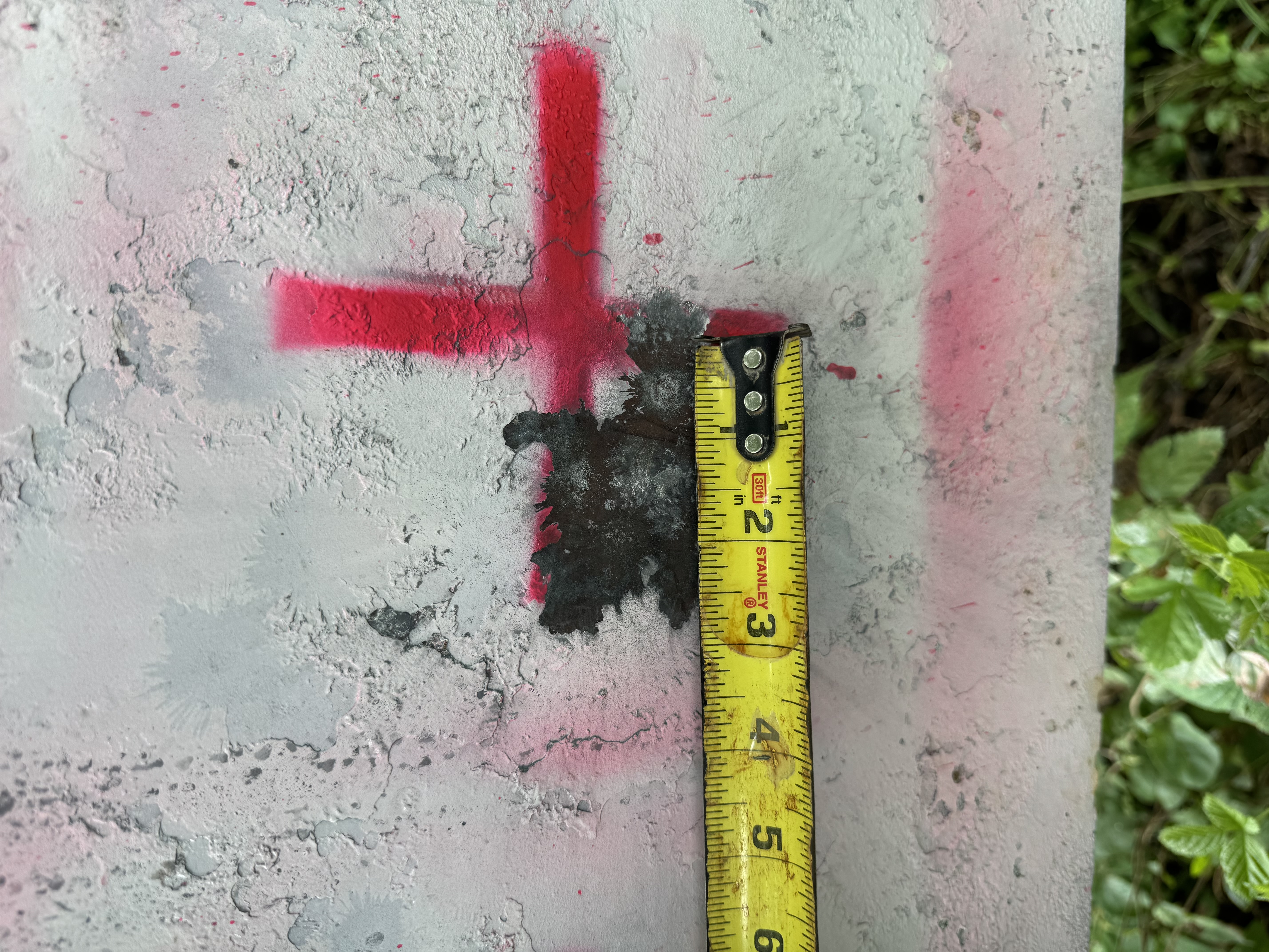

Just photos with data to provide more info to that 108gr ELD-M / H4350 load. My apologies, I didn't provide much data before.
Starting load, went a bit too conservative but the accuracy was there. Some stickers blew off after the fact in the wind. I also don't think my chronograph was giving velocity errors, I think I was just in a crap node. (5 shot groups only)
Velocity climbing up, but still not what I wanted in ES/SD. Accuracy still as good as I can shoot.
Then I got worried about pressure (zero need), and narrowed the weights. Here's where every group kicked one out. This trend continued until (4) kicked out, and by 41.0 the POI had shifted completely.
So finally back under half-minute, I decided I'd screw with seating depth just a touch.
^ At 2.250 I kicked two out, so there's the outer limit of my depth. The wind was pretty rough too.
Right now, I'm going to load back in the middle of the seating depth range and try a few more at distance to see if they hold up. If they do, I'm calling it done.
41.0 gave me 3,012 FPS.

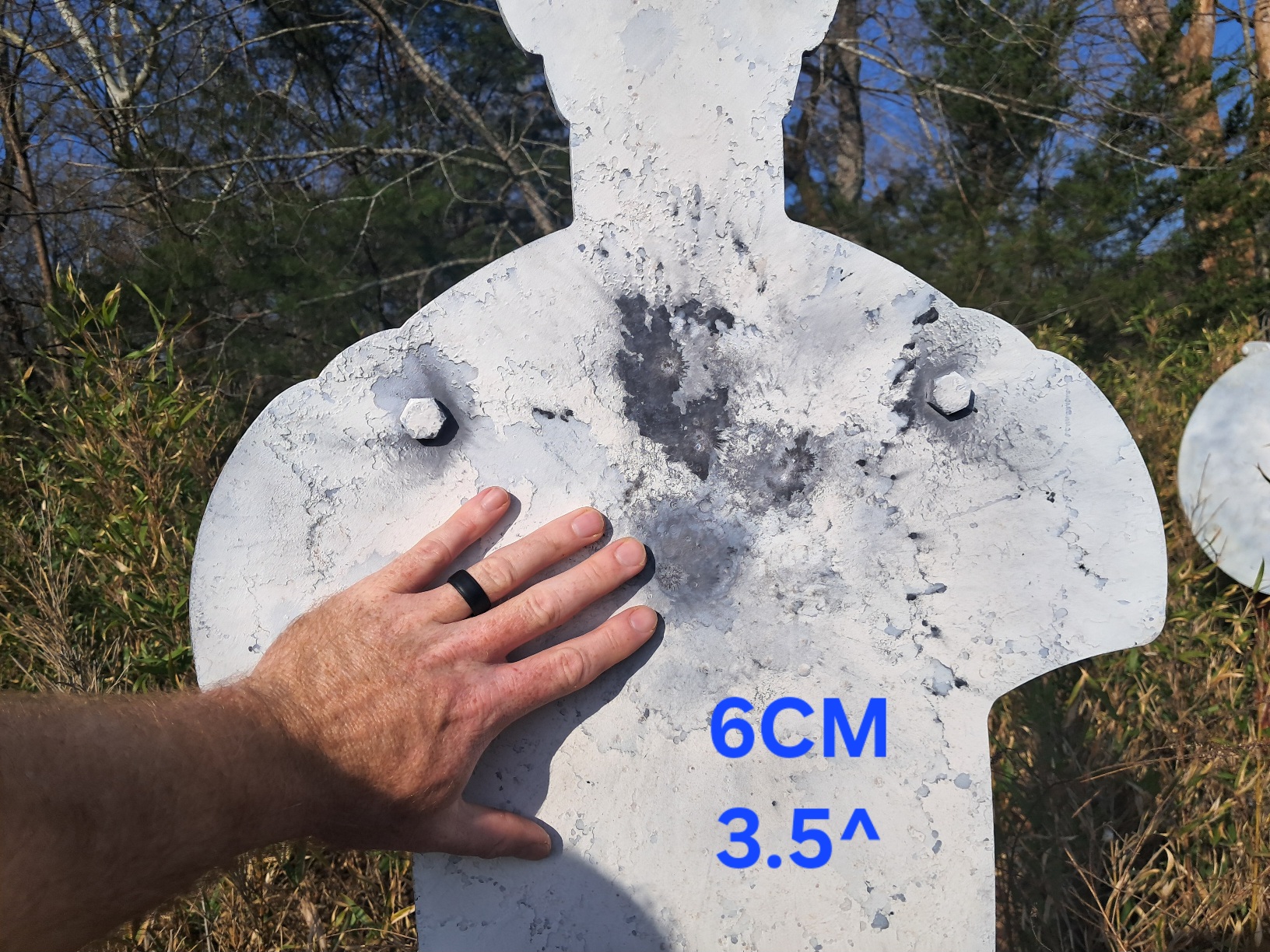

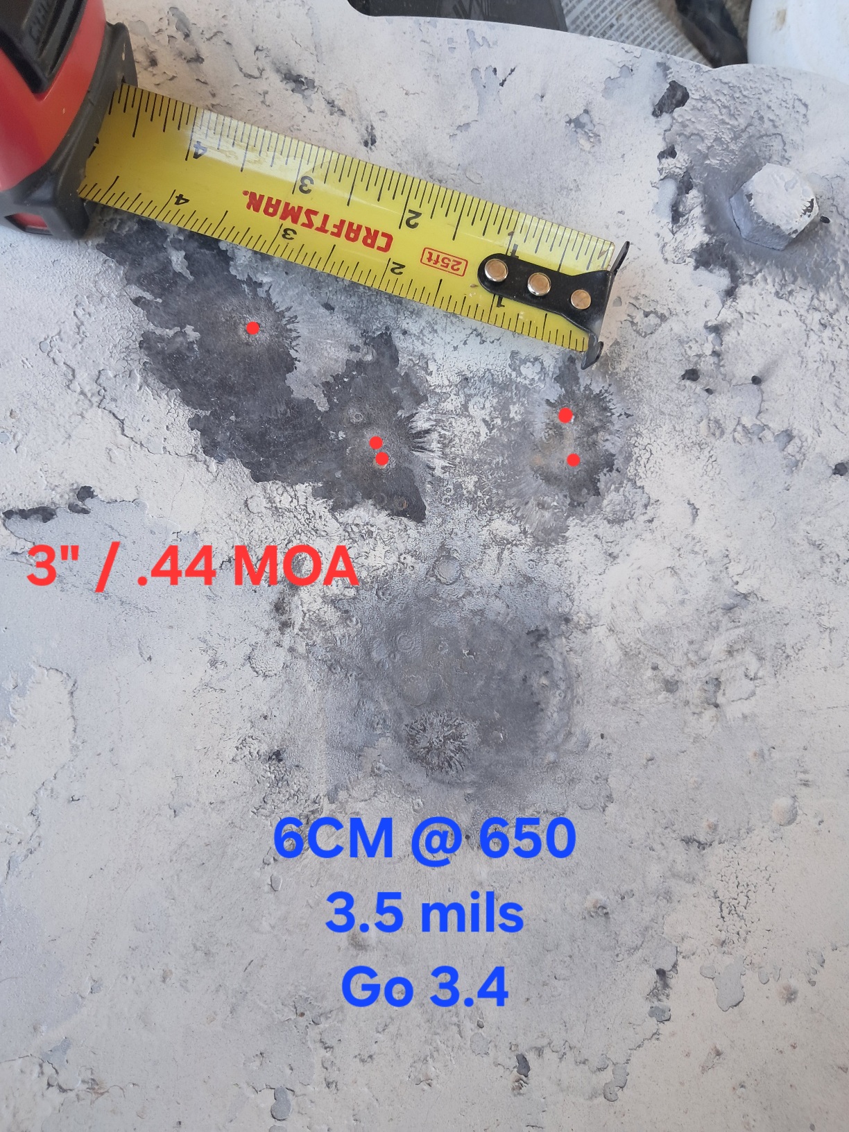

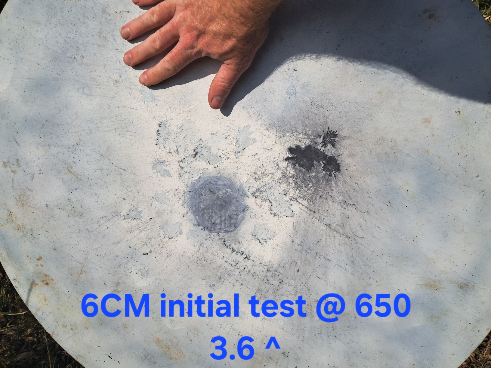

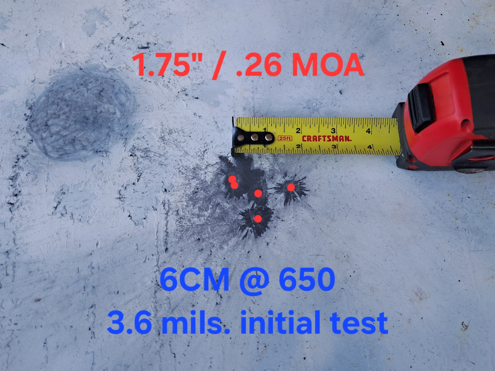

Guess I'll have to stop being a cheap-ass and buy a decent chronograph. My old faithful still works, but it is an optical, and I routinely have to add about 20-25 FPS to match my drop when I go from 100 to 650 (because the chronograph is about 15' from the muzzle).
However, this time it looks like I gained about 40-50 FPS. Trued velocity at 650 on Thursday, and it that puts my load at about 3,060 FPS.
I'll probably never duplicate the initial 5-shot group, but I'm still pretty happy about the follow-up group too. The load comfortably shoots in the .4s up close when I shoot my old man Fudd 5 shot groups.
108gr ELD-M
1xF Peterson brass
CCI 450
41.0gr H4350
2.235 CBTO
26" Bartlein, 1:7.25

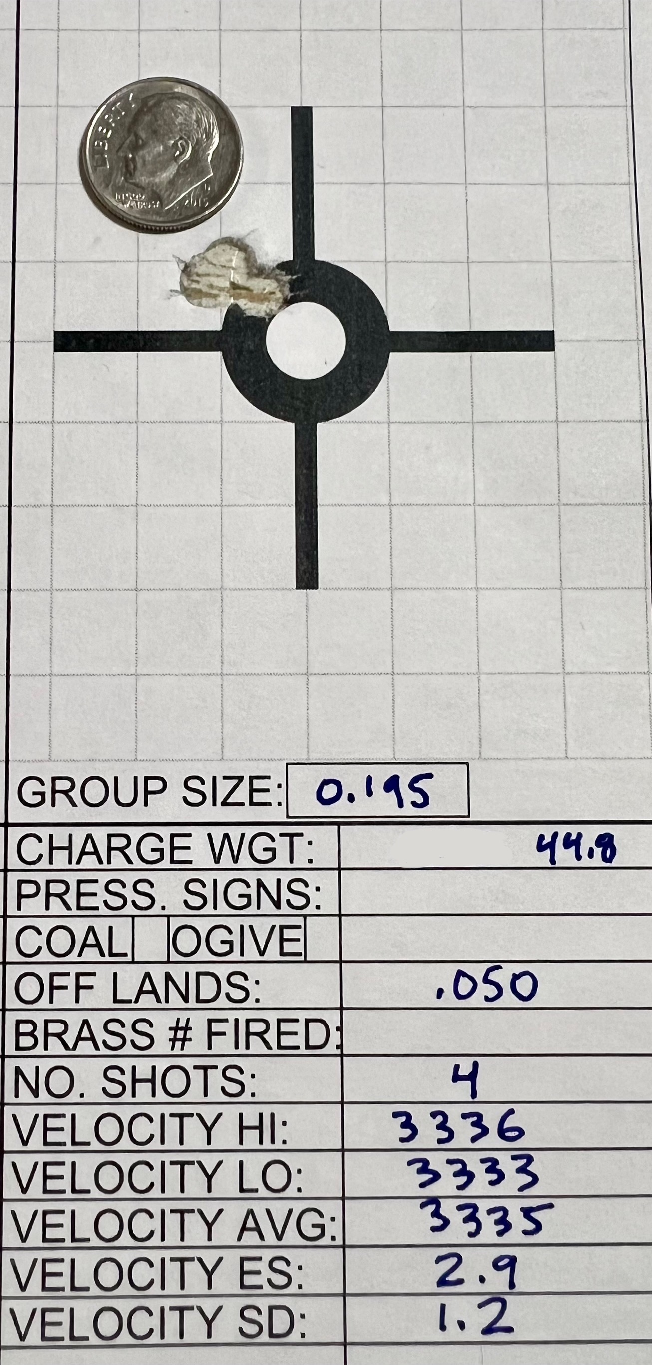

Worked up a coyote load today. 87gr VMAX, 44.8 gr H4350, Alpha brass, Fed 205 primers.
3,335 FPS, 2.9 ES, 1.2 SD. 24” Proof CF barrel.

Wow, 3,335 is screaming.
I wouldn't worry too much about the barrel's hatred for the ELD-VT. Sometimes there's just a wild incompatibility. I have an AI barrel that'll shoot the 140 ELD-M into clovers...but I tried the 130 SMK and it became a 2 MOA rifle at best.

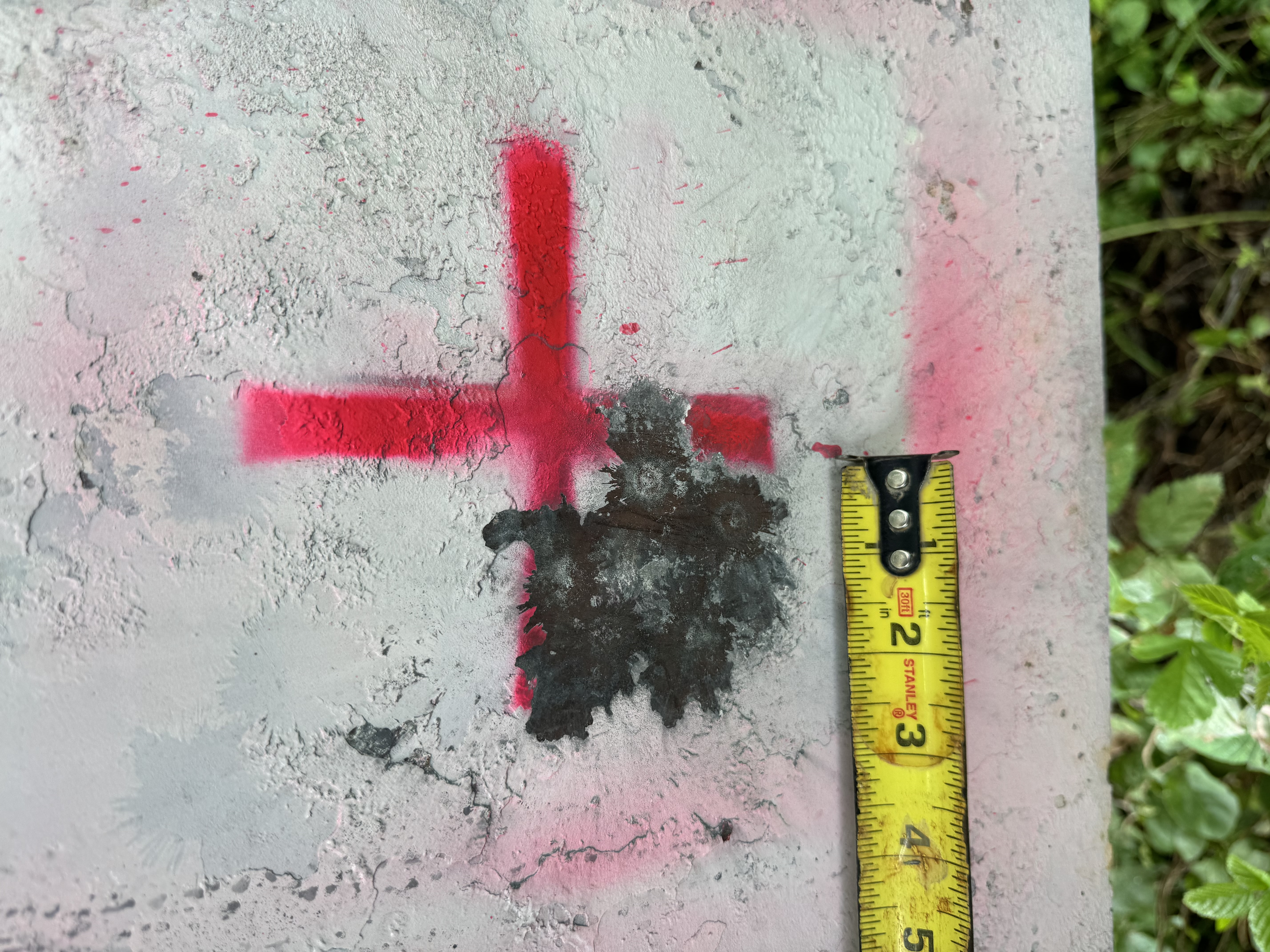

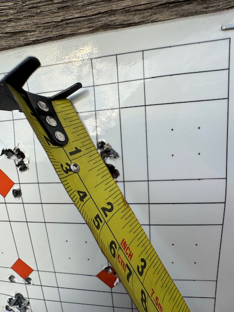

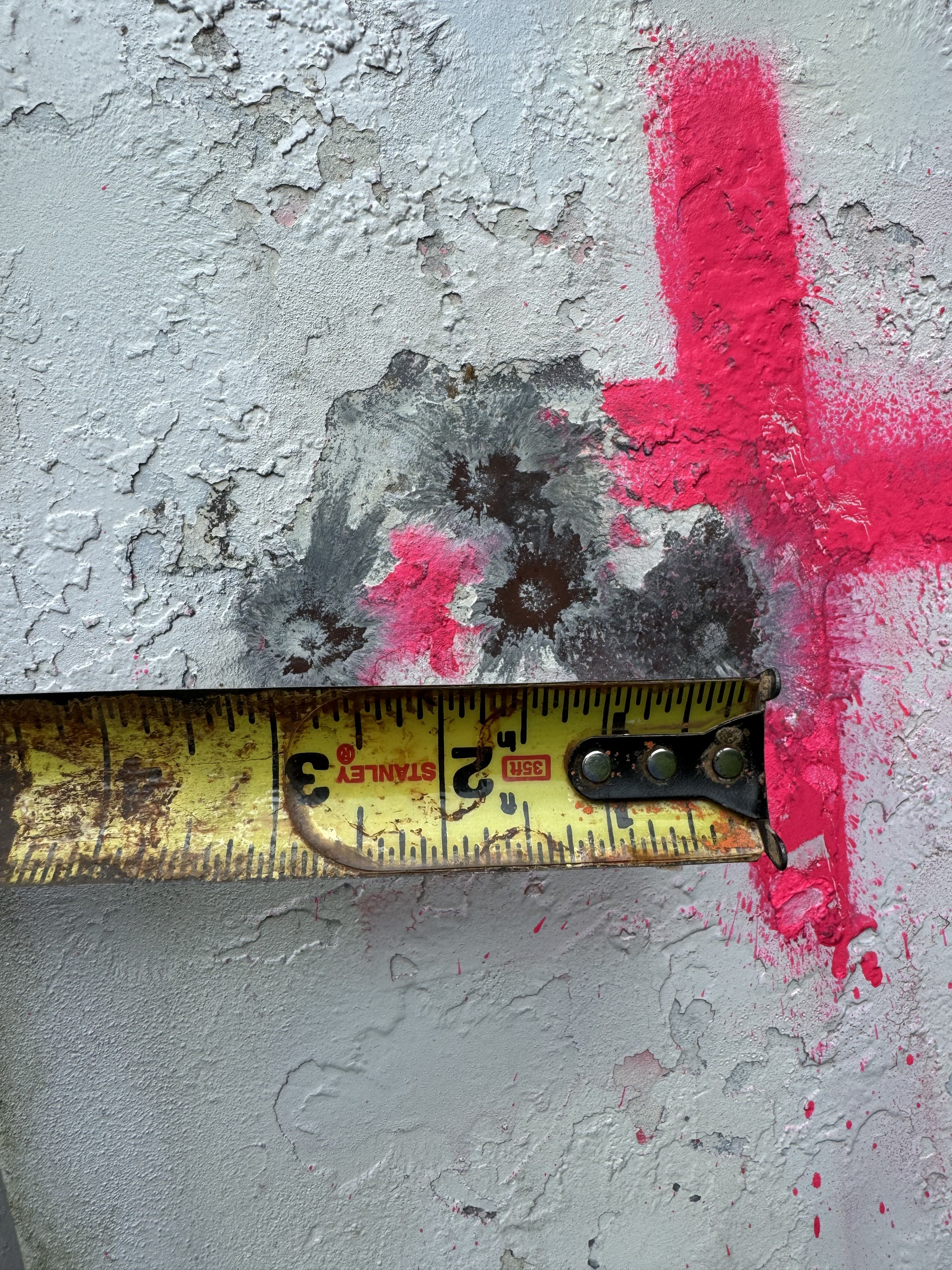

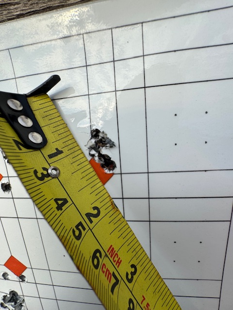

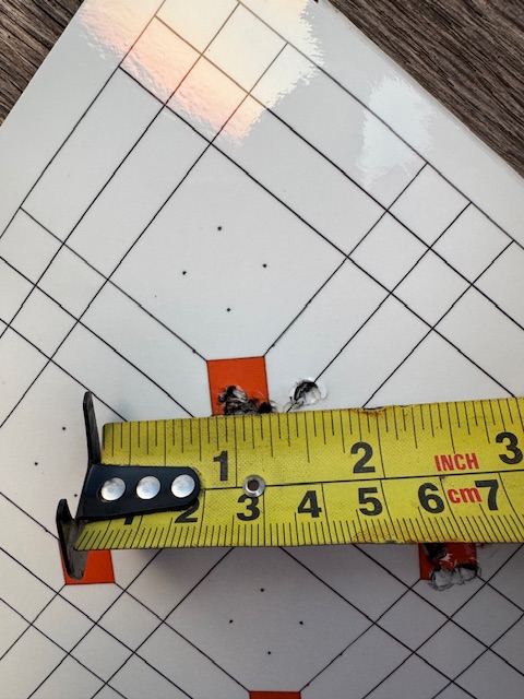

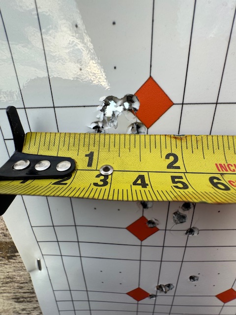

This is the first lightweight fluted hunting barrel I’ve used, it’s only 3lbs at 24” long. It seems to get 3 tight shots, and 1-2 fliers every time. The groups were a tad better with 105 hybrids vs the hunters, but the difference was small.
First 2 pics are elite hunters, second 2 pics are hybrids. It may just be all this barrel can offer. It’ll still kill a coyote, but the comp barrels I’ve got in 6 creed are definitely tighter groups.
I’m going to try the elite hunters is one of the comp guns tomorrow, and see how they do in comparison.
