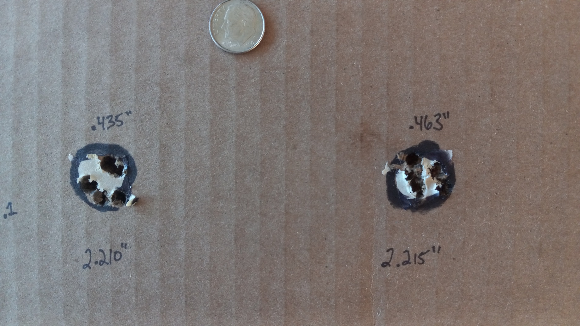

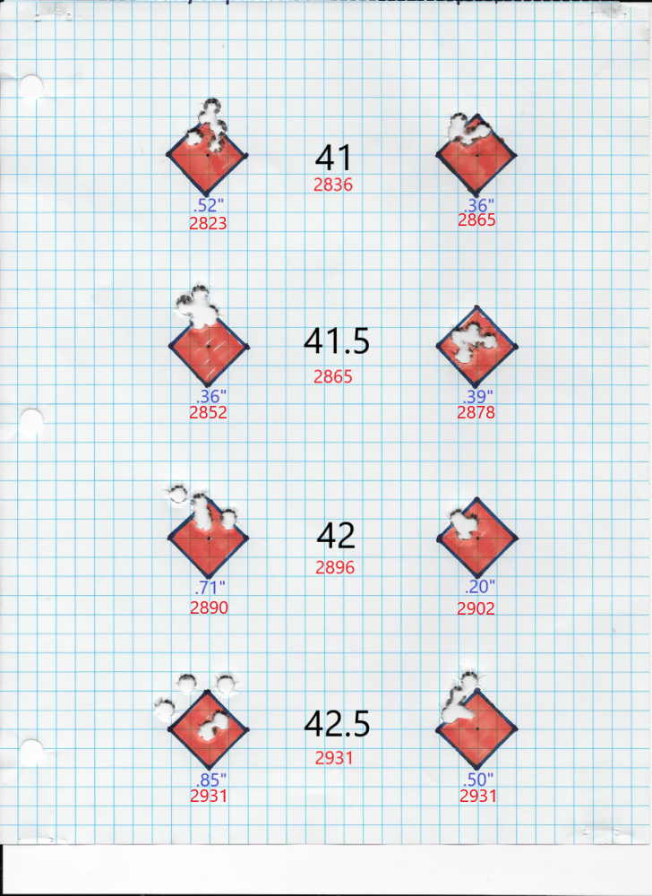

Guess I got it as good as it will go for the 107 SMK / H4350 in this barrel (26", 1:7.25 Bartlein). I had two distinct plateaus in velocity for groups (not a single shot). I usually don't believe in that stuff, but this barrel has shown it enough that I'm starting to drink the "flat spot" kool-aid * in this barrel.
I beat myself about the head and neck trying to get good accuracy out of that slightly higher charge weight. 1/2 - 3/4 MOA...no better or worse.
Loaded back down to the more promising charge weight that gave good results earlier. I did not do as well as last time, but I had more wind today too (excuses, excuses). Loaded one last group and shot it at 300...it held up rather well in the wind. Guess I'm done.

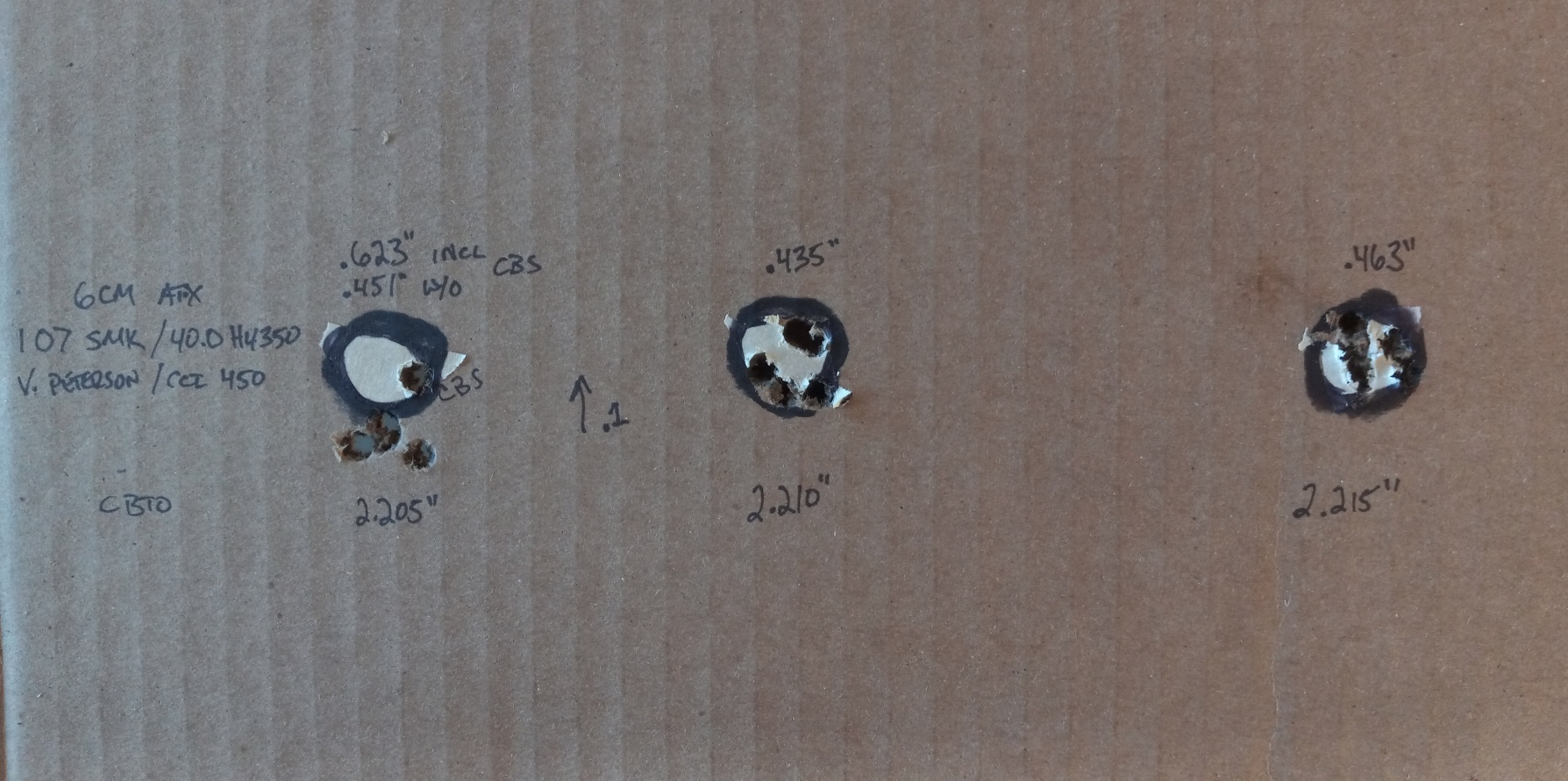

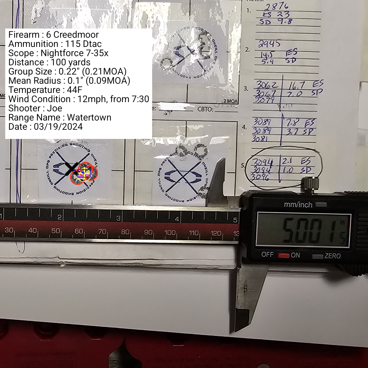

Today's tests:
I tried to move the dime far enough away that somebody wouldn't think I was trying to cover anything. 😉
Whole target:

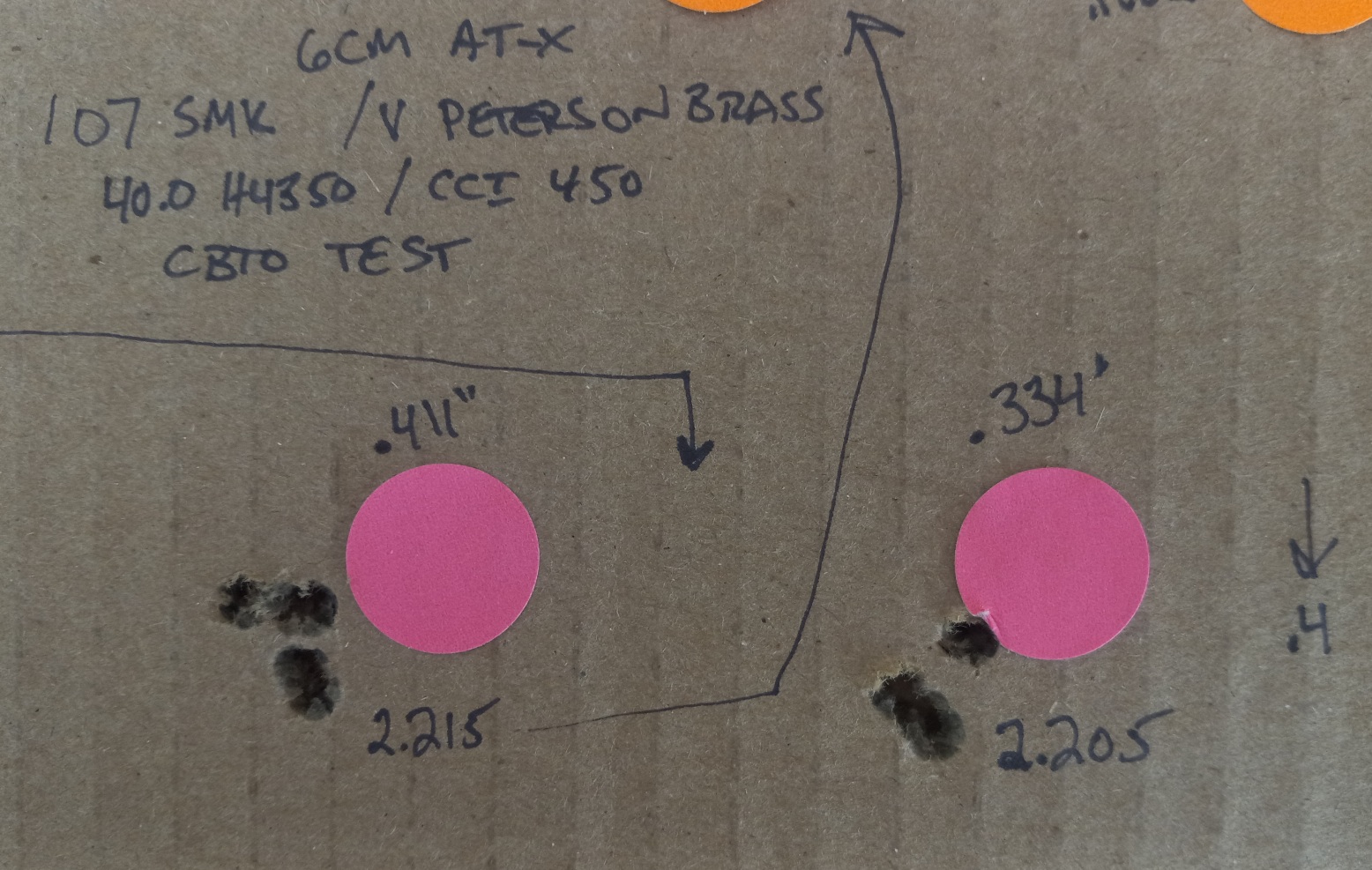

What I was trying to duplicate and failed:

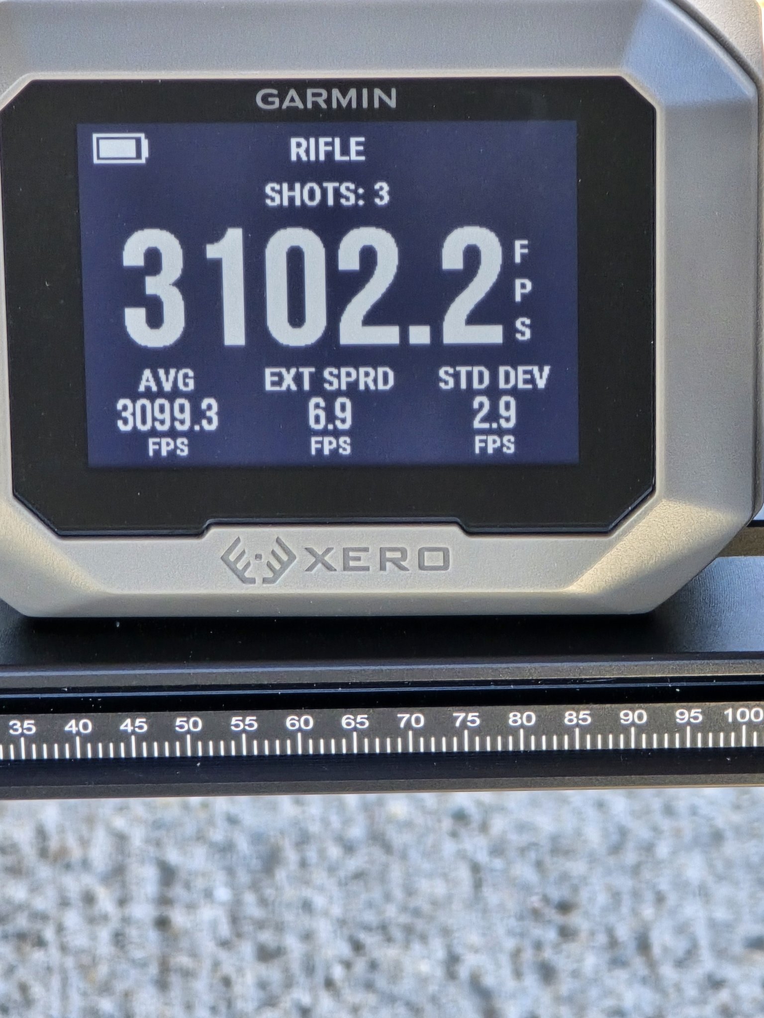

^ This is 40.0. I ran 39.9 and 40.1 over a chronograph and had an ES and SD average of 25.5 and 8.5 between the two. Velocity is going to be right at 2,950.

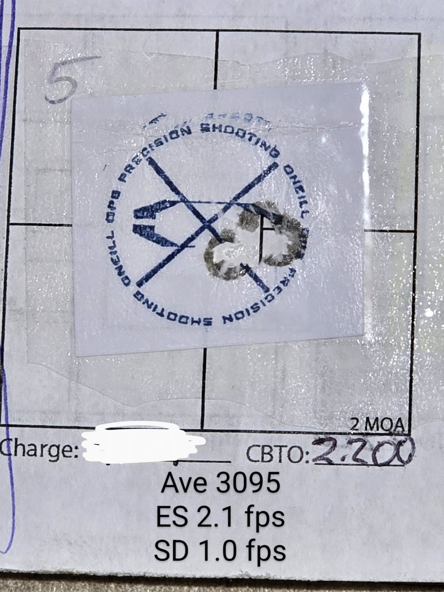

Just dropping a little more N160 data, as I don’t see a lot and VV powders are becoming the cheaper option…
22” suppressed, Lapua cases/CCI 41/N160/105/2.7” OAL
This was shot left column down, then back up the right. The rifle was allowed to “cool” between strings (about as much as you can in with a little shade, no wind, and high temps). The differences in velocity (in red) for 5 shot strings are… something.
I’ve suspected N160 in this cartridge of being a little temp sensitive when it’s hot for a while now. My previous outings with virgin brass at 70*F averaged 2760 on two different 69*F days, same charge with once fired nets about 2823 at 89*F… unless it’s the last group of the day, then the same charge on a hot barrel averages 2865. I haven’t quite wrapped my head around it yet, but I’ll probably be vacuum sealing some rounds to do some temp testing next time out.
It could have been that the barrel was late to speed up (200 rounds then vs 275 now), 40 rounds of fouling, or maybe the difference in sizing/mandrel/the humidity while I was loading – hard to say. I honestly expected a small drop in velocity once everything was fireformed/resized, which is why I added more powder from the baseline of 41/2760.
Considering the total of 40 rounds aggregates under 1” with a .21” mean radius (and the fact I know that I possess neither diggler's oustanding marksmanship nor penmanship), I think I’ve reached the ‘stop messing with it’ phase- I’d just like to have a good temp sensitivity input to load into the kestrel and to add a little more confidence.
Thanks for coming to my ted talk.

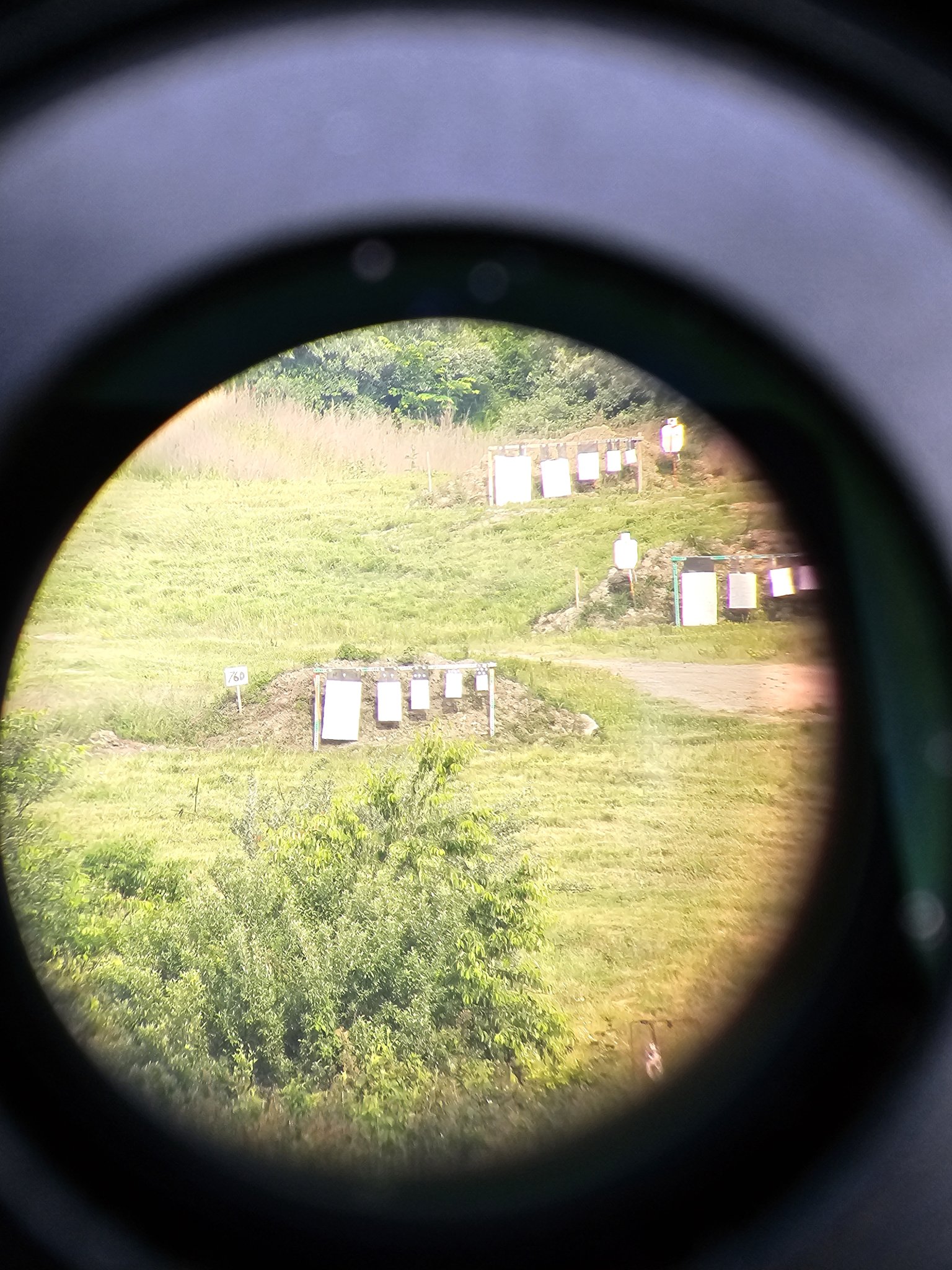

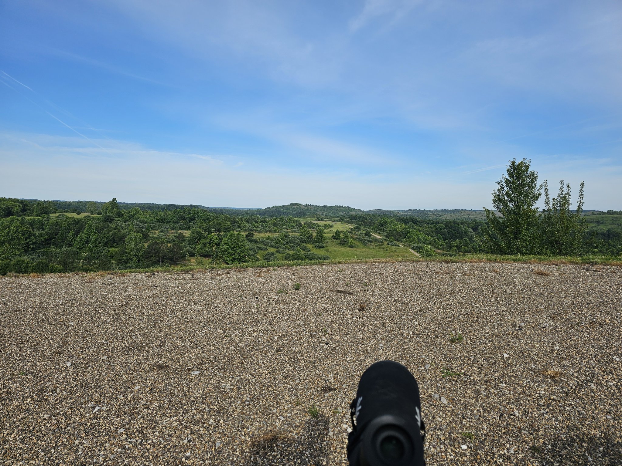

because it's a test your limits game where there are no sighters and no wind flags and a huge mountain range so the wind wreaks havoc here in south east kentucky. unpredictable directions with no real cues. a high BC (.32 g7)of the 115 gr dtac at 3125 does great against wind and helps get first round impacts on a roughly 1moa target.
oh plus we have to shoot 300 yards and be able to see out impacts so the 6mm is king of the hill where I'm at.
if you want to win you'll need to at least stay on the 1.5ishmoa (#3 out of 5) target at all ranges and never miss to have a chance and you'll likely have to score at least a few on the 1moa #4 target. Last time I went 4 in a row at the #4 target at 1k.
So are you talking about an actual "benchrest" match or just something you guys shoot at your range? BR matches usually have sighters and flags etc. Just wondering as never shot an actual 1000 yard BR but have shot 6mms for 20 years now out past it without issue in heavy winds at less velocity in PRS style matches. Even back when shooting the .243 I only range them at 2990fps when others were running 3150 and did just fine.
oh no, I shoot prone, all the old guys shoot off bench. it's not like nra sponsored or anything, we all use brakes or suppressors.
also winner gets 500$, second place gets 250, third gets 50
everybody else just loses their 35$ entry fee.
super fun honestly. if you're in south east kentucky I'll take you to it.

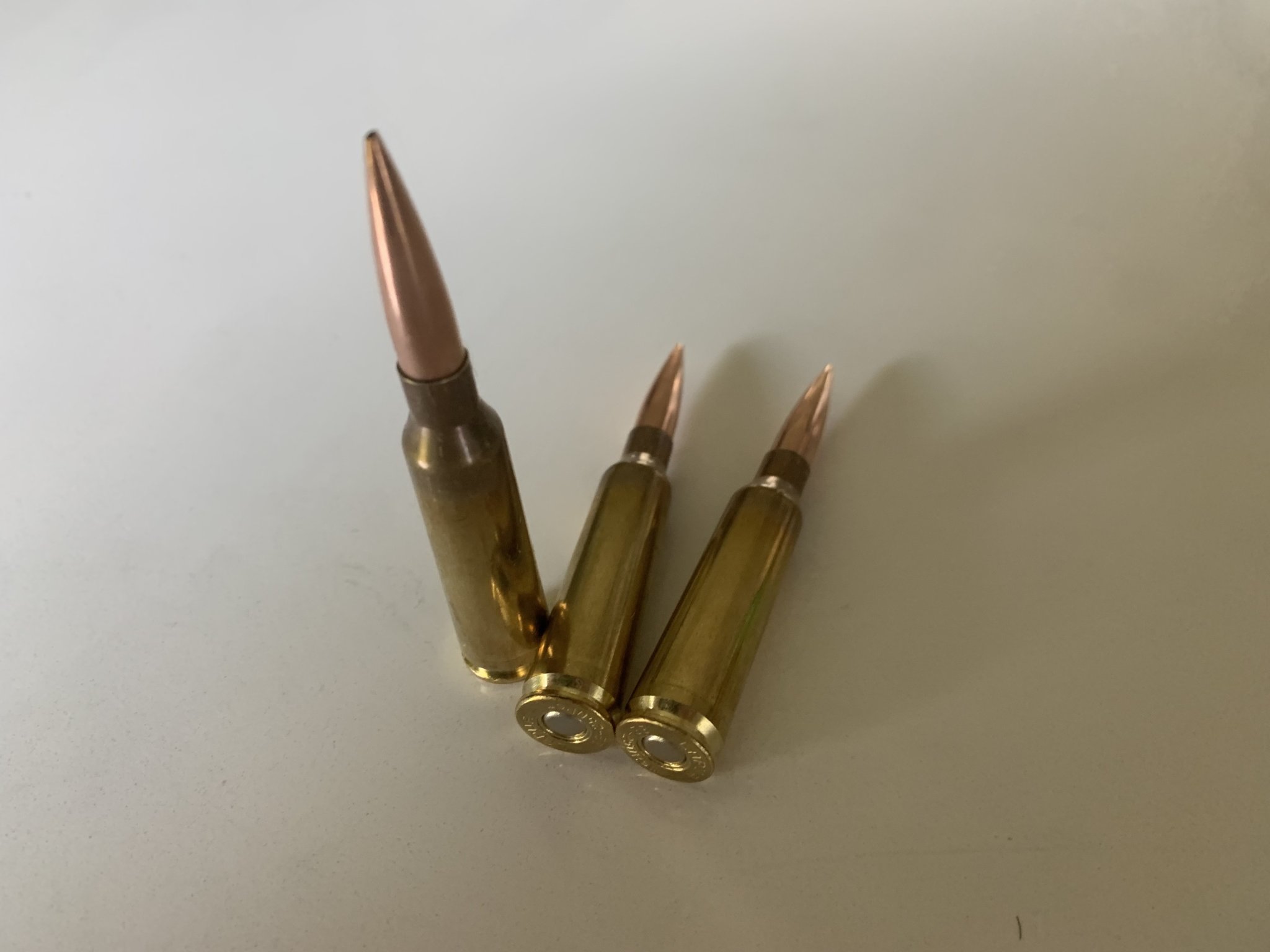

So I picked up a 6 creed BA, mostly bought for the action but should be a fun barrel to shoot. What’s the brass situation? Is lapua no longer making 6 creed brass? I don’t necessarily want to neck down 6.5 lapua brass but could, I don’t want to use alpha because I already have a bunch of 25 creed brass and don’t want to mix anything up, what’s next best readily available, Peterson? Thanks

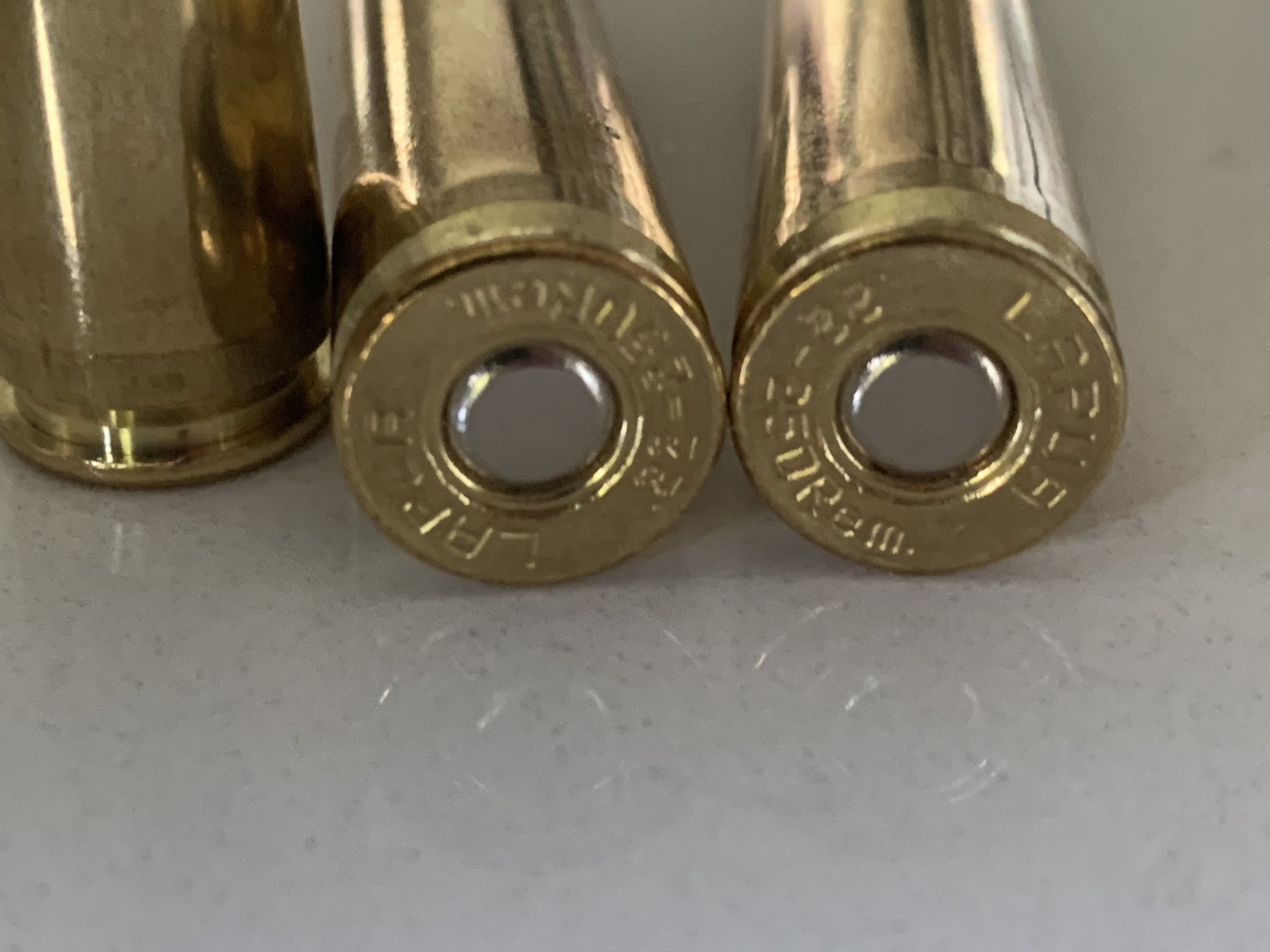

If you want to use LRPs, Lapua 22-250 brass works great for 6CM.
It'll close on the shoulder and all you have to do to fire-form it on the first firing is use a sensible middle-of-the-road charge (say ~39-40gr H4350), and it is accurate on the first firing too. The only downside is that you end up with a shorter-than-usual neck (kind of like a big Dasher case) so when cleaning the barrel you have to be mindful of that so you don't end up with a crazy carbon ring (it's really not a big deal).
I've got a few hundred with ~20 firings on them over 3 different barrels and they're still performing great (and I've never had to trim them lol).

An update from my above question.
I swapped to some old lapua brass I have, 5x fired in another chamber.
Gone are the pressure signs. But I’m getting clickers, chambers are just different enough. I don’t think the alpha grabs the chamber walls enough and is giving me holy thrust. H4350 may be too fast as well on this barrel this far along.
The barrel is still shooting extremely well.
I’m going to attempt a slower powder with the alpha, if that dosnt go I’m SOL and will hopefully get my 223 shooting well enough to be competitive.

Try a RCBS matchmaster die, it should size your lapua down enough to mitigate any chamber differences. They size a ton at the bottom side the case compared to most the other die manufacturers.

More than SAC? That’s what I’m currently using.
Going to try the alpha with h4831sc and see if I can take it down lower without getting too low in case fill.

Idk, I haven't tried sac dies. Get a good micrometer and measure the web area of fired VS sized cases. Calipers are half ass for this a mic is much better tool if you have one. My RCBS sizes lapua brass from 4707-471 to 4692-4695. I haven't had a clicker on anything creedmoor since switching from redding to the RCBS matchmaster.
