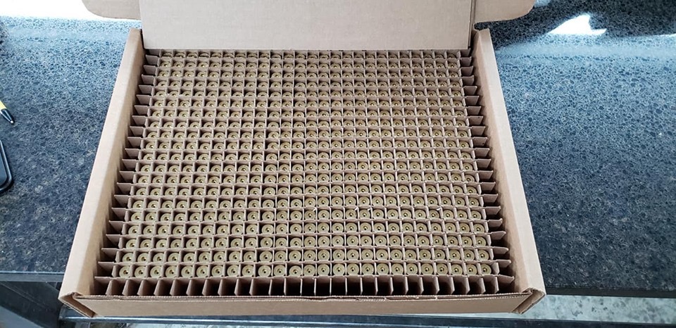

Alpha will be coming out with commercial brass by August of 2019.
Dies are currently available from Hornady. RCBS and Redding are due by late fall of 2019

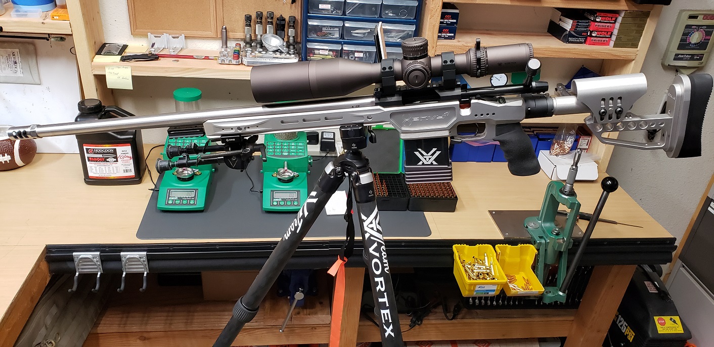

Rifle specs:
GAP Templar Action
Bartlein 1:7.7 twist 6mm M40 Contour finished @ 26"
Huber Trigger Single Stage
KMW Sentinel Stock
Vortex Optics 4-27 Razor
APA Lil Bastard Brake

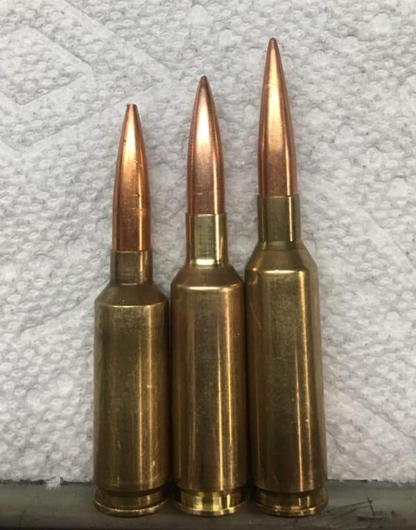

The 6GT was formed initially from 6.5x47L. The size of the cartridge is between a Dasher and 6x47L.
Left to Right
Dasher - 6GT - 6x47L

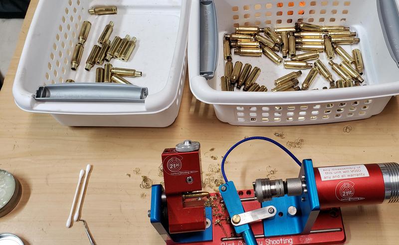

Neck turner with 35 degree cutter and 6mm setup. I have the 21st Century power lathe turner which made this process a lot easier and faster. Turning the necks is the longest part of the process.
Mini Chop Saw from Harbor Freight (30.00). No, I am not joking and yes, you need a lil chop saw. Think 300blk out days before brass was readily available.
2 presses is a huge help.
Steps 1-5 will get you 6GT brass that will chamber and shoot, but have a quite a bit of run out and I don't think it's optimum for load dev.
Step 1: FL all your 6.5x47L brass if it has been fired.
Step 2: Run it through the 6GT sizer with a .266 bushing. You will need to run the case up a little at a time. George told me to size the neck, then 100thou each push of the ram, back off each time.

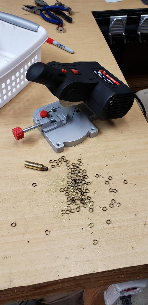

Step 3: Chop the long neck off so you only have to trim a little bit with the Giraud.
Step 4: Trim on Giraud: Length:
Step 4: Turn the necks. You will have a bit of brass to remove as there is a huge donut from pushing all that brass down.
Step 5: Tumble and load.

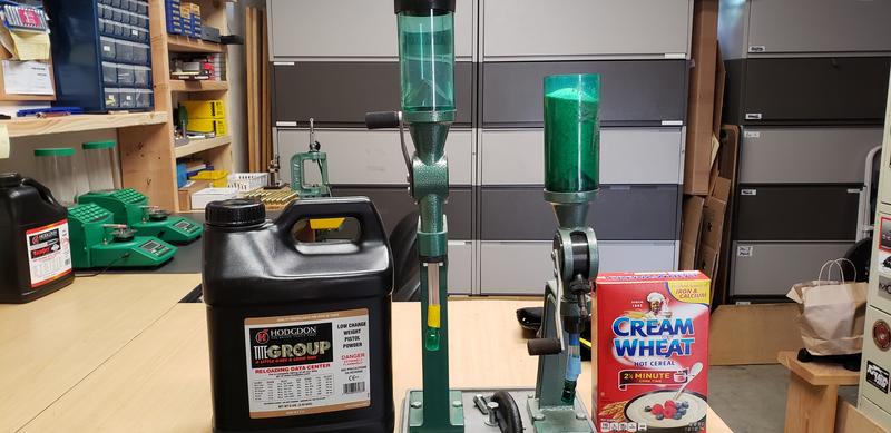

Instead of Step 5: Tumble and load, I decided to form the cases using the cream of wheat method of forming. (COW) This is the first time I have ever done this and it actually works pretty well. I was able to form 175 cases in about 1.5 hours without burning up the barrel or components.
Using two old RCBS manual powder drops, I was able to charge cases quickly.
7083150
Step 6: Drop 8.0gn of Hodgon Titegroup and fill the case up with COW to the necks. Stuff a piece of tissue in it so the COW and powder stays put. I will also add that use regular small rifle primers as well. No need for CCI 450s for this process.
Step 7: Fire the COW loaded rounds. If you have never done this, it's loud. Sounds like a pistol going off. Ear pro still a must.

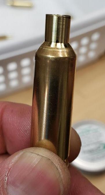

The piece of brass on the left is how the case looks after COW fire forming.

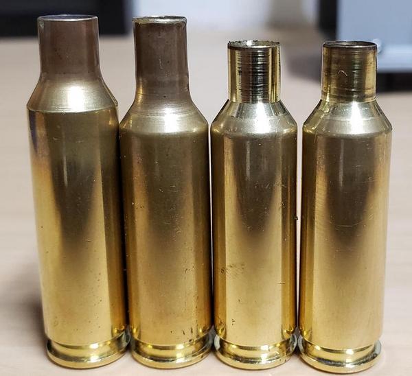

Below is a pic of what the brass looks like going through the process.
Left to right: 6.5x47L brass, sized with the 6GT bushing die with a .266 bushing, chopped/trimmed and turned, and fired formed.

Dan on the chop saw:
7077921
21st Century Powered Lathe is the cats meow of neck turners!
7077922

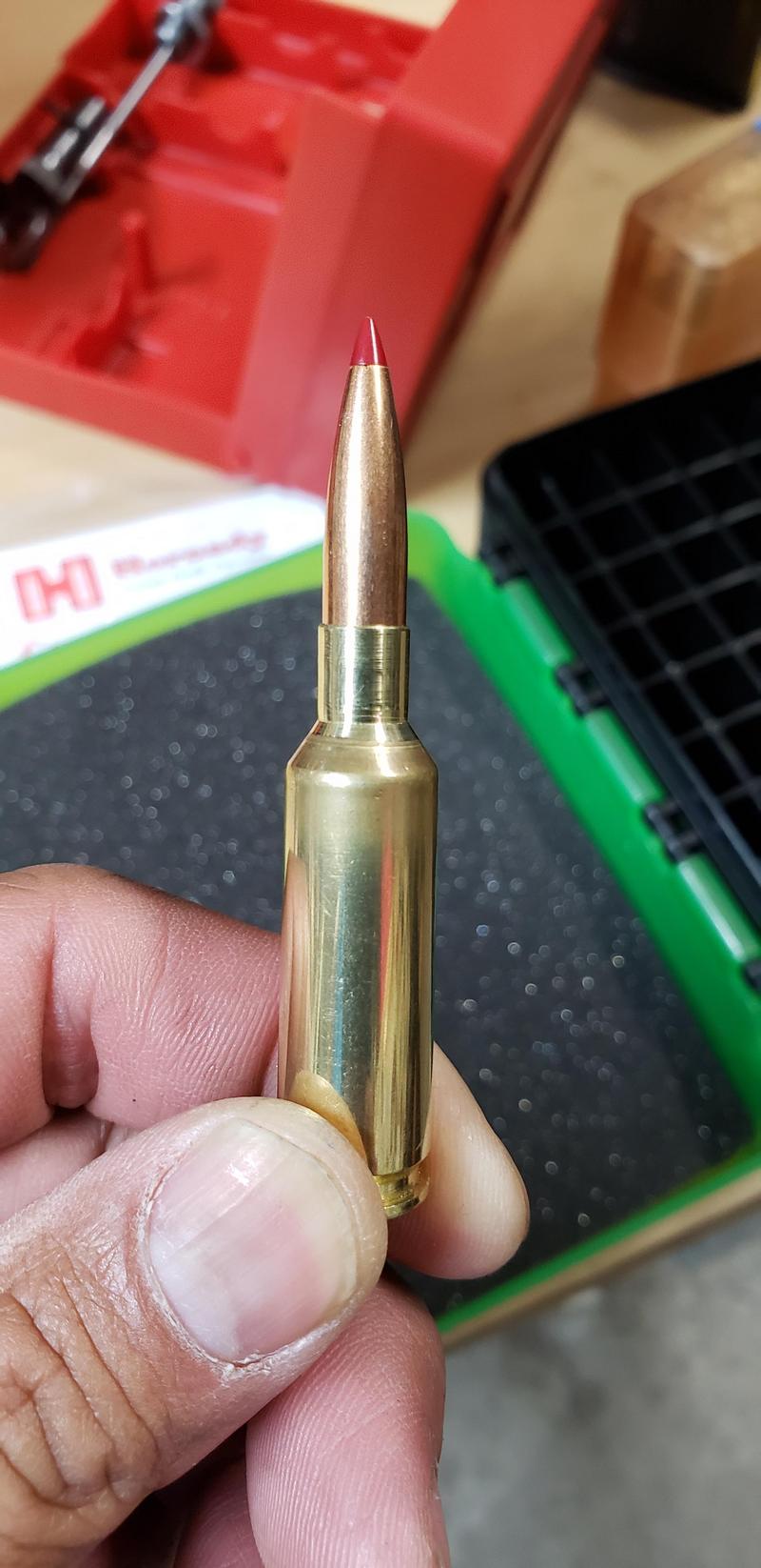

Ready to load:
7077923
First loaded 6GT.

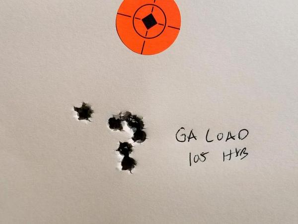

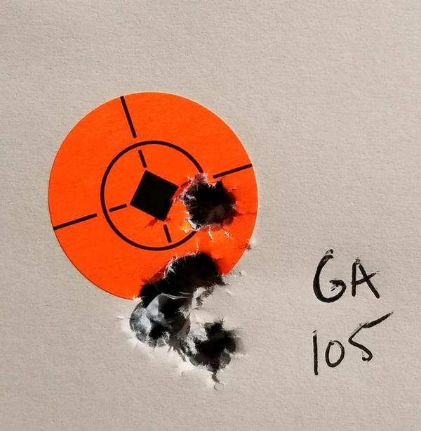

Next 5 of the GAP 105 Hybrid Ammo
7077926

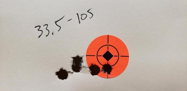

Non-Formed Brass
105gn Hybrid
33.5gn of Varget
7083142

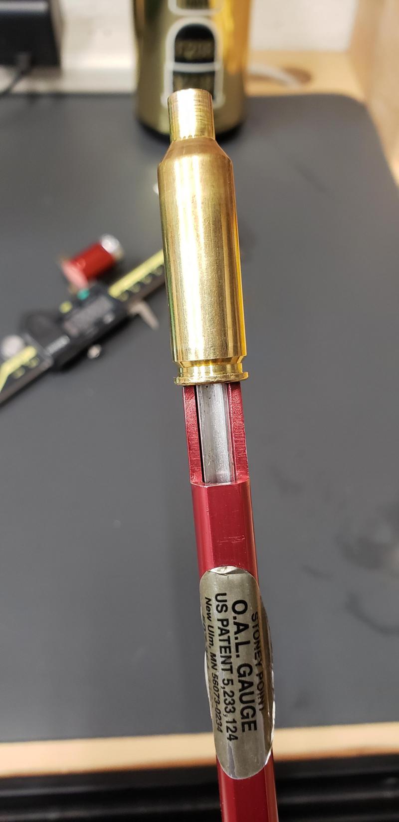

Made a OAL Gauge case:
7083156
This is what I got for each bullet measured with Ogive touching the lands:
105gn Berger Hybrid: 1.950"
108gn Hornady ELDM: 1.960"
110gn Hornady ATip: 1.980"
112gn Barnes Match Burner: 1.970"
115gn DTAC: 1.960"

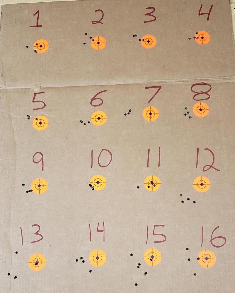

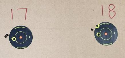

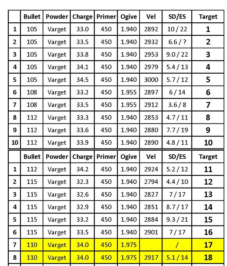

5-27-19 Load Dev Range Report

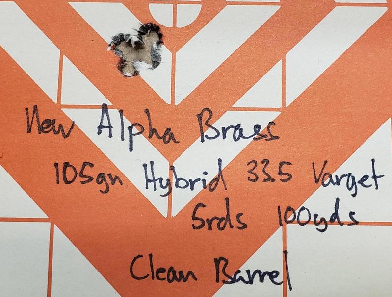

Cleaned the barrel so I fouled it in with 5 rounds using brand new Alpha brass. These were the first 5 out of the barrel that AM. Moved the zero a touch, fired 3 more.
7085391
Checked Zero @ 200yds to foul the barrel in a little. This was with Cream of wheat (COW) formed brass.
7085390

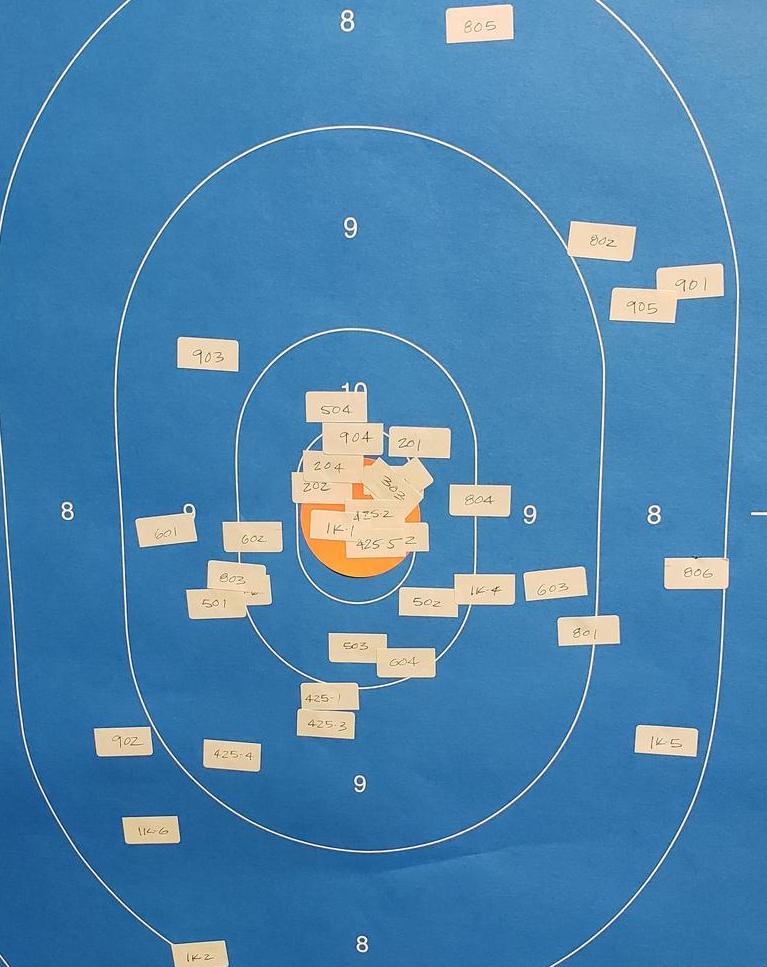

Ran these bullets: 105 Berger Hybrids, 108 Hornady ELDM, 110 Hornady ATip, 112 Barnes Match Burner, and 115 DTAC
Data gathered. Looks like I got a solid load for 105s, 108s, 110s, and 112s. Gotta work on that 115s. Dan did most of the shooting while I wrote down numbers and worked the Magnetospeed.
Fired 12 rounds and then let the barrel cool down each time. Will probably load up the 108s and run them out to distance this weekend at our LR match.
7085395
Fired 4 rounds of each, except for Target # 15
7085397
7085398

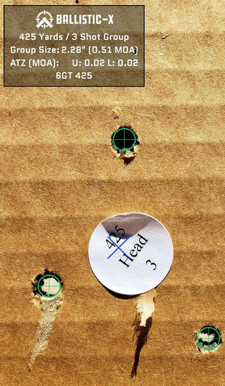

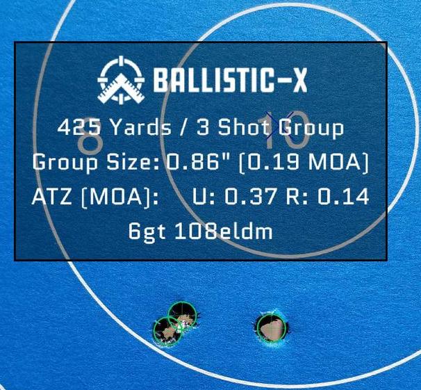

5-31-19 Shot a NCPPRC LR Practice from 200, 300, 425, 500, 600, 800, 900, and 1000.
Used the COW formed brass (still has a fair amount of run out), but was able to gather pretty solid numbers all the way out.
Used the 108ELDM pushed by 33.5gn of Varget giving me about 2940. Barrel is broke in and sped up.
Conditions were nice. Got into the mid 80s by 11am. Winds were from 11 to 2oclock.
10ring is 4"x3"
Kestrel and everything tracked pretty well. 10ring is 4"x3"
7089324

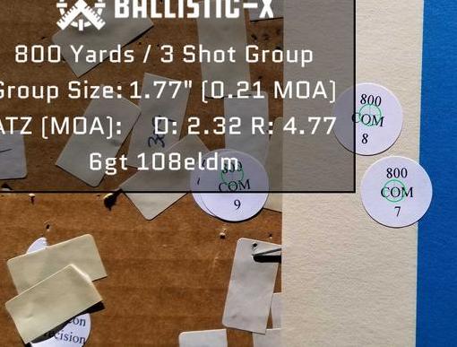

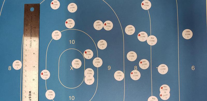

Shot the match on Saturday and Sunday. Saturday went OK, blew some wind calls at distance that cost me. The .270BC life is something I am not use to coming from a 6.5mm 140gn bullet.
Here are some groups from that match. We shoot 3 round per string at various distances.
7089326
7089327
7089329
7089331
Dropped 1 out of 12 @ 900. Pretty decent water line considering the mirage and me just not being the worlds best shooter. LOL Brass was COW formed. Should tighten up a lil with full formed brass.
Step 4: Turn the necks. You will have a bit of brass to remove as there is a huge donut.
Did you anneal before loading after sizing down? What did you turn the necks too? Thanks!

After one fire forming the lapua brass was around 43.3 grains of h20 capacity. My dasher weighs at to 41.9 for comparison. If Alpha can match that capacity or get close to it we will be gtg. If they don't and it has too much you might as well just run a 6x47.

Groups are all relative for me because I am not a group shooter. Dan was on the gun, but he doesn't shoot a left handed KMW stock on a regular basis either.
Taking the GT out to distance tomorrow. See how those 108s fly. I will say that even with COW forming, here is a fair amount of run out still.

Rutter, I am going to play a lil more with that load and shoot them in a F-Class 3x600 match. Don't have many of them so trying to use them the best I can to gather data.

The 1:7.7 is rocking the 108s pretty well. Been busy the last few weeks so have not been able to hit the range.
Jorge Bonilla sent me some 105 and 115 RDFs to try out as well.

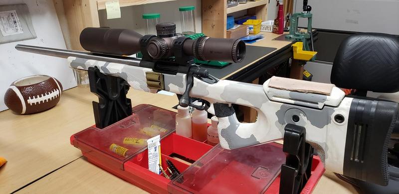

I have a 7 twist Bartlein at Rubicon Precision being spun up on a new Impact Action.
Dan is getting his 6GT spun up as well.

Been busy the last few weeks to get any more testing done, but did shoot todays steel match and had a 2nd GT built up by Rubicon Precision. I wanted a tighter twist than a 1:7.7 for the heavier bullets so George was kind enough to get me a 1:7 to spin up.
The 108s are running solid @ 2960 with 33.5gn of varget in upper 80s - low 90s degrees. Ran the gun hard on props all day without any feeding issues.
Reamer was purchased from GA Precision and is the same spec as the first rifle.

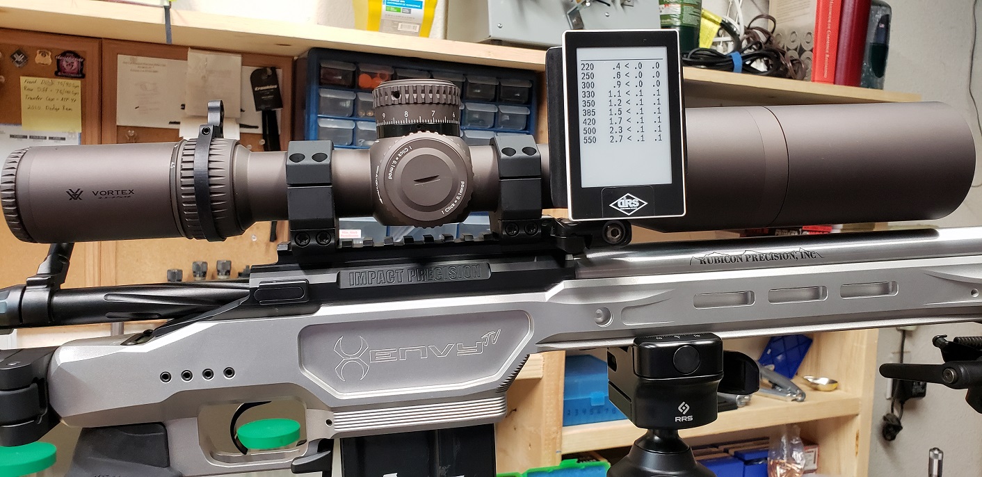

Specs on 2nd GT
Built by Rubicon Precision in Cool, CA
Impact Precision LH Action
XLR Envy Chassis
Vortex Gen II Razor
Bartlein 1:7 twist
APA Lil Bastard Muzzle Brake
Trigger Tech Diamond
New rig has about 20 rounds down it and is also liking the 33.5gn with 108s ELDM. I'll be focusing more on the 110 to 115 class bullets in 2nd GT.

I'd be interested to see what H4350 would look like in that. I started shooting it in my Dasher bc Varget is a throat torcher. Im at a compressed 35gr with 105's at 2910
Tried H4350 with a 115 for a pressure test and the case capacity is not there, which does not surprise me since the case was designed to run Varget or something real similar.
