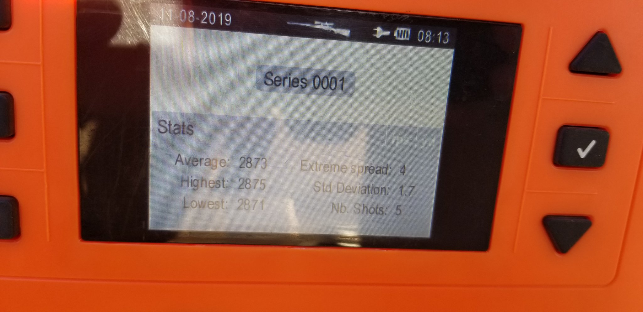

So far the Hornady GT Brass has been GTG. Weighed a handful of cases out of a batch of 1000 pieces, all were within a half grain in weight. Ran a mandrel through the necks and chamfered new brass, loaded some up and had some extremely consistent velocity spreads. Primer pockets felt great, even after a stout load. Time will tell but so far so good on the hornady brass.

Load and velocity? I'm guessing the 2871 was just a starting point?
That was the load I ran over the weekend at the Bakersfield PRS match with the 112s. 35.8 H4350, 50 off. Just a quick load I threw together before the match but didn't have a lot of time. Varget works well too with low SDs. Planning to go back out this week with once fired brass and do some more development with different bullets as well.
My plan for the gt was to run similar to dasher speeds at lower pressures. I've been running the 112s in the dasher at 2860-2880 so I just ran with that load for the match.
