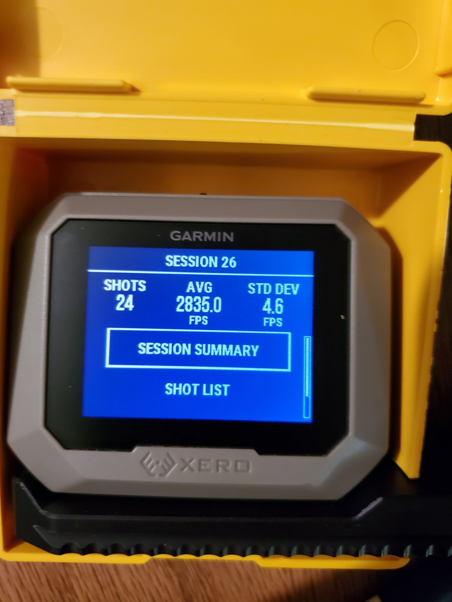

Has anyone tried the Hodgdon Superperformance? I've got a bunch so I might give it a go when I get everything together. It did well in my creedmoor. Screen shot shows load with a 105gr bullet.

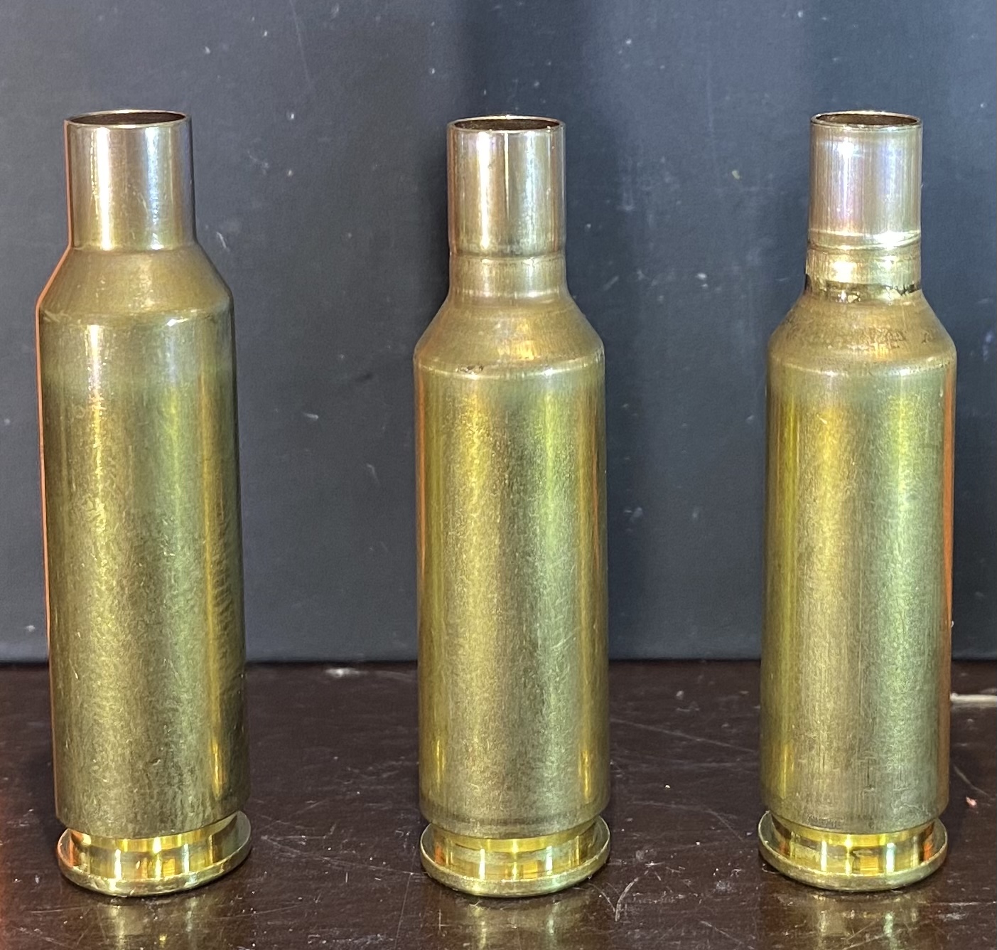

I will post a step by step of the 47 Lap brass to 6GT at some stage, but for anyone with any reloading nous at all it is very simple. Not to mention half the price. 47 brass is completely cleaned at 13 thou. Leaves you with a 269 loaded round. I would die losing brass at $3.50 a piece...
Reactions: ReplicaSnipers
After going through the bushing die and before trimming.
