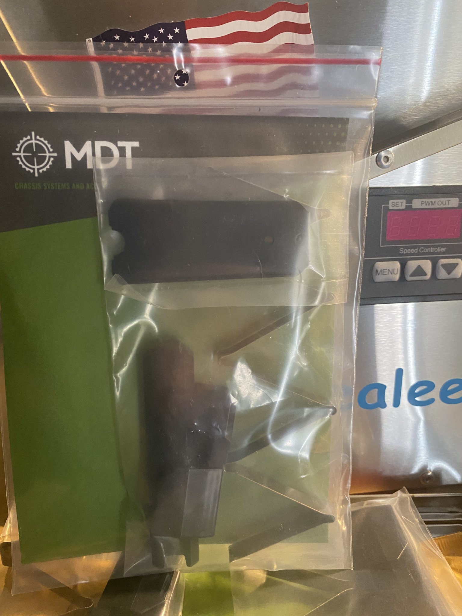

Get ahold of MDT. They reached out and sent me new followers, mag springs, and spacers to alleviate the issues I was having. Make sure you tell them if you have binder plate or non binder plate mags. Also, let them know if you have 10 or 12 round magazines. They will send the proper sized spacer for them.
The only downside so far is that I have to load to mag length and under to find my optimal seating depth. This knocked off about 60 thou of play room off the lands for me.

I'm not sure how to continue to be polite and say I don't run MDT mags in my GT because they don't fvcking work.
AI Mags, ARC mags, take out of package, insert bullet, go to range.
Rinse, repeat.
No calls. No email. No swapping. No tweaking feed lips. No searching who else has the problem.

Not to beat a dead horse, but...
Like most everyone else, I had trouble feeding 6GT with MDT mags. I was not surprised as it was a known issue when I started shooting the cartridge. I asked MDT about it and this was the response:
Thanks for the question.
Feeding the 6mm GT from our metal magazines is a known issue because of our control ribs, and we are working on a solution, but our Polymer magazines will feed the 6mm GT. Here's a link to that product.
https://mdttac.com/308-6-5-creedmoor-mdt-polymer-aics-magazine-10-rnd/
If you have any further questions, please let us know.

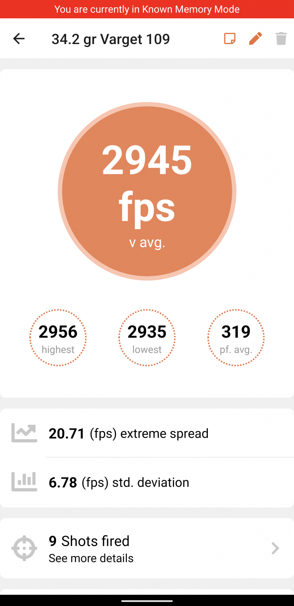

I'd break in 36.5gr of H4350 with Alpha brass. One of the nice things about 6GT is there's pretty much no reamer variations. I'll wager you final charge weight will be around 36.7gr going 2900fps using Alpha brass.
I'm about ready to go load 50 rounds to shoot tomorrow for more break-in. Rounds 101-150. I'll vary some load weights and work up to your recommendation quickly and see how it goes. Hopefully we'll see her speed up a bit and I can 'try' to get some load development done for Raton next Sunday. Thanks for the recommendation. (y)
2 different 6gt barrels, not as easy as a dasher, bra, or br, but def not picky. 36.6gr H4350 with 109s 40k off lands shoots 4" at 870y thats the furthest I've shot paper. I think last time i ran 15 over chrono I had an es of 13, avg was 2907fps. I'm running a 28" bartlein 7.5tw.
Have you found it easy to get low SD’s with H4350 in the GT? Does it have a wide node?
Again, 6GT has almost no reamer variations. Follow this guy's load:
36.5gr to 36.8gr of H4350. 105gr to 109gr projectiles. .030 to .050 off the lands. Painless.

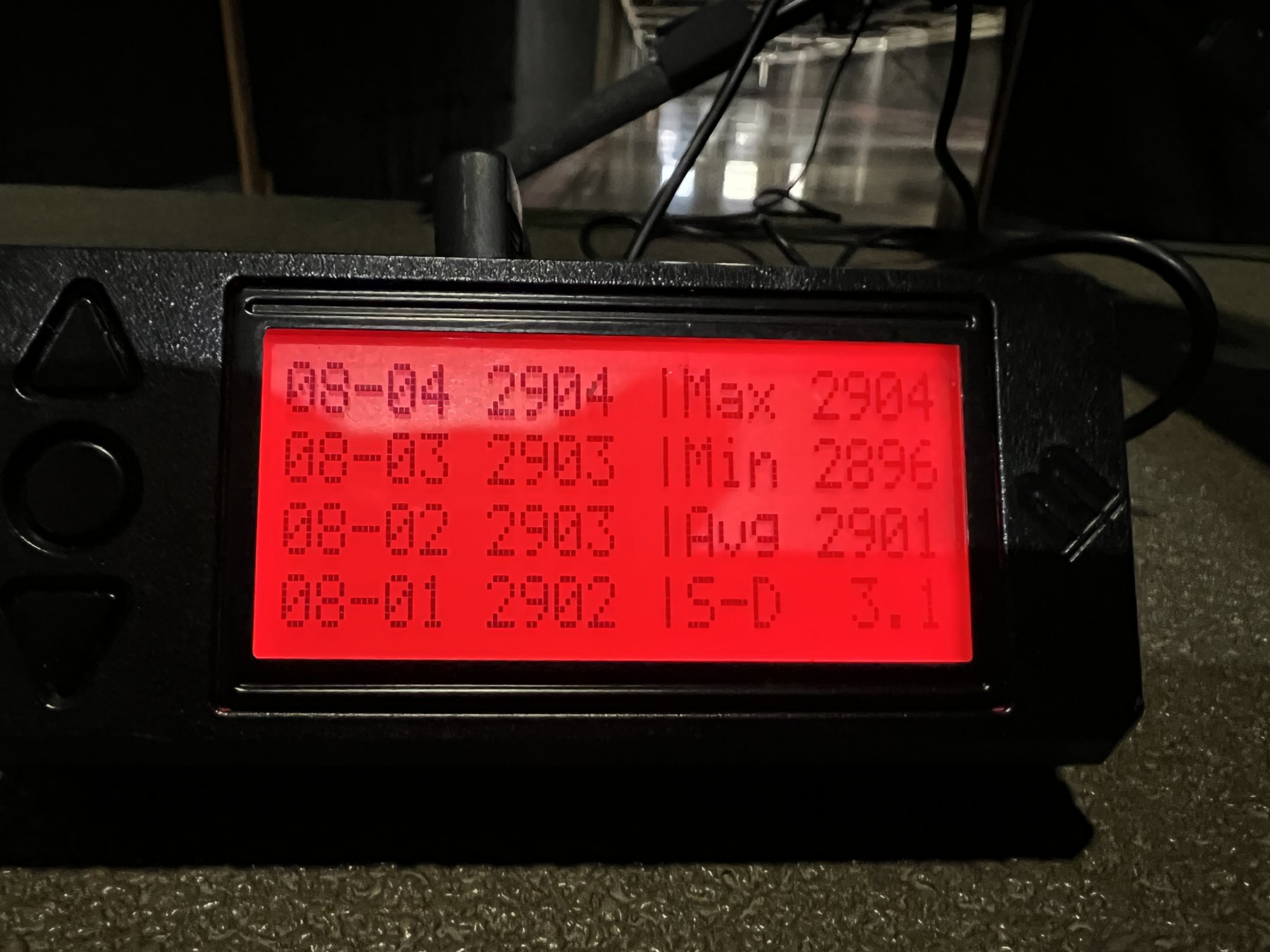

Here is a little more powder/velocity info for folks.
Alpha brass (1x fired, no shoulder bump)
CCI BR4
Bart's 105 Gungnir
30 inch 8 twist Blake barrel
VARGET
33.2 - 2960
33.5 - 2972
33.8 - 2995
34.1 - 3003
34.4 - 3024
34.7 - 3051
35.0 - 3074
35.3 - 3092
35.6 - 3119
35.9 - 3136
H4350
36.5 - 2975
36.7 - 2974
36.9 - 2982
37.1 - 3001
37.3 - 3016
37.5 - 3023
37.7 - 3040
37.9 - 3053
38.1 - 3072
38.3 - 3091
Hope this helps!

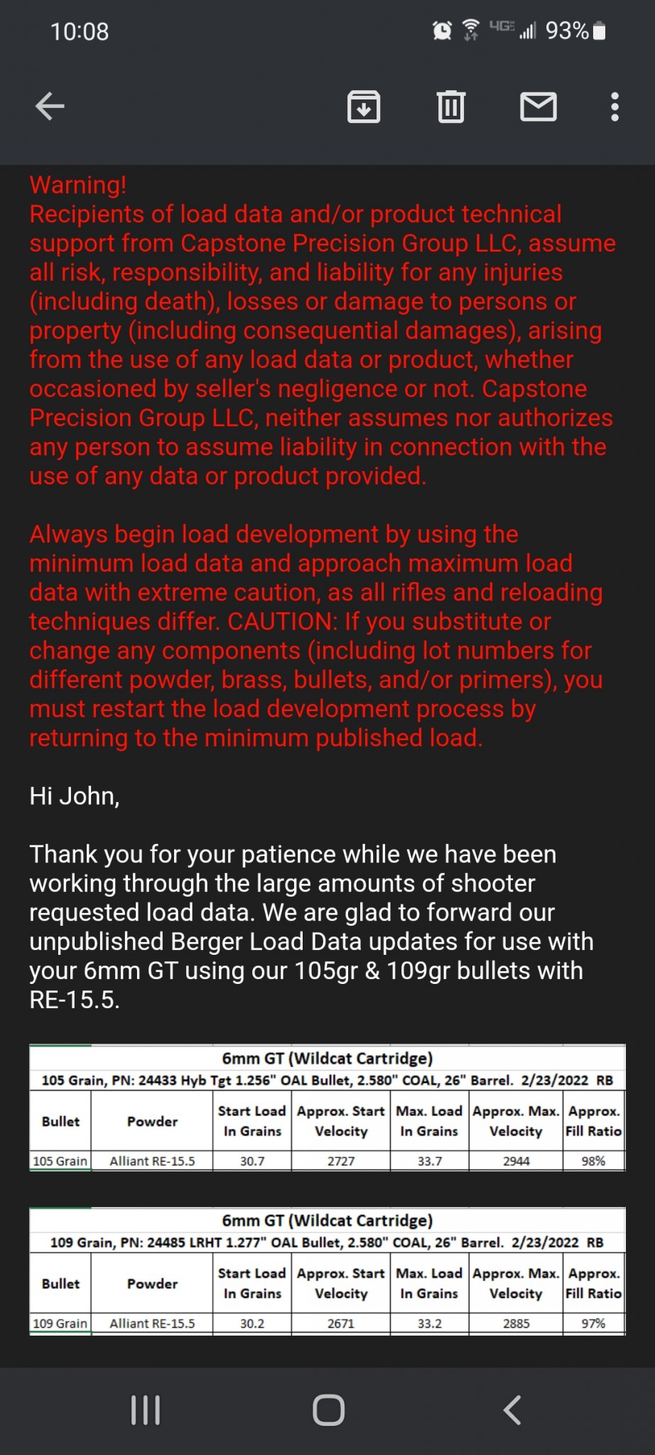

Hey guys, i am building a 6gt bolt gun and was wondering what powder you’d start with out of bl-c(2), 4895, xbr 8208?
I have br-4 and 450 primers, alpha brass, and 108 bergers, i also have some Varget but not much. I been keeping an eye of for h350 but haven’t been able to get some yet.
Any Varget class or H4350 class will work in the GT. Look for 4166, 4451, Staball, CFE223, RL15, 15.5, 16, 17 Whatever VV equivalents are and so on.

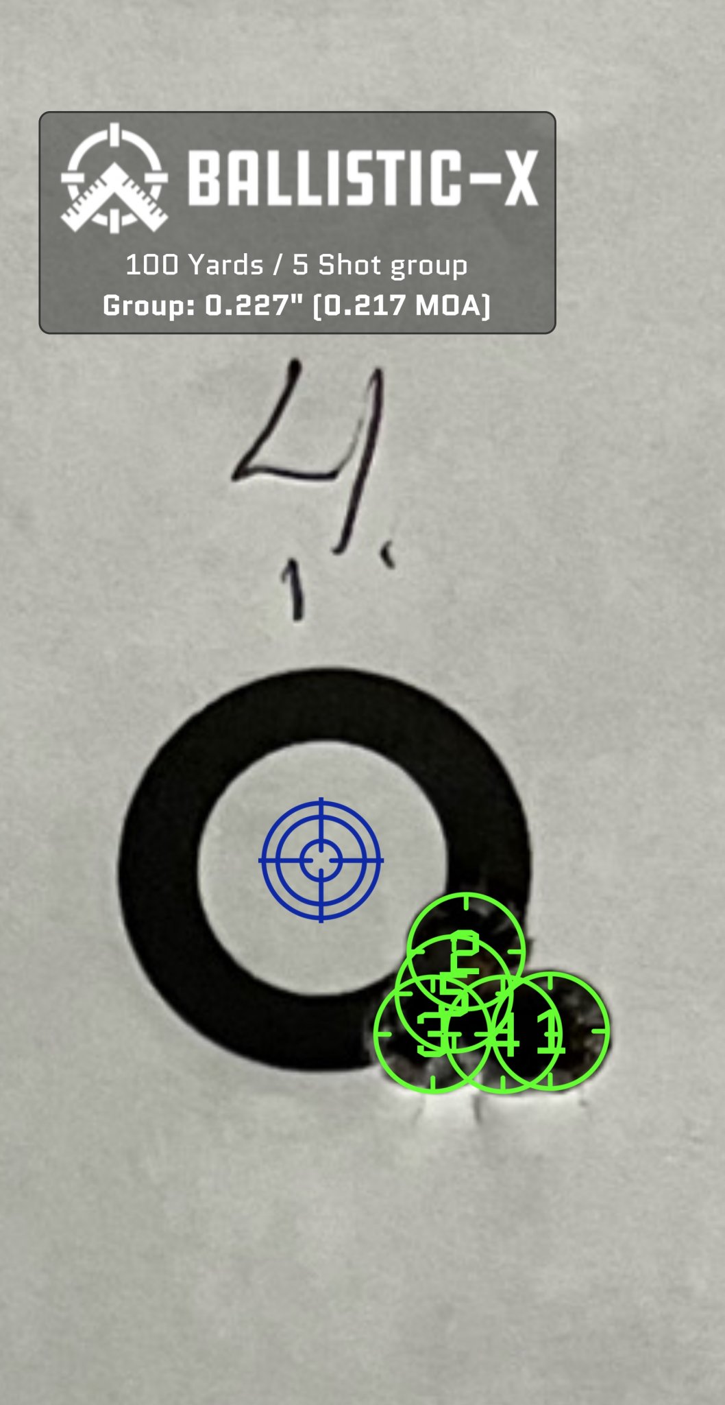

Same base to ogive seating depth I've been running(-40) with 109s for 700 rounds. Barrel has just over 1400 on it. H4350 36.5(warm temps), 36.6(med temps, 36.7(cold temps) keeps speeds right at 2900. This was the cold weather ammo shot at 50° today, avg velocity was 2912 with es of 20 over 25 rounds fired. Same ammo shot 1.5" at 400y but didn't feel like hiking back up the snowy hill to fetch target. 50° and snow on the ground with swirly winds had pretty heavy mirrage, so groups may have been better in ideal conditions. Barrel is a BB steel bartlein 7.5tw 237 bore 28" hvy varm. This is what a person looks for in a prs load, super stable over the course of 700 rounds fired. I'm unsure of throat erosion as this point as I haven't checked since it just keep shooting. I just adjust the charge weight by 0.1 for different seasons as I'm not in a powder node, but the speed node of 2880-2910 held excellent vertical at 500y upon initial ladder. Last fall this velocity printed 4.7" group at 870y. All shooting is from a bipod and rear bag field conditions, no benchrest bs.

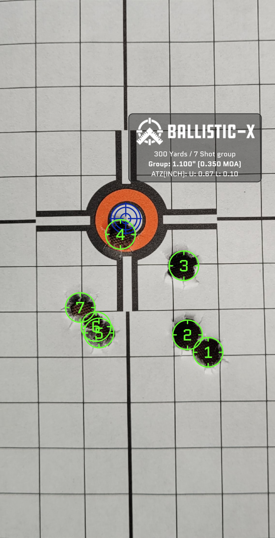

108bt ran very well 10 and 20 off in a prior barrel, like stupid good. 1.5" 10 shot groups at 500y. Was running rl16 @ 2940fps.
It liked .10 today. But I got better SDs/EDs at .50 and was just a little tighter. But after reading above, it looks like I need to push a little farther to see.

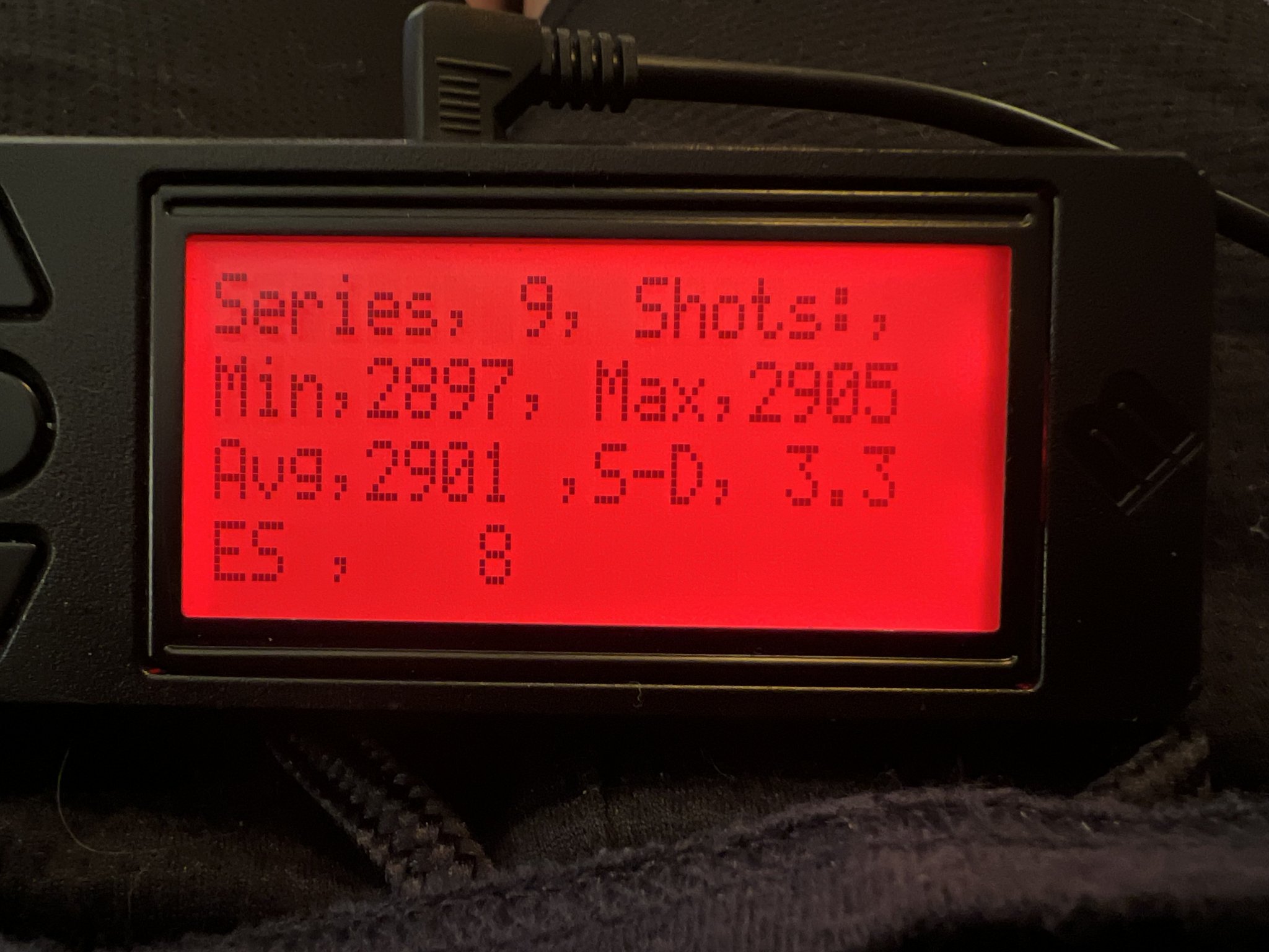

I had a roll going until the 5th round. It read an SD of 0.0 right before shot 5. My panties got a little moist and I think it slowed down shot 5.
