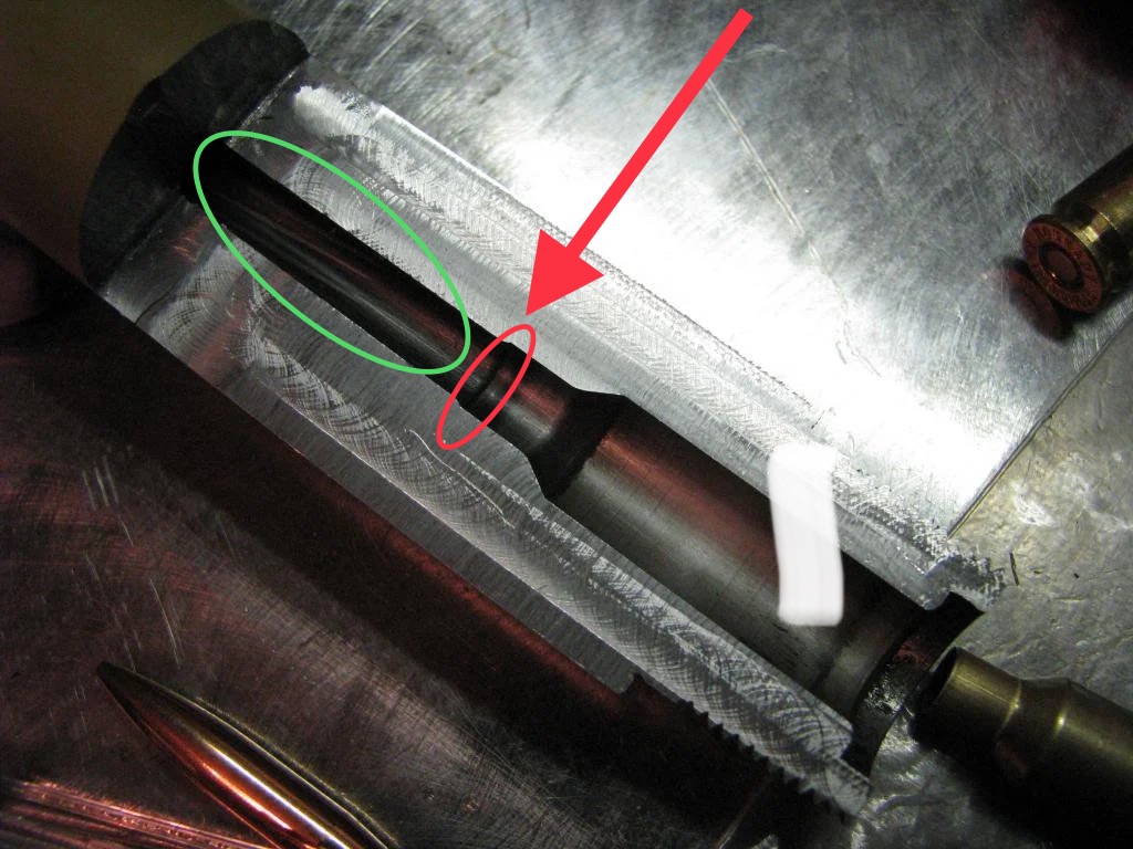

Most people seem concerned with the green area. While yes that is important, the burned out barrel or velocity drop is from the area in red.
Which is why a barrel setback is only as minimal as needed to “freshen” the chamber.
This also means that unless you are comparing apples to apples (bullets, powder, case length, cleaning…etc) you can’t give a confident answer how long your barrel vs my barrel will last.

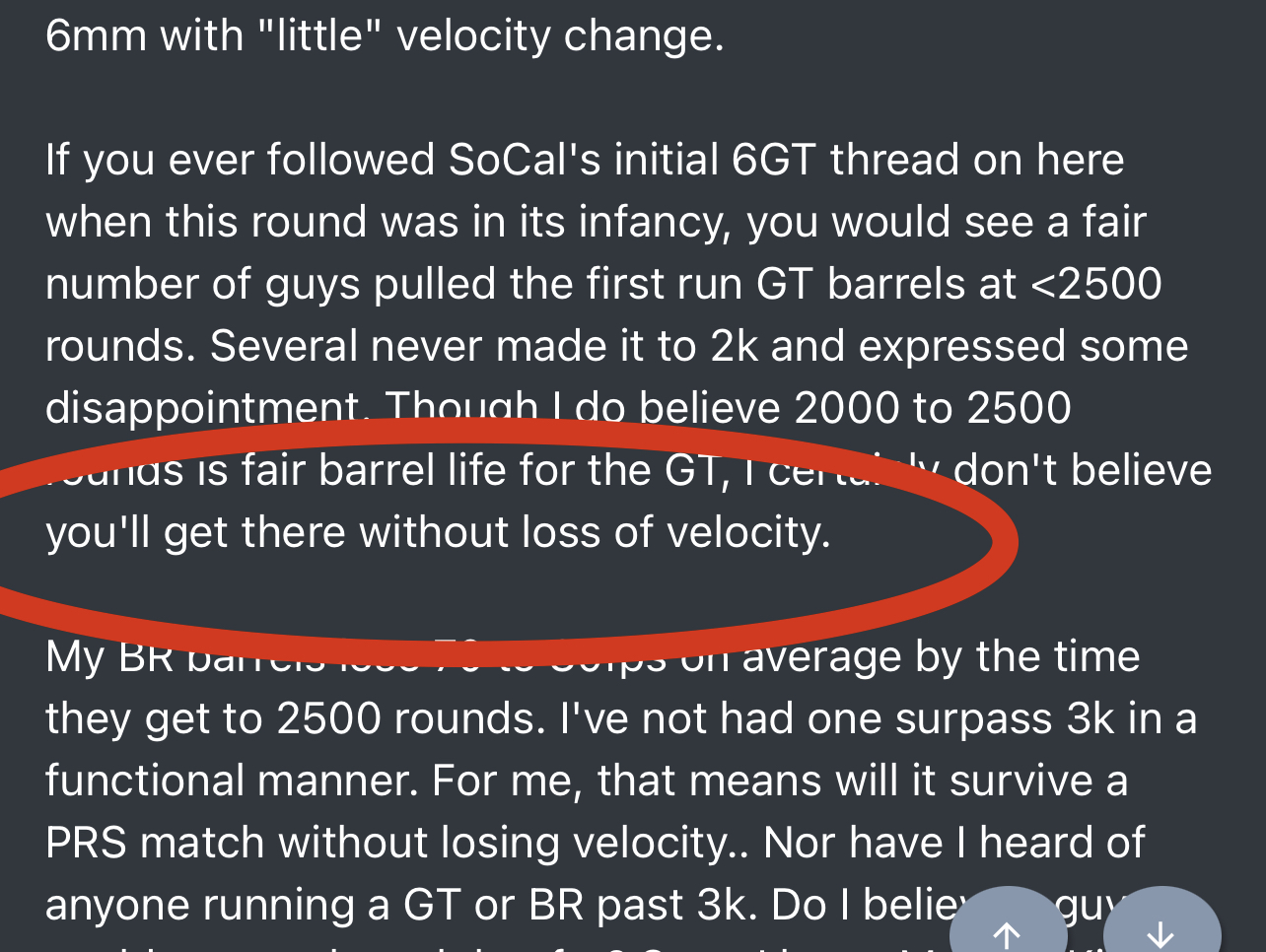

I have no idea why you think I needed all of that explained to me. I understand the process quite well. The head scratcher is how you get to 2000 to 2500 rounds on a 6mm with "little" velocity change.
If you ever followed SoCal's initial 6GT thread on here when this round was in its infancy, you would see a fair number of guys pulled the first run GT barrels at <2500 rounds. Several never made it to 2k and expressed some disappointment. Though I do believe 2000 to 2500 rounds is fair barrel life for the GT, I certainly don't believe you'll get there without loss of velocity.
My BR barrels lose 70 to 80fps on average by the time they get to 2500 rounds. I've not had one surpass 3k in a functional manner. For me, that means will it survive a PRS match without losing velocity.. Nor have I heard of anyone running a GT or BR past 3k. Do I believe a guy could nurse a barrel that far? Sure. I know Morgun King ran a couple Dasher barrels to 3k running a nice easy Berger 105. But he pulled them at that point, and pulled all his other barrels sooner than that.. So that's not the norm for a competitive shooter. The large majority of competitive shooters are pulling a Dasher/GT type of 6mm at around the mid 2k round count. If nothing of significance had changed in the round characteristics by that point, why would anyone be swapping them?
So that's the head scratcher. I have no desire to spend pages debating it. I would rather just tell you I'm glad you are seeing good barrel life from your rifles and how you shoot them, and move on.

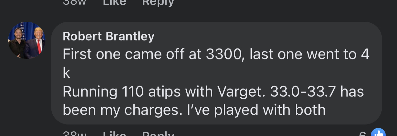

There’s literally pages of guys here and on FB who say they get 2500 out of a dasher, 3k on a 6br
And variance claims of 2500-3500 on 6gt.
So, whoever “they are” you are not reading.

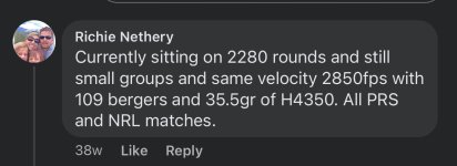

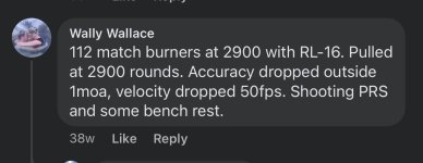

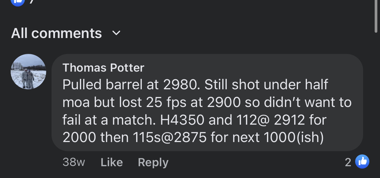

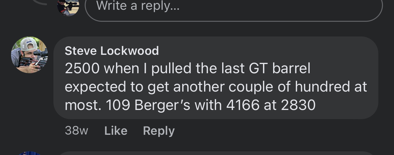

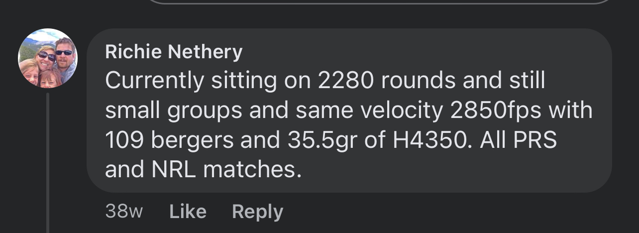

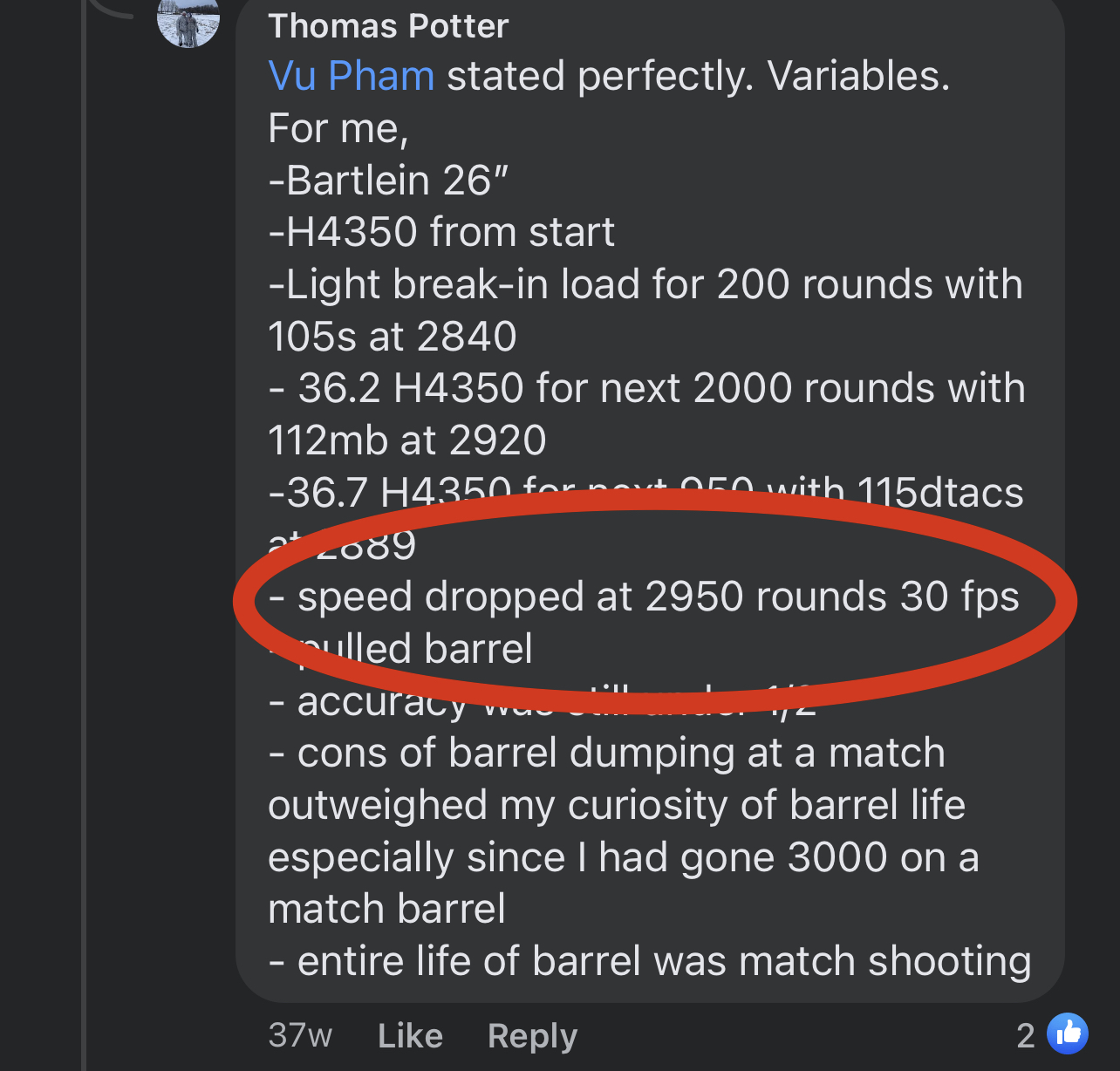

Here’s you saying you don’t believe you can get to 2500 on a 6gt without velocity loss. And saying you’ve never heard different.
Here’s a few screen shots that took 3 min to find.
So, again, read more before you make all encompassing statements and implying someone is exaggerating.

I dont have your Google Fu skills. There's several guys in that 20 page thread who lost barrels at less than 2k rounds.
And funny that one of your quotes is one of the guys I shoot with all the time. His barrel last year didn't fare nearly so well.
But I'll confess to be surprised that so many people have similar experiences to yours. I havent seen a barrel perform in that manner for me. It remains a head scratcher I guess as to how guys are getting that many rounds down the pipe with velocity change.

Reactions: Birddog6424
Thats amazing honestly. As I noted above, mine didn't make it to 2k. A guy I shoot with pulled his at 2k last fall, couldn't get a barrel, and ended up taking his Creedmoor to the Finale.
2850fps is where I was at as well with DTACs. By the time I shot my 3rd Pro Series match, it was down to 2770fps. Thats what the AB guys clocked it at in Montana. I shelved it after that to save it for the Finale and shot my BR. But it was toast.
Just a bad taste in my mouth I guess. Fingers crossed on the next ones.

What powder are you running? I'm convinced that some powders are throat burners. RL17 is one. Not that anyone uses it anymore, just an example.
