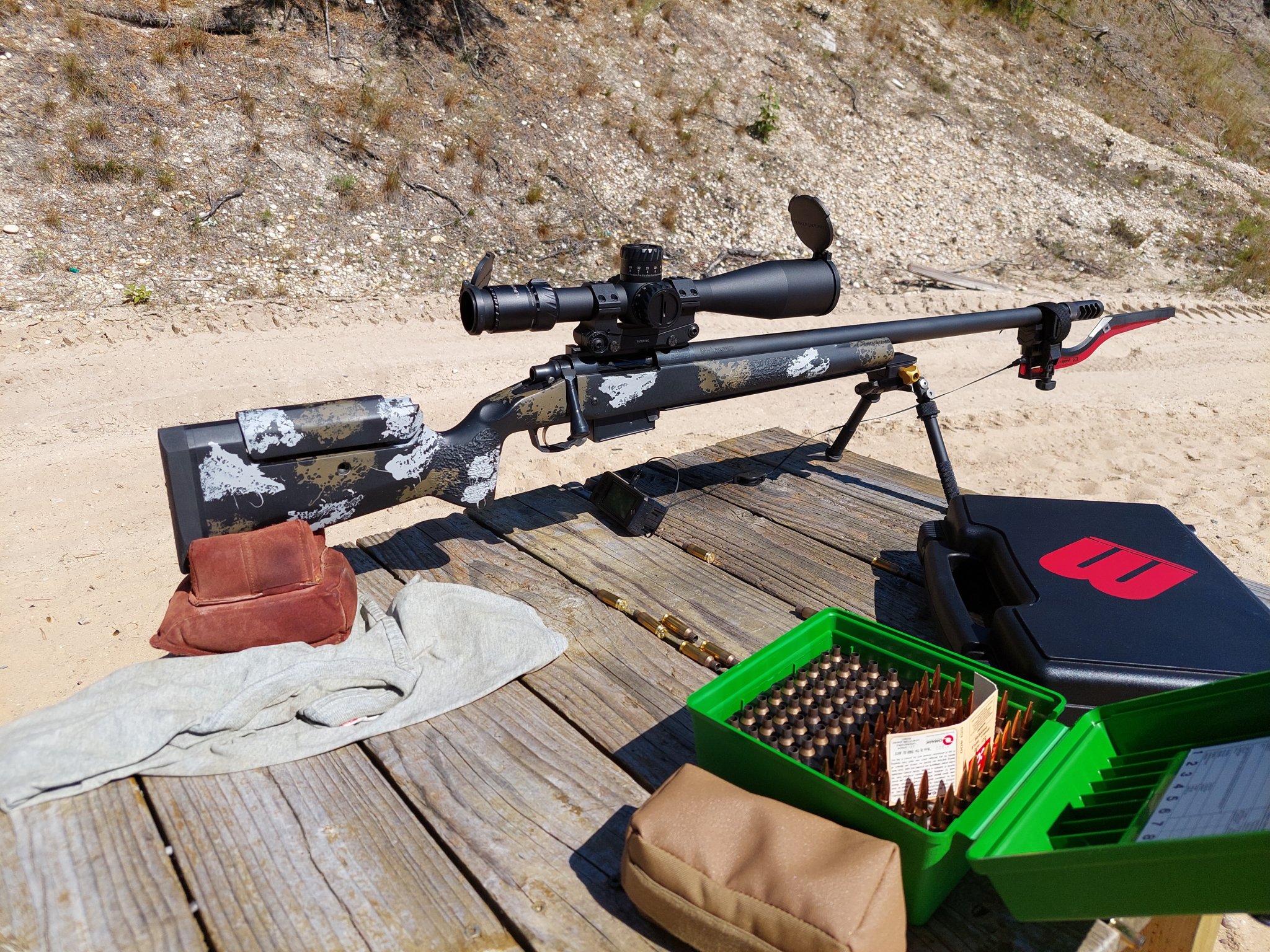

Here's the rifle and can so you can see what the total length looks like.

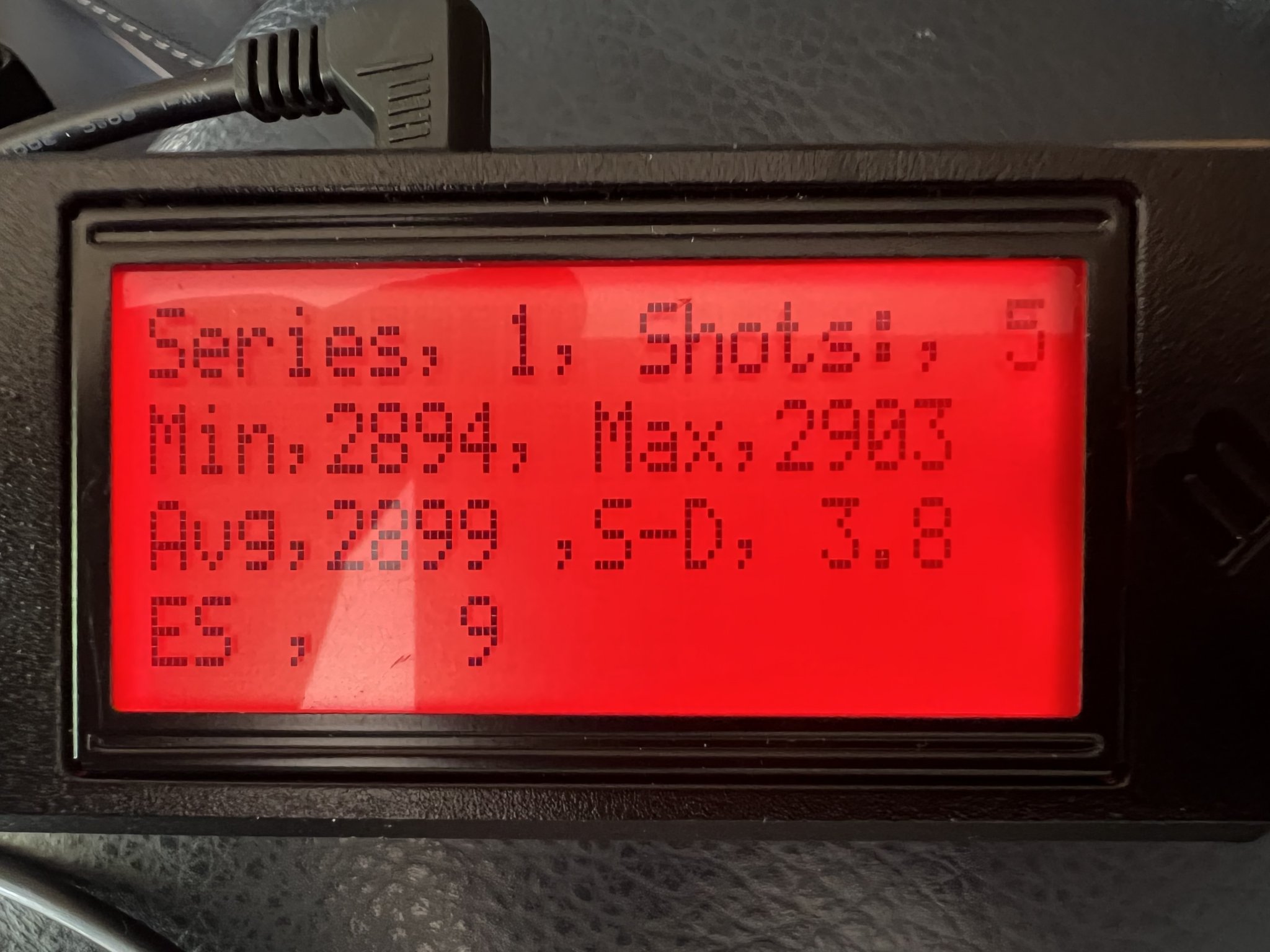

It seems like a common Dasher load is a 109 Hyb running 2875-2900. Which sounds like where a lot of people are running their GT (with slightly more powder)
If that's the case, is it just about feeding and mag kits?
I realize this might be a dumb question, but I'm going back and forth between ordering a Dasher or GT.
Yep
I run 31.8 Varget for 2850. 34.2 Varget for 2960.
Sounds like you can run your GT 50-75fps faster than a Dasher, if you wanted to
