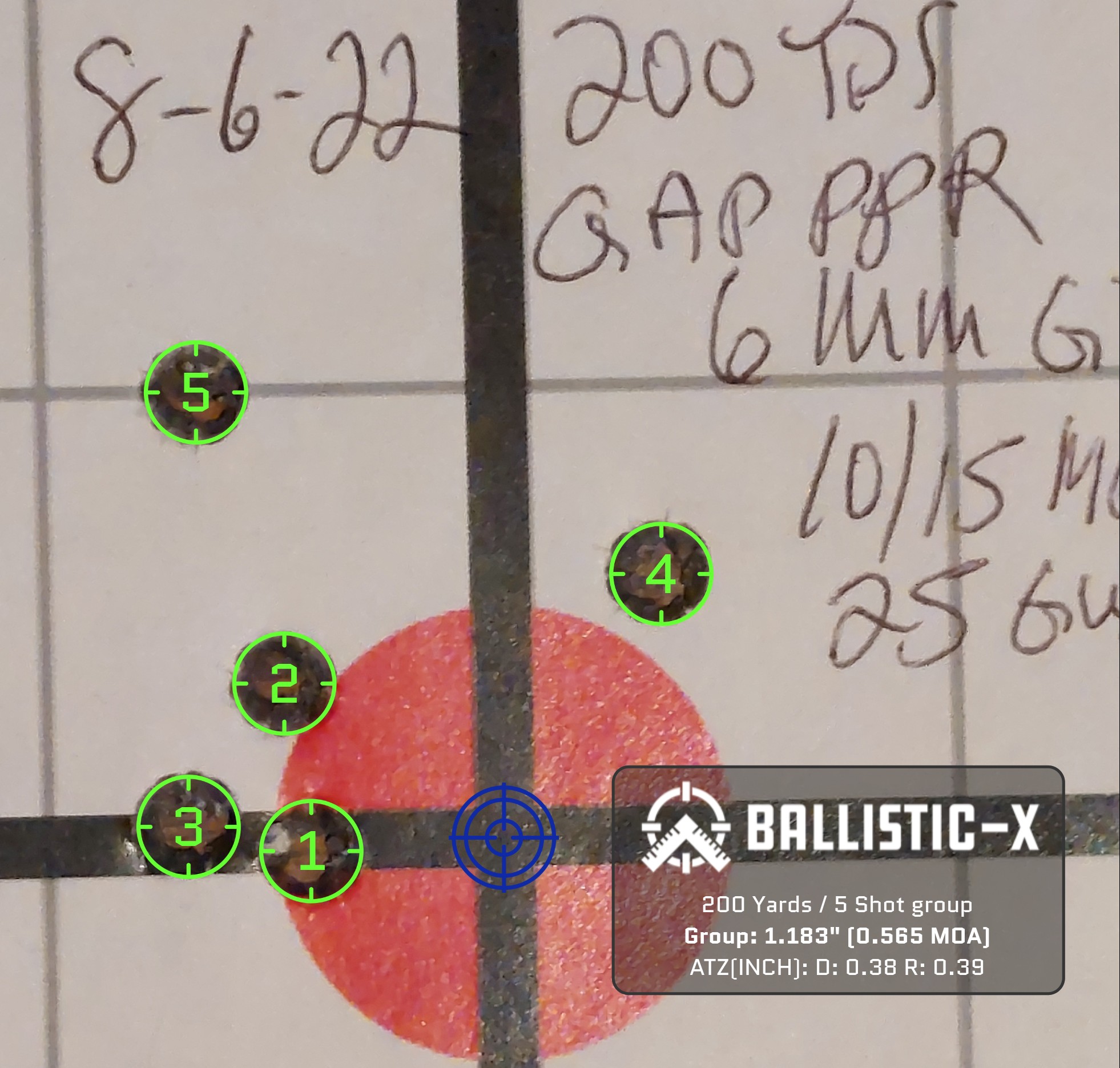

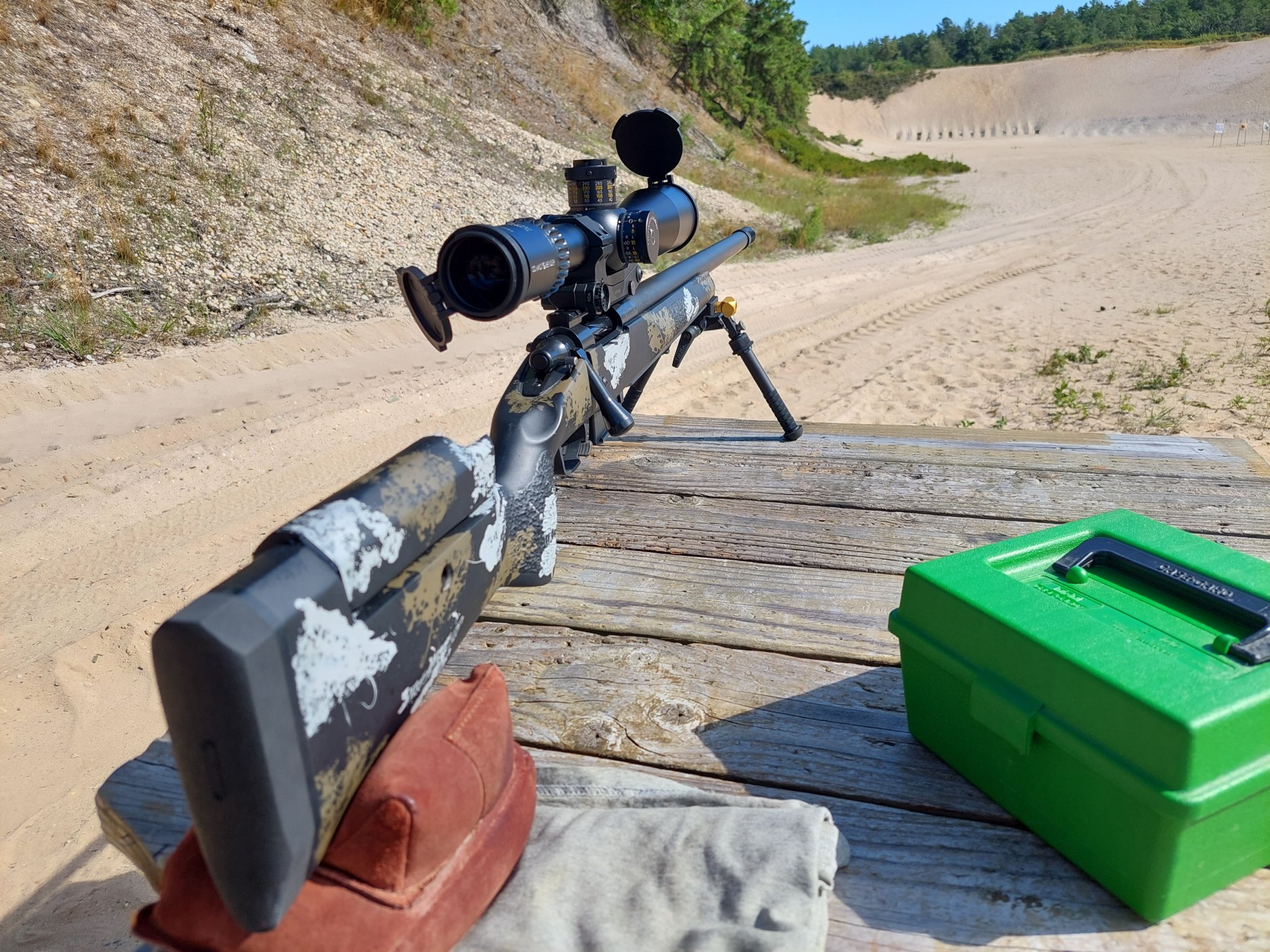

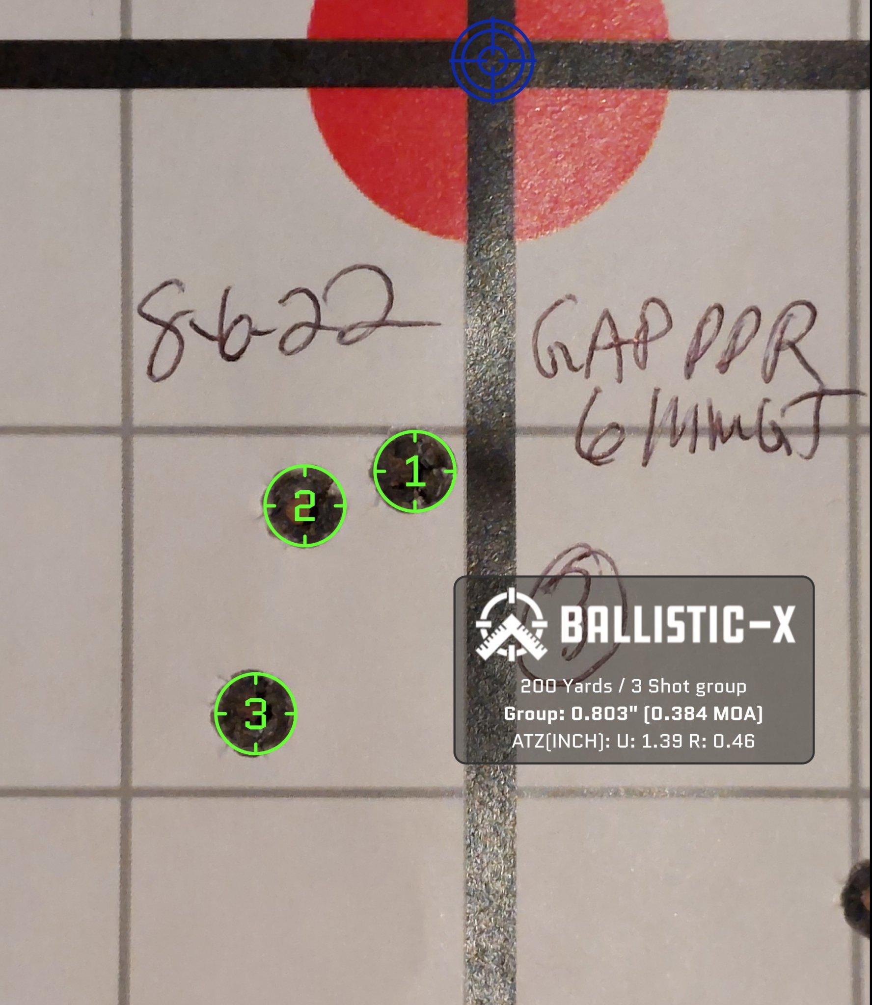

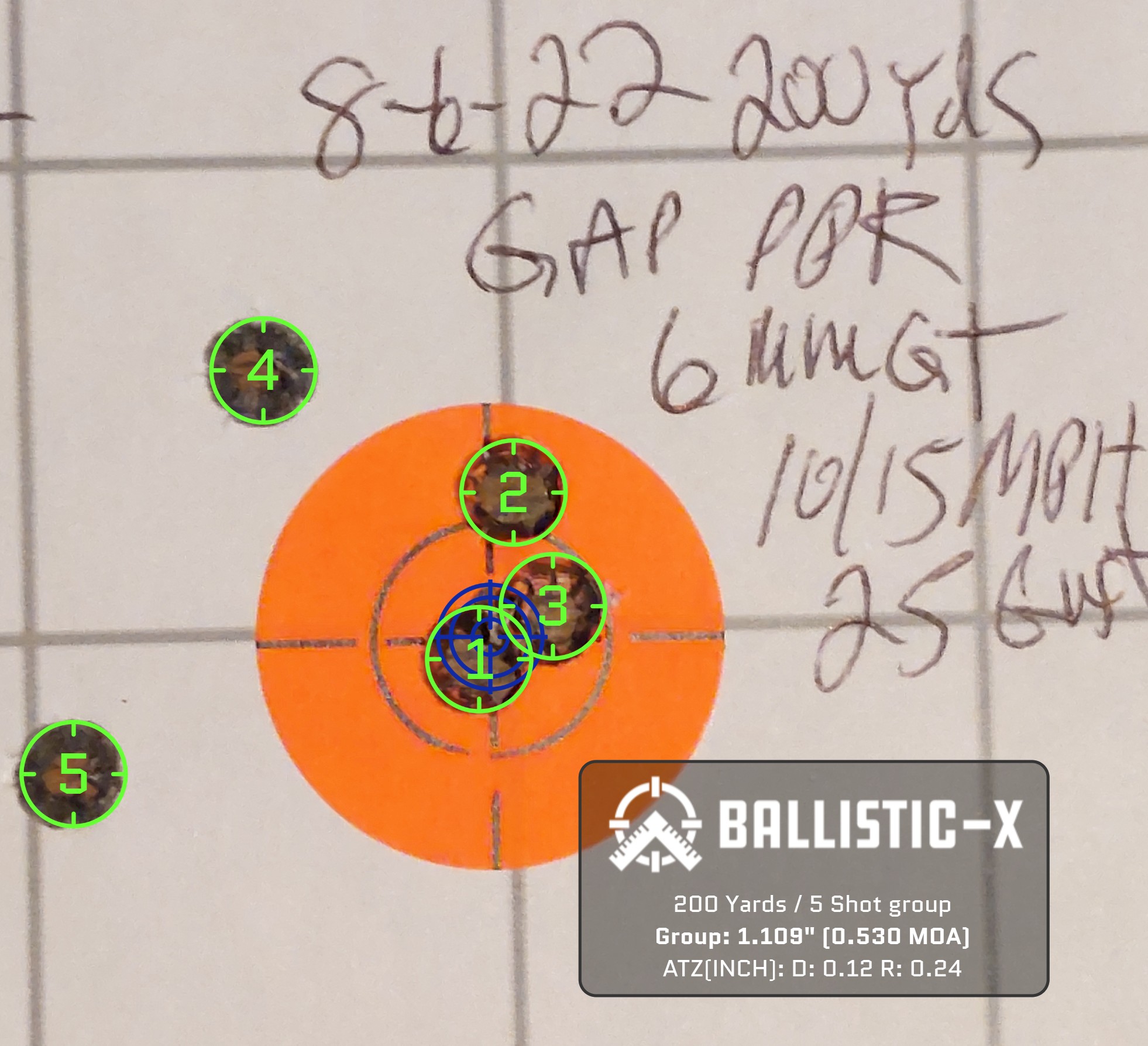

Shot this GAP PPR again today. 34.5 grains of h4350 and 107 smk. 10 to 15 mph sustained with 25 gusts.
Re-mounted scope, 2 into 200 yard back stop, then 3 shot group on paper.
Rifle and round is rocking...
Even with some wind fliers it's good, or perhaps me flyers... 😉

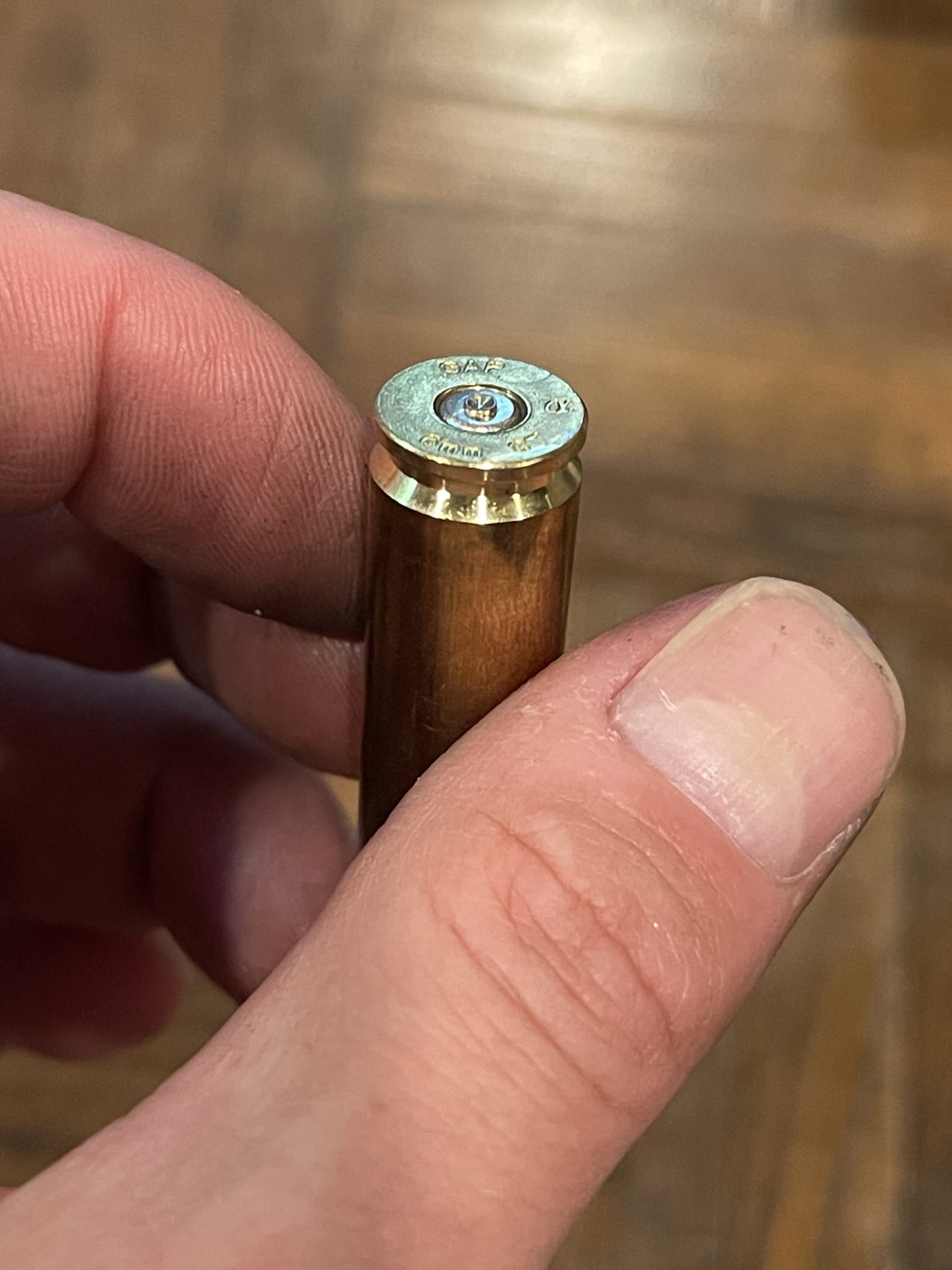

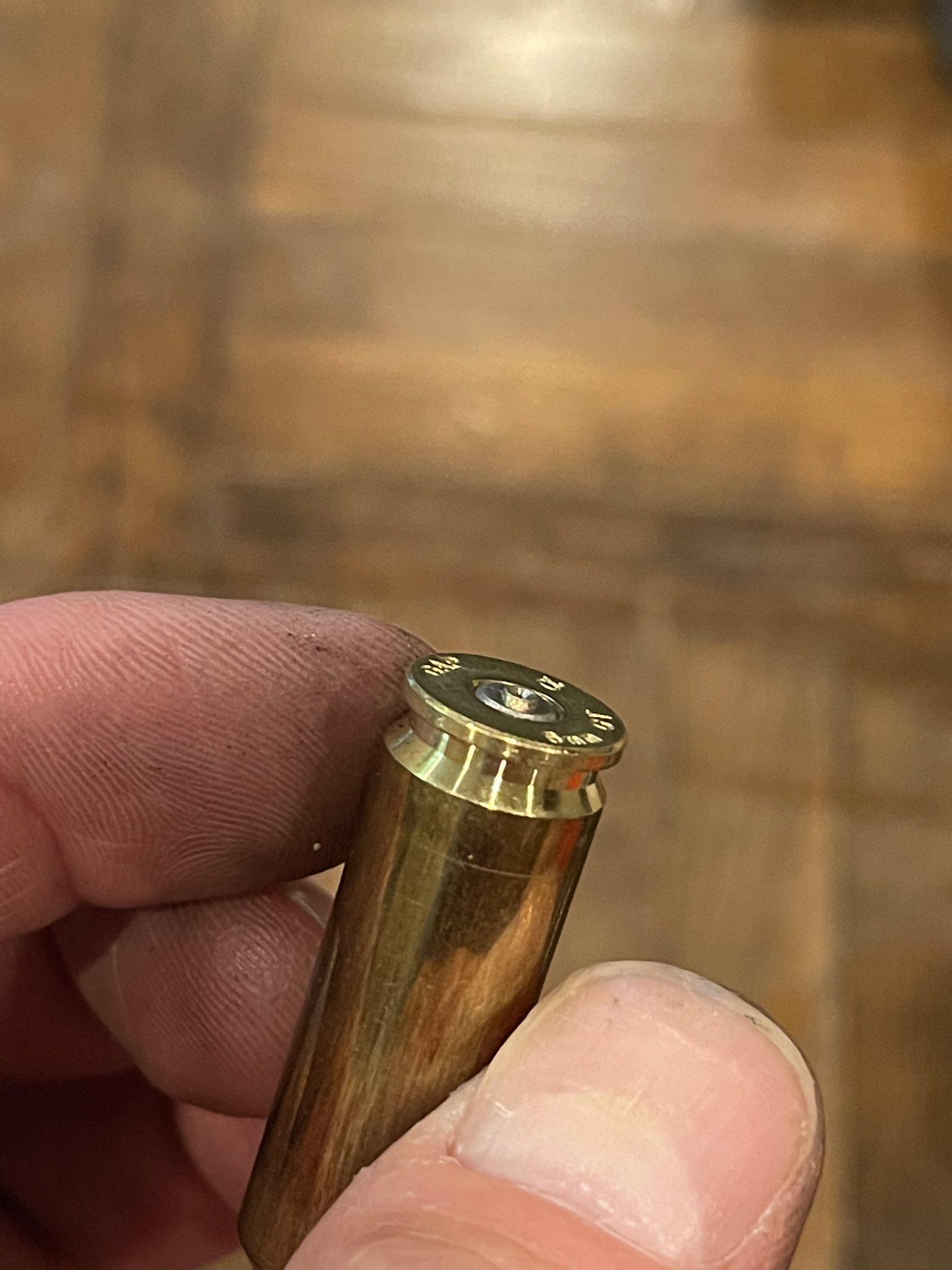

Looking for some input. I been running my 6 gt loaded up with 36gr of h4350, alpha brass, br4 primers, with a berger 109lrht. I have been getting a velocity of 2868, and at my match today i was experiencing some hard bolt lift. I am running 3 thou of neck tension on annealed brass, seated 1.935 cbto, which is .065 of lands. I bump my shoulders 3thou. It was also 100degrees at the match today.
So does any of this sound off and would cause a hard bolt lift on a defiance action? Primers look very good, i do get a slight amount of ejector swiping.
I run nearly an identical load except I use CCI 450s and get about 30 fps faster. No heavy bolt lift and it shoots extremely well. As long as my ballistic app is set up properly.* :rolleyes:
Man I run 36.2gr h4350 with same bullet from a 28" barrel at 2910-2920 cci450. Its an extremely mild load, i can get near 3080fps before bolt lift on an ARC nucleus gen2. How many firings? Check the diameter of a sized case at the web area vs a fired. Perhaps the web isn't getting sized enough by your dies? 3k bump is a bit more than necessary, I usually strip my bolt down and size a case just enough to get the the bolt handle to falls shut on its own weight, and go one more thou, usually works out to 0015 or 002 from fired.

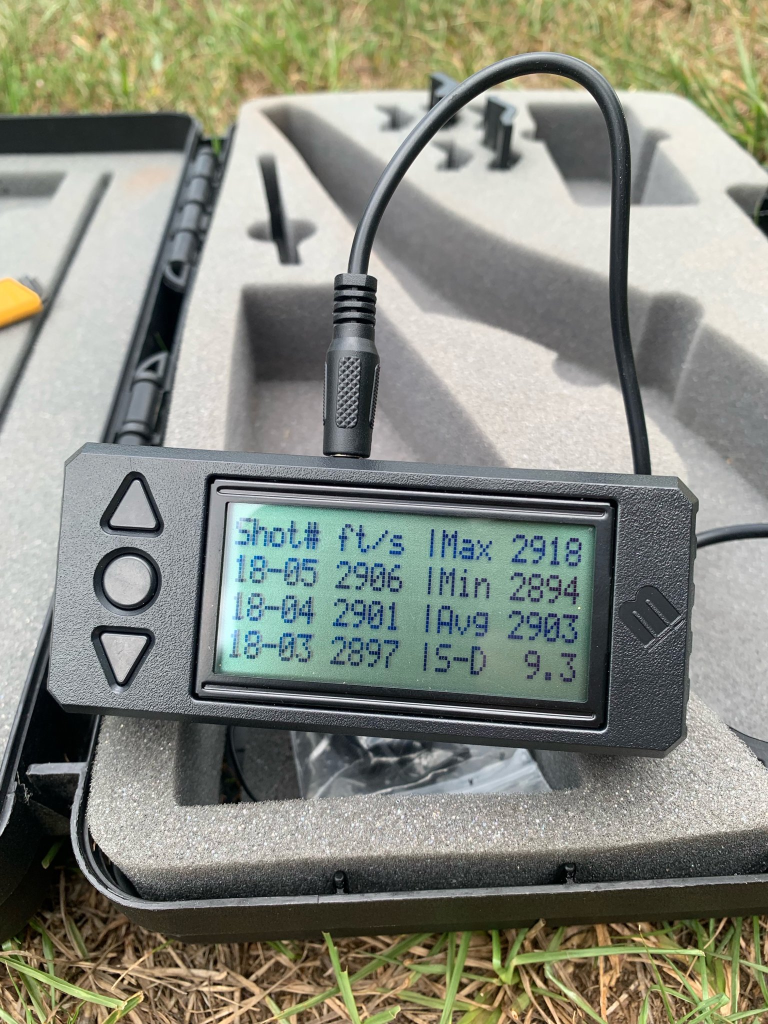

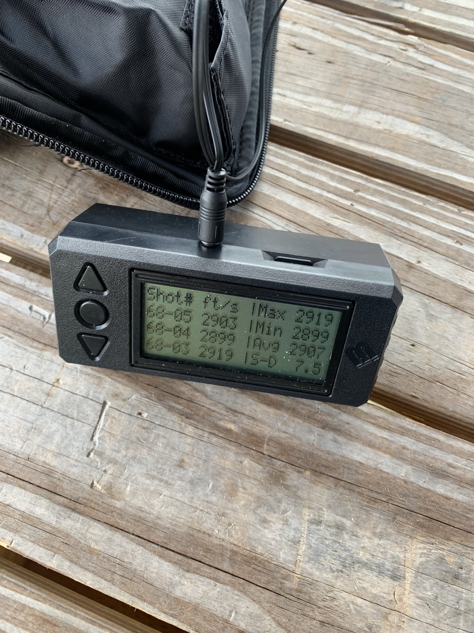

Hornady 109 factory ammo is getting me top 10 finishes and production wins. I love not having to deal with sitting at the reloading bench. The amount of time saved is incredible. I don’t even need to pick up my brass anymore on stages.
I know this is a reloading thread but I thought it may be valuable to anyone who is on the fence and feels like they need to reload.
This stuff rocks.
9.3 SD were the first 5 rounds out of the rifle.
The other image was round 175-179 after the final PRS stage for the day.
This stuff rocks.

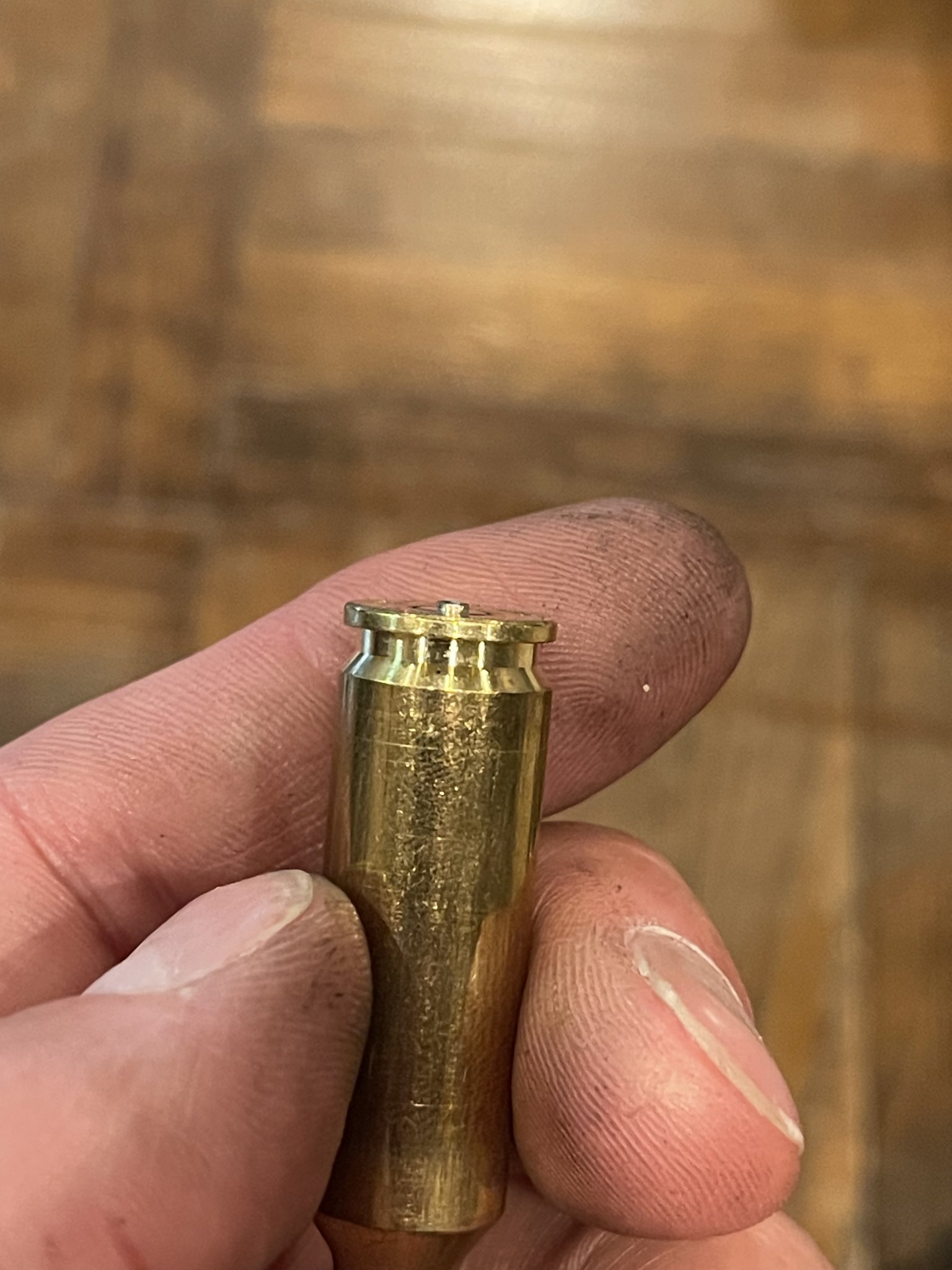

I got 15 firings from the Hornady brass before slight case head separations occurred on 7 out of 100.

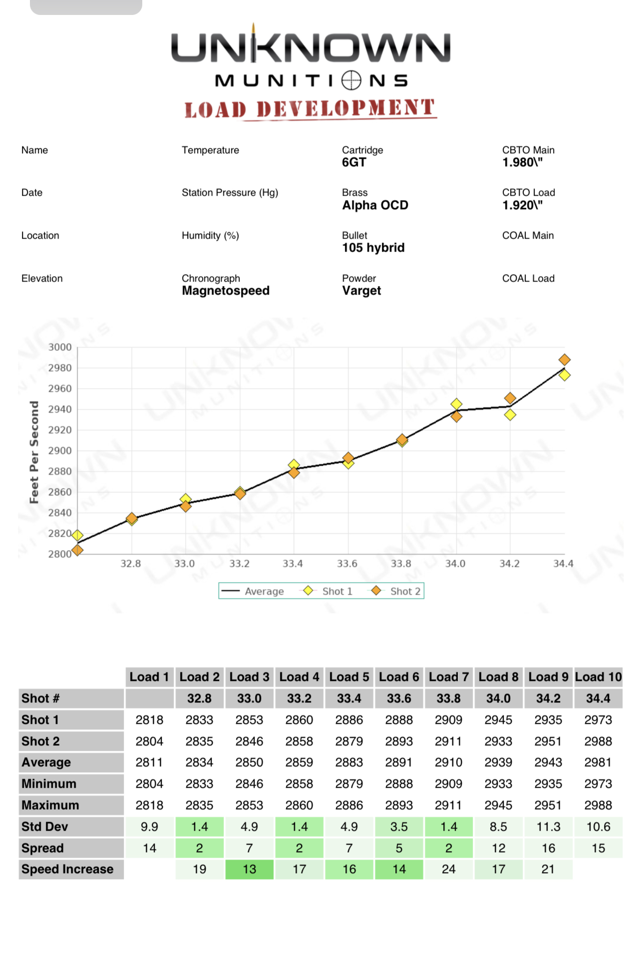

I’m no mathmatologist so could someone explain what it means when the line thingy goes more sideways than up in one of these? There’s been a few now. Not gonna lie I didn’t know how to do it until I saw the unknown munitions one a couple posts before.
It means nothing. It's a Rorschach test... guys see what they want to see.
Some may call it a "node" they found using their "data"... but they'd be willfully ignoring the overwhelming likelihood that the anomaly they observed was just a simple coincidence, especially since it occurred while shooting a painfully small sample size of rounds (nowhere near enough to know anything or say anything with any certainty). Some of those same guys also speak of performing tedious and ridiculous rituals as essential to breaking in a new barrel. Some even claim to have possessed lots of bullets that went to sleep on them at inopportune times. Sleeping bullets. 🤔
If you want to burn 50rds worth of components and barrel life figuring out that, with that powder in that barrel, ~33 grains nets ~2850fps, and ~34gr nets ~2950... that's cool. Just know, you could've figured that out with 2 rounds, and then loaded 48 at your preferred speed.
Combustion requires fuel (powder), more fuel means more combustion, so more powder means more speed, derp. Combustion remaining constant while adding more fuel is not a thing (ask NASA).
If you ever run into an actual person educated and practiced in combustion and propulsion at a party, see how far you can get into explaining "nodes" and/or an "OCW test" before they spit out their drink laughing...

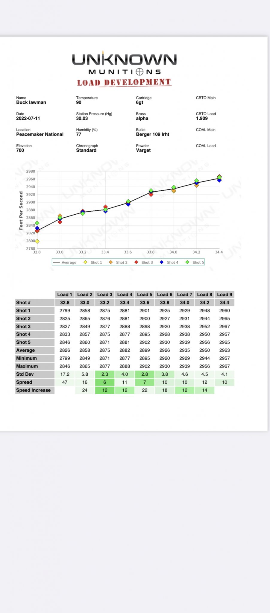

Speaking of 6GT, I'm just about ready to prime and charge 500 cases...
H4350 and Hornady brass, was @ 34.5 grains and typical velocity of 2700. Maybe I'll bump it up to 35.5 - 36 grains. Thoughts?
I have no first-hand experience with 6GT just yet, but IMO, with any cartridge, that's pretty much the only reason to bother doing a ladder... to find out what it takes to get the speed you want and/or what you can have while remaining safely under the "oh shit" zone. Since I'm not as obsessed with speed as some, I don't usually load hot enough to where I'd have to worry about pressure. YMMV.

I have 6.5 Stabal, Varget, & H4350 on hand, but I started the 6GT on Vit N555. Never had to hunt for a load in this thing. Works so well I've had no reason to try anything else.
38.6 of N555 with Berger 109's = 2920 from a 26" PVA. Nice case fill & is a pretty clean burning temp stable powder in my experience so far.
There was no hint of pressure signs at that speed. I just stopped there because it was a full case & saw no point in chasing speed any higher.
2800 - 2930 with Berger 105 hybrid or 109 LRHT it shoots the same tiny groups. Like you said pick your speed.
