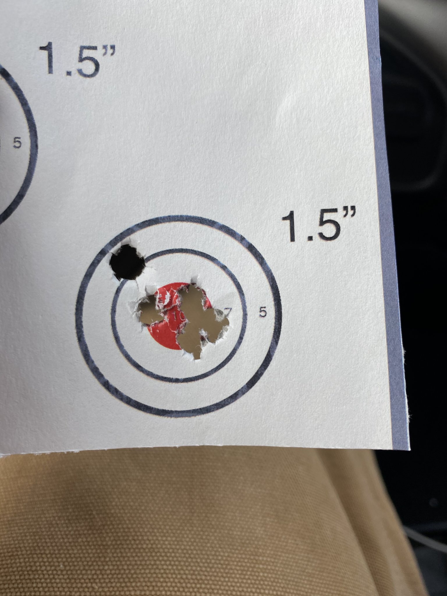

Anyone neck turning the Hornady brass? I received 400x pieces yesterday, pulled 20pcs to sample, ran a mandrel to uniform necks, and one side the neck is 0.0125, the other 0.0135 this was consistent on all 20 cases I measured, I suspect it's the same for the whole lot probably.
What's your purpose? Is your goal 1 hole at 1000 yards? Or are you shooting PRS/NRL/CD matches? If the latter, neck turning is a waste of time.
You won't see any accuracy difference between turned and unturned necks. Its one of those things that makes people feel good about their reloading practices, but it won't accomplish anything.
Reactions: Darkside-Six
This is with virgin Hornady brass with nothing done to it. Just loaded and shot, no mandrel even.
The group in top right was with brass I had pulled all the bullets from on an old load, just stuffed the bullets back in without even re-doing neck tension.
As has been said, neck turning the GT is a waste, spend more time shooting and less at the bench.
I have. You can decrease your ES a bit. But for prs type stuff, your ES will already be well inside the targets we shoot.

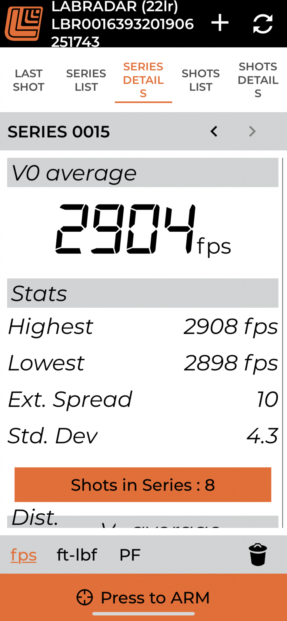

OK after finding a load that gave good SD and ES, I measured my CBTO length and started with the shortest of the five I measured (2.0175), loaded up 5 rounds with that seating depth, and then did four more batches of 5 at; 2.0145, 2.0115, 2.0085 and 2.0055. 2.01145 was the best with minimal vertical stringing (one called flyer). So that's going to be my load.
GAP brass
CCI450
34.9g RL16
109g Berger LR Hybrid Target
2.0145" CBTO
2929fps @70*
SD 4.8
ES 13

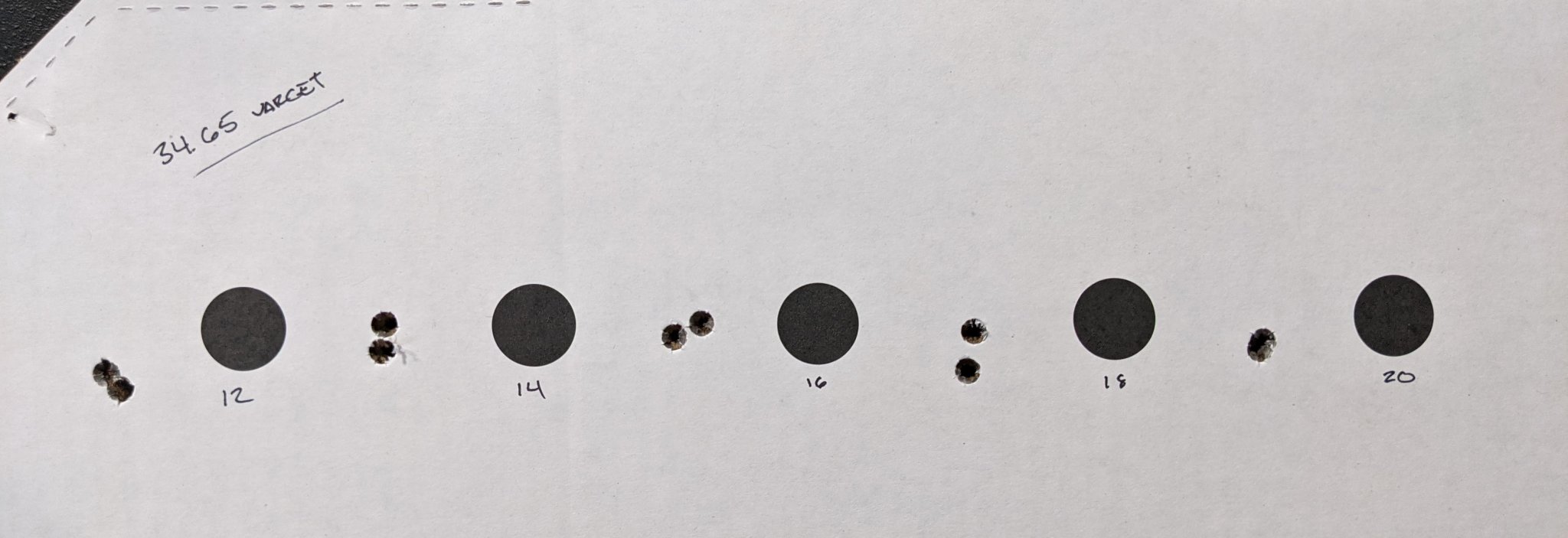

2932 fps from Bartlein 26" bbl 1:7" Twist - Barrel only has 120 rounds through it.
Wanted to work a load up for The Guardian.
Used the ATS Tuner behind a APA Little Bastard Gen3
34.65 gr Varget
Berger 109 LRHT
Alpha OCD
CCI 450
0.020 jump
2924 fps at 54*F
Dots are 3/4" Avery Dots
This is 60 total rounds (of course the LabRadar skipped 6 of them...)
ATS Tuner (12 was starting point - went all the way around - settled between 20-22)
10 round groups
My barrel (25" Benchmark) sped up considerably after 100 rounds.

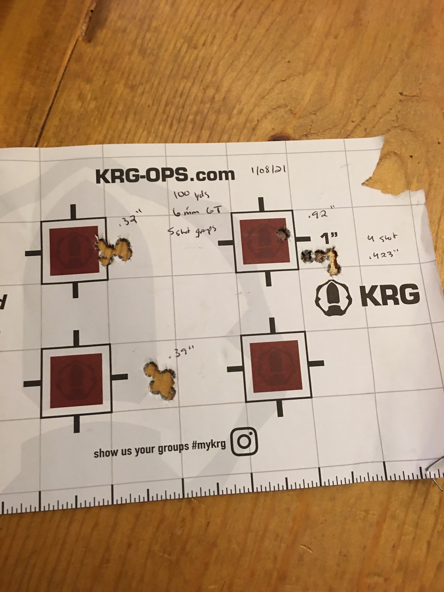

Picked up a used hawk hill 7.5 twist and multiple fired brass this was my starting load...
109 berger
0.050” jump
GAP brass
CCI 400
34gr Varget
5 shot group with a called flyer
I think I’m done 🤷🏻‍♂️
seems a touch slow compared to similar recipes could just be CCI 400 vs 450?
this is my first 6mm and ease of load development alone is worth the switch

IMHO your speed is more than fine, and i wouldn't worry about the primers . I would take that any time , also remember the hotter the faster your barrel finishes.
Ya I’m not worried about speed at all. Thought about maybe trying to find next lower node even. For my budget I’d really like to extend barrel life as much as possible
if i am not mistaken , I think I have read that the pros have even lowered their speeds to like the 2800 fps, but PLEASE don't quote me on this. I might be wrong.

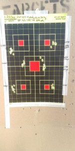

I tested em today with 36.3gr Rl16. 10k-30k off lands in 5k steps. 10k was 3/4" 15k was 1/2, 20k was dang near one hole. So I decided to shoot 25 and 30k off at 400y, they were both bout 1.25" for 5 shots. The whole string of 25 rounds had an es of 22 with new Hornady brass and cci450 primers.
That’s good to know thank you! So your thinking jump wise in the 20 to 30 range?
Yup, I loaded some more this am to go an verify at 400y again, the longest I have at my local range. The Hornady gt brass has been very erratic. I chamfer/debur all 400pcs, ran necks through 242 mandrel. I'm getting very inconsistent nk tension, so easy seating, some tight as hell, have to dial an extra 8k on my seater to match the light seatings. To get it consistent, I had to anneal all brass with my amp, and run the mandrel once again. Hopefully once everything is fired, annealed and sized these problems go away. It shoots well regardless with pretty decent es/sd.
