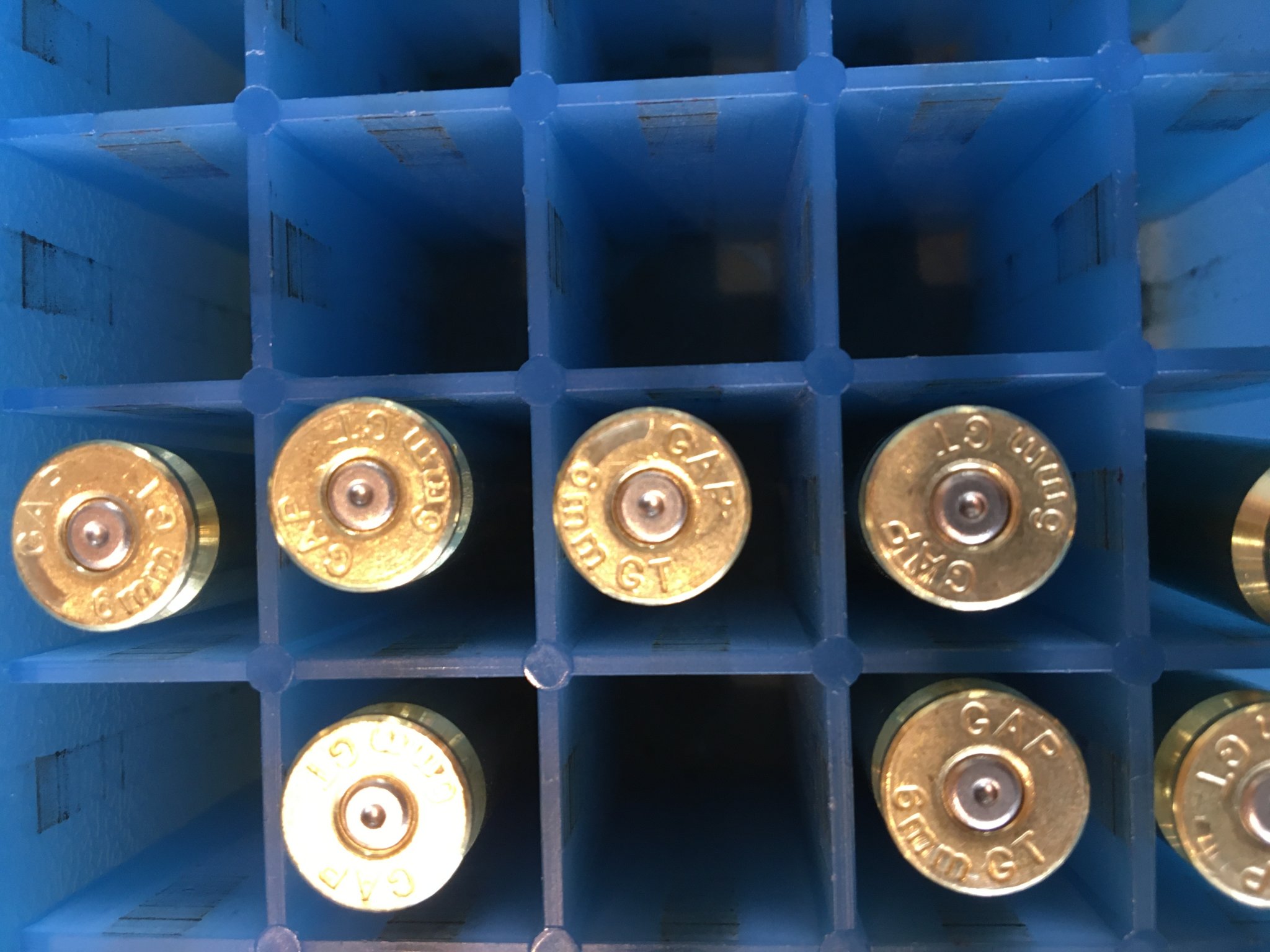

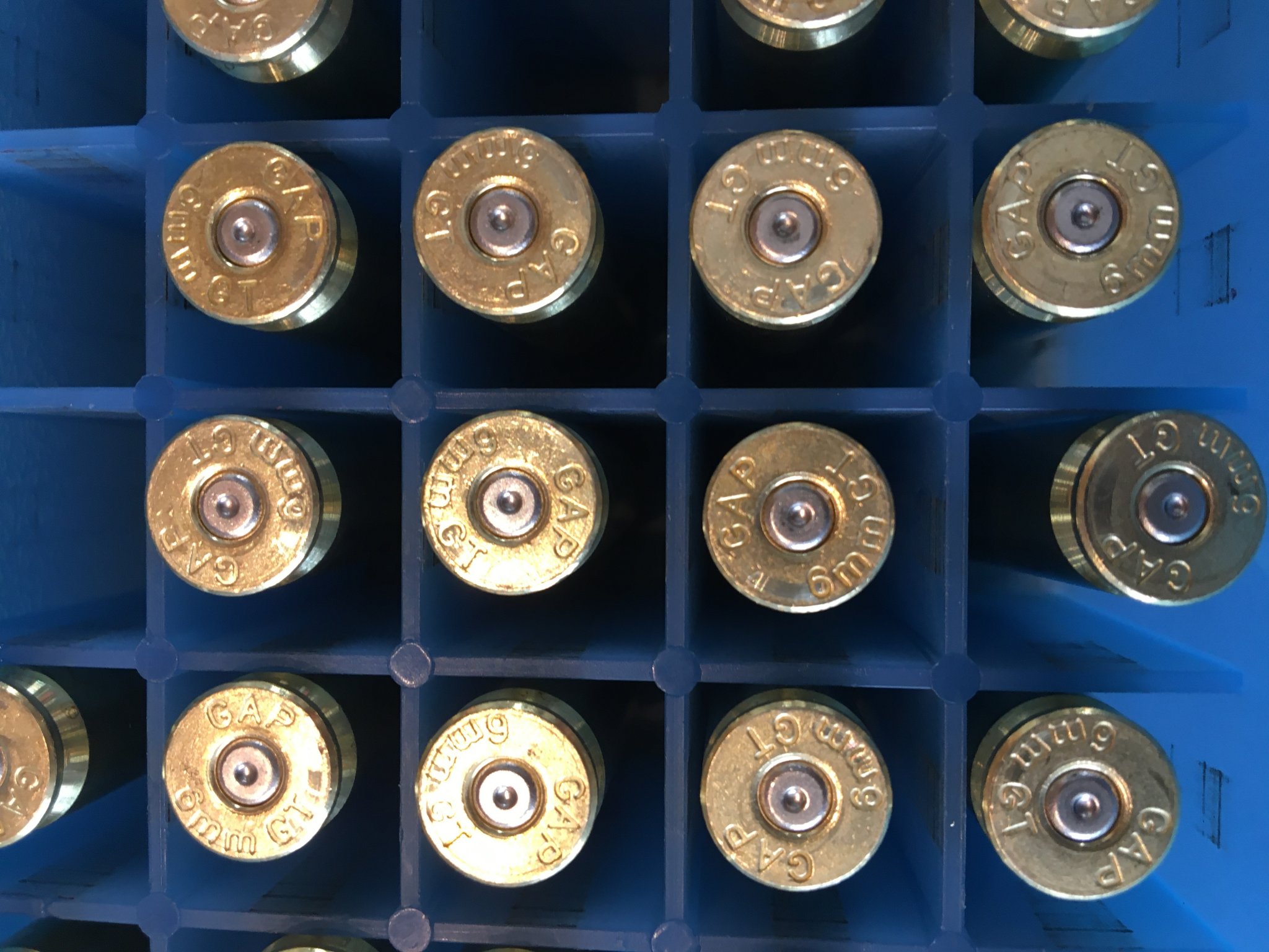

This was my node in the pics below.
But within 60 rounds of shooting those rounds across the chrono and shooting that group, my velocity climbed up, my SD was ridiculous, and it stopped grouping.
So I scrubbed it, it was filthy with copper and carbon. And it went back down to a 4 SD in 10 shots, and was single hole again.
So I took it to an NRL match, 190 rounds. Just checked it yesterday, and its back to 18 SD and 51 ES. Utter garbage. There's just no excuse for it.
And they are the exact same rounds I loaded and checked before the match. I loaded 250 at the same time.
