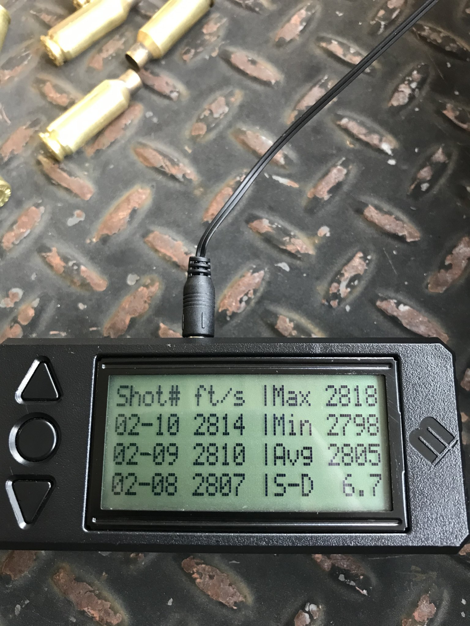

Runs a 108eld to 2805 with a gas gun load of 29gr of CFE223… and I load it on a progressive… with cheap starline brass
Hm I’ll need to chrono my 26” bolty after I finish breaking it in and compare to my 20” semi after I finish breaking that in.

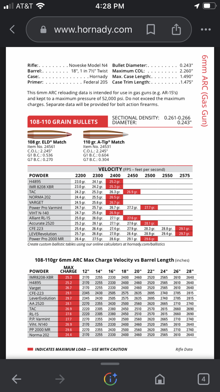

And I’ve ran a 108eld to 2950 in the 28” with CFE223… but that Is MAX and I won’t trust running it with a temp sensitive double base ball powder

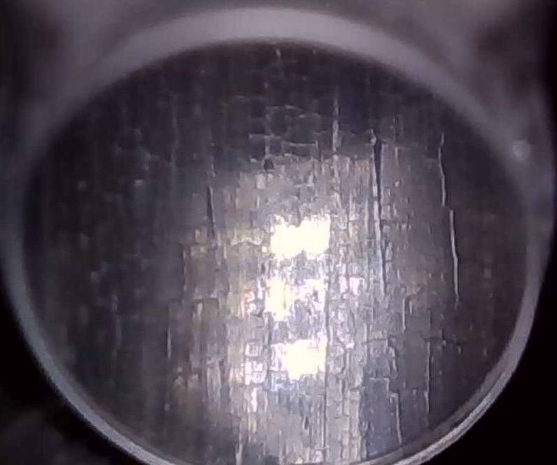

Both mine sped up at 300ish rounds… 26” jumped 70fps and the 28” jumped 40

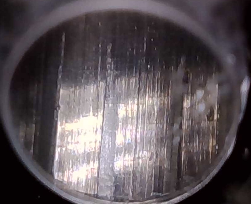

I'm really enjoying the 6ARC for PRS. Granted this is my first season and I'm a shitty enough shooter that it's more about learning than being competitive.
Tried reloading it with 103 eldx's, 107 SMK's, 108 eldm's and 112 match burners. In a stock Savage bbl I haven't been able to get anywhere near Hornady's advertised speeds without hitting pressure signs. I've spent the most time shooting 107 SMK's at 2615 with 27.9gr of LVR and 112 match burners at 2525 with 27gr of LVR.
I have a Rock Creek bbl from PVA on order that I'm really excited to try for both a better rifle balance and hoping something will be different about the chamber and I'll be able to get another 200fps out of it.
All told I'm having fun with it, and the throat is holding up amazingly well for having 1300 rounds through it.

Thats good to hear. It's the first time I've ever seen primer flow and hard bolt lift while not being even halfway into the published load data range. It was disconcerting.

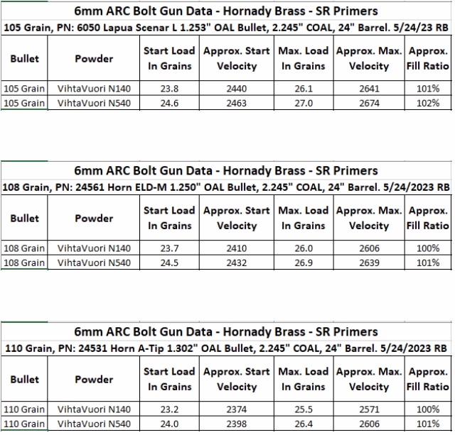

Try some N140/540 also. Both will be much more temp stable than Lever or CFE.

I was going to buy some N140 to try with the 110 ATip but seeing the Varget recommendations and also the CFE223, both of which I have, I might try some of them first.
