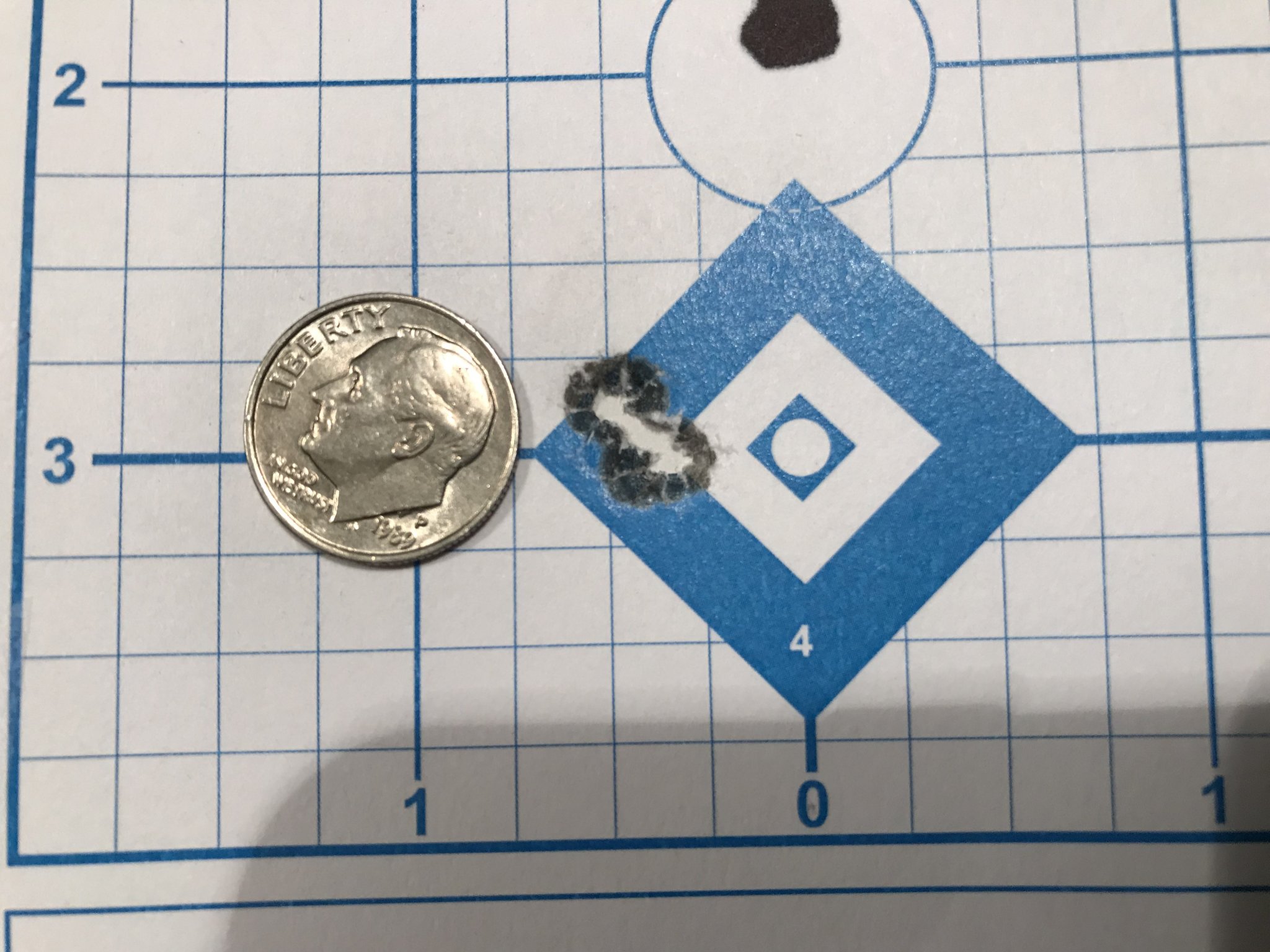

Think I might have it dialed in finally. ( felt the one to the left )
4 shot group @ 100yds.
26 inch HH med palma, MPA, Lapua brass, CCI BR4, IMR 4166 @ 3035 fps, 95g. smk's .019 off
