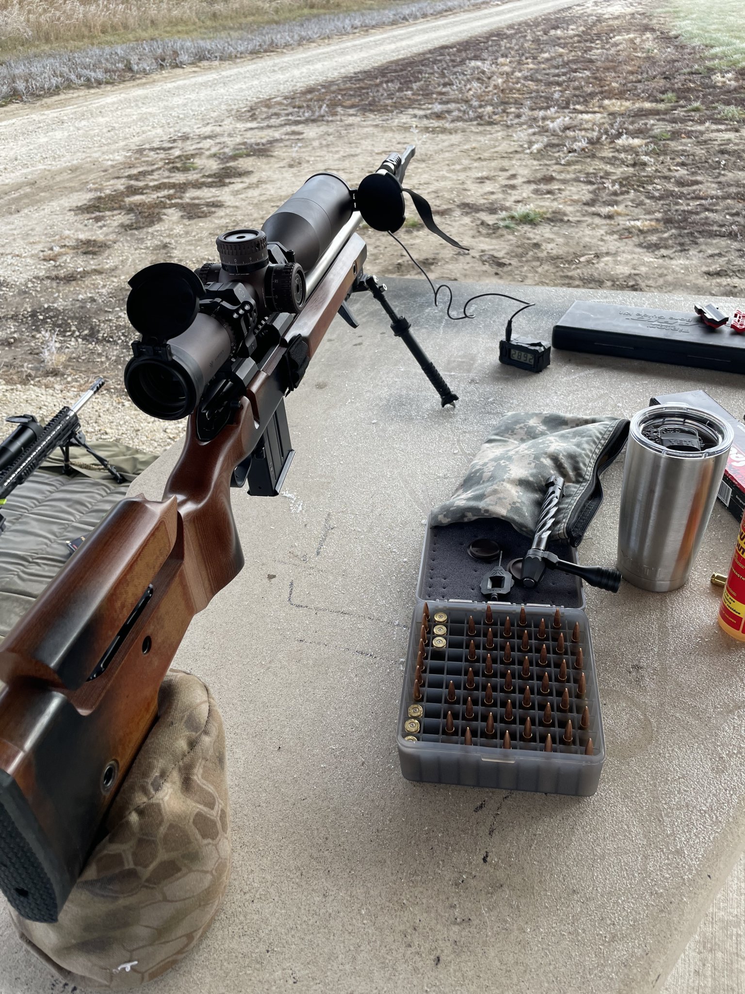

Tested the new lot of H4895, a fair bit faster burning than the old lot. Old one was giving me 2863 fps with 30.3gr behind a 105 hybrid, new lot was 2906 fps, 28" barrel. About a half grain charge weight difference to get equal velocity (29.8 gr is pretty close to matching). New lot seems to shoot a bit smaller groups. The best groups and SD's seem to be in the range of 29.8 to 30.1, between 2865 and 2885 fps.
Also dusted off my old original 6BRA 26" barrel which has 2700 rounds on it. My 14 year old daughter is learning to shoot and I had her do the testing since she's going to shoot a match with me. That barrel performed best in the same range as well, everything from 2840 to 2880 fps was in the 0.3's with her shooting. Settled on 30.1gr at 2865fps to mirror my other barrel, so I only have to keep track of one set of dope during the match. :)

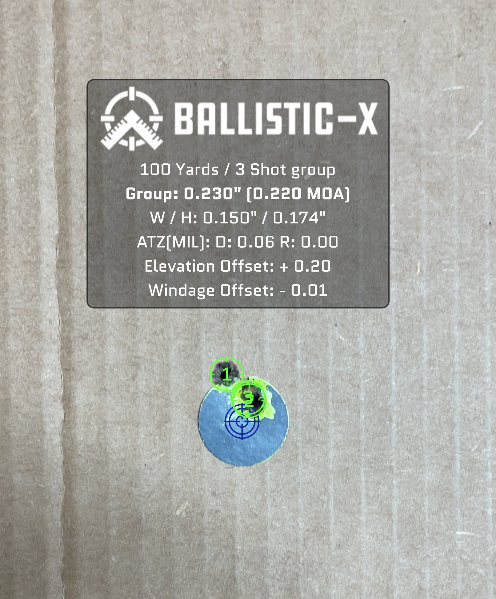

Well. I’m going backwards in velocity and ditching the 6CM train for a 6BRA barrel. Gonna be running lapua brass, varget because I have 20+ lbs of it, and CCI 450’s for the time being with a 109 hybrid on top. I’ll post data once I have it for others future reference since I haven’t seen much with lapua brass, varget, and 109 hybrids

  • 6mm BRA Brass, Alpha Munitions
  • CCI450 Primers
  • Berger 109gr LRHT's jumped around 0.020"
  • 31.2 gns of Varget
Right in the sweet spot of 2880 fps and shoots great. There is another node at 30.3gns of Varget (2780) and the recoil feels significantly softer but I'm having great success at 2880 so I'll stick with it for now.

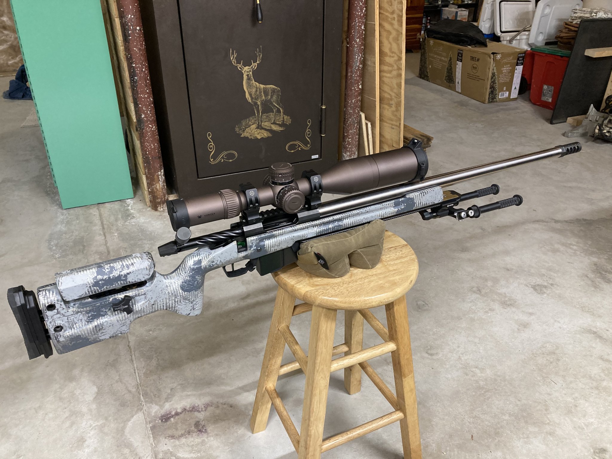

So I'm in the process of building a 6mm BR-A right now. It's going to be a Lone Peak Fuzion with a 26" Rock Creek from PVA, and a Foundation Centurion. I picked up Whidden dies, neck expander, Alpha brass, Varget, H4895, and SW Precision to work with. Problem is that I can't find much for bullet selection in stock.

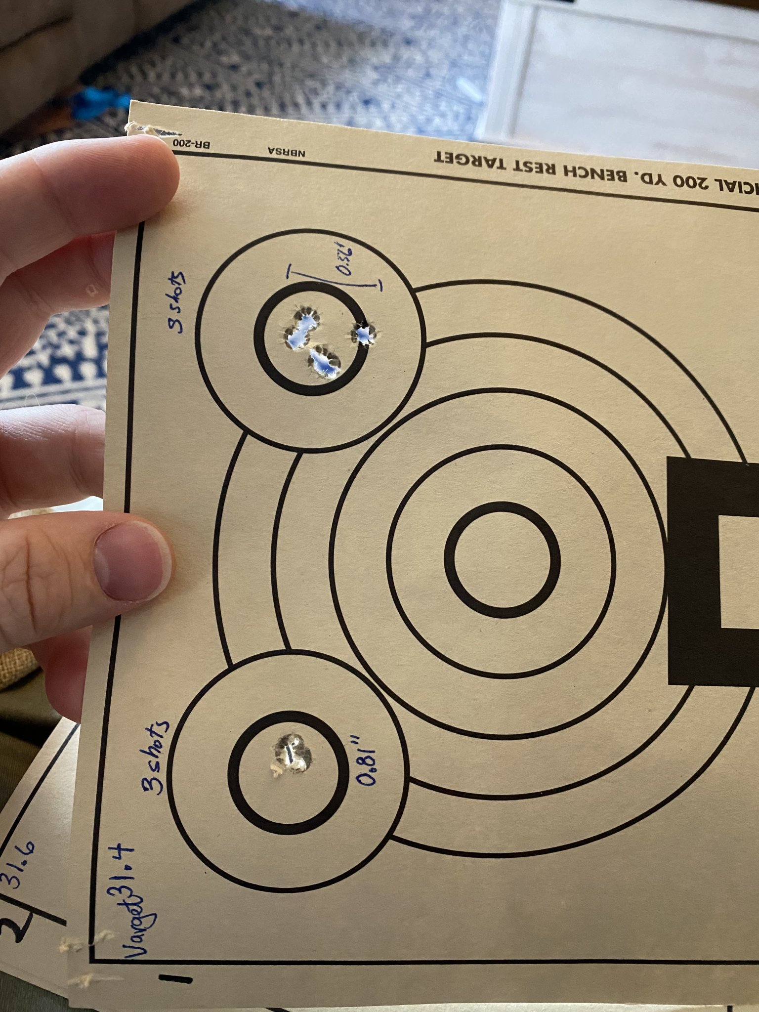

Here’s the 31.4 warm up groups. Smallest 3 shot group I’ve ever shot.(it was 0.081” not 0.81”)

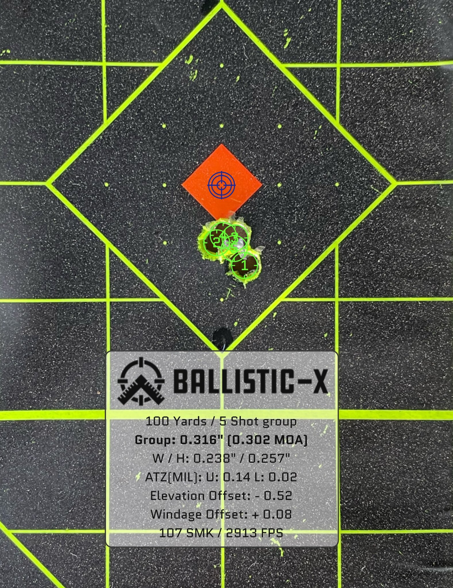

Finally made my first range trip with the BRA. Barrel came in Thursday so I spun it on and loaded up 50 rounds to do some break in.
Ended up finding some 107 Matchkings so I loaded those in Alpha brass, 30gr H4895, and 205M primers. Velocity was 2,913 fps and accuracy was amazing. The 3 - shot group below were literally shots #4,5,6 through the barrel. I did see some ejector marks on the brass, so considering it was 20 degrees out I think I'm going to work up a low node for summer.
Kinda feels like going to the dark side since this is both my first custom rifle and my first 6mm hot rod cartridge. Blew my mind how easy this was. I'm definitely hopping on the band wagon 🍻🍻

On your load, you might want to try Varget.

I would back your load off to 29.5 grains of H4895. Perhaps even 29.0. 30.0 grains is pretty hot for fireforming.

View attachment 7755565Hahaha I basically have the same damn rifle. Only difference is I’m running a Foundation Centurion stock.
Hahaha we basically have the same rifle
LP Fuzion
Centurion
26” PVA prefit m24
APA Little bastard
Arc rings
TT 2-stage
Gen 2 Razor
