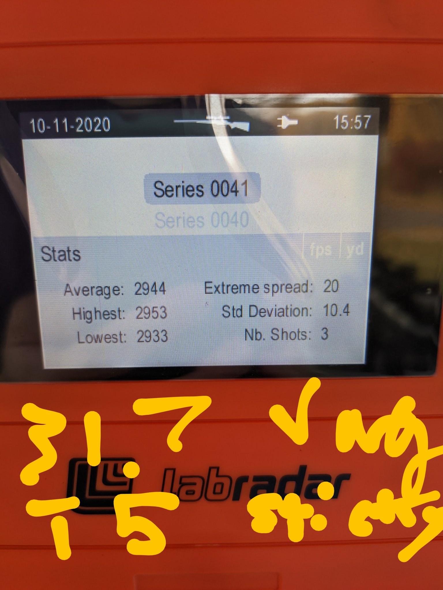

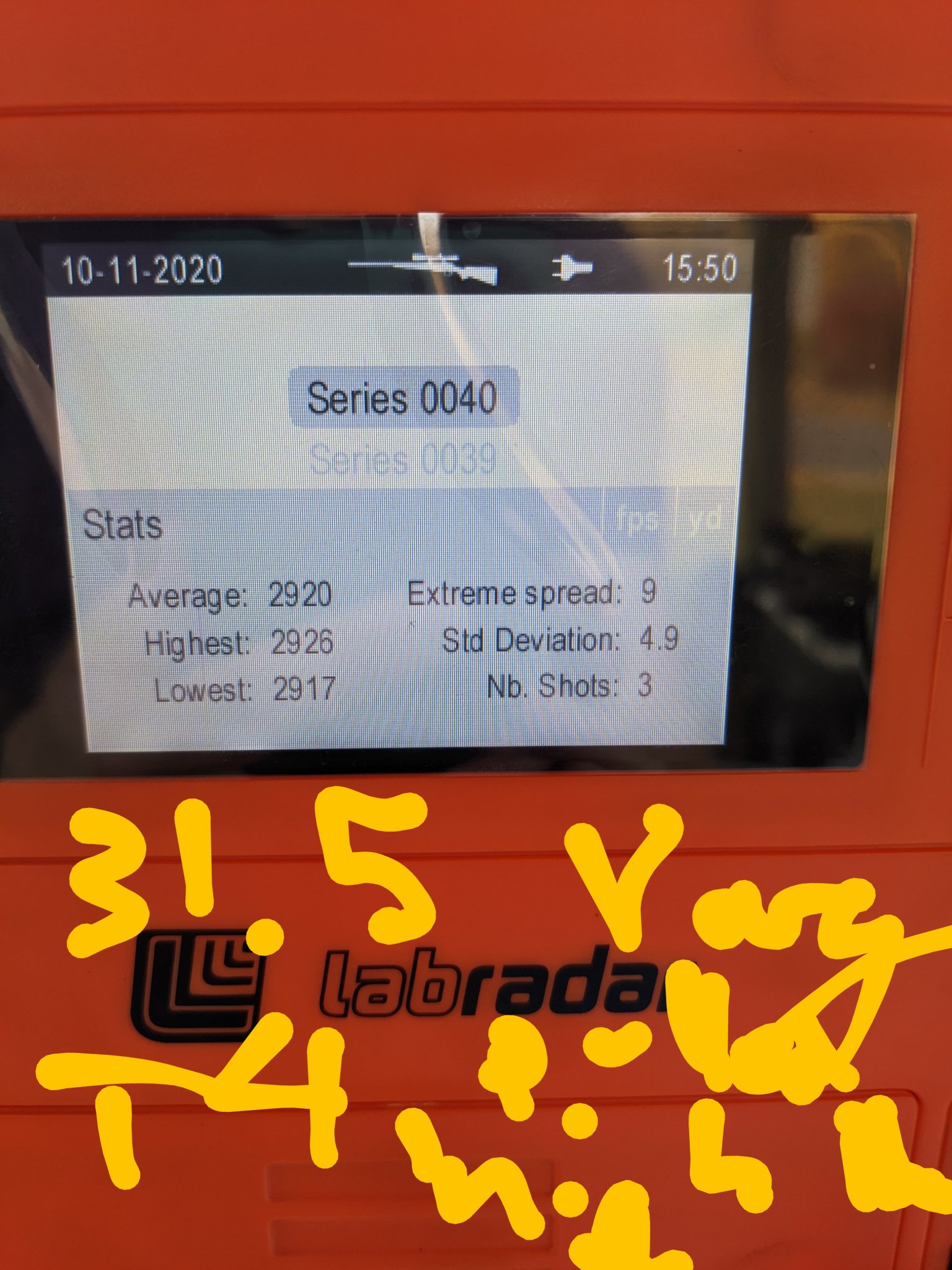

Sticky bolt with 31.7, as (badly) noted, and had a more flattened primer, over pressure for sure. 31.5 gr was way better and grouped well. Lot 7223.

So, regardless of speed, is 31 grains of Varget in Lapua brass with 105 hybrids over pressure?
If so, a whole bunch of BRA shooters are in for an awakening.
I don't think it is. I run 31.4 with a tweak on either side depending on temp and bullet. I have brass shooting that load with over 15 firings on them, and pockets are still good. I do think lot #'s on the two most common used powders make a difference. I have old Varget from 2013 that is a lot faster/hotter than some of the newer stuff I have. Usually requires me to drop at least 2/10th to stay in my velocity node.
