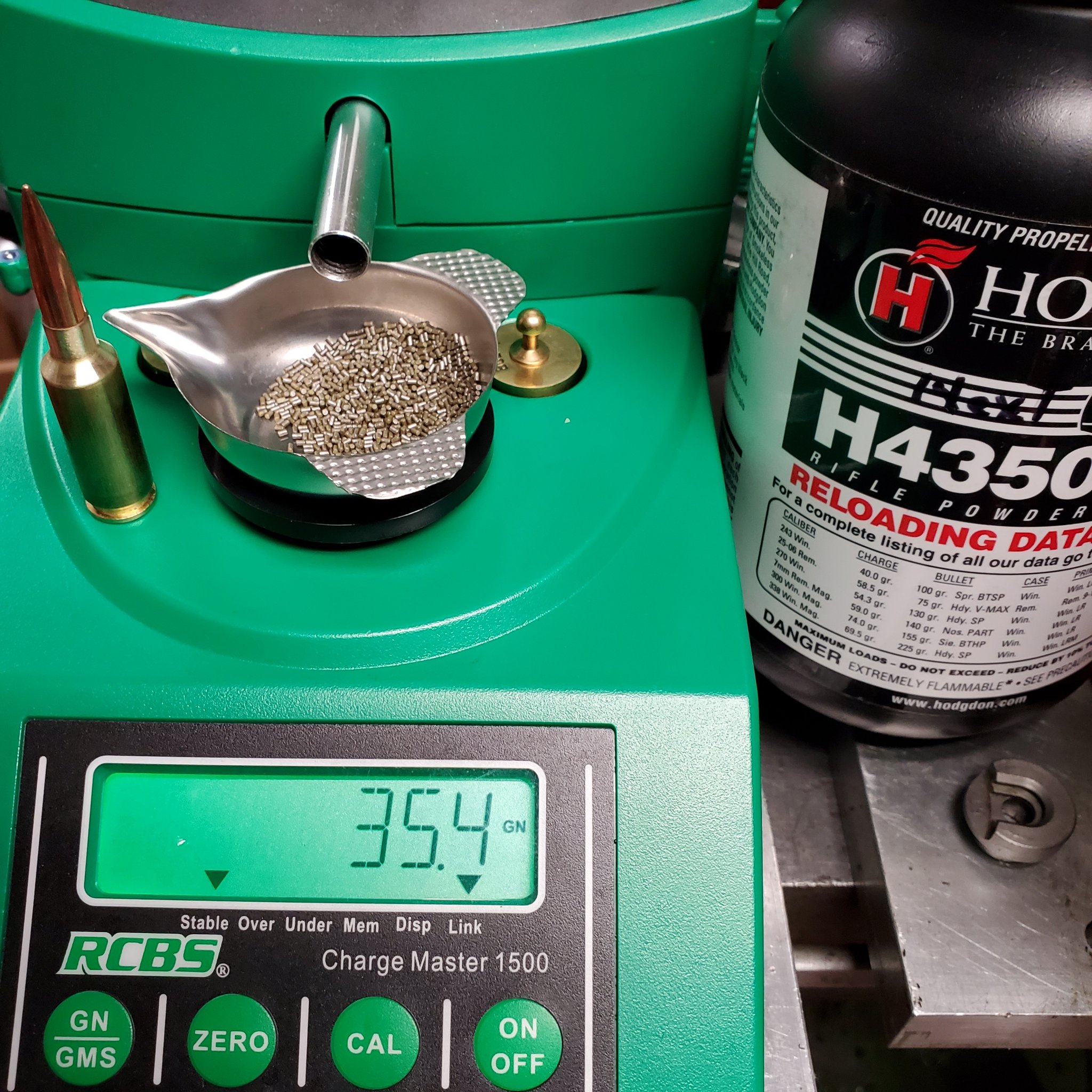

So here are the Facts: I have a 6 mm dasher and use Aplha brass, and can easily load 35.4 gr ( .2 above Hodgdon max for a 107 gr SMK) into the Alpha case and seat a 107SMK with a Forester seating die.
My fired 6 dasher Alpha cases hold 40.1 gr of H2O. And the Hodgdon 2020 Annual Manual P #84 has load data for H4350 107 gr SMK 35.2 gr (C for compressed powder charge) as a max load. Seems like I tried this load but, but do not have any data on it. According to Hodgdon you can load 38.3 gr of H4350 into the dasher case with a 90 gr SWT SCIR.
I load 40.8 gr of CFE 223 behind a 58 gr V Max, mabe a bit more...they are running 4100 fps out of a 7.5 twist and grouping very well for a varmint bullet.
I consider the 6 mm Dasher to be the best 6 mm available for accuracy vs velocity. It will run 110 SMK at 3085 fps, accurately...or slow down to 2950 to 3020 with a match bullet for one hole groups in the .2s" for not so good shooters.

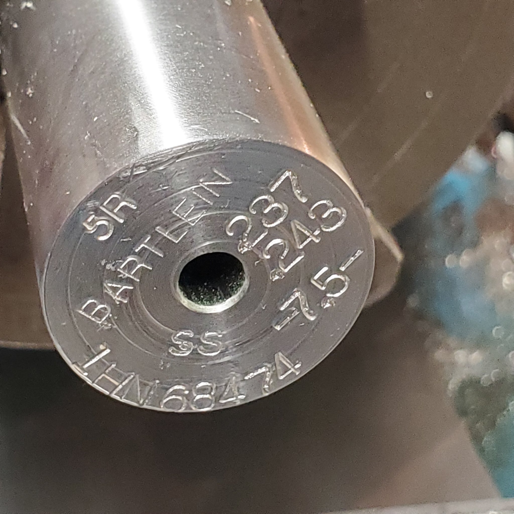

Can you please give some details about your barrel brand, rifling (cut or button), and length?
Also, what size groups?
I tried some 70gr, 75gr, and 87gr loads yesterday with terrible results from my 7.5T.

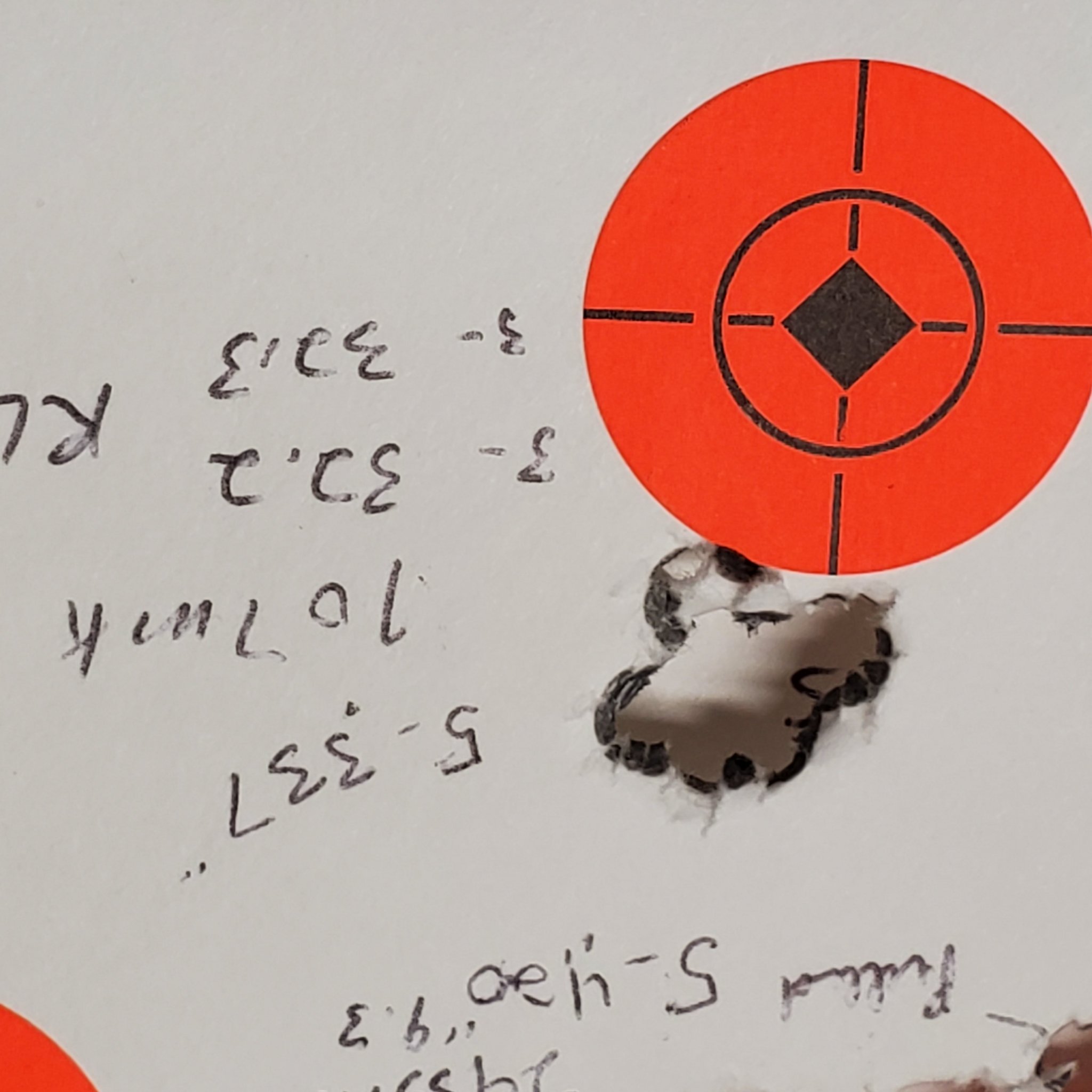

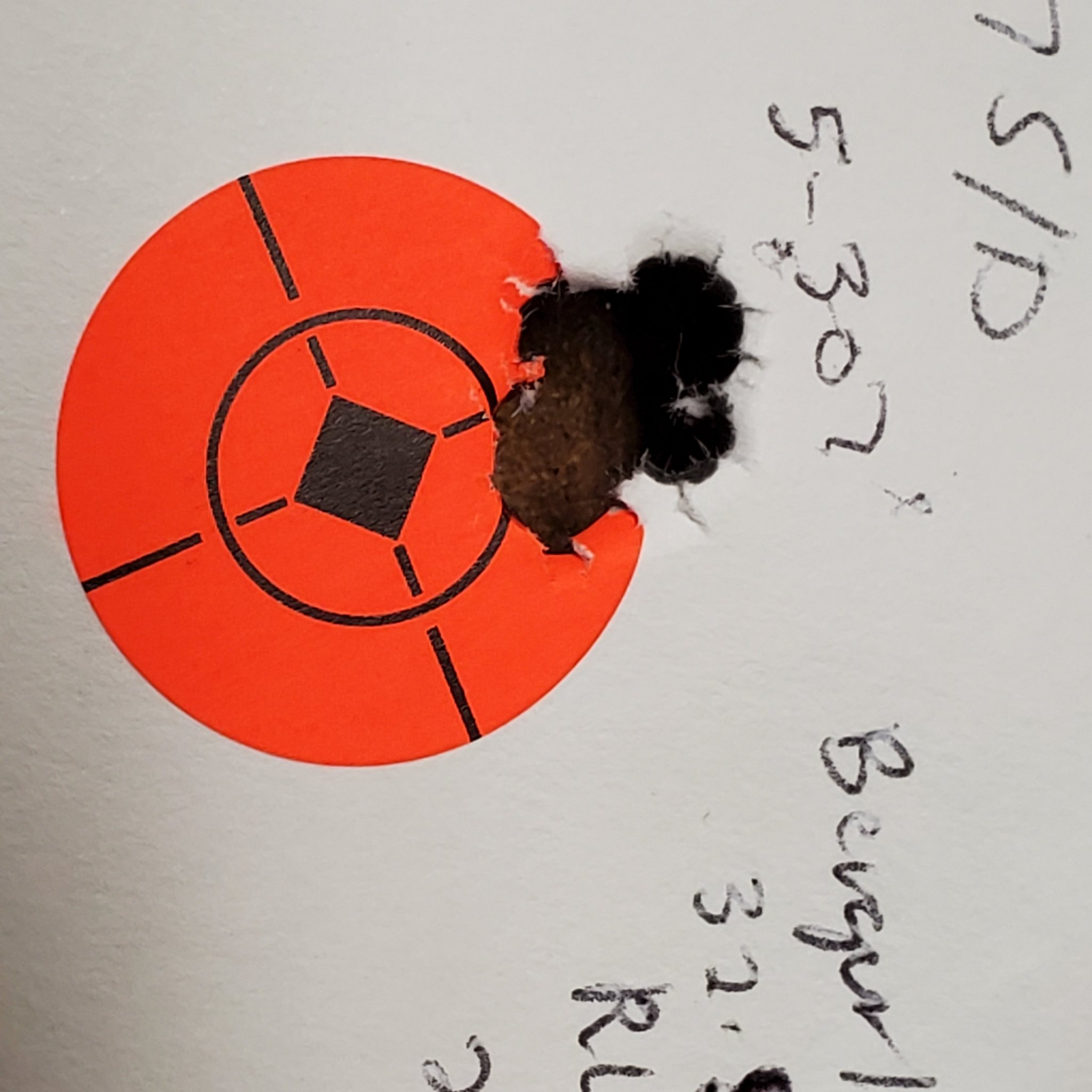

Bartlein 5 R SS 28" M24 cut rifling 7.5 twist. I'm not a very good shooter these days eyesight and old age, but it did 13, 5 shot groups with different powders and bullets the average of the 13 was, .313" I chambered it myself with my own reamer. It shoots 55 to 115 well, the 58 was good at 4100 fps in the 7.5 twist.

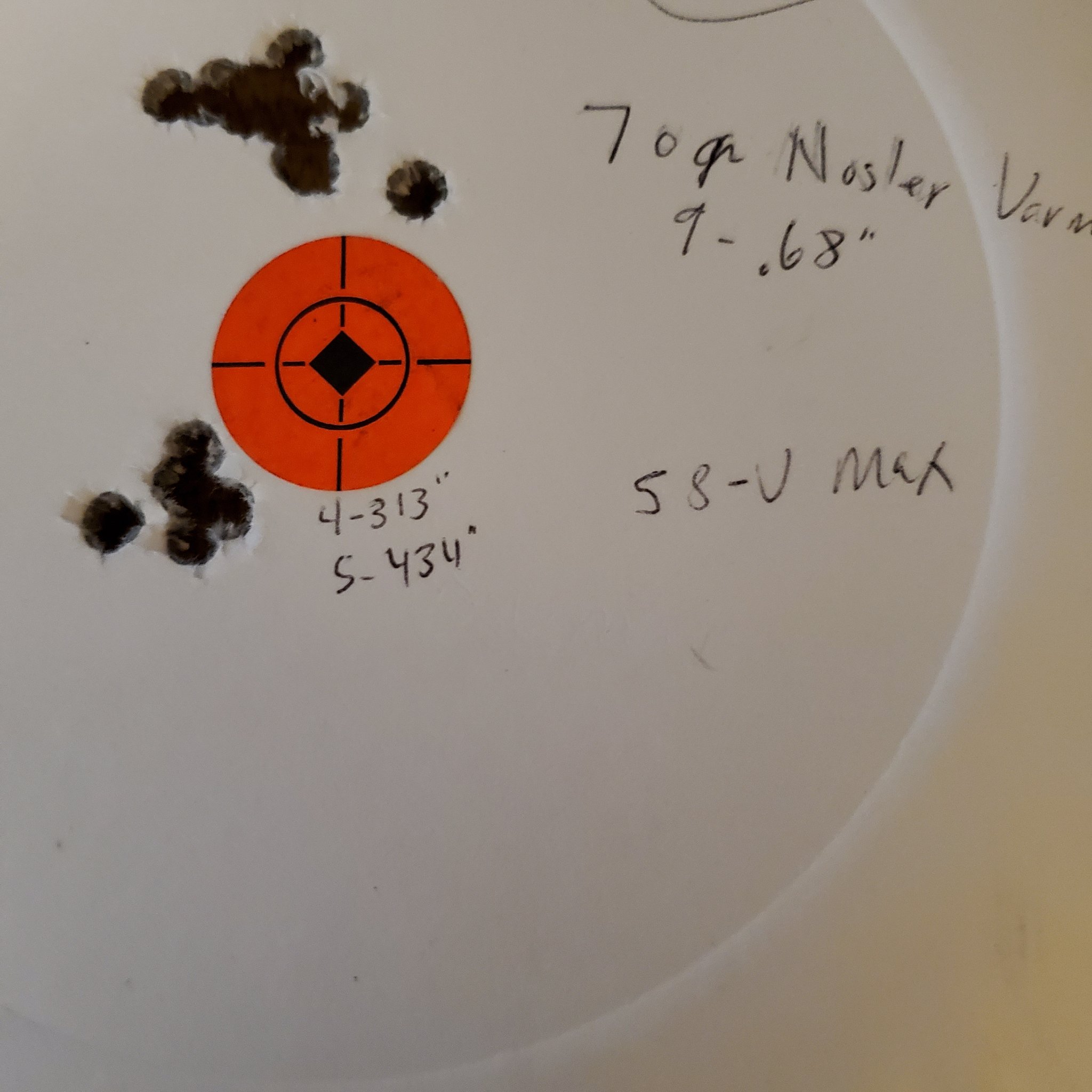

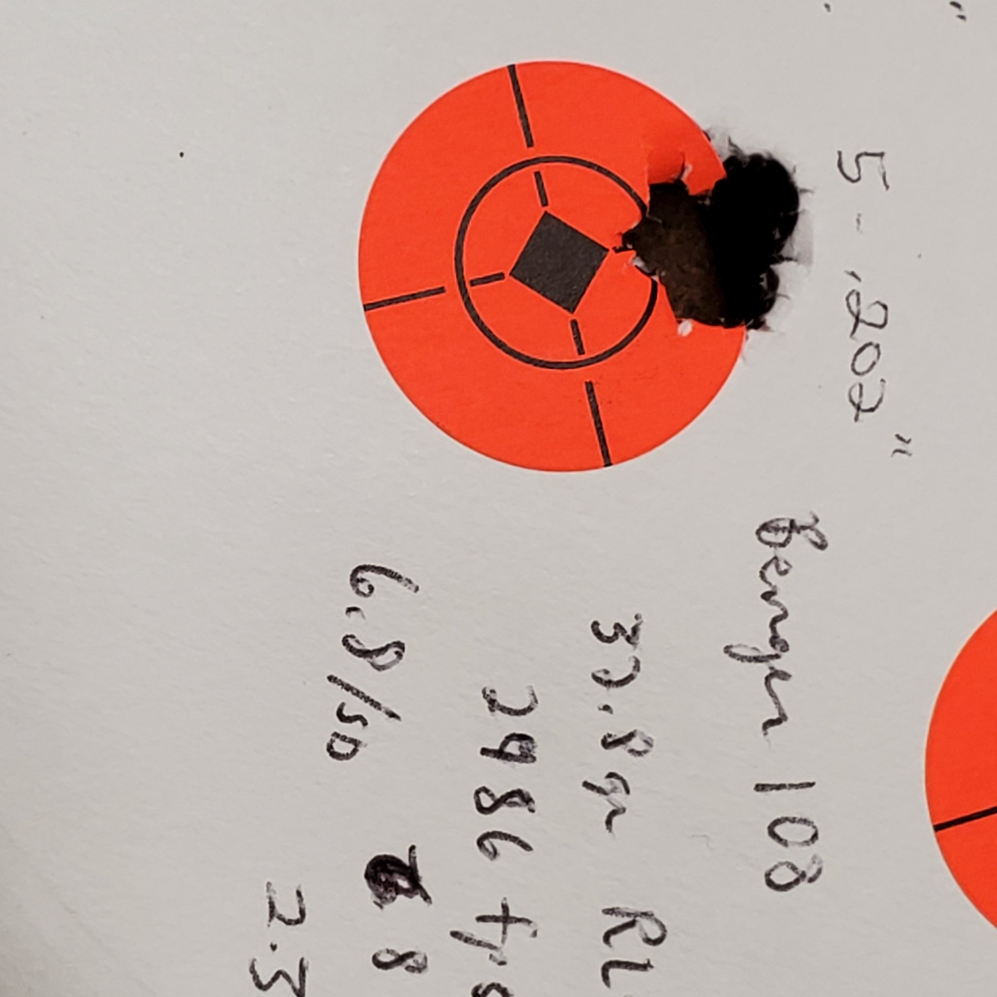

I found a target with the Varmint bullets in 6 mm Dasher at 4100 fps for the 58 gr and 3700 fps for the 70 gr. with the 7.5 twist. With better eyesight probably wouldn't have a flyer, and a good shooter could eliminate that...but that's an example of what I got.

^^^ NICE! ^^^
I would be happy with those results, too!
I have the same barrel, but 20", best group was 1.125", sadly.
Used Varget in all loads, perhaps a powder change would help?
Thanks!

Varget is a good powder for accuracy..."usually" in heavy bullet loads...in 6 dasher...but it seems to change its strips and sometimes the worst powder depending on the application including the 308 where it had a S/D of 58 fps on weighed charges in a 16" barrel.
So Varget can be a good choice, but not always the best.
Here I used CFE223 with the Varmint bullets, maximum load in the Hornady annual manual, for both bullets, with Alpha brass and Remington 7 1/2 primer. About 40.8 gr with 55 gr & 58 gr bullets...the 58 was fast and accurate, as well as the 70 BT. The 55 gr was ok but needed a little adjustment, lower velocity, or higher velocity...would probably do it, to where it comes together...but the other two are not picky fill it up with CFE223...work up to the manual max and give it a try. 6 mm Dasher is notoriously accurate, find the area your barrel likes.

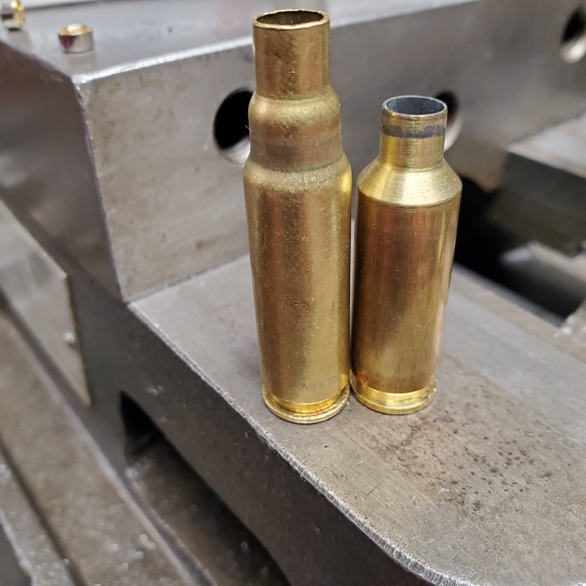

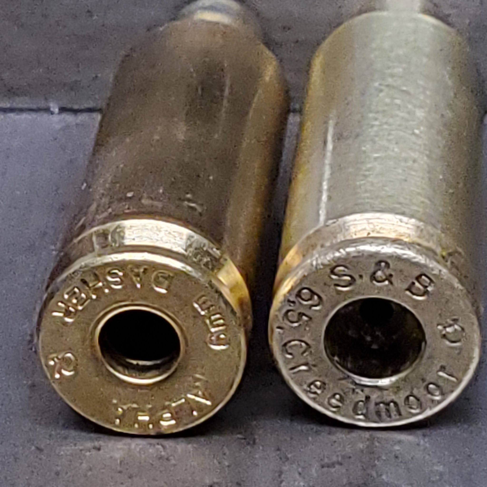

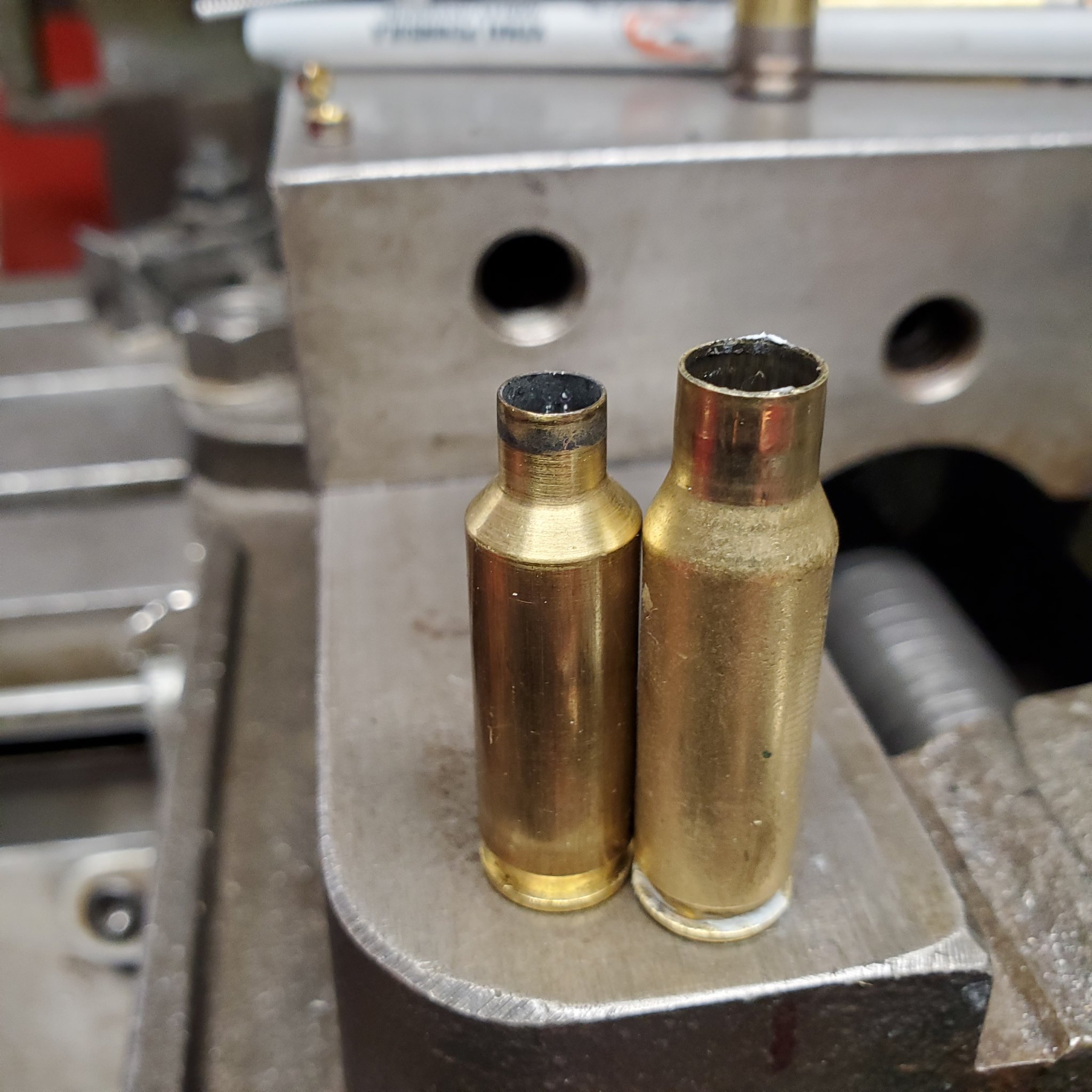

Is it possible to create Dasher brass from a six. five millimeter creedmoor case?
Reactions: 45-90
Yes, you can...but should you?

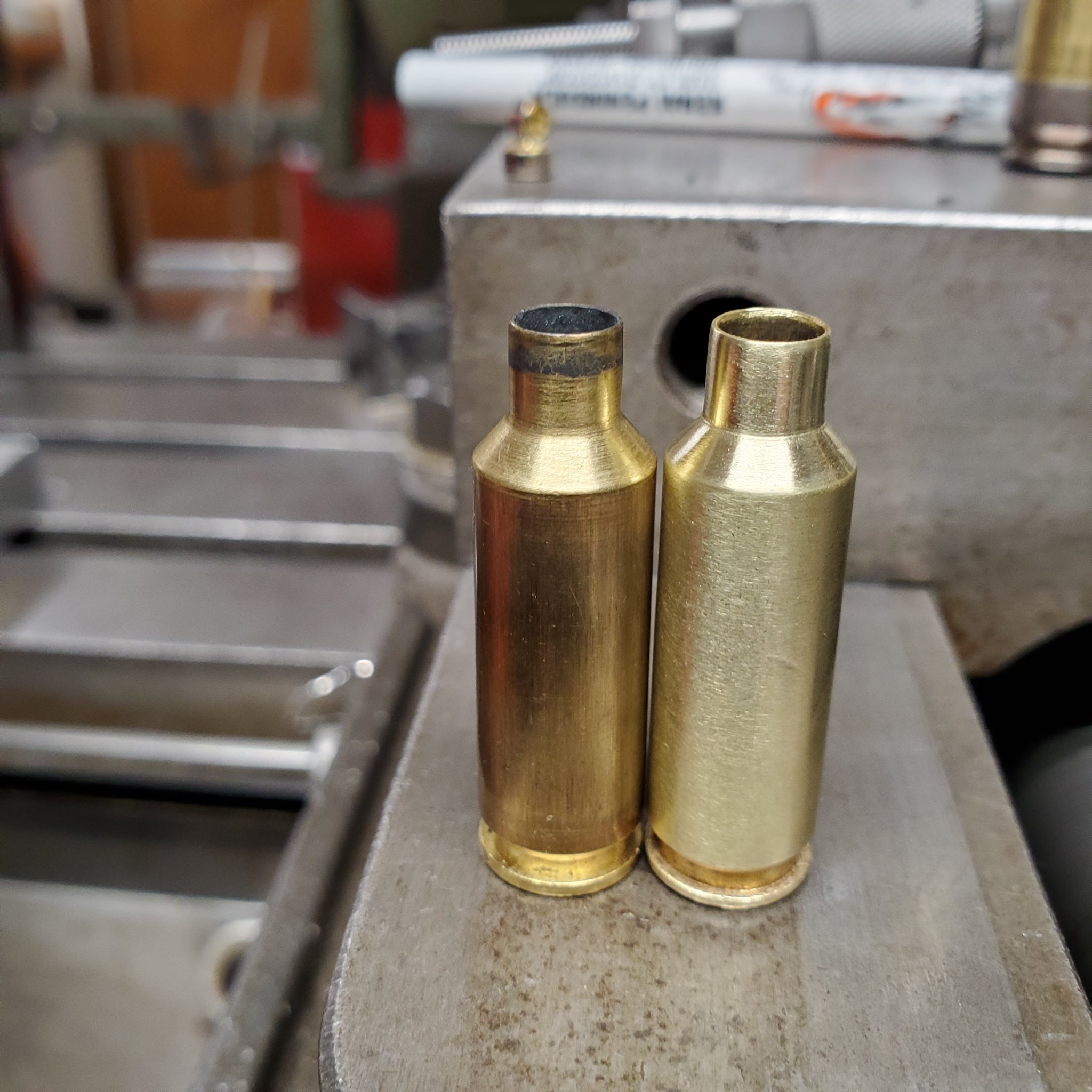

Here is how I do it but it's definitely not recommend, unless you can not get any brass...I use Alpha brass for my 6 Dasher...
But 6 dasher can be made out of any 308 based cartridge, even a 30-06 if you care to work at it.
I used LR primer 6.5 CM brass but you can get SR primed 6.5 CM brass.
The shiny one is 6.5 CM and the dull one is fired 6 dasher....you will need to neck turn also.
I forgot the first step is to move the 6.5 CM shoulder back, trim to length, then move it back to close to finish, in steps.l of 30° as 40° shoulders are harder to move without collaspe, so that is why the steps must take place, in shoulder location gradually, and anneal on the last step. Plus remember to neck turn...as I said you can ...but it's much easier to just buy Alpha brass. But if you have the tools, it's not difficult either. And you process a bunch at a time with each progresive step...also check your case volume when done.

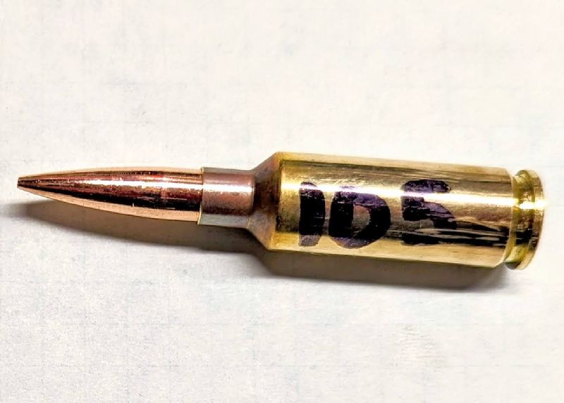

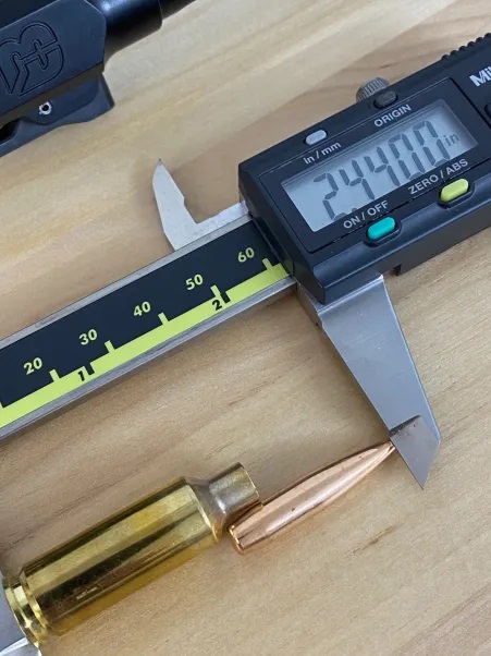

Need a quick sanity check...
Just finished building my first 6mm Dasher rifle (specs below), and while loading up my first rounds, I confused myself when I got to bullet seating depth. I used a Sinclair Bullet Seating Depth Gauge to figure out where my lands were at, and repeated the measurement on a dummy cartridge (increasing seating depth until the bolt handle drops). Results were within 0.001" of each other, so I trust that I'm in the right neighborhood.
Bullet touching the lands:
  • CBTO = 1.808"
  • COAL = 2.392"
Data/charts that I have come across say the COAL for 6 Dasher is 2.441", or 0.049" longer than my max length load with 105 VLDs. I understand that bullet lengths vary due to inconsistencies at the meplat. But on other cartridges that I have reloaded for, the chambers usually accommodated bullets seater longer than spec, and seating depth is limited by magazine dimensions. This is the first time that I have to load shorter than the book shows.
Is this normal with the chamber on a Proof Pre-fit? My loaded dummy round looks about right to me.

Yep, perfectly normal. My CBTO is usually in the range of 1.79ish with a 104 freebore and low 1.8's with a 130ish freebore. Suspect yours is the latter.
Awesome, thanks. I just wanted to make sure I wasn't making a dumbass mistake before loading up a bunch of rounds and heading off to the range that is over 1 hour away.

Where are you seeing 2.44x" COAL published?
...not much bearing surface in the neck loading that long:

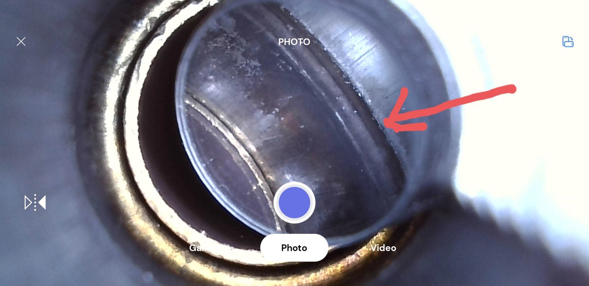

Can I be a dipshit for a minute and ask what freebore is. Is it the distance between the top of the shoulder/base of the neck to the start of the lands where the arrow is?
Freebore is a smooth section that starts at the end of the chamber (just past the case mouth) and continues up to where the lands start. It's usually just very slightly larger than bullet diameter so a bullet can pass through freely after it leaves the case but before it encounters the lands. A larger freebore number means you can seat your bullets out longer.

Can I be a dipshit for a minute and ask what freebore is. Is it the distance between the top of the shoulder/base of the neck to the start of the lands where the arrow is? View attachment 8364548

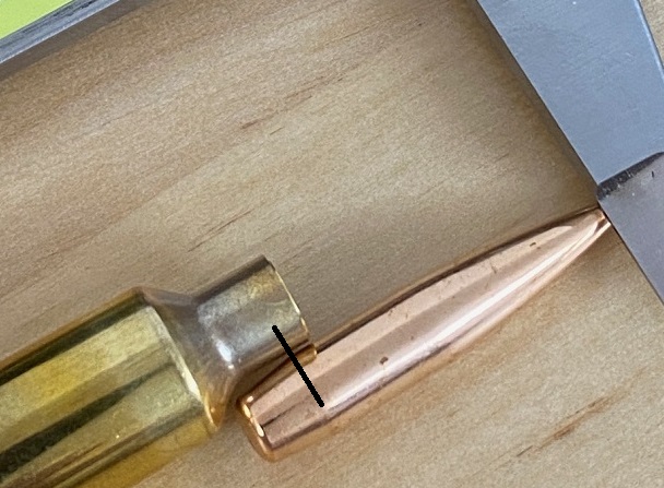

That picture is looking at the case mouth (under the blue dot), and the start of the freebore (at the red arrow, lands would start further right) showing how far that brass can grow before trimming is needed. Also pretty good show of how carbon can build up there….
So freebore is from the arrow to the start of the lands?

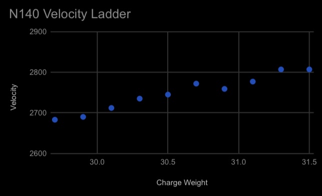

Here’s my velocity ladder for 115 DTACs in 6 dasher with N140. This was shot out a 26” 1:7.5 twist barrel in 55* weather. I saw no pressure signs
I ended up sticking with the 30.5gr charge. This is the same charge weight I use for Varget and the speeds are almost identical.
10rds of N140 at that charge weight gave me an SD of 8 and ES of 28 with an average speed of 2734. I’m hoping that gets a bit better once I replace my chargemaster lite.
While I am here, what G7 BCs are people using for DTACs at dasher speeds? I had been using a G7 of .276 from the Geoballastics library. But I seem to consistently be a bit high at longer ranges. A G7 of .300 better aligns with my rifle.

I tend to shoot the 110 gr SMK at 3085 fps, I believe they have a higher BC.
I have tried the 115 DTAC coated in my 6 Dasher, with a bunch of different powders, a little over 2800fps to 3044 fps they are basically accurate, with a variety of powders.

I'm running a Bartlein 5 R 7.5 twist 28" M24 profile, chambered by me, with my own reamer.
So a new barrel can be ready to go in one day.
