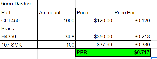

New to 6 Dasher, what does is the cost to reload it with brass and how many reloads do you typically get out of the brass? I understand the bullet choice and when you buy etc will have an impact but assuming you buy powder/bullets/cases etc today.
You should be able to get 10+ firings out of the brass as long as you're not hot rodding it. Bump the shoulder .002 and anneal every now and then and it will last a long time. It's a very fun and accurate cartridge.
Can speak just for Alpha or Peterson, reinforcing what @M_R_Woodard just said. If you dont hotrod the beast, ( 2800-2850 fps with 105gr bullets) they will last... My first batch of both brands is at 7th firing and still both look like new. Annealing every firing just to be sure. Full sizing, 2 thou shoulder bump, PRS shooting. F-class, different story.
Choosing to run a dasher should come with no cost factor involved in your decision. In my opinion, this is a performance cartridge, and factors such as your preference of components and performance requirements should be a deciding factor. Example: I wanted to switch from 6.5CM to a 6mm for PRS. I prefer Lapua brass, so that narrows my selection down some. I did not like the reported shorter barrel life with the 6 creed. I heard of stories about the 6x47 being a little finicky. Lapua does not make brass for the GT( and the conversion process from 6.5x47 was too much for me). This led me to the 6BR or one of its cousins. I shoot with several guys that run Dashers so I knew that if I needed assistance along the way, i had it..... and that's where I ended up. glad I did. it's a fantastic cartridge for what i do with it. which is running a Berger 105 hybrid at 2920ish FPS
If you don't like the idea of fire-forming or hydro-forming brass, Alpha and Peterson make brass for it, but it seems that some of us have found that there are some caveats to using those. But i also know several people running Alpha brass with nothing but good things to say.
Be sure of what reamer design you are going to use VS the brass you intend to use. Alpha legacy reamers are different from Lapua reamers and the components do not play well together.
As the others have stated above, brass life is completely dependent on how you treat it. Don't over-size it. Anneal often. if you load over pressure chasing velocity, you will lose primer pockets sooner, as with any other cartridge.
In today's time, you're going to pay ~ 1.30 / $1.50 per piece of brass. Bullets average .50 cents. most powders are 50$ a LB now. Primers are averaging .10 cents a piece. All of this can be said for almost any other cartridge in this same performance realm. 6creed, 6x47 Lapua, 6GT, 6BR

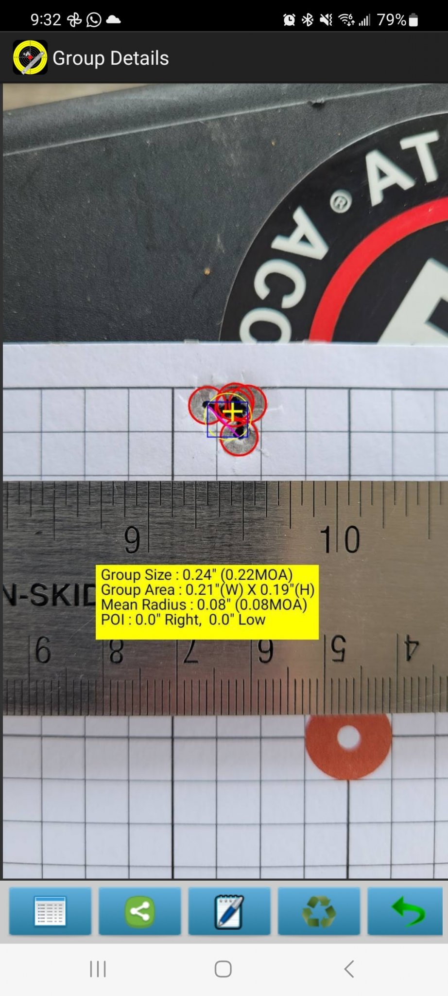

I shot this this group while zeroing with the SBM load.

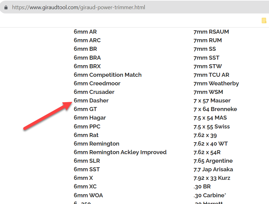

Is there an affordable decent way to trim 6 dasher? I've spent almost 8 grand in the last few weeks on this rifle and I'm getting a little tired of spending. I don't want to spend another 500 bucks on a trimmer.
Does that Lyman xpress trim work with this short caliber?
Could always chuck up a Giraud Triway trimmer (used to be ~$125 last time I checked, though it's been awhile).
Also just a thought, but do you need to trim now or can you put it off until it's necessary? I used to trim every reload but have since found that to be excessive and now rarely trim only when needed. With my current lot of Dasher brass I think the brass will wear out before it needs to be trimmed so I don't think I'll trim again until I start a new lot of brass.
They were the first people I called because I have the 223 and 308 but unfortunately they said they don't make it for 6 dasher because the case is to short
Yeah definitely, I have 300 new alpha brass. I just want to be prepared for when the time comes. I think a trimmer is the last thing I need for this new caliber. I got the 105 berger hybrids to start with.
Reactions: TylerN and Terp
Reactions: louu
Good call.
That's strange, given they have a cutterhead for 6mm/6Dasher...falsely assumed you could adjust it to still index off the shoulder and the two-tenths difference in length between .223 and Dasher wouldn't matter. Good to know, though!
Reactions: louu
ive went through several dasher barrels and probably 800 rounds our brass, and I trimmed them one time because i was going to a big 2 day match and had time to get silly with reloads. i wouldnt waste your money right now on it. You can get several firings out of your brass before you need to trim it
Reactions: louu
Good call.
I also contacted them for cutter for dasher and bra, they said they do not make them. So what version are you using?
Reactions: louu
Giraud says they don't make the tri way version because the back of the case won't stick out of the tool enough to get a grip on it. They have a setup for the fancy machine that costs $600 for dasher.
Thanks guys, I'll keep an eye on the length and like you said I probably won't need to trim. I just like to be prepared because I end up doing most things last minute
I retired my Giraud and moved to a Henderson, but I meant they make cutterheads for Dasher for the regular Giraud, so didn't think it would be an issue for the Triway because the case isn't THAT much shorter than a .223...seems they could even shave down the 'shroud' 3 thou and make it work. Strange.
I have never trimmed my 6 Dasher brass either.

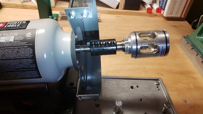

But usually us an old Wilson case trimmer with a modified cutter for an electric drill motor...cheap does about 600 cases per hr. Or collet closer and a Bridgeport mill is 1 second per trimming even if ya take off a 1/2" of brass. The best way for 50BMG case trimming.

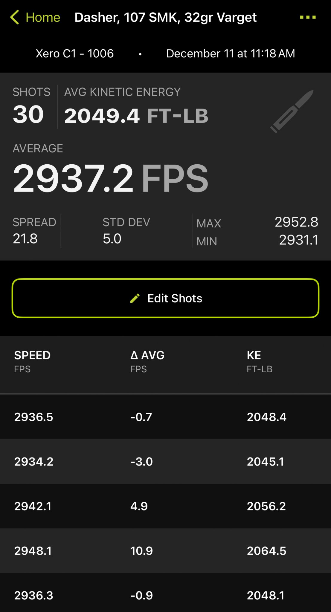

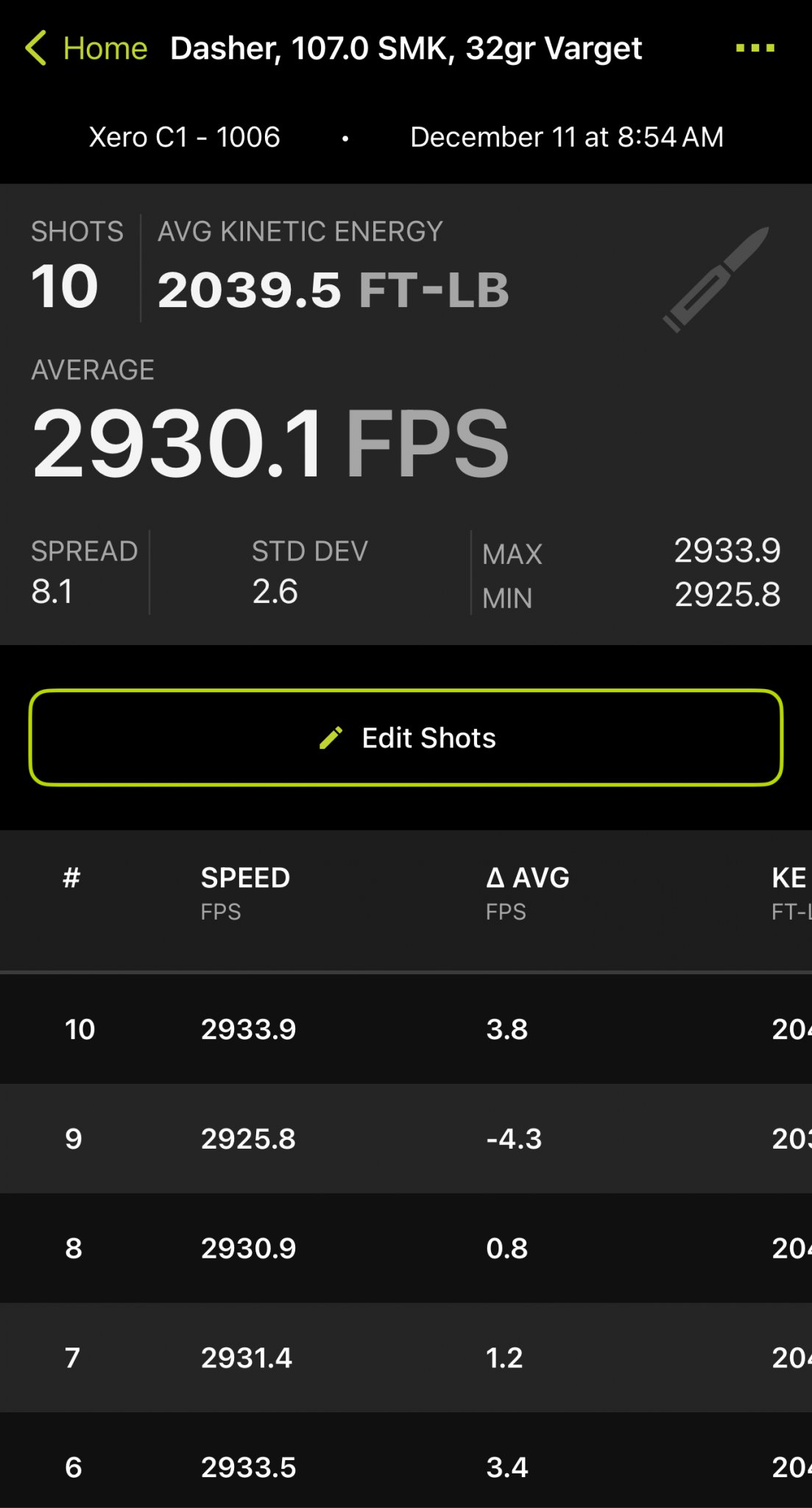

Got to take out the new Garmin last weekend and absolutely love it. Mounted on an Area 419 Arca Arm and it didn’t miss a shot. I love that I can shoot at the 100yd berm and then turn and shoot at 600 and don’t need to worry about alignment like with the LabRadar. Here’s the data from a 30 round string:
Lapua fireformed brass
Proof 26” SS prefit
Sierra 107 SMK
32gr Varget
.020 jump
~60 degrees Fahrenheit @ 1,000 ft elv.
For fun, here was the best string from that morning when it was about 15 degrees cooler:

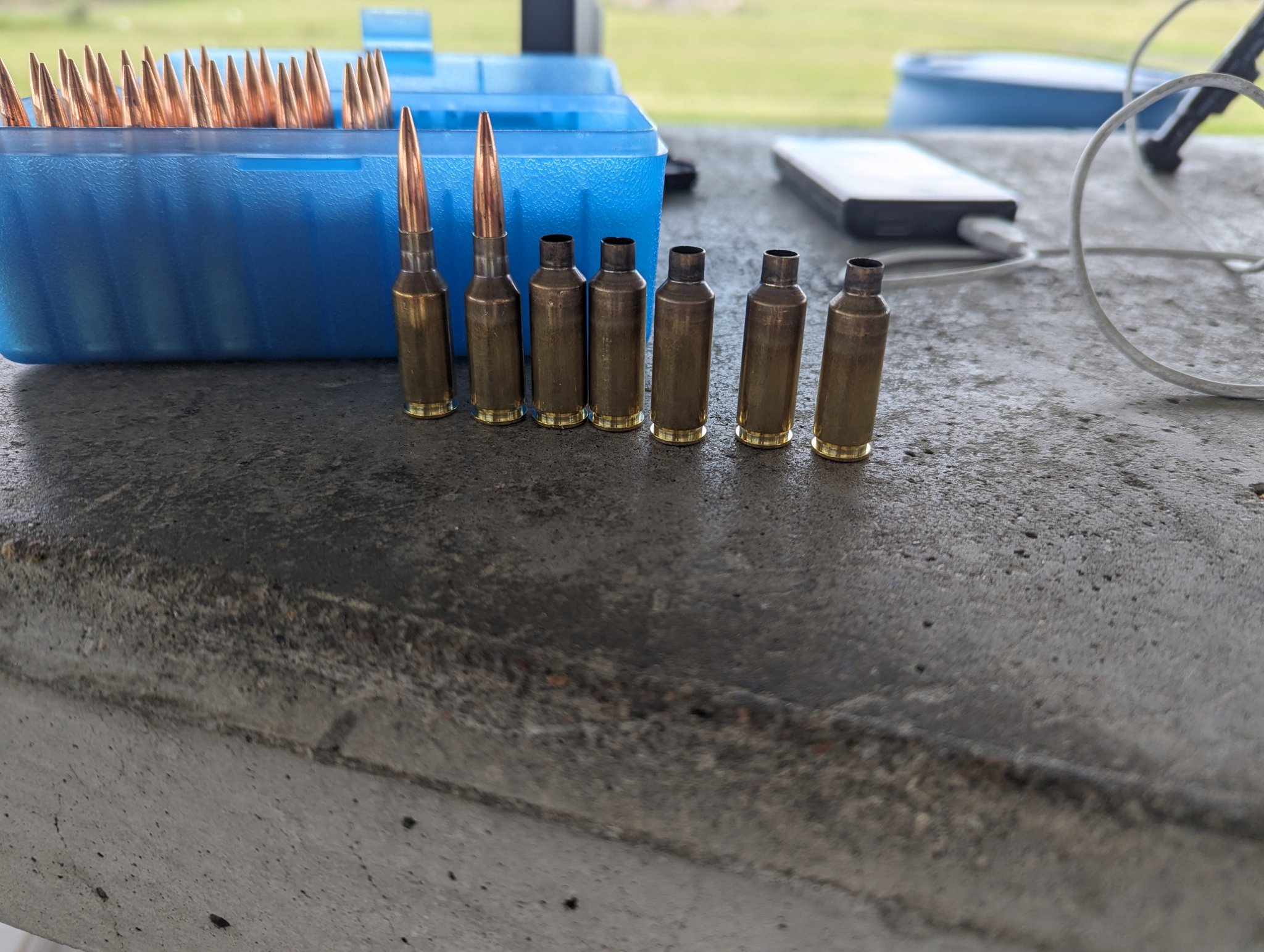

I've been running Alpha brass and have had no issues. However the tinkerer in me decided to fireform some Lapua brass to try out.
I went with the false shoulder technique and results were great and the process is easy. The fireforming rounds shoot great so I'd happily go to the range and shoot them just as I would formed brass.
0.257" false shoulder. Ran a mandrel through the brass. Backed out my already setup sizing die on my Dillon 550 1 turn. With the Armanov tool head this is repeatable due to the floating die, unscrewed the small pin-screw, turned the die out one turn and screwed it back. This allows the false shoulder to crush fit in the chamber easily. Then the next station ran a 6mm mandrel. After that annealed them and loaded. No jam on bullets, loaded 10k off the lands just same as I would on formed brass.
28.0gr of Varget, CCI 450, 112gr Match Burner. Brass formed up well, from memory about the same as new Alpha brass (and better than Peterson which comes with an extremely round shoulder body junction.)
