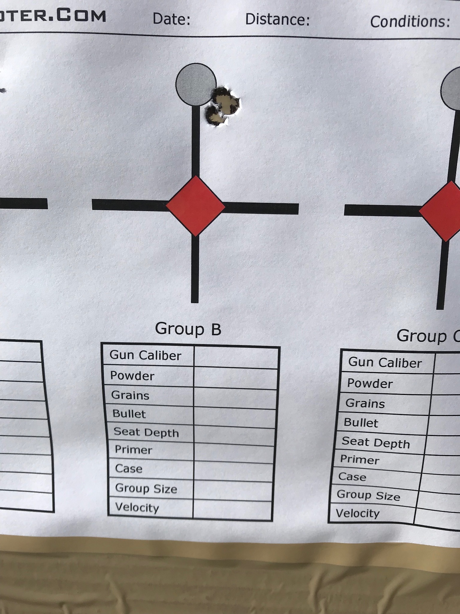

I am running the following load in my dasher 6mm
Berger 105 Hybrids
32.4 gr Varget
CCI 450 primer
AVG FPS 3030 with 7.5 twist krieger barrel 28” in length
shooting off a benchrest I get 1/4” five shot groups.
Got out yesterday in some fairly challenging conditions. 40 deg cold cloudy wind 10-30mph 11-3. 32.2gr H4985 under berger 105gr going 3003fps. At 550 it wasn't even a challenge. At 1000 hitting a 6" plate was just fun enough to make me want to climb back out of my SUV after warming up to shoot another string. Wasn't really wanting to make it a shit show day but had to verify chono and calculation data at range. Dead nuts on for three different calibers. Good day.
Reactions: BLKWLFK9
