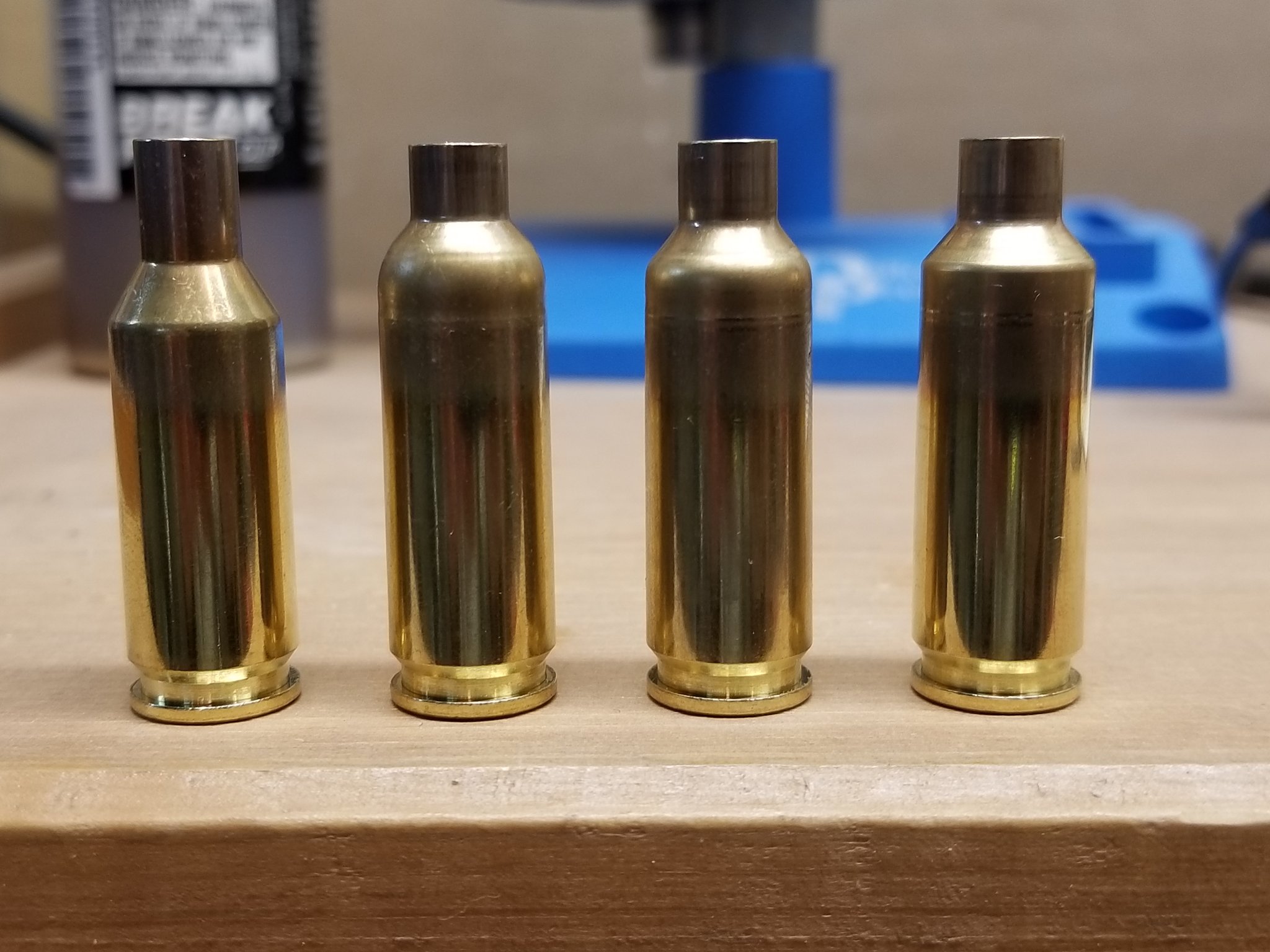

Getting the hydro die and consistent technique down took a dozen or so cases, but I've got it figured out now and am actually quite pleased with how uniform the cases are turning out. See attached picture with new 6BR case on left, then case out of hydroform die, case after full length sizer die, and finally once-fired case.

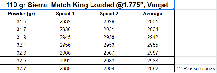

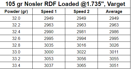

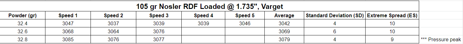

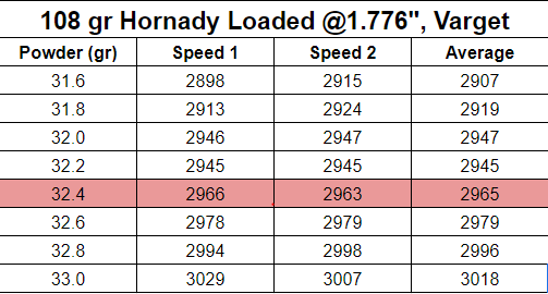

So far I have done 350 ish rounds of FF-ing with 90-105 gr bullets, jammed 0.030", 30 gr +/- 0.3 gr of Varget, then I started load dev.
I have run the 105 Nosler RDF's at 0.040" off the lands (the 1.735" is CBTO with a custom gauge):
The 108 ELD-M's 0.020" off the lands:
The 32.4 gr load was highlighted because that was what I ran at a club match last weekend, but more on that later.
However, since running those two ladders, it appears that my barrel has further sped up another 50-75 ft/s as these are the numbers I got yesterday!
105 gr RDF:
and 110 SMK:
I hope this proves useful for anyone out thereIt looks like I will be running the 108's this season, as 105 Hybrids and the 110 SMK's are hard to find/expensive up here!
