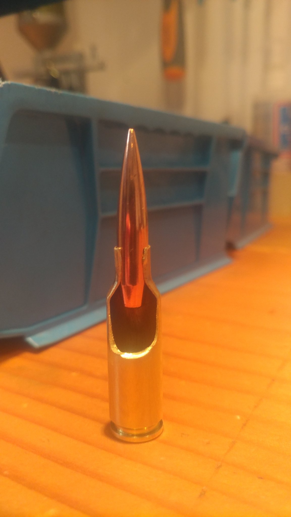

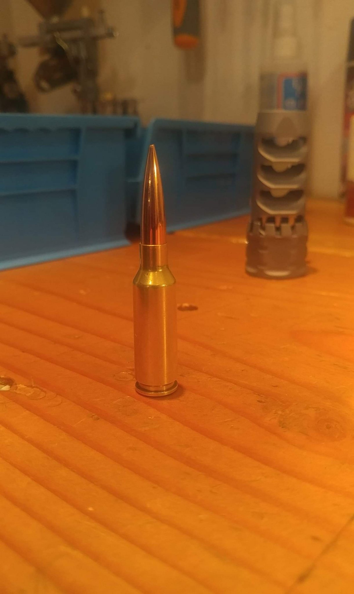

112MB at around 2.38" OAL which is easily doable in my rifle. Obviously I don't have the barrel in hand so I have no idea what will actually fit, but it looks cool.

The FedEx truck dropped my barrel this afternoon. Checked the chamber with my gages all good there. Slapped it into my side charging upper and had to make a comparator case. I have purchased to bullets so far 6mm Hornady 87 Vmax and 107 Nosler RDF. The Noslers hit the lands at 2.310 and the Vmax hits at 2.087. that's a little short. I guess I'm off to find some more bullets to try next. My barrel is a Xcaliber 24" Bull, Stainless, with an 11 degree crown. Been shooing Grendel's for years now so I have lots of powder choices. Using Hornady brass and Fed AR match primers
