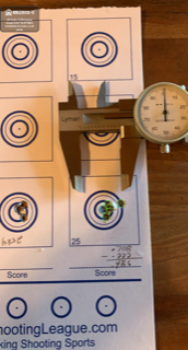

A caliper is only 20 or 30 bucks. My vote is measure with a caliper outside edge to outside edge of the black grease smear, leaving a minuscule amount of white line to make sure that you are measuring as close as possible, and subtract .222.

When using a caliper I always measure from the outer edge of the black ring of the two holes that are furthest apart and subtract the diameter of one bullet. Trying to eye up the center of a hole and keeping the caliper there for a measurement leaves room for more error. I think measuring from the outer edge of the black rings and subtracting .222 is a good standard. Just my 2 cents.
This is the way I do it as well. I was never able to accurately measure to the actual center of the holes but can easily measure to the outside edges of the group. It may not be perfect but if we all are consistent it still gives us a relative benchmark of rifle/ammo/shooter performance. The only person I am competing with is myself. As for the software method? It gives the illusion of precision but is still limited to the accuracy of the user. I cannot see it as being any better than the old method and not all have it anyway. I am OK with 0.222 since that was what most of us have used for years.
