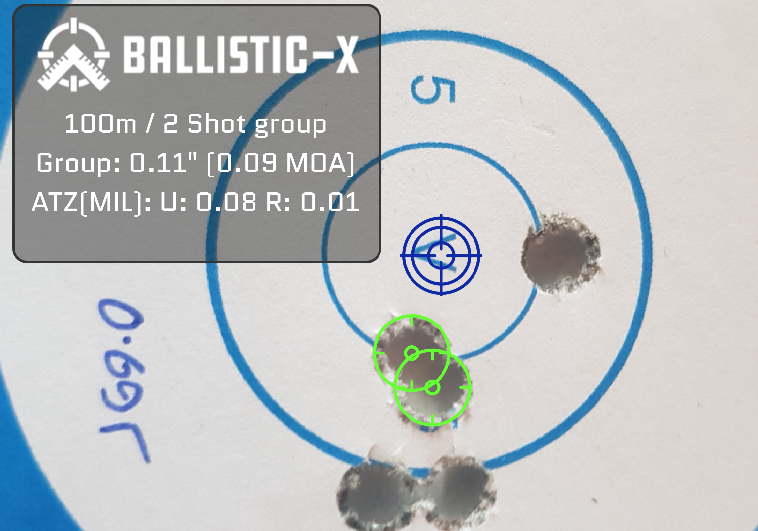

    @jbell I would vote for using something like Ontarget TDS /Ballistic-X.

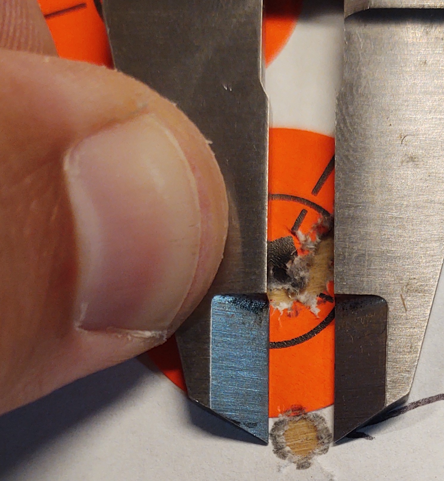

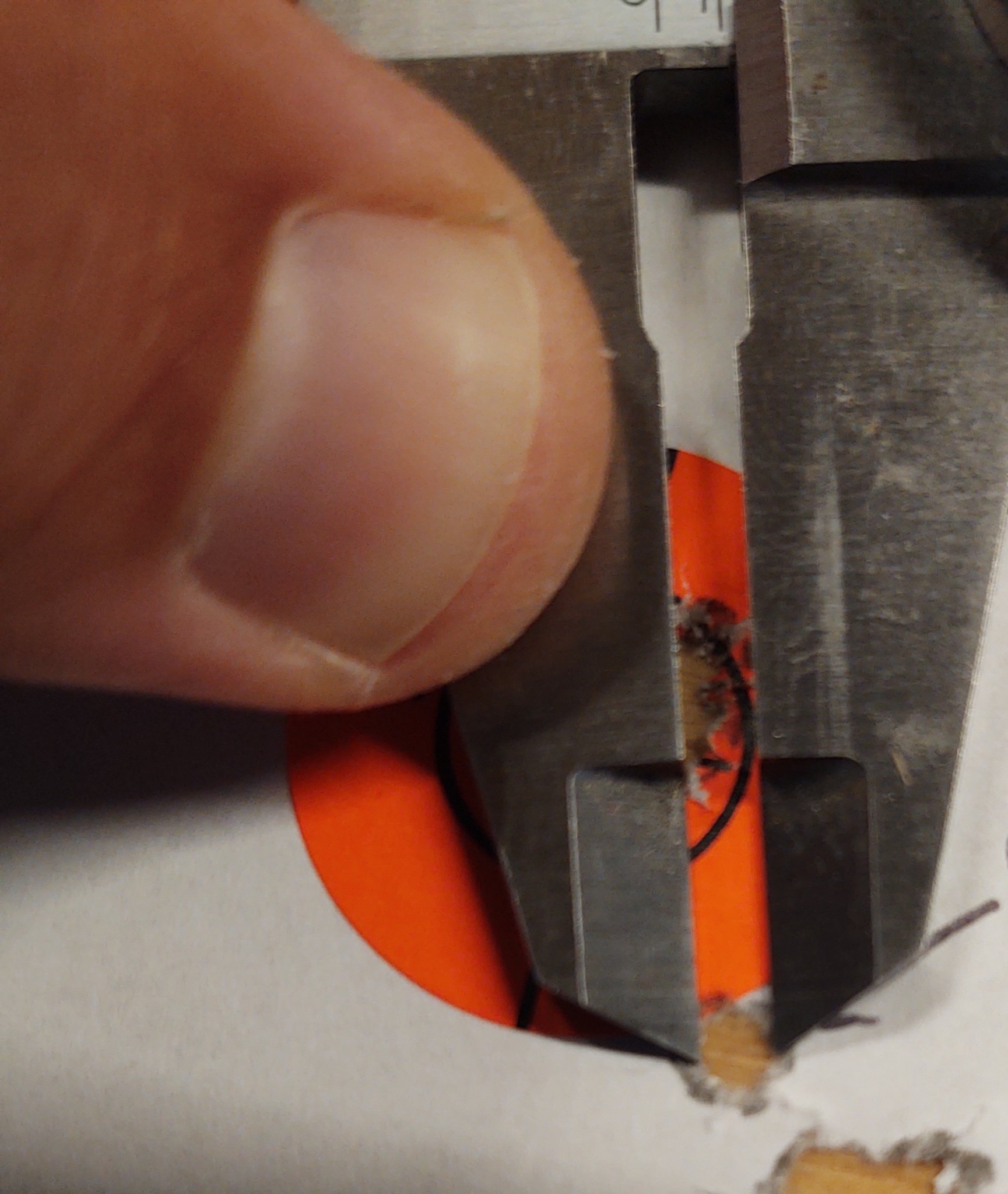

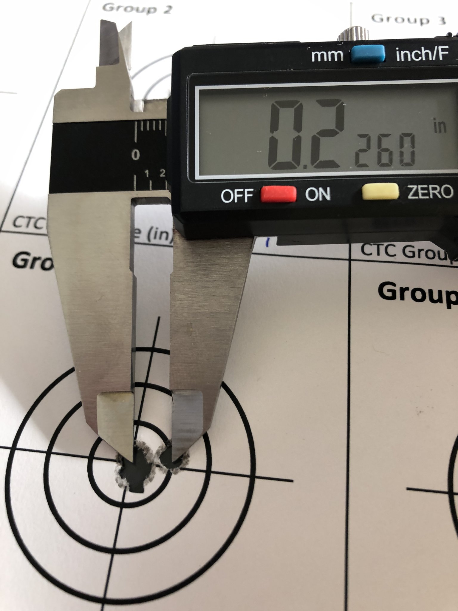

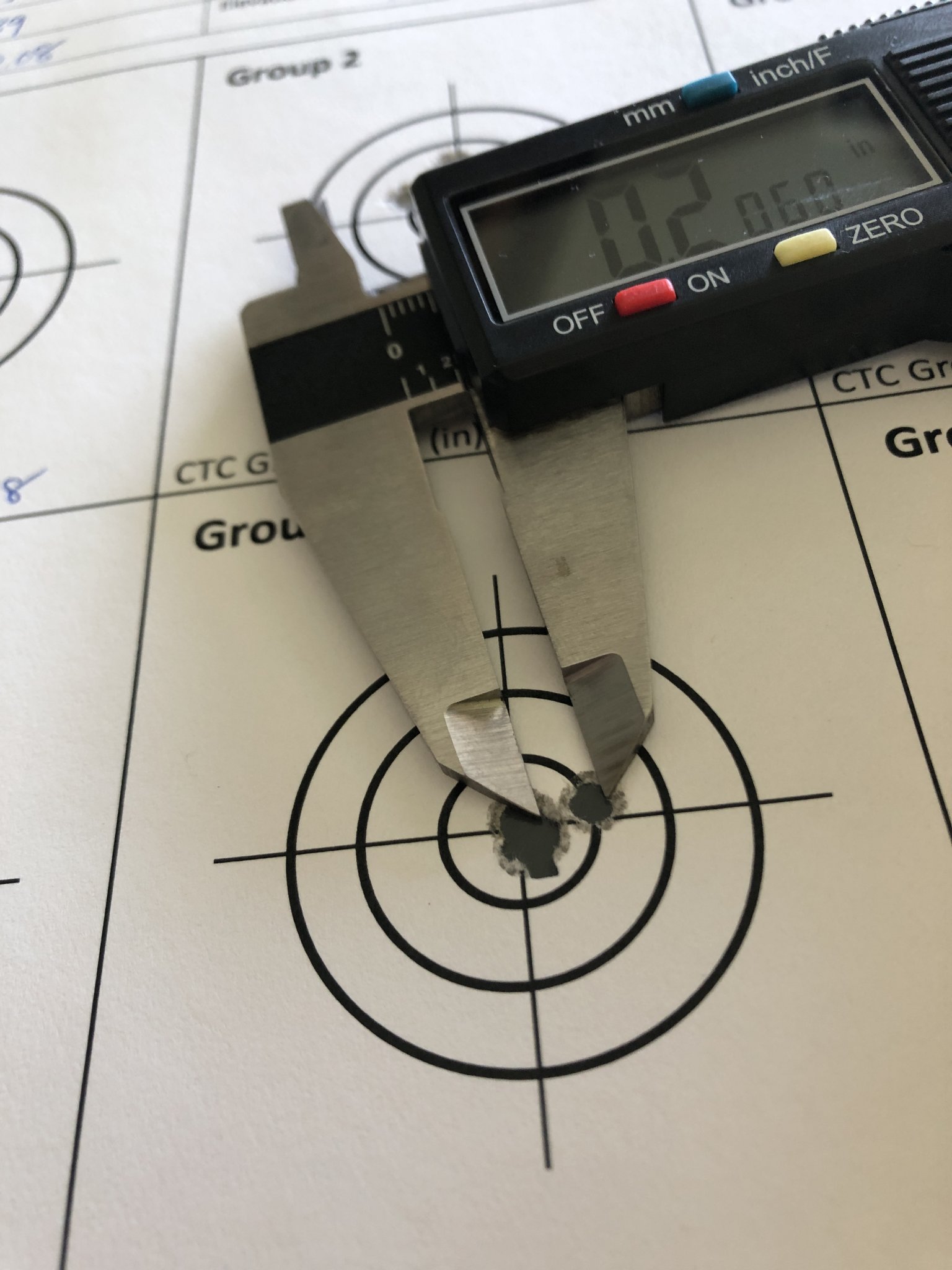

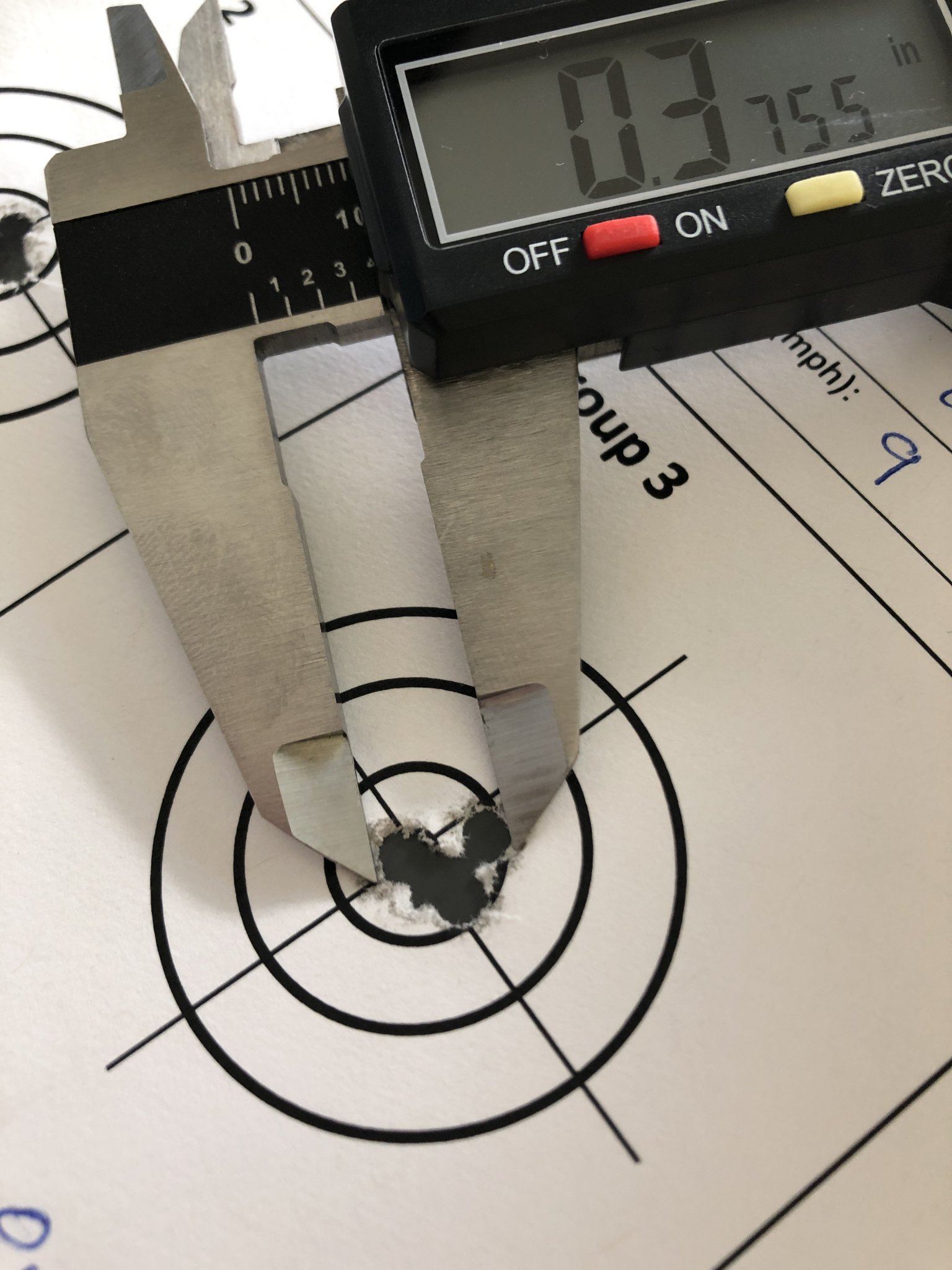

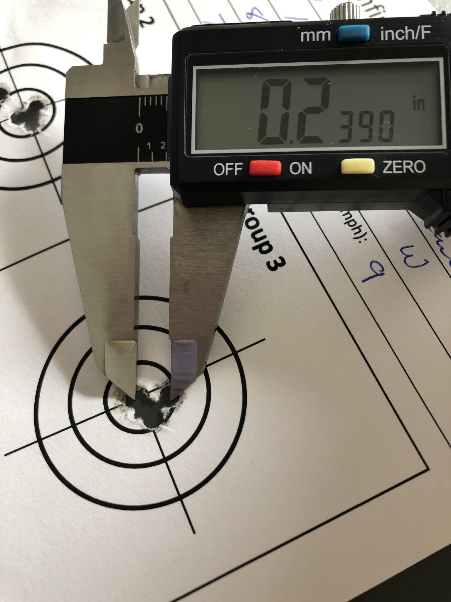

    jbell, a couple of examples using a caliper and measured two different ways; Center to Center with no subtraction and Edge to Edge, then subtracting 0.222.
    So which widths would I report for the 6x5? CTC or ETE?
    Bull 3 - 0.161 ETE vs 0.226 CTC
    Bull 5 - 0.153 ETE vs 0.239 CTC
    The pictures above are from a target with 65 lb cardstock, and the holes have a dark ring where the bullet pushed through, but did not cut the stock from edge of the round to edge of the round. So the paper hole will always (in my experience) be smaller than the bullet diameter. Another factor to consider in describing how to measure for 6x5.

    If there is separation between bullet holes measure with a dial caliper from the outside edge of one of the farthest holes to the inside edge of the other. This gives a accurate measure of group size CTC regardless of bullet hole size. If the group is a single enlarged hole use the parts of the dial caliper that are intended to measure inside diameter and carefully measure the the largest part of the hole without tearing the paper then subtract .222". This is about as good as can be done to keep the measurements fair, accurate and consistent. Software measurements are not consistent nor accurate because it relies on the exact input of the bullet hole diameter which is not being done. Example, entering unfired bullet diameter of .224 and the software looks at bullet holes in paper that are actually. 178" yet the software "thinks" that they are .224". Actual group size is no where close to what the software measures.

    Good point. I tried to remeasure the two example bulls after I read your post. Bull No. 3 has a clover-leaf pattern and has no inner edge to use as a measuring point. I was able to measure Bull No. 5 and attached the picture below.
    What do you think about just using the outer edge of the group at the widest point (whether that is the outer edge of two holes, or the outer edge of a larger whole), and reporting to the tenths of an inch as in the above post? Keeps it simple, easy to group the data into the buckets suggested.

    I haven't had much luck using Ballistic-X on my I-phone X. Every time I touch the screen to place a mark, the mark moves when I lift my finger. Also it is hard to get a perfect picture of the target.
    I think the inconsistencies your seeing are because you are not measuring at the correct part of the bullet hole when measuring the ETE. Measure from the outer edge of the black ring, that is part of the bullet hole (group) also. Let me get some pics to see if I can explain it.
    This is not accurate with the ones I’ve used including Ballistic-X. It isn’t measuring from the outside and subtracting bullet diameter. It’s measuring using a bullet-sized marker on screen. There can be error but it is related only to how closely you position that marker to the center of the hole. You should be able to get that to within a pixel or so—I don’t have time to figure out what that would be at the moment.

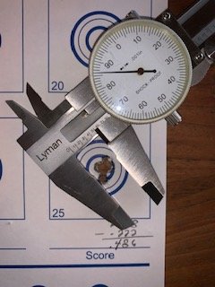

    This is the way I've been doing it. .708 minus .222 = .486. Same group measuring outside to outside and subtracting .222 and also measuring inside edge to outside edge.

    What does it use for a reference to size?
    If a standardized target were used that had an accurate 1 inch reference (could be the out diameter of the scoring ring or simply a printed rule next to each aiming point) and require an image of the targets with each submission, anyone here could use various methods to confirm the group size no mater what size the image is displayed at. Target Scan, Balistic X, using calipers and scaling the image size or using any of the commercial grade imaging equipment and software is possible and simple. Some have been doing that already with the groups that are posted here and that is much of the basis of this controversy. In some cases the claimed center to center distance Is over 20% smaller than actual.
    Yes but then you don’t know if it was printed at 100% or if the printer was miscalibrated. Personally I don’t really care that much. There is always measurement error. I wonder if the benchrest people have validated their ability to measure group sizes to the thousandth?

    My vote is outside to outside minus .222. With jbell's illustration so I won't screw it up from one time to the next. Do the best you can with what you got and the people getting pissed about 'losing' because 'somebody can't measure right' should get an automatic 0.2225" penalty.
    they use the reference distance you enter (ie the 1" or 3.65" or whatever you tell the software is a known distance). This defines the absolute scale of the 'picture' - the larger the reference distance the more accurate it will be. The bullet diameter is just used to get a suitable, scaled, ring to display that will give an easy visual match to the bullet holes. Human perception is remarkably good at aligning two circles of near same size - much better than we are at deciding the center or diagonal of a circle.
    So here is an example of the problem with this approach..
    lets assume that i can actually shoot like Padom and others and that the two bullet holes selected are actually my 5 shot group...
    This target was dry, high quality card and the bullet holes are close to full size so the caliper reading (oto) is 0.305" this gives a ctc of 0.305 - 0.222 = 0.083"
    If the target was damp paper then the bullet holes would prob be closer to 0.17" so the caliper reading (oto) would be 0.28" this gives a ctc of 0.28 - 0.222 = 0.058" - close to half of its true size and markedly better 'score' than 0.11". ...
    so depending on the target paper the same group could measure with the calipers - .22x method anything from 0.083" to 0.058" - this is a huge error margin - even ignoring human errors in the process.
    In comparison the software method would give approx the same result in both cases. It may still not be perfectly accurate, but it is more accurate, and dramatically more consistent.
    Reactions: jbell
    I just wanted to add that eletronical scoring should be promoted.
    You can measure reference target length with a caliper or a ruler, the targets are often 1 inch wide.

    The problem with bad cameras is that on a large piece of paper it WILL distort the image. You should test this by looking if group sizes change depending on if you use reference from center or the edge. This applies mostly when there are multiple groups in the same picture.
    Or you can use standardized targets like Air pistol 10m or air rifle 10m targets and TargetScan software. It works well because the software removes distortion by placing the shots on a matrix determined by the circles.

    There are so many variables that effect the diameter of the bullet hole that there will not be any true consistency in measurement from one target to another and from one individual to another. I started shooting the original 6X5 in 2013. I got a little obsessive about trying to find a medium for targets that would provide some consistency. The only that I can tell is that, under most circumstances, it doesn't reliably exist. Many of the reasons have already been pointed out by other posters.
    I see y’all’s point on how easy it is to get lost in the weeds and how difficult it can be being as accurate as humanly possible when measuring rimfire rounds on paper and then calculating MOA. I am right there with ya!
    However I think the point of this discussion isn't how to squeeze the very last drop of accuracy out of our measurements, but rather how can we all be a little more on the same page when submitting measurements. Keep in mind the MAIN point of the 6X5 thread isn’t a competition, it is to get more people interested in precision rimfire. My goal is to grow the sport, share knowledge, provide a welcoming source of information and inspiration for new shooters. The last thing I want to see is making this over complicated and thus turning people away from it.
    So let’s try to keep the final decision fairly simple, easy to do with common measuring devices that most shooters have or at least should have.
    I have done this for almost seven years and the above is pretty much what it has always been about. I live in a rural area and shoot on the driveway for fifty and a hundred. Further is available by going to a pasture. The performance of other gear and shooters is pretty much what I read here. It gives me a way to gauge my performance and it is greatly appreciated. Originally a technical discussion here would be about something like the deterioration of ammo accuracy as the temperature falls. Now that discussion is more likely to be about chamber dimensions and their effect on reliability and accuracy.
    I have two suggestions for 2021. The first is stop listing "best group" for each 6X5. It tells us very little to nothing and doubles the input for jbell. The second is going back to an earlier day requiring a picture of the rifle and a detailed description. It would tell us a lot about changes in performance. Did you change from a rear bag to a butt spike? Were you shooting a twenty four ounce trigger and now your shooting a four ounce? Have you built a new bench with increased stability? Any dialogue that provides info. is a plus.
    Edge of smear to edge of smear minus .222 has been the standard and should continue to be so.
    .222
    Seconded!
    And the motion passes!
    Seconded!
