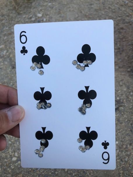

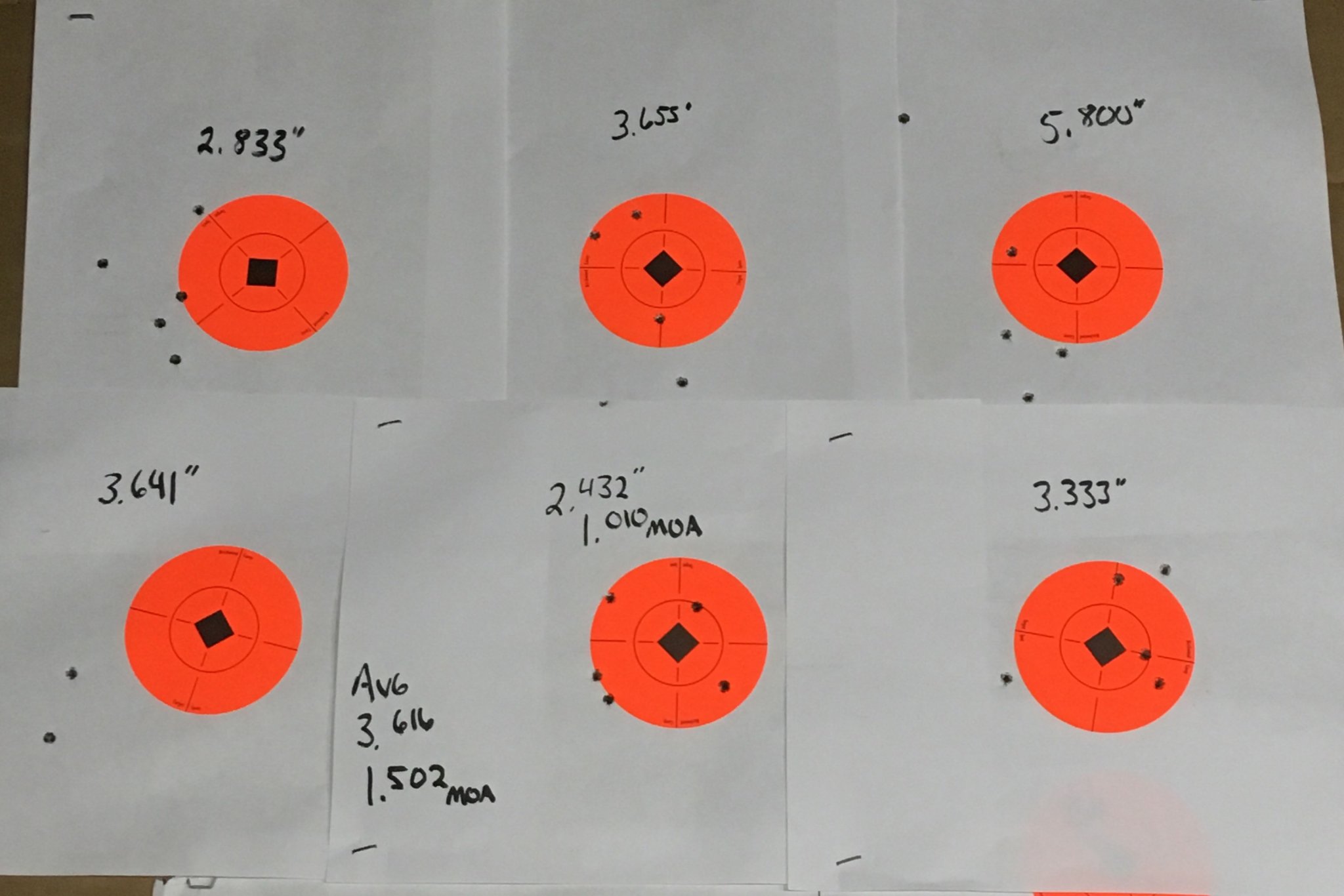

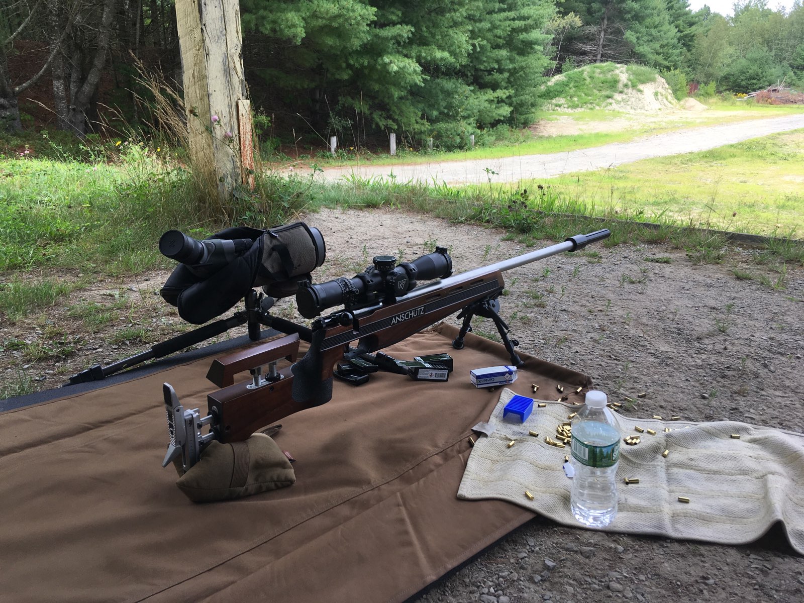

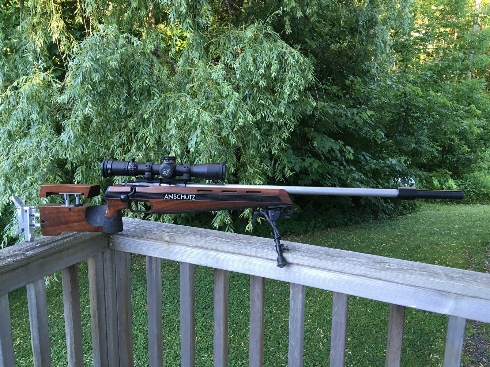

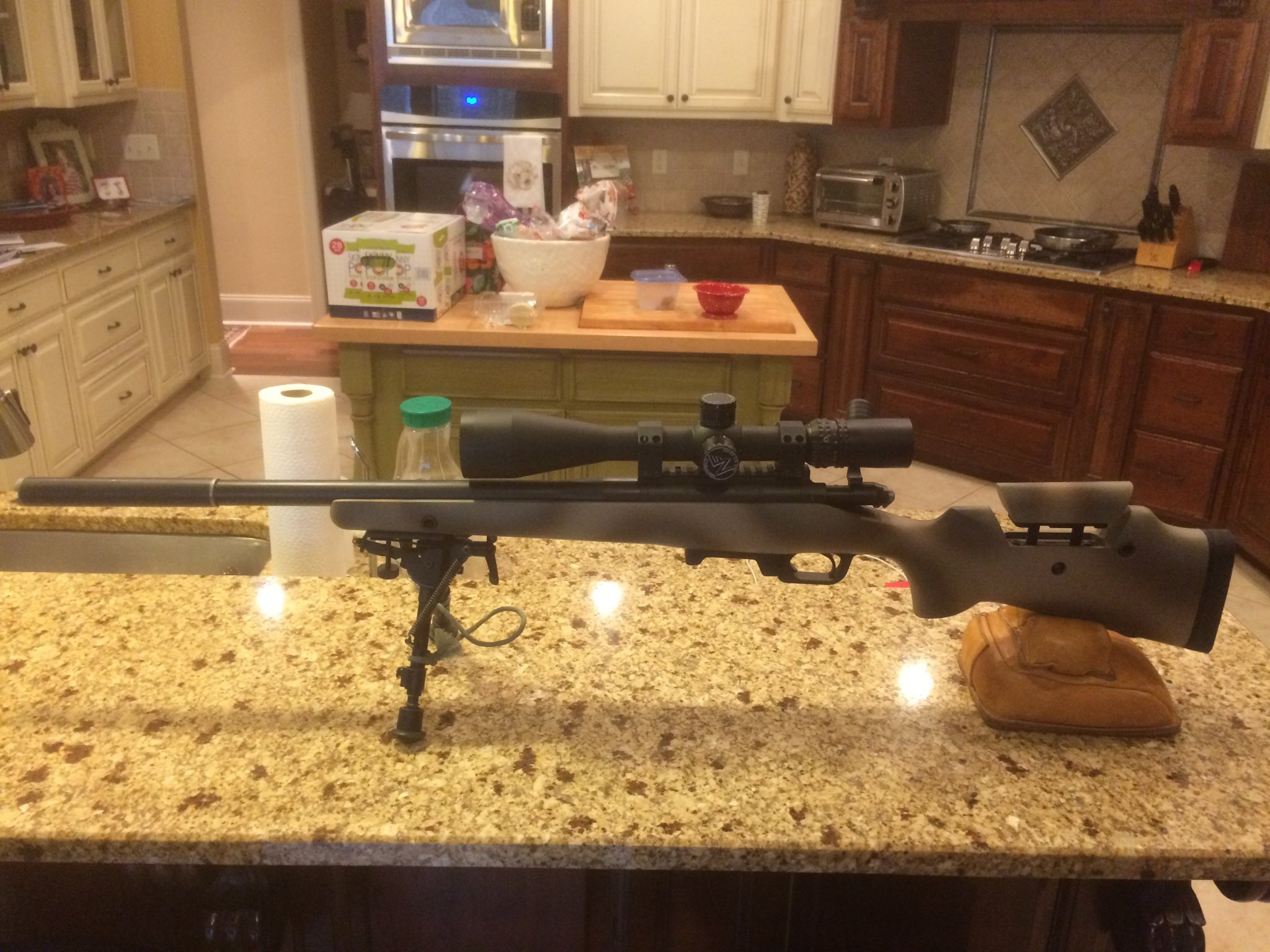

So my new rimfire is finally complete, maybe (I am still trying to decide if I want to bed it or not). Here are the details:
-Anschutz 1827B action
-5020 trigger set fairly heavy
-Benchmark 3 groove 15 twist @ 26 5/8" installed by Mark Penrod
-Champions Choice bloop tube (for shooting with irons)
-Anschutz 1907 stock that I modified for the repeater action
-DIP 25 MOA pic rail
-Nightforce ATACR F1 Mil-R 4-16X42
-APA rings
-Harris BR-S bipod

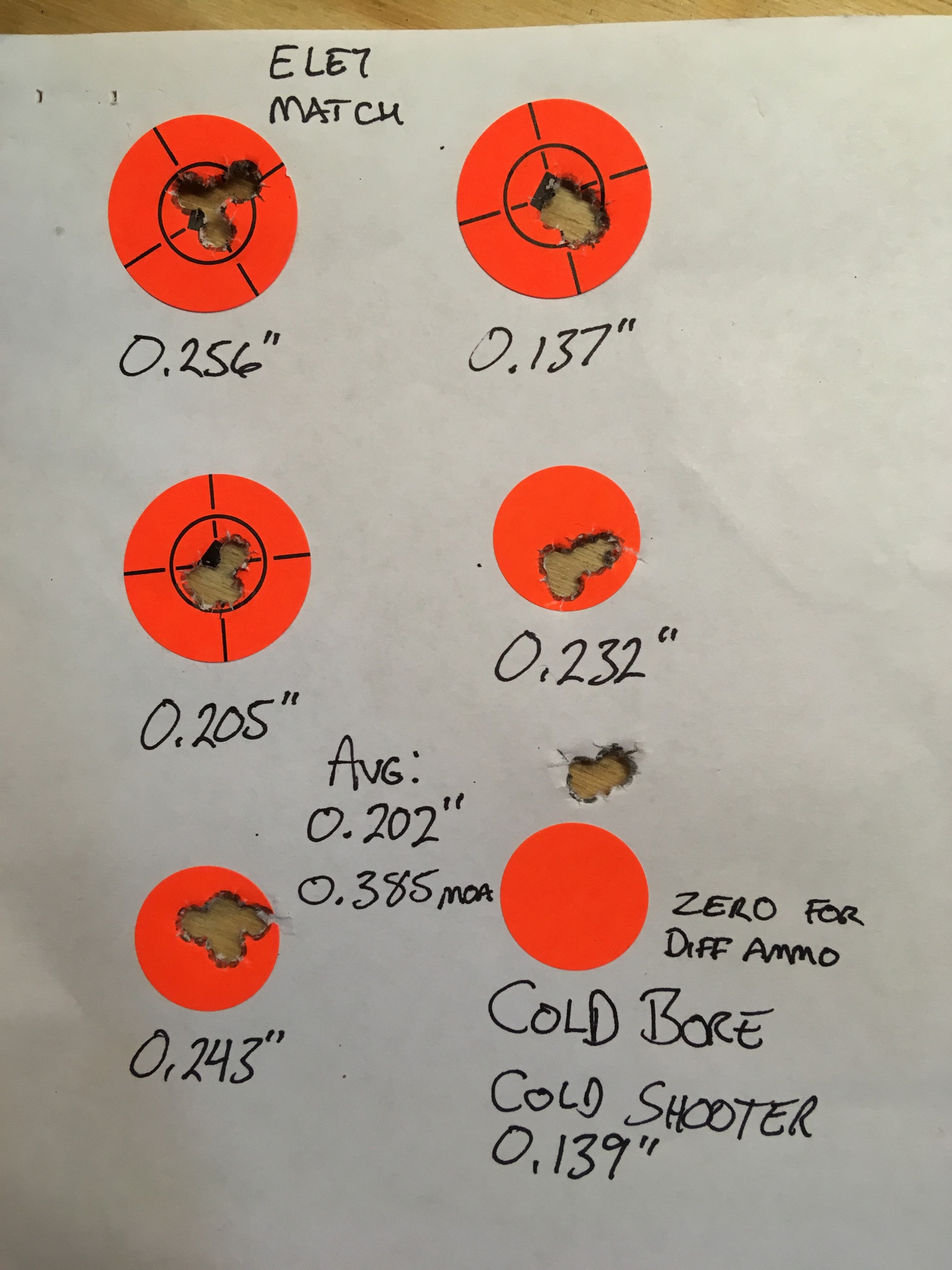

I have not been shooting much this year at all, so I am pretty rusty overall. I have not lot tested any ammo through this rifle, and the Eley target has 2 different lots in there. Today was not a great day to test accuracy, but I rarely have a chance to shoot I just had to suck it up. The weather today was in the low to mid 70's with 0-10 MPH winds that were switching from 3 to 6 to 9 O'clock. Basically it was a tough day to shoot rimfire at 100 yards. My process today was whenever the wind either dropped off or held a steady blow I would run a group as fast as I could to keep the conditions. You can clearly see this in the POI shifts and erratic flyers, but it gave me a good indicator that this may be a good shooter. I am especially pleased that it shoots Center X as well as or almost as well as Eley Match (black box). Everything was shot @ 100 yards prone with a small TAB bag and bipod as seen in the picture.
There will be more to come. I am looking forward to putting irons on it and slinging up prone!
Nice rifle JB. I too have not got to shoot much this year so far. The Winter/Spring was cold, rainy and blustery and we never had a calm day. Summer has been HOT, wet, and stormy and again we have rarely had a calm day. I just got back from a week in MOAB and am still marveling at the open spaces out there.

jbell, that's an unusual build. I will watch with interest as you shake it out.

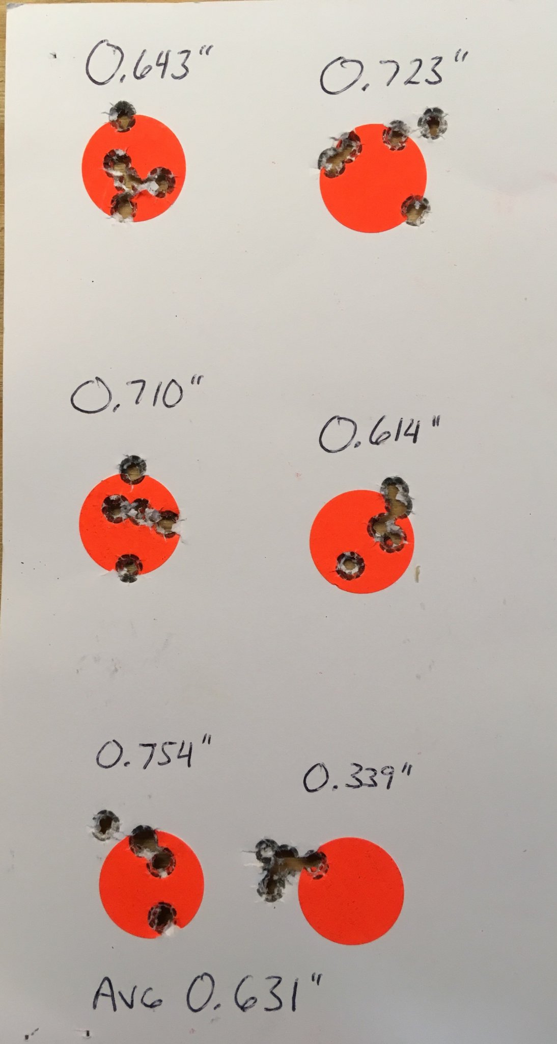

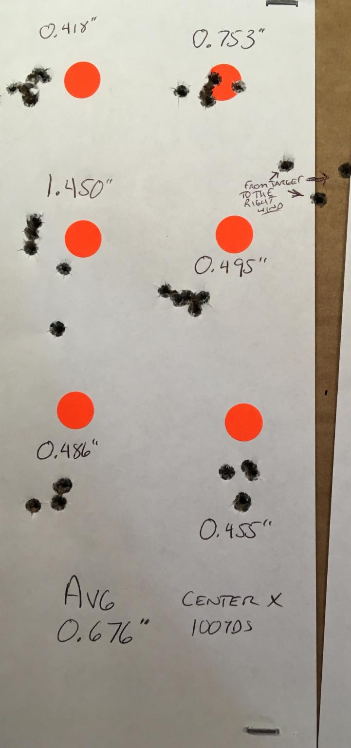

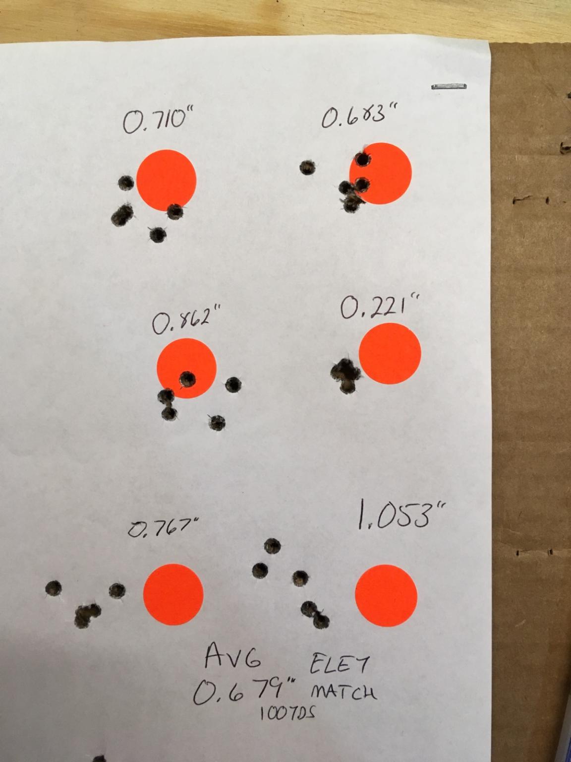

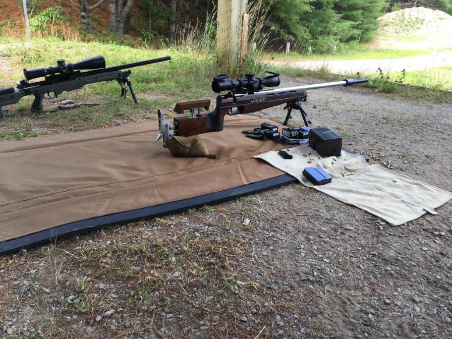

I was able to get out and try the Anschutz at 230 yards today. The weather was a bit unforgiving, challenging to say the least. With one front moving out and another coming in the winds kicked my ass. It would be steady full value one minute and then come right at me the next anywhere from 4 to 10 mph. My method for dealing with it was to pick a condition and put 5 rounds on target before it changed, so I was shooting pretty damn fast. It is a good thing the Anschutz feeds and ejects like a boss!
It isn't anything impressive at all but here it is:

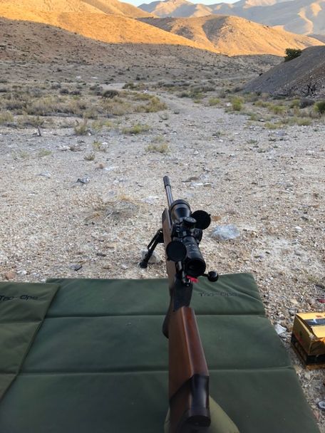

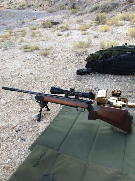

Here is one of the rifle and my shooting position:
I am looking forward to getting out with a little better conditions soon. The top 3 targets were shot with Center X and the bottom 3 were Lapua Midas + for reference.
Reactions: deltawiskey

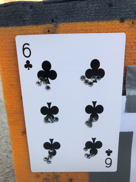

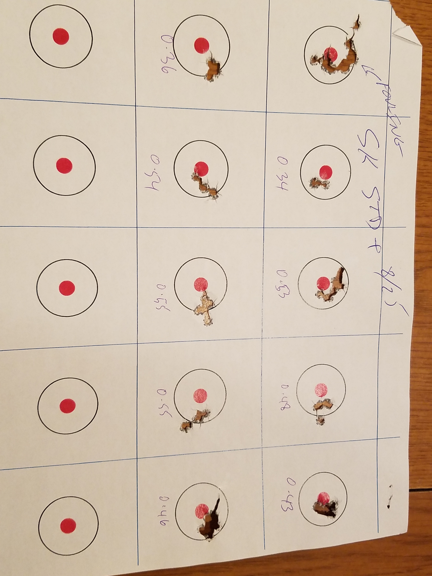

Ok, you'll have to pardon my ignorance on the measuring side of things but this is how I did it.
Top left .571
Top right .787
Middle left .624
Middle right .549
Bottom left .826
Bottom right .613
Average.661
All shot at 50 yds

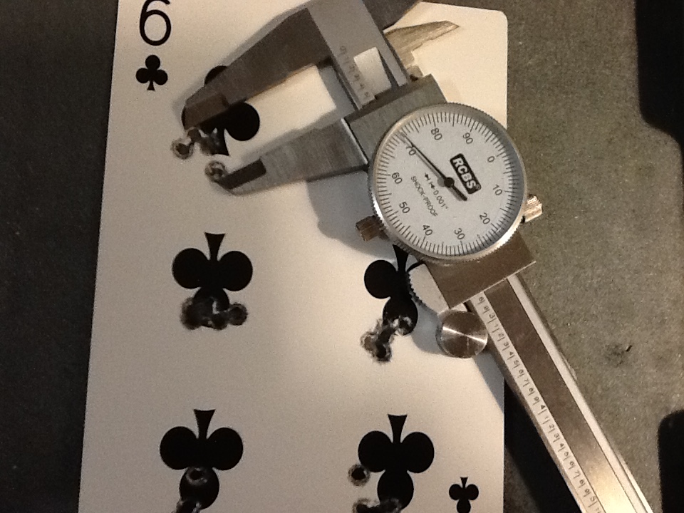

Measure the outside of the widest part of the group and subtract 1 bullet diameter(actually 2 halves of a bullet diameter). If I read your caliper correctly it should be: .71 minus .224 equals .486 center to center.
Balataspin, I have you on the results. You are measuring correctly: outside of the lead mark on the target and then subtract bullet diameter. There has been extensive discussion as to how much to subtract for bullet diameter over many years here on the Hide and other sites. As you know bullet diameter is 0.224" but the paper never reflects that (**NOT TO DISAGREE WITH QUICKDRAW BY ANY MEANS, just passing on some info that has been hashed over a bit**), but if you measure the actual mark left on the paper by the bullet you will see they are hardly ever 0.224" in diameter. I think this is because of how the paper target reacts during bullet impact, different paper will show different size holes from the same ammo shot out of the same barrel. The most proper way to measure actual CTC group size is to measure a few individual bullet holes in the target being used and take the average of those, use that diameter to determine group size. To keep things simple we (the people involved in the discussions years ago decided to use 0.222" as the standard, so everyone was on the same playing field. 0.222" seemed to be about the average single bullet hole diameter across several different target materials.
But to be honest I most certainly do NOT care what you use as long as it is close, because there is nothing on the line here this thread to me is about shooting, sharing information, pushing your own abilities, and seeing what is possible. This is not my thread, I only try and keep it rolling, this thread is for everyone. Thank you all for contributing as it has become a pretty large sample of what is possible in the world of 22lr, keep the targets coming guys and gals!
