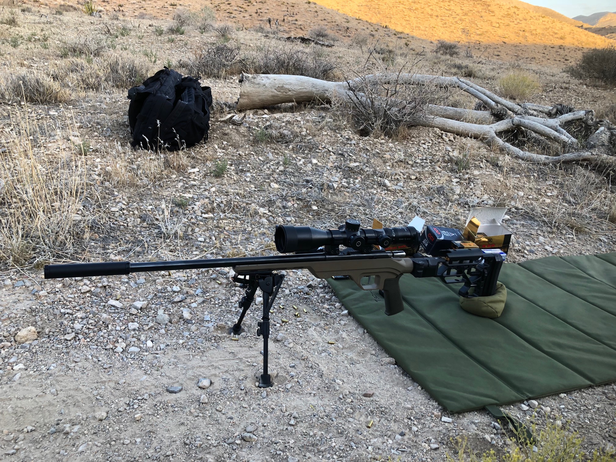

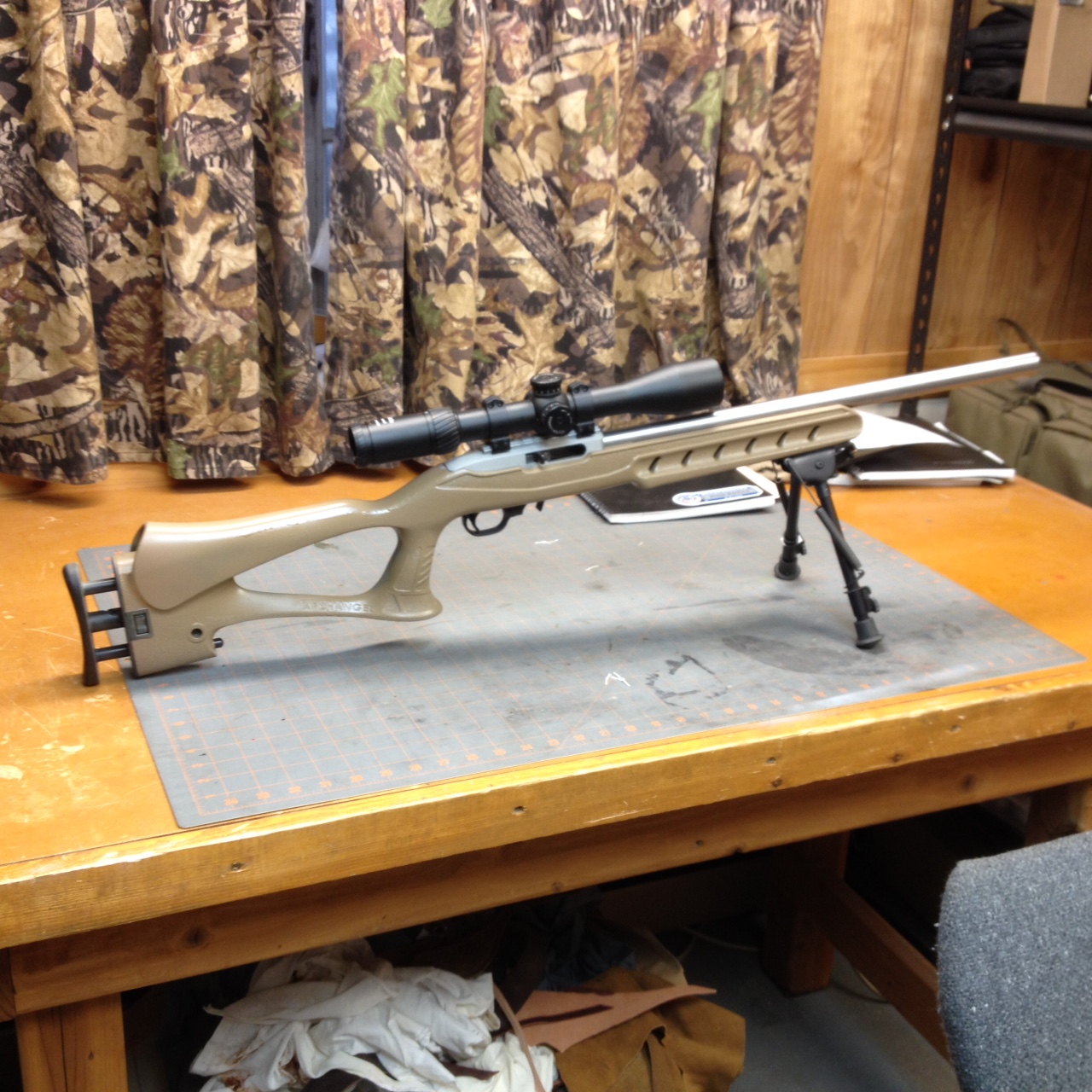

Ruger presicion rifle,with er shaw barrel finally got her dialed in. Shoots as good as my kidd 10/22 i heated up the factory barrel in the shape of a S sending back to ruger,,,,,S,,,,,,, stands fir sucks....
Er shaw done a fine job with there match grade barrel... Shot the same with sk yellow box as it did with sk red box and Lapua center x... Beded the areas i could with alluminum tape... ....

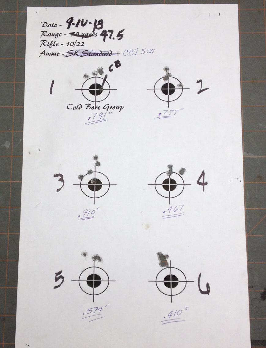

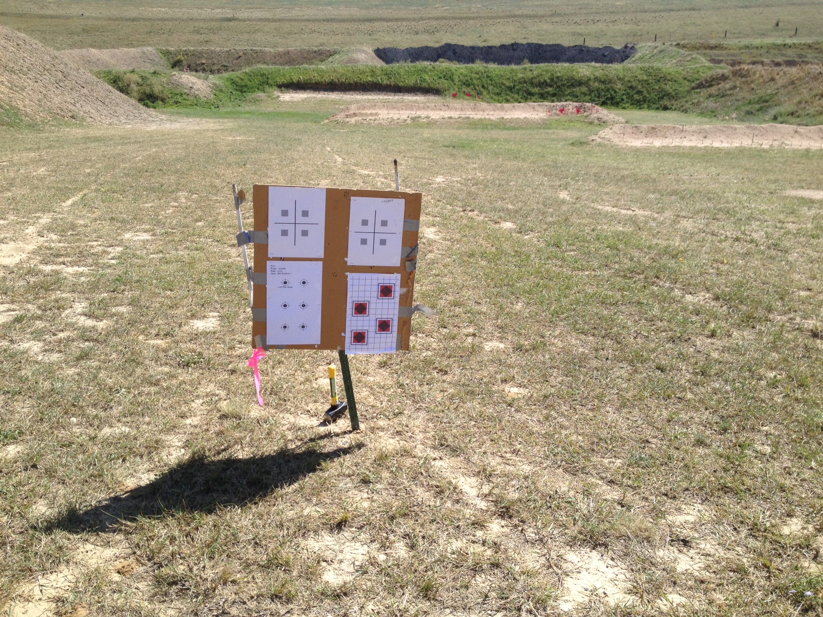

I saw this thread and liked the idea of cold bore 6x5 so gave it a try yesterday. Truthfully, my expectations were higher than my results...but it's a start.
Prior going to the range I had given the receiver and bolt a thorough cleaning which it was way over due for - but that may have affected the beginning groups. This is with a Ruger 10/22 that has a Green Mountain barrel, BX trigger, and the scope is the Cablea's Convenant FFP 4-16 44mm. It has a MOA Christmas tree retical and I'm really liking this scope.
I set the target frame at what I thought was 50 yards and after I began shooting I checked by the range finder and it was 47.5. Opps. You can the target is about to give it up - so I re-did that when I got home.
My best group was the last one - not sure if that is the gun settling in or the shooter.

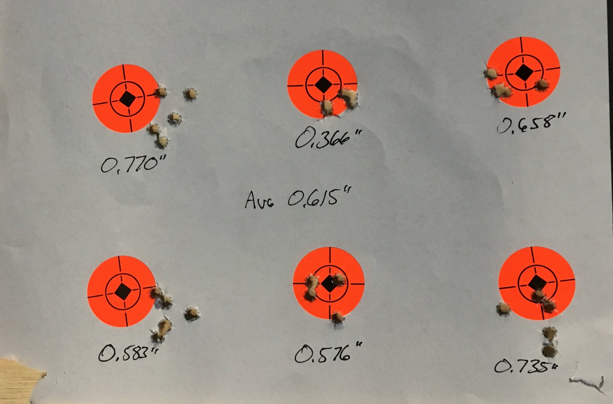

Ruger RPR 22LR @ 50 yards using SK RifleMatch... I don't have notes about the wind but generally we fight the wind a bit in the fall at this range. Re-barreled with a green Mountain 16" and continuing to work on little improvements here and there. I ended up with an overall target average of 0.449 for the target.
Reactions: quickdraw and dinc

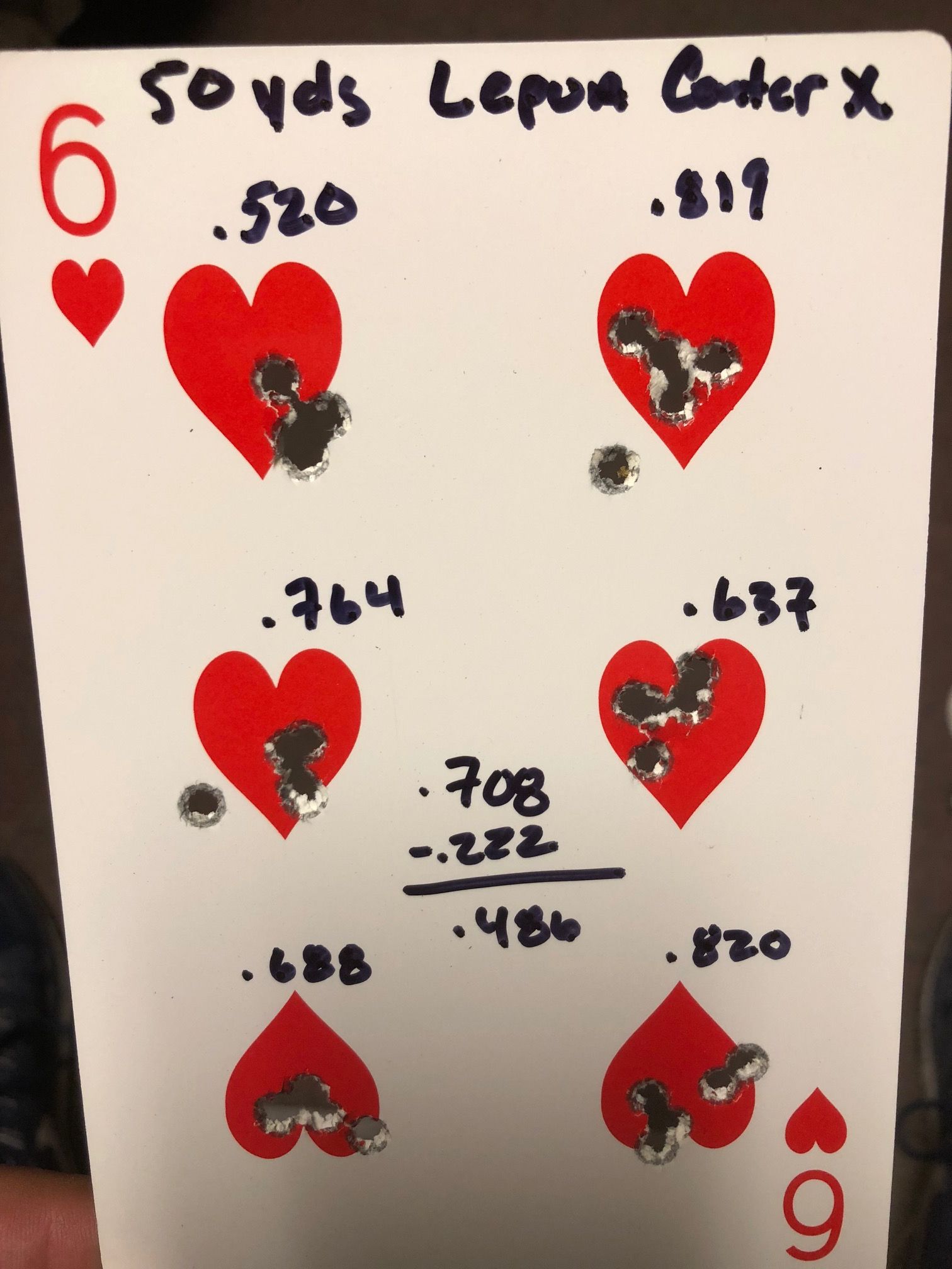

Nice, I think this is our first RPR. Nice job. I shoot playing cards often, the suits are challenging targets at 100 yards (1 round per suit)!

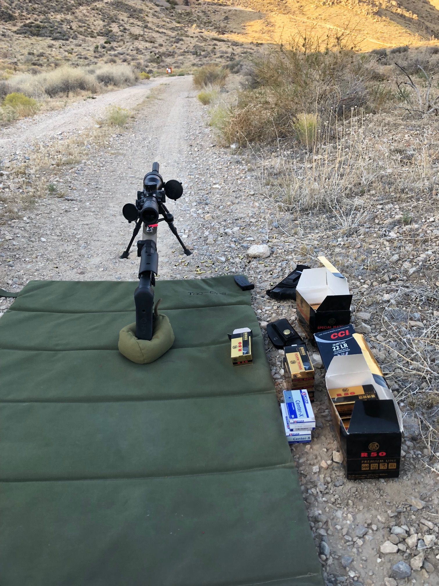

Vudoo Apparition 18" barrel, SK Pistol Match, 50 yards. Shot from my Booger Bench off the back porch. Smallest group: .253". Average: .346". 40 degrees and my flags were hanging straight down.
