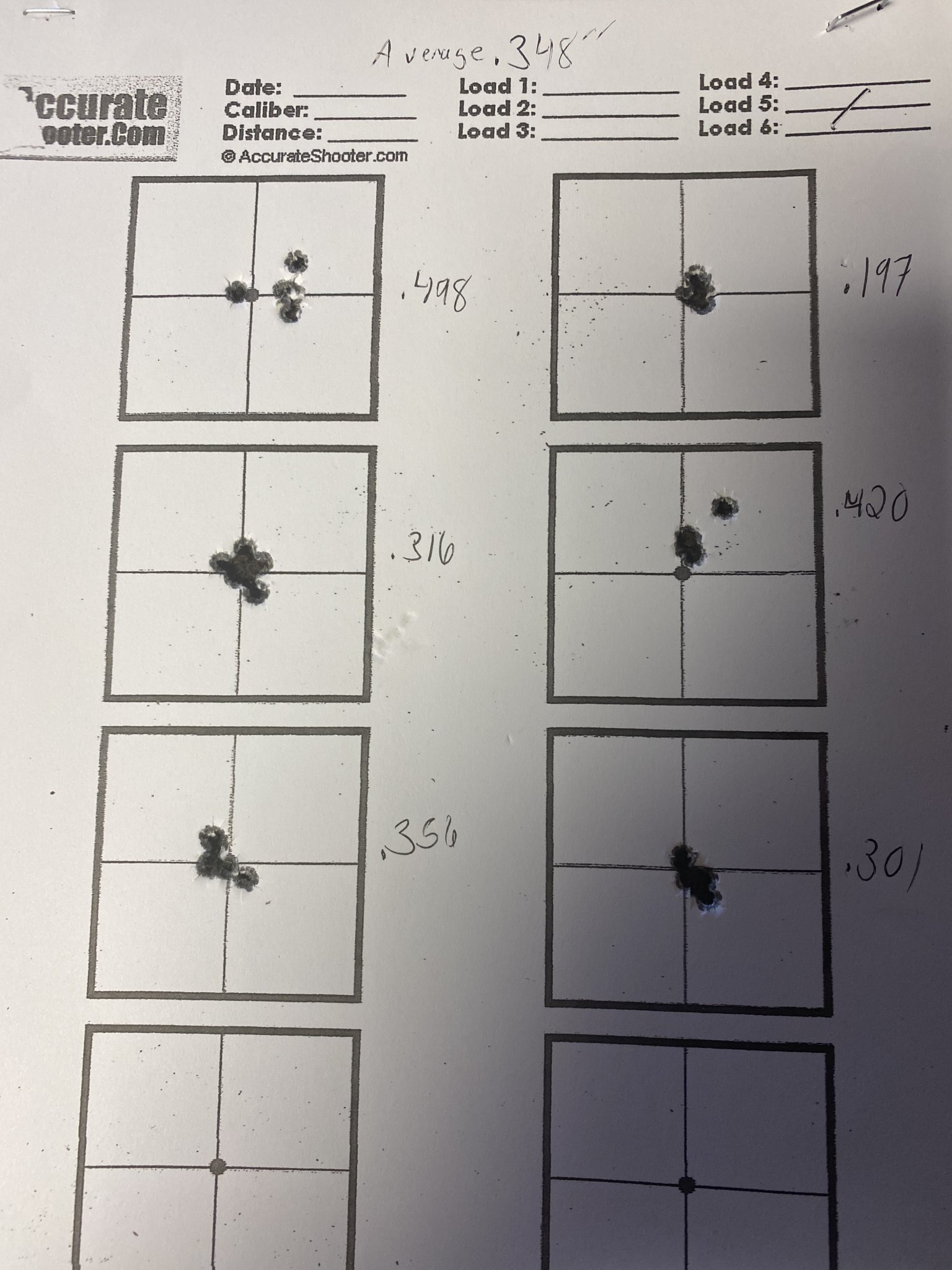

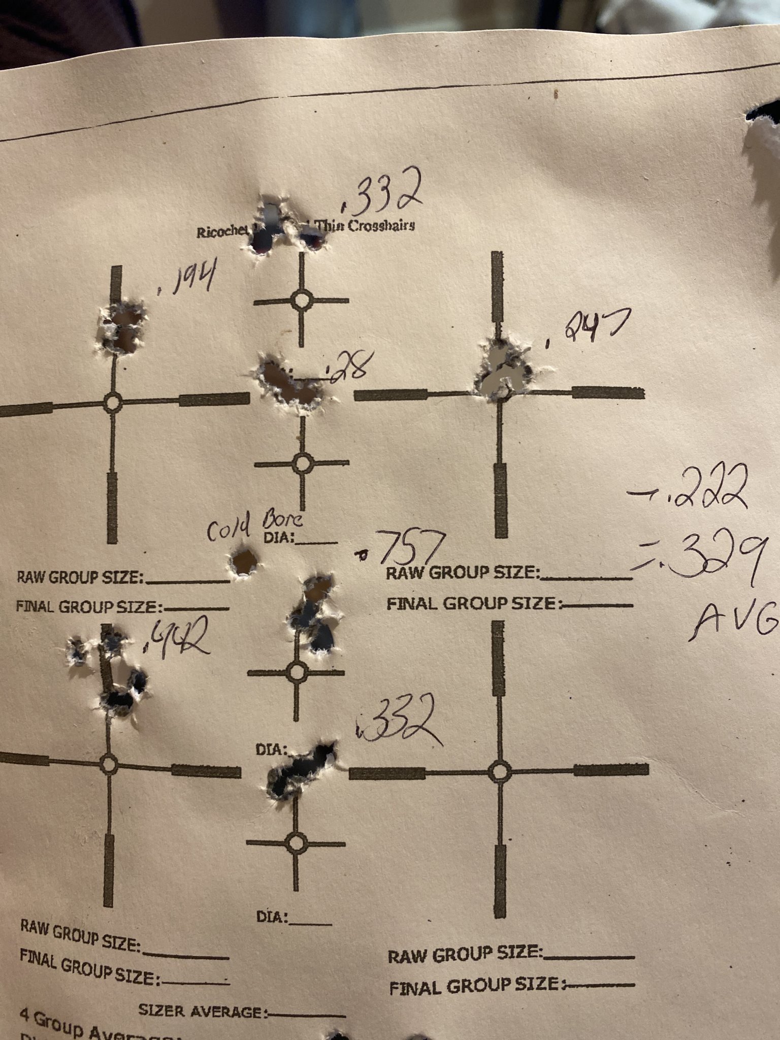

I was practicing for ARA today and decided to do a 6x5. I’m pretty sure I can improve on it. I had been shooting for hours and the cheap scope had my eyes all jacked up. Hopefully I get a chance to mount a Sightron 45x on it and zero it before Saturday’s match.
12/26/2021
50 yards
CZ 457 VPT MTR
Mueller 40x56
Center X
.348” average

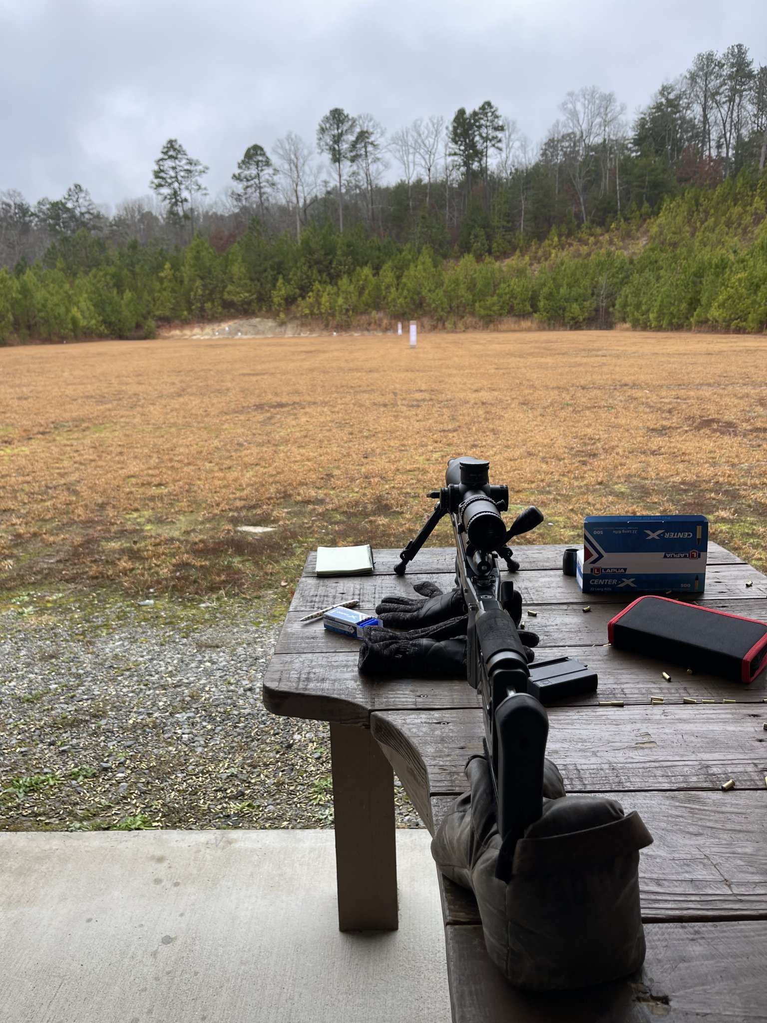

Today’s effort at 90M. The weather was challenging as you can see. I’m not using better ammunition because i think it would be wasted under these conditions.

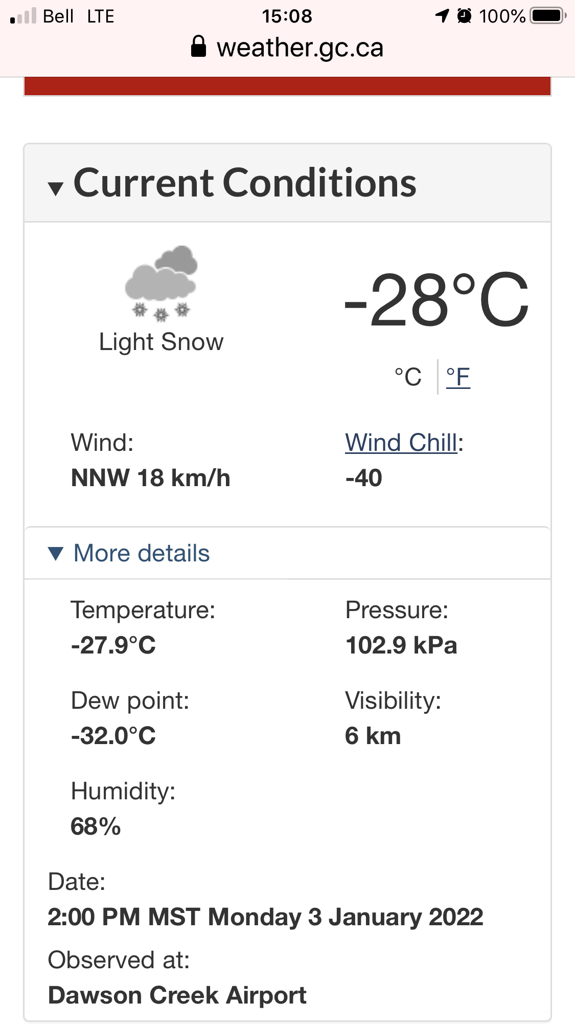

I try to keep the ammunition and rifle in the truck between strings. SK S+ and SKRM have been slow for me at all temps and in the factory and IBI barrels. 1035 yesterday, barely 1000 in the factory barrel. Eley is close to the box velocity.
thanks :cool: similar to my experience, although i tend to give up below -10 C

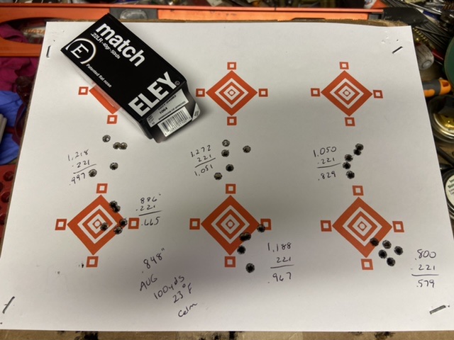

Here’s my submission for cold weather. 23degrees but calm, sun was setting. Shot prone 100 yards. Vudoo with jewel trigger, Foundation Centurion, NF 7-35. I have been wanting to test eley for a while. I didn’t “tune” any at all. Started out with clean barrel, shot 5 at 50yds then went straight for 100. It may have done better if I had shot a few more foulers. I shot top row left to right, then bottom row left to right. I did come down .2tenths as I cycled through the groups. Best group was .579" and average was .848".

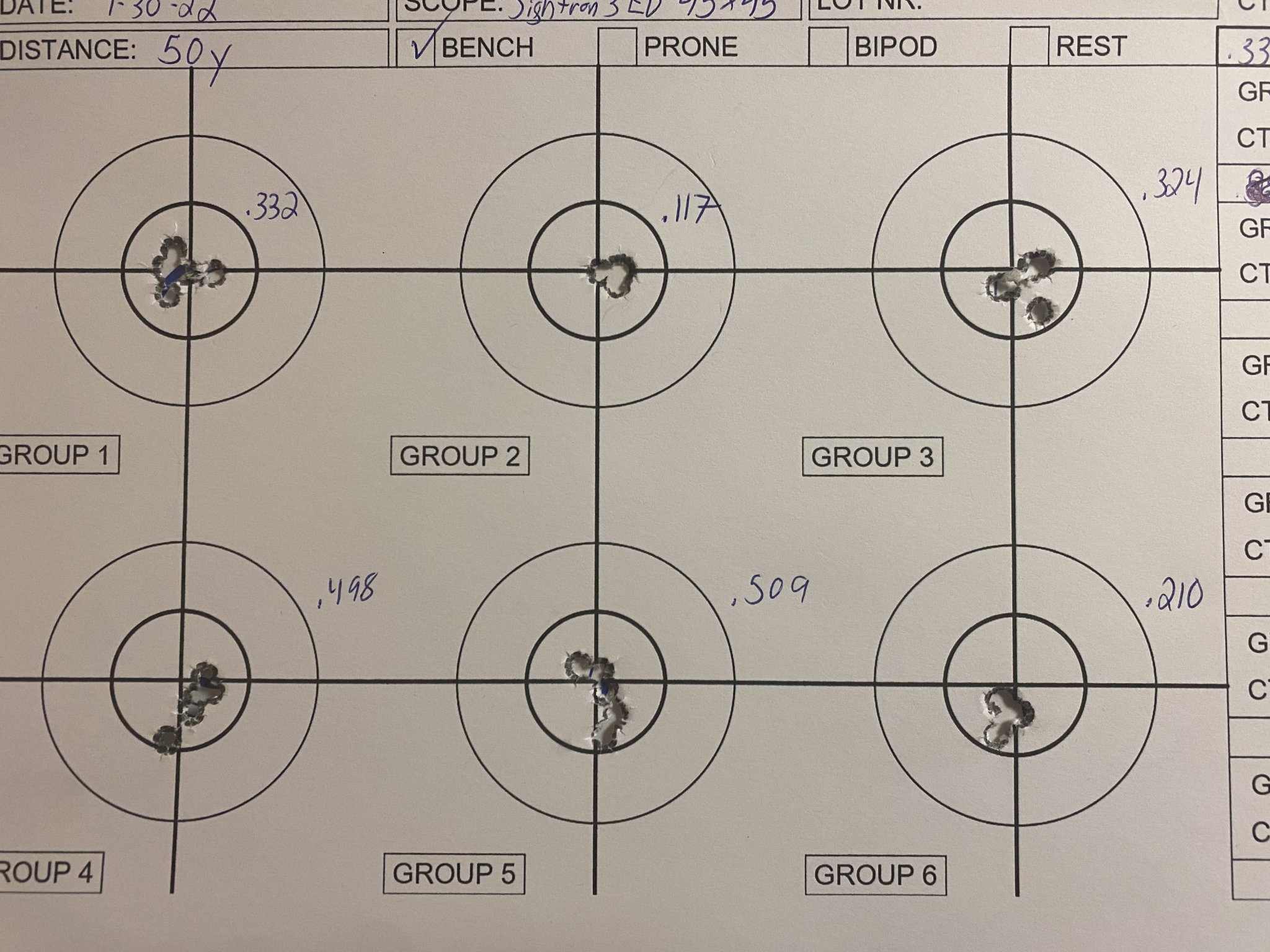

I’m not too happy with the results, but I have to start somewhere. This setup did great at a recent ARA Factory match. I have another VPT that is being lot tested at Lapua in AZ so I’ll have another entry soon.
1/30/22
CZ 457 VPT MTR
Sightron 3 ED 45x45
Lapua Center X (random lot)
Indoors
.331” Average
.117” best group

View attachment 7797513View attachment 7797512
Where do you shoot if I may ask?
I switch back and forth between an unbraked 300PRC and an 18 lbs 22LR. Sometimes there is an SKS mag dump on the line too. I like to work at ignoring the distractions.

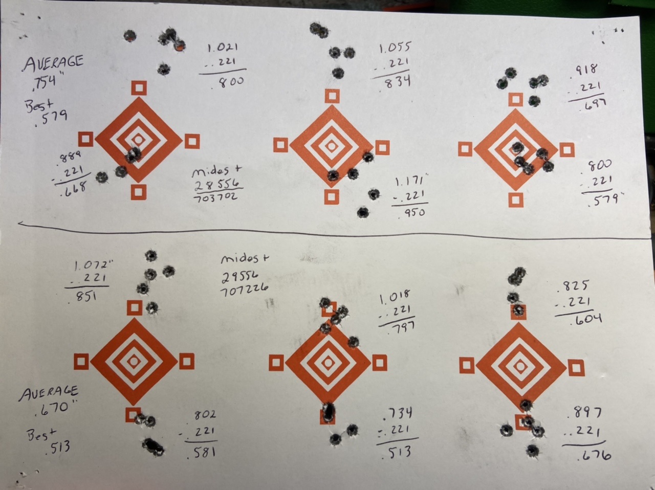

We still had lots of snow on the ground but temperature was nice and I got a new lot of midas+ so I had to try it. The top half was my original lot (28 speed) but I hadn't been able to test it in decent weather. It shot an average of .754" with best 5 shot being .579". Bottom half of target was new lot (29 Speed) that shot an average of .670" and a best 5 shot of .513".. All shot 100 yds prone and temp was 56F and cooled off to around 50F before I was done. Same rifle V22 Vudoo with 7-35NF.

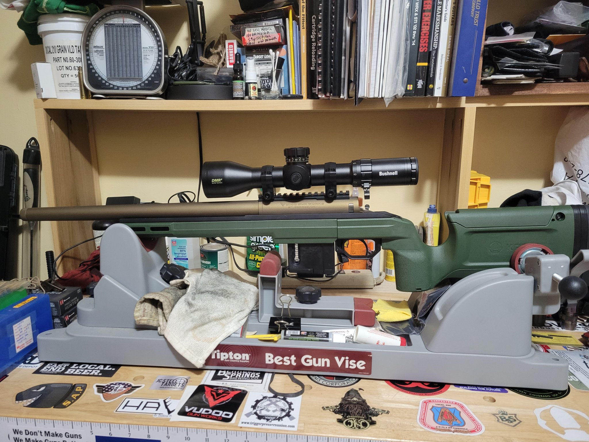

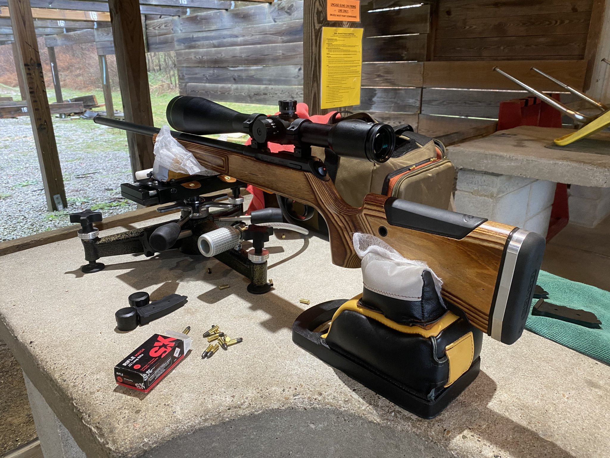

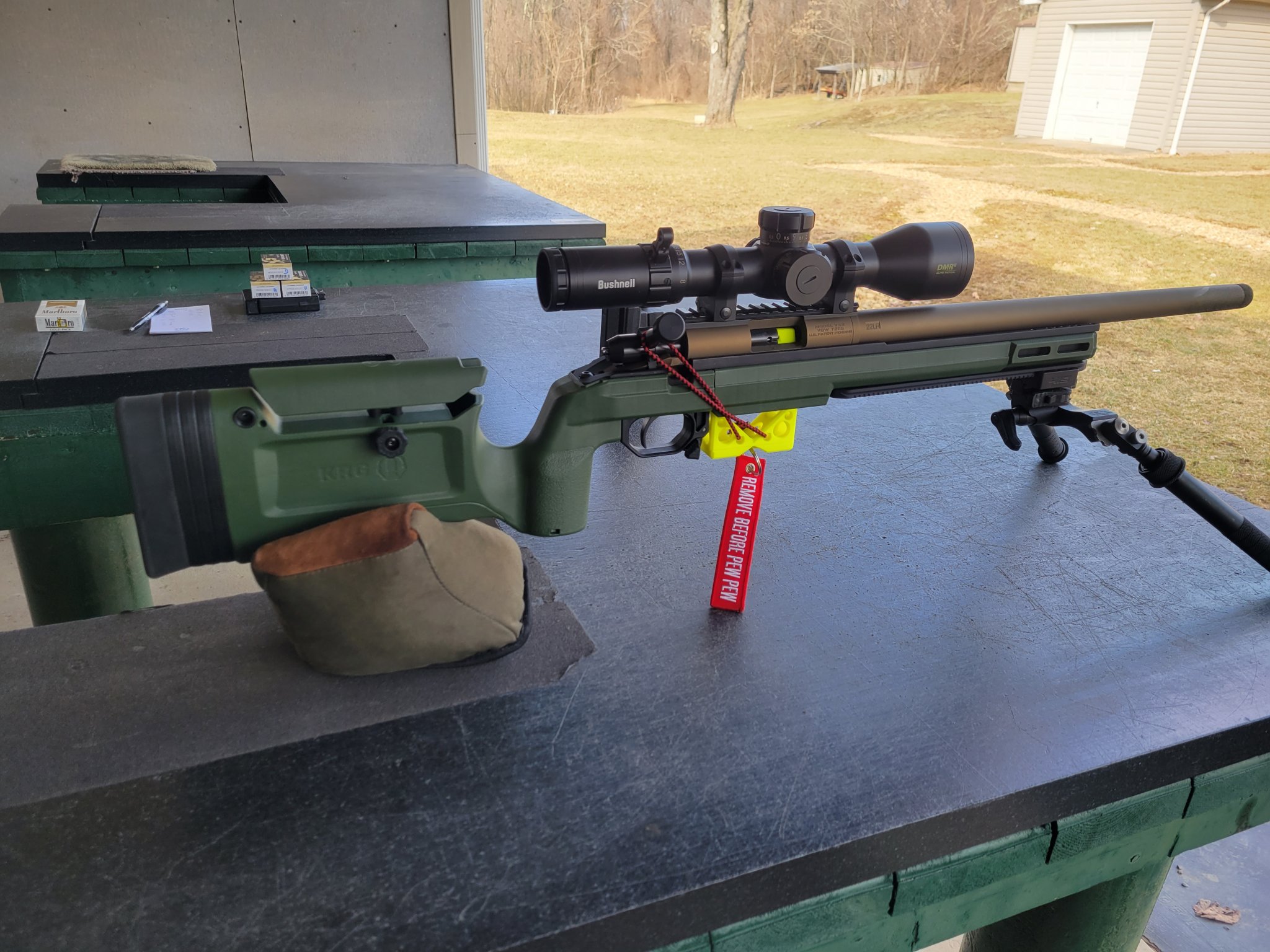

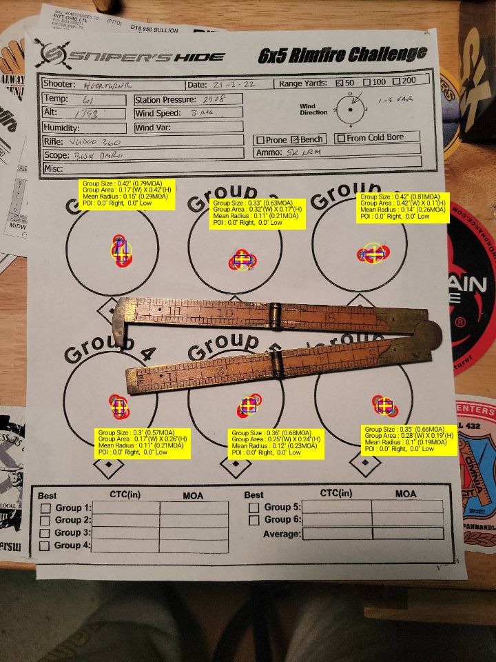

Here's the first submission with the new baby
Vudoo 360 Apparition 18" MTU contour Ace barrel.
Random lot of SK LR MATCH, these are rounds 120-150 on the gun.
Still adjusting things and getting the feel of it.
Target was shot on bench with a S-CAL bipod and rear bag.
I have to say, I'm definitely becoming a Vudoo fan!
Forgot to add : 0.363 avg!!!

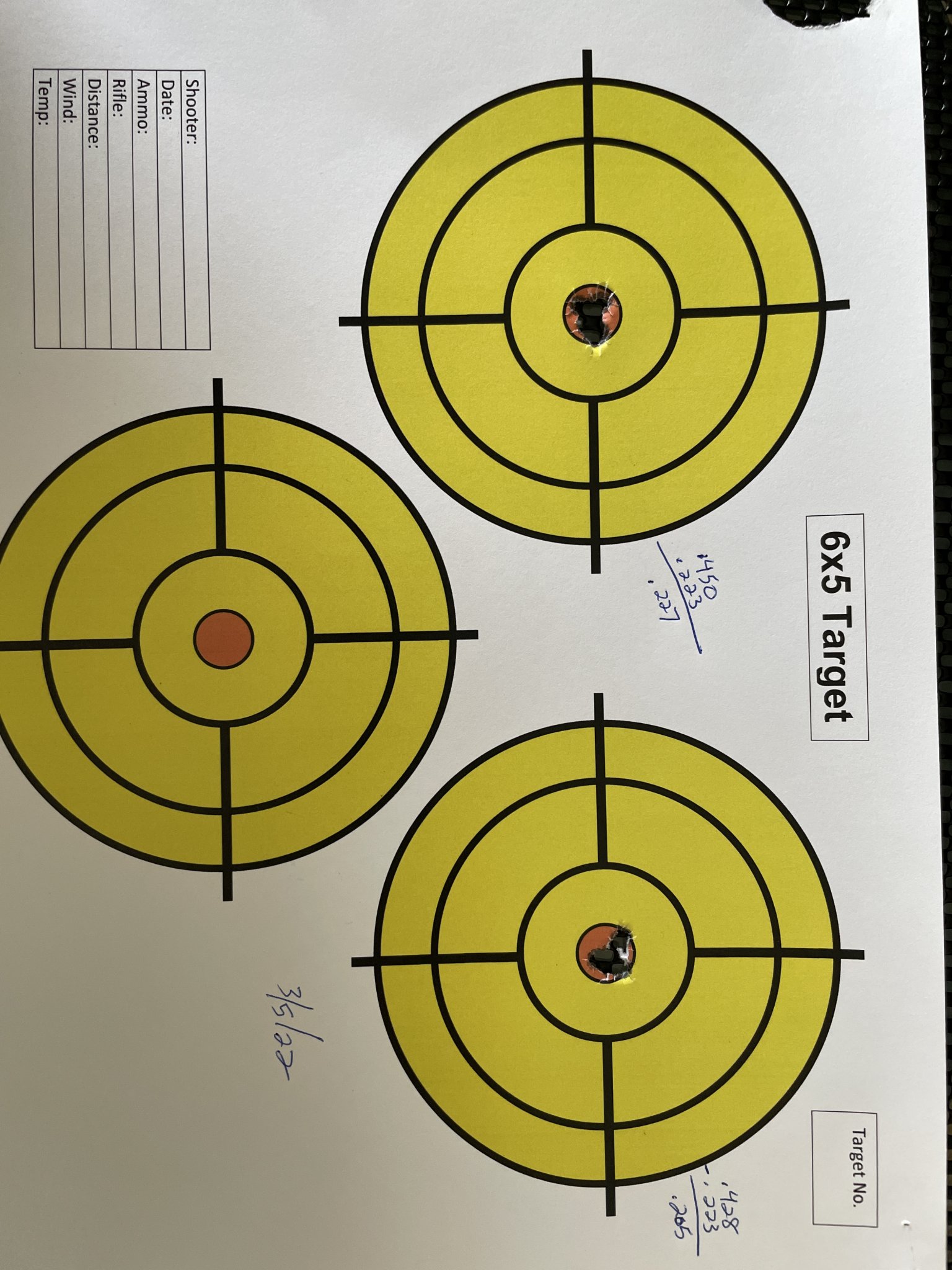

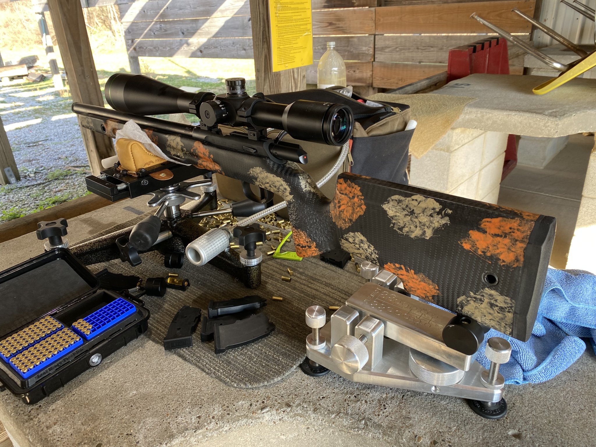

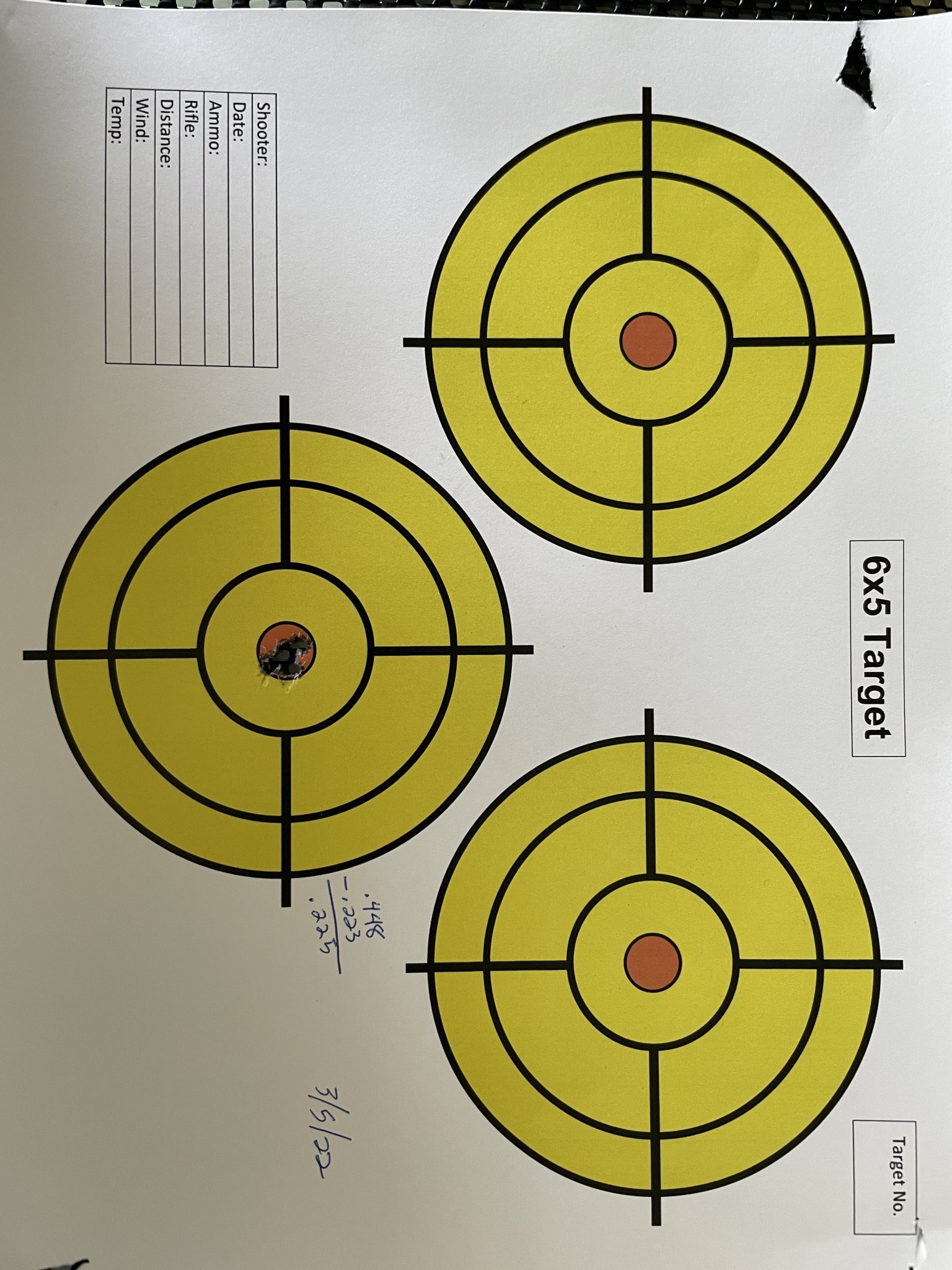

jbell, had a chance to get outside today.
Temp - 47
WInds - 8mph from the southeast
Humidity - 57%
I posted three targets, with three bulls on each target. I shot the first target, then moved down, shot the two bulls on the top of the page, then moved down to the lower bull, but adjusted my scope down to the third target, hence shooting 3 bulls on the first target, 2 bulls on the second target, and the center lower bull on the last target.
No cold bore shot included.
Groups:
.225
.227
.205
.159
.251
.255 = 1.322/6 = 0.220 ave. (.159 best group)
Rifle:
Holeshot 2500x action, Shilen rachet barrel, Harrell's tuner, Scott's Mid-Barrel tuner, NF 15-55 Competition scope, Bix n Andy trigger, McMillan SF Straightline stock.
RFS99

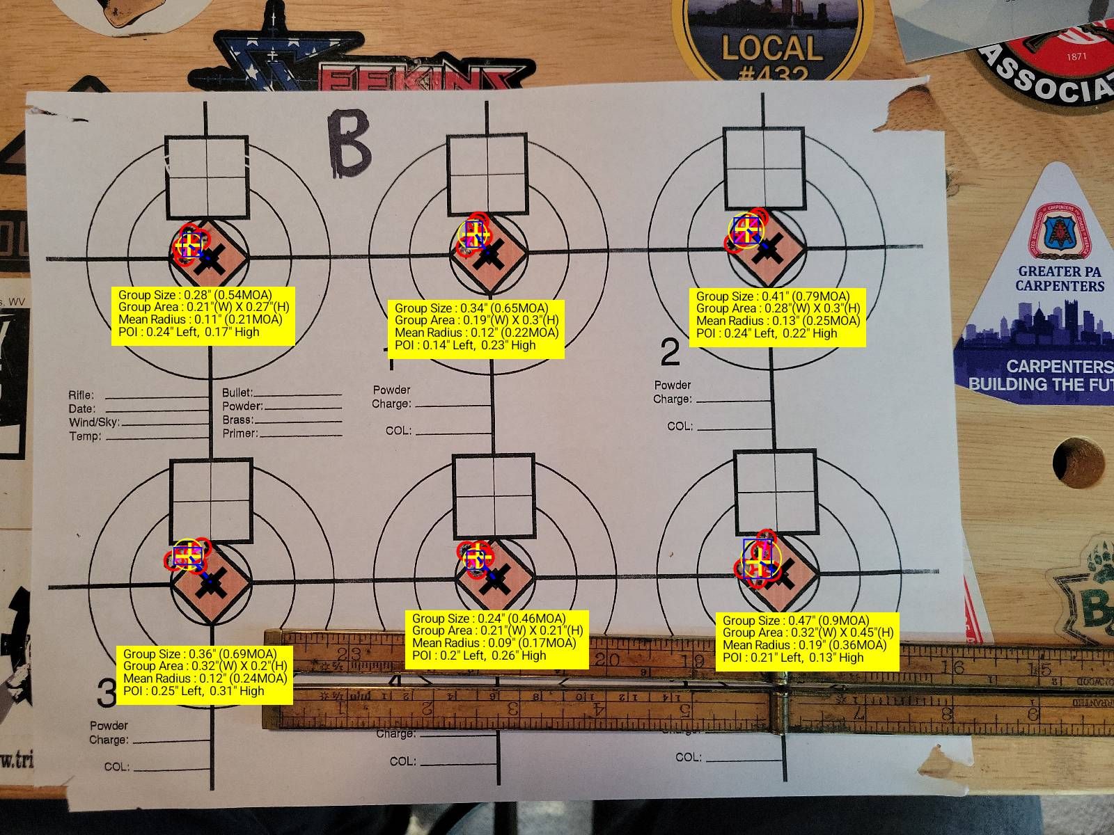

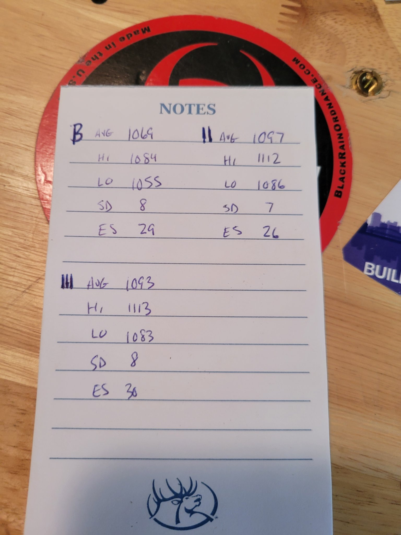

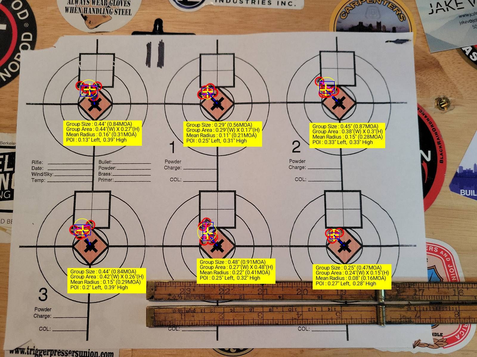

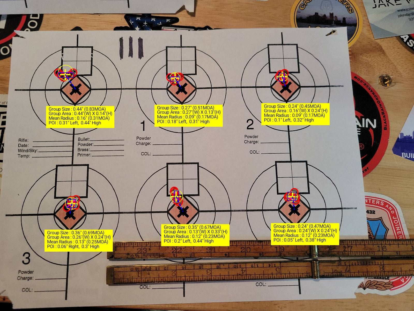

Ok, did a little lot test on 3 lots of SK LR that I've got in the new Vudoo.
The setup:
First, 20 rounds of each at 50yds with the magnetospeed..
Chronograph results:
Then a 6x5 of each lot:
0.35 average
0.391 average the wind got a little squirrely for groups 2 and 4..
0.316 average Looks like this is going to be the match ammo for the next few months!
I will get it lot tested at Lapua sometime this year hopefully but this should do for now.

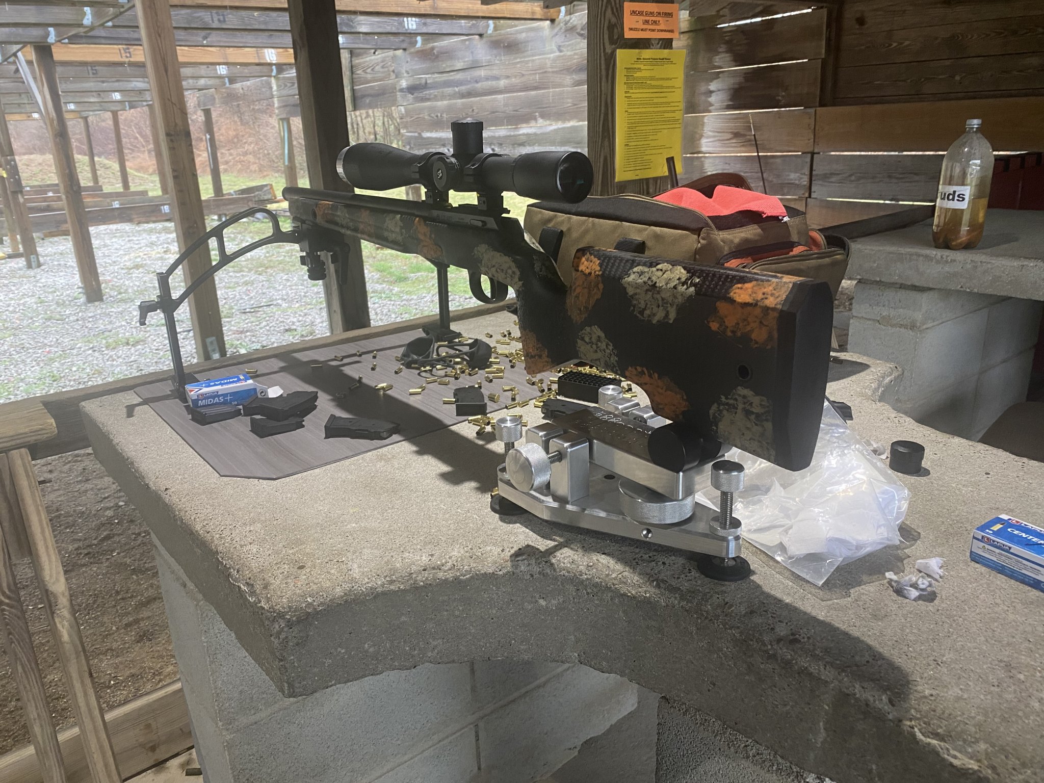

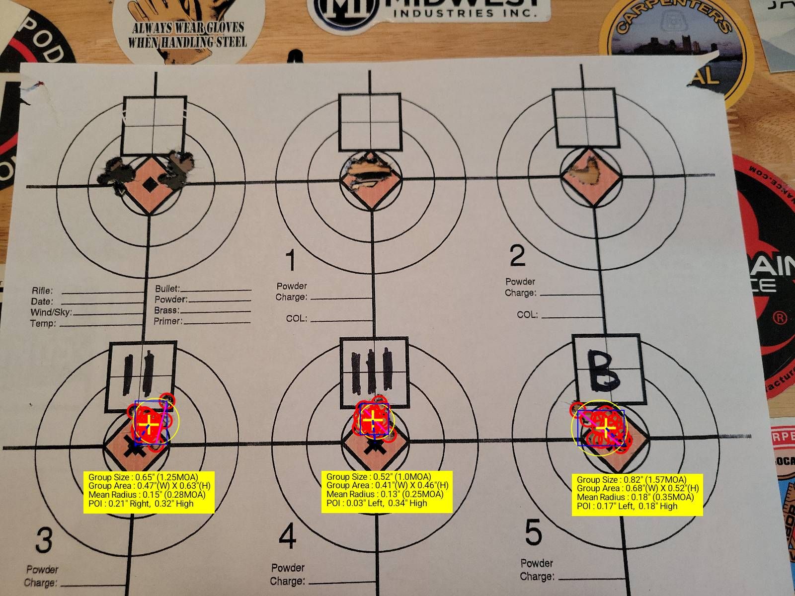

It was raining and windy today, but I had to shoot some. The targets were soaking wet so when I measured I measured some of the holes to where the grease ring should have been. I shot one with Center X, but the Midas+ was the winner, barely.
CZ 457 VPT MTR
SightronIII ED 45x45
Midas +
.330” Average

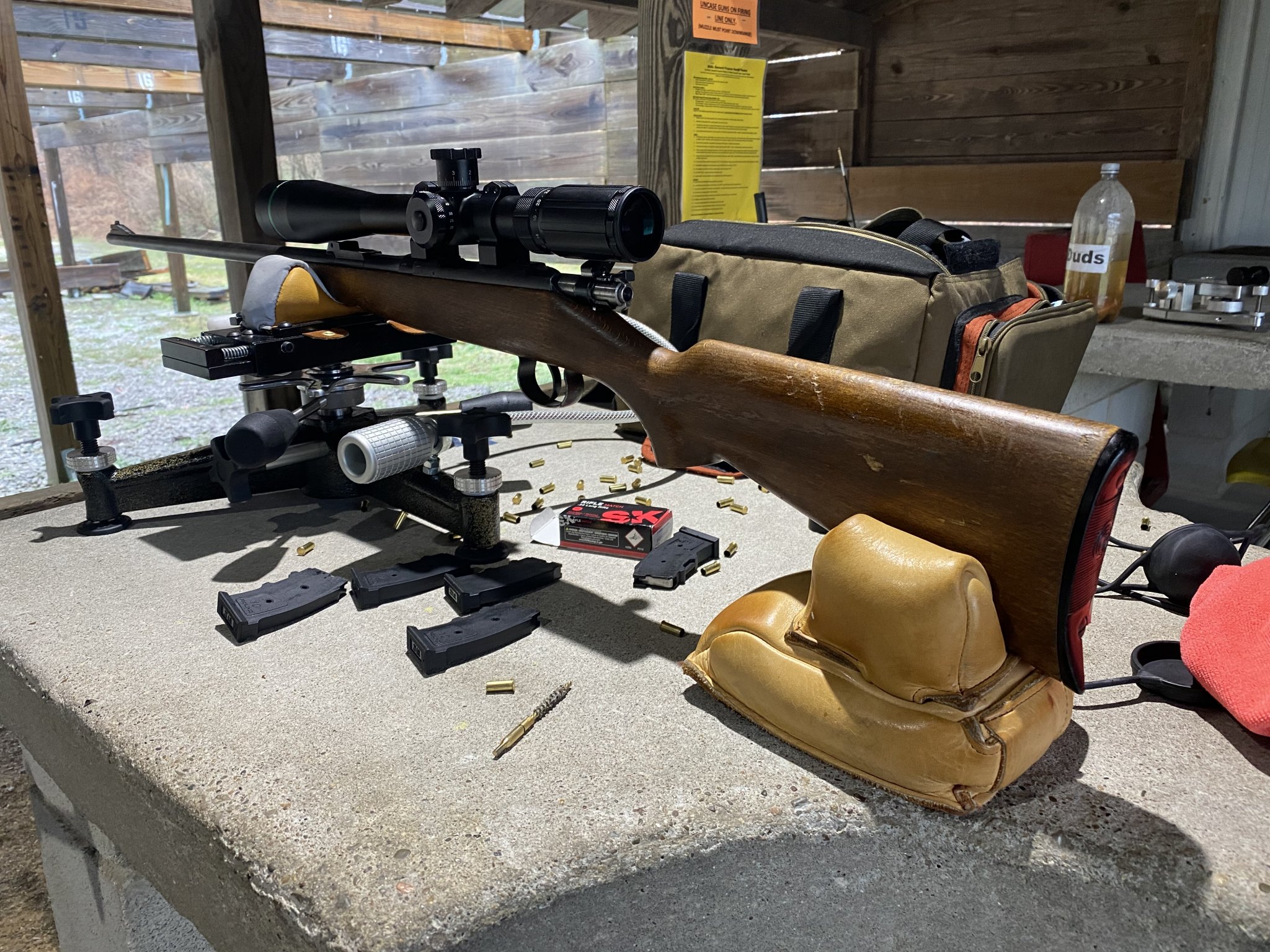

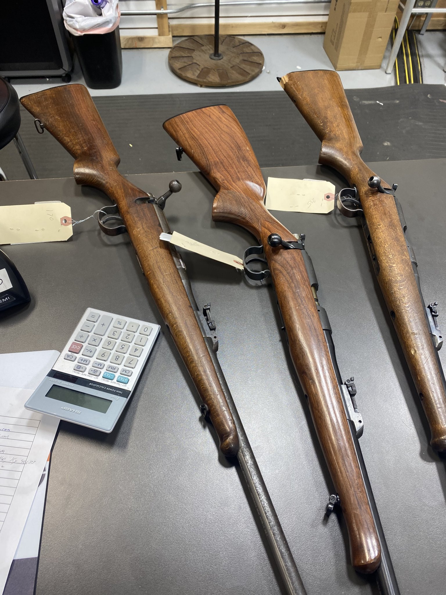

I bought two 1957 model BRNO model 2’s recently, both beat up pretty badly. I tried to shoot this one last week, but the firing pin spring was weak and wouldn’t hit hard enough to fire. I took the bolt apart to put a new spring in and discovered the “lube” inside was all sticky after a few decades. That was what the problem was. The trigger is kind of heavy compared to what I’m used to. I’ll fix that.
Apparently this thing is pretty darn accurate. I can’t wait to do the trigger and shoot some Center X through it.
I still have to try the other one out. I also have a new, old 452 Lux too and I have a NIB CZ 452 2500 Super BRNO with a 29” barrel enroute. That’s enough CZ’s for a while.
This target was soaking wet too. I measured to where the grease ring would have been.
