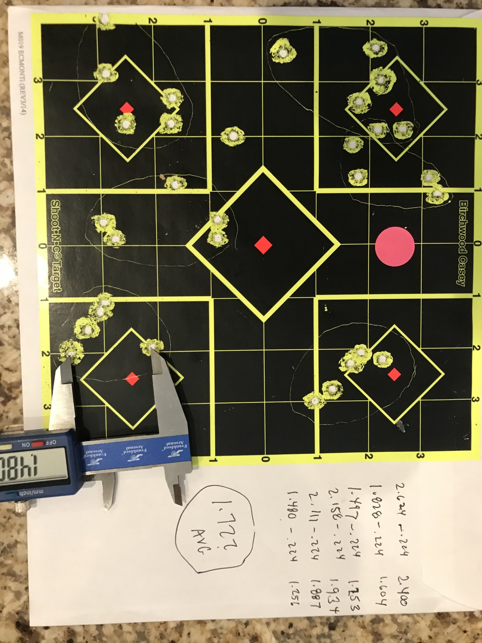

200 yard 6x5
Vudoo
Eley Tenex
Winds SSW 1-2mph
Shot at 8:45 was sighter,
Best 1.256"
Avg 1.722"

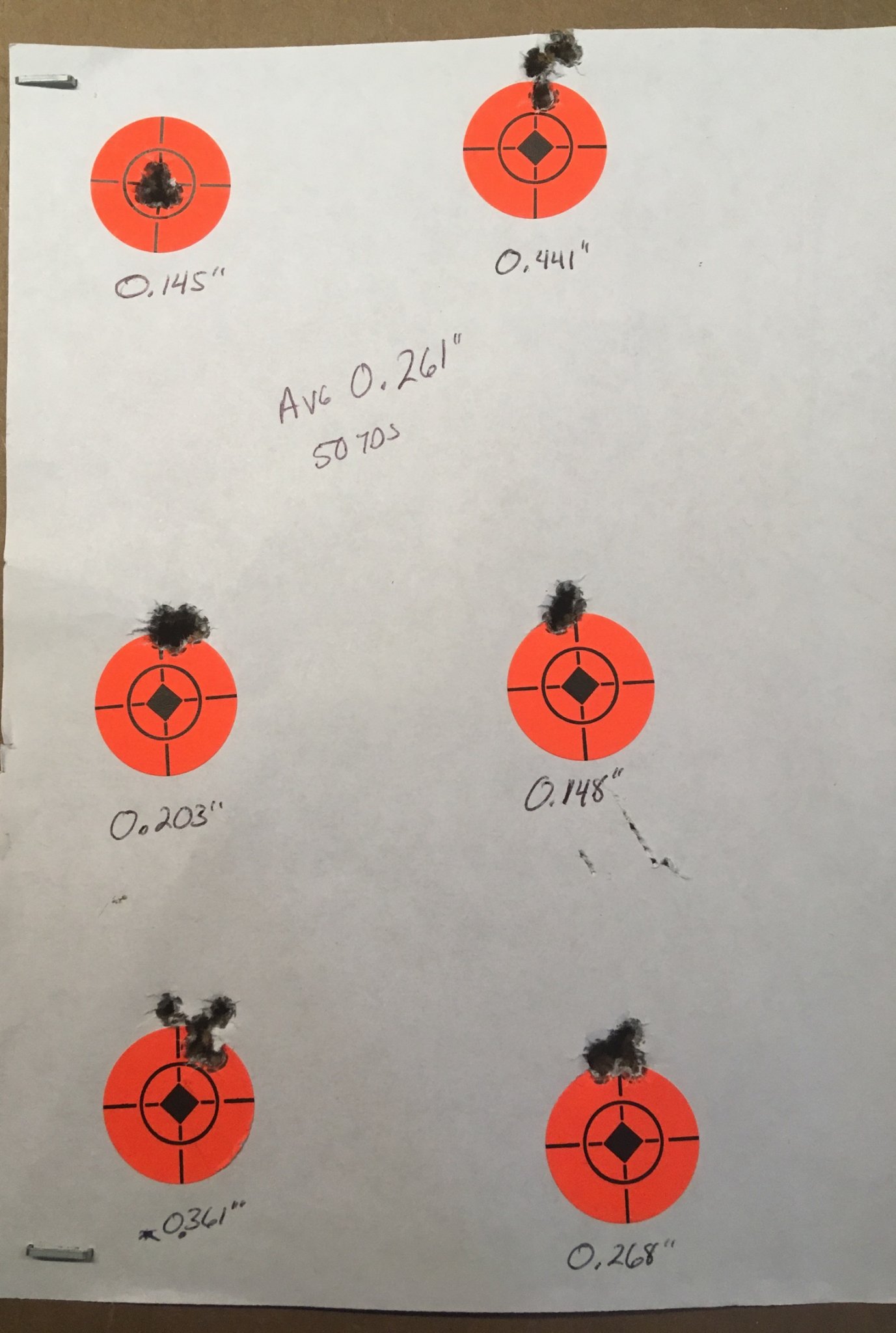

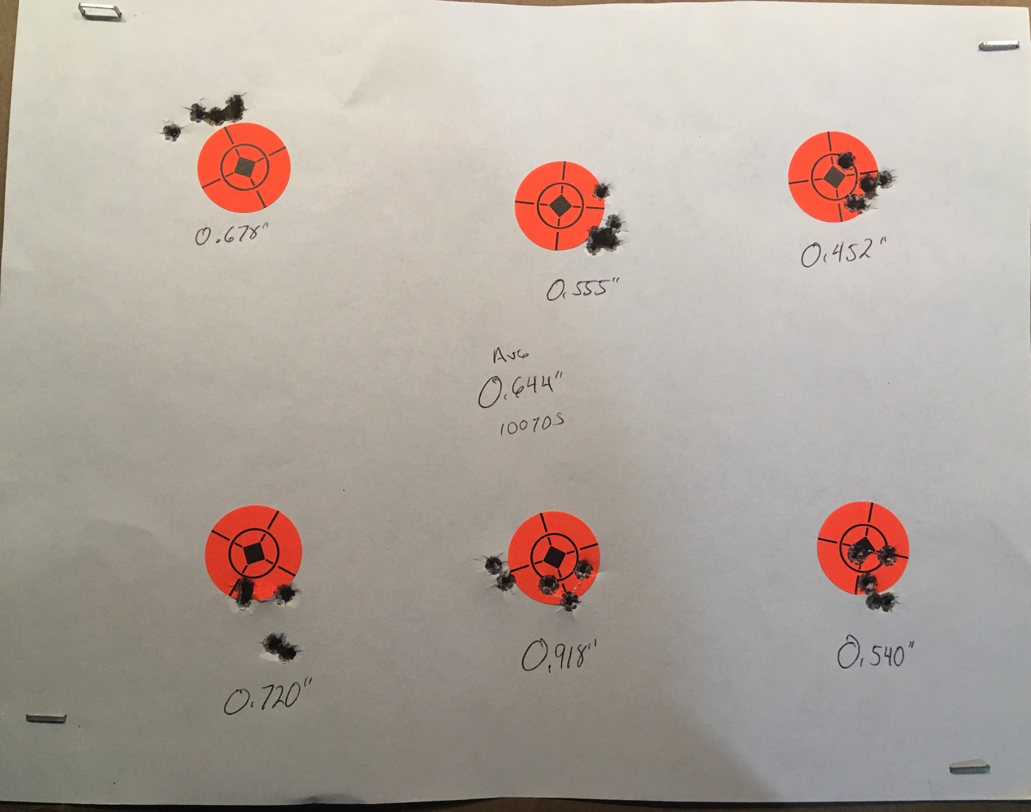

I hadn't intended to shoot a 6x5 today. I just wanted to shoot a little bit. I keep a target posted at 50 yards off my back porch so I can shoot any time I want without needing to post a target first. It seems I had a new target with no holes. I decided to shoot my Anschutz MPR because it doesn't get much attention since I got my Vudoo. First group looked pretty good so I shot 5 more. ;) I used a front bag instead of a bipod.
50 yards.
Anschutz MPR
SK Pistol Match.
60* slight wind, raining a little
Average: .4105"
Best: .278"

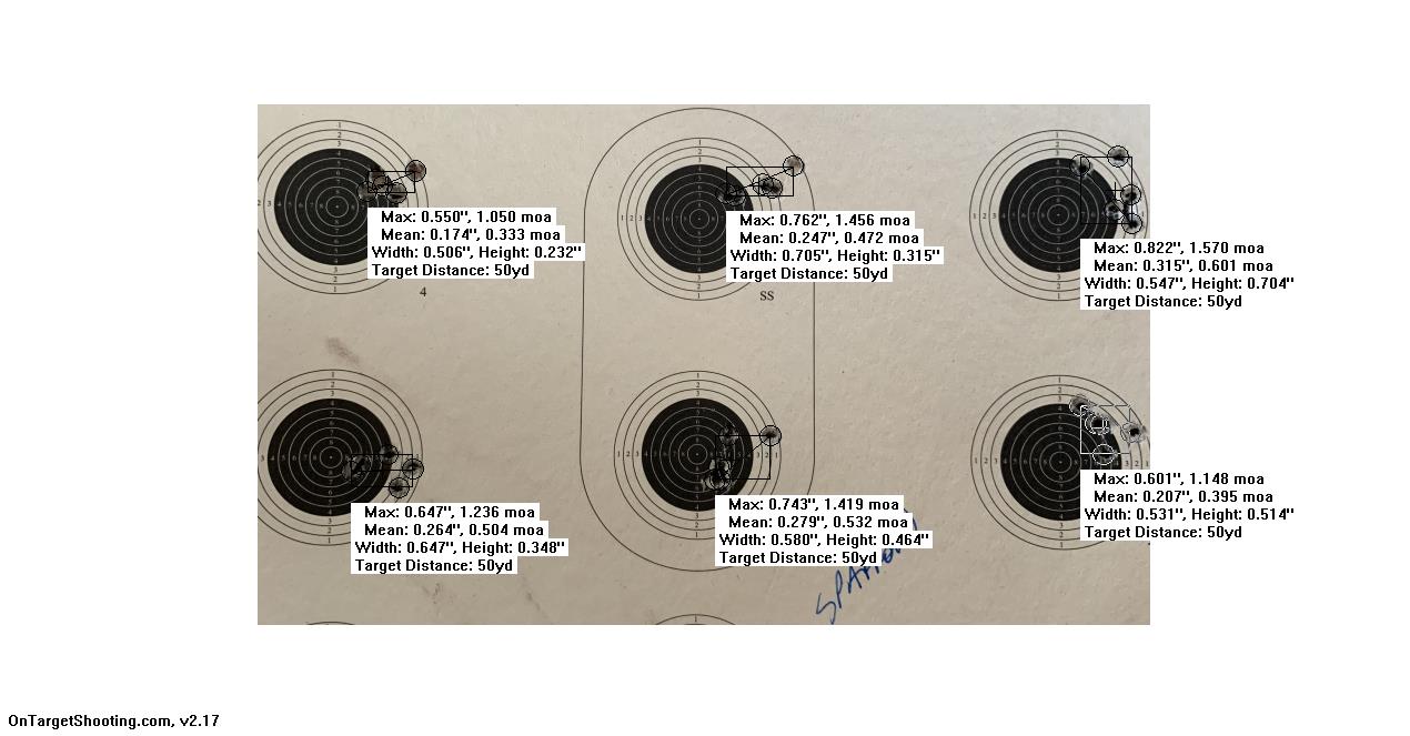

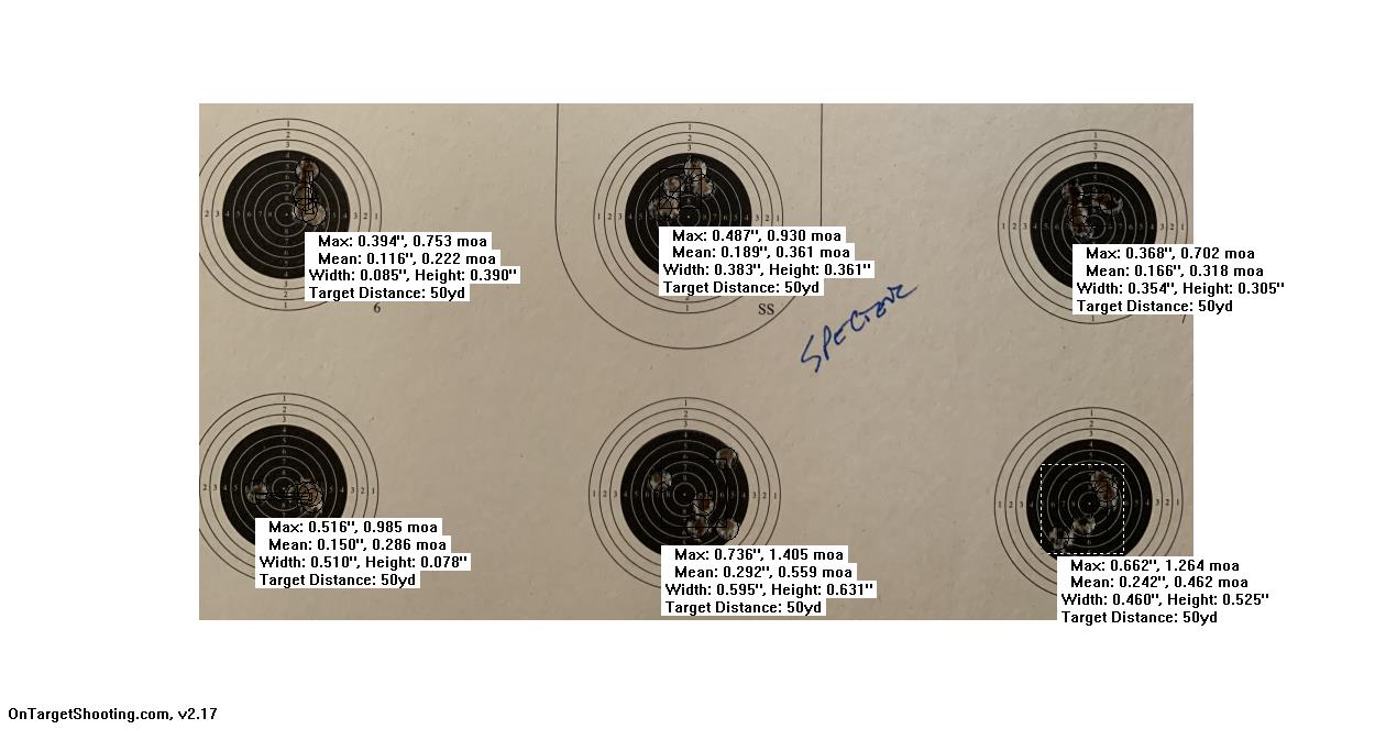

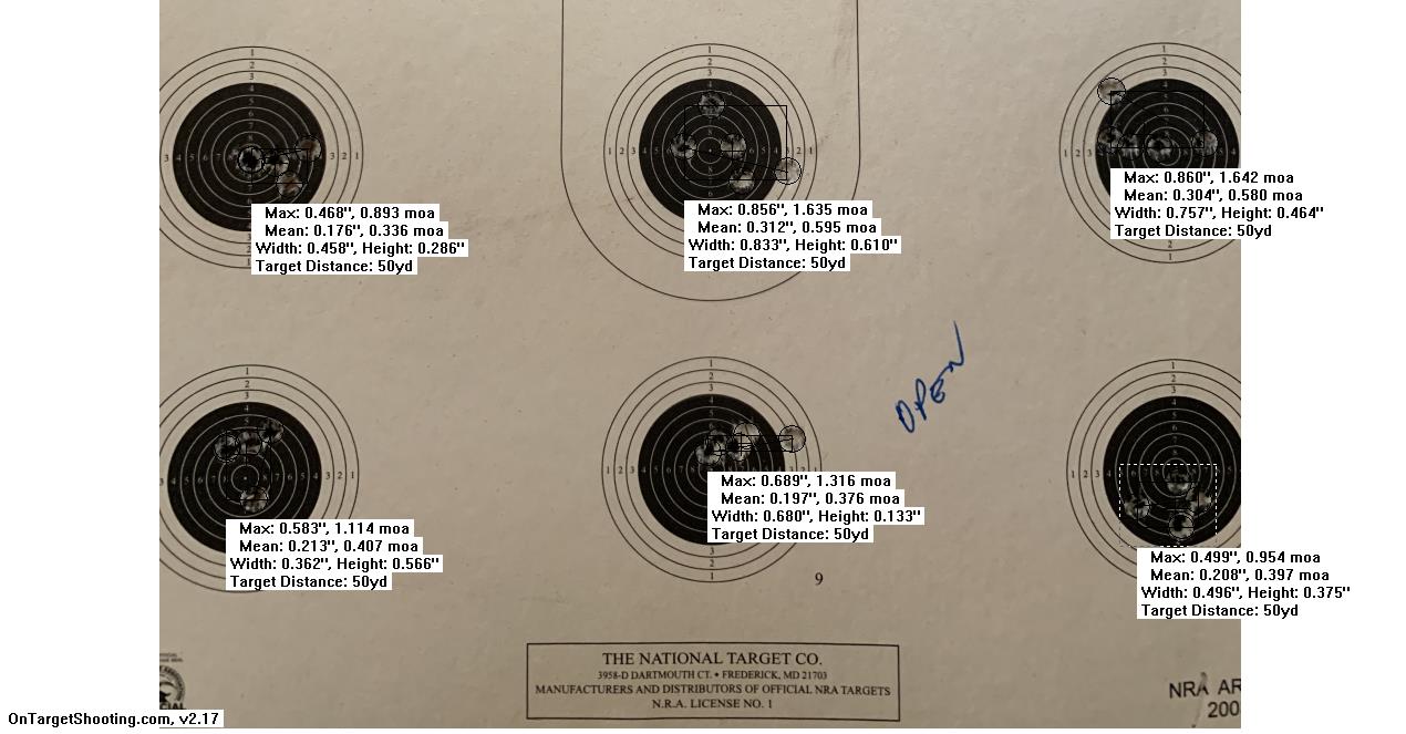

No changes to my posted results, but thought I would post this here for those interested. Did a back to back to back test of my Ruger Precision Rimfire rifle (Athlon Ares ETR, UTG Bipod) with my Sparrow II, no suppressor, and my Spectre II. Same ammo (CCI SV), same range, same shooter (me) and as similar conditions as possible. Shot them in 6X5 so I figured I'd post here.
Conditions:
40 degrees when I started, somewhere in the 48-50 degree range when I finished. Winds blowing every damn direction, left, right, at me...
Results:
0.468" Best, 0.659" Average with No Suppressor
0.550" Best, 0.688" Average with Sparrow II
0.394" Best, 0.527" Average with Spectre II - although Group #4 had a lot of potential except for that one shot (Always how it goes)
Also shot some 15 shot groups at 100 - wind was really messing with those as were a couple noticeably louder, so presumably faster, rounds.
Will need to run some more test, but I have been shooting primarily with my Sparrow attached. Considering shifting focus to the Spectre...
Even though the average was smaller w/o a suppressor it looks like the Spectre had a better tune to it with some single round fliers that hurt the average, but I know the rifle with the Sparrow has turned in better averages. How does the rifle with the Spectre do with better ammo?? I feel like everything you have posted with the rifle has been with the Sparrow as opposed to the Spectre.
Everything to date (before this test) was with the Sparrow as I have traditionally gotten slightly better results with it on other rifles. Need to experiment a little more with different ammo head to head. I have some Wolf, I think some R50, and I have some Center-X on its way. Groups were larger than best posted across the board - probably due to the suck wind conditions.
ETA: Part of the reason I have been focusing on the CCI SV is that this rifle seems to like it, I have a stash of it, and I am curious how far I can wring a $350 gun with $2/box ammo.

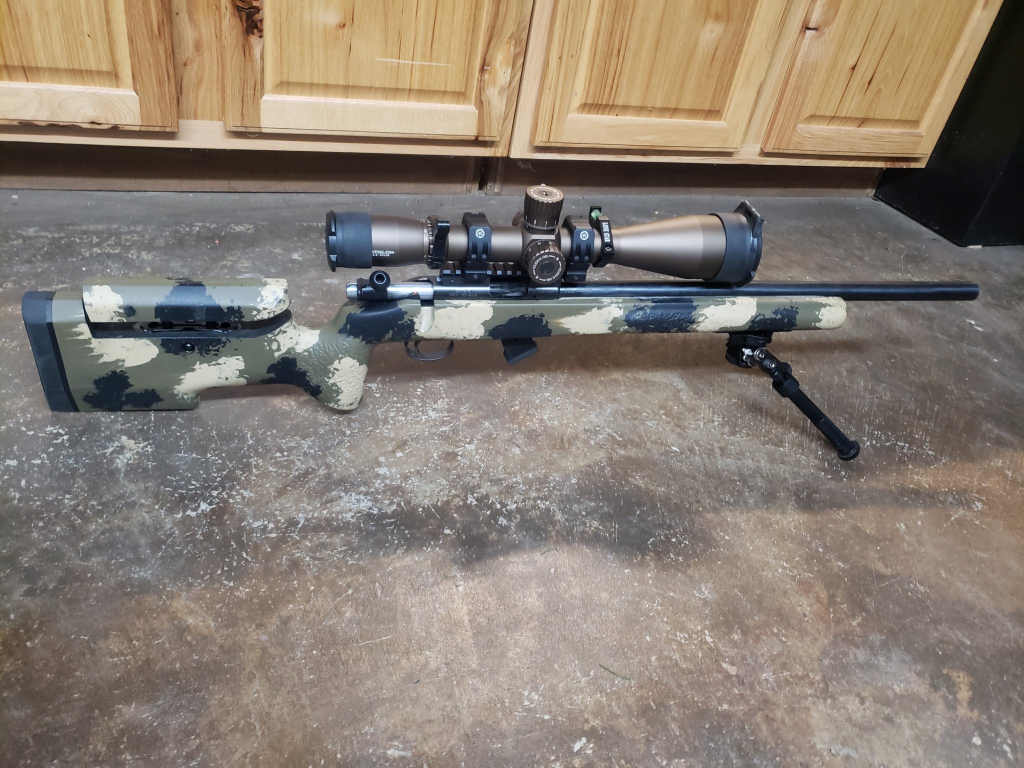

I've been tinkering with this rifle for the past couple of weeks and I'm starting to get it lined out. I'm still doing some testing and I believe I'll get better results in the future.

I started the build by turning the shoulder of the stock barrel so I could set the head space with shims like the lilja setup. I recrowned the barrel. I glued the barrel into the action. Polished the internals. Switched out trigger springs. Pillar and glass bedded the action and barrel. At first I had only 3 inches of the barrel bedded and it shot pretty well. I wanted to experiment, so I bedded the rest of the barrel, it shot worse. So far I have taken 1 inch of bedding off of the muzzle end. This is currently where I'm at. Will shoot indoors today and see if I can work on those group sizes.

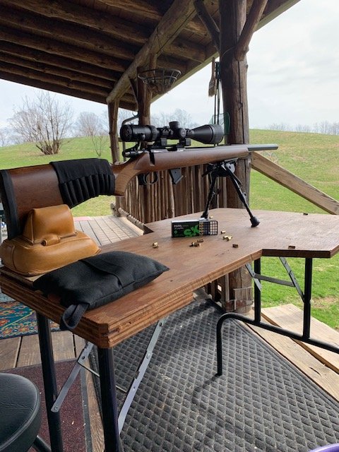

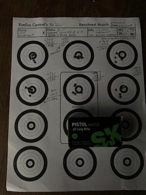

An attempt with my CZ 455 Varmint. Vortex Crossfire II 6-18, SK Pistol Match. Shot from my portable bench with a bipod and rear bag. Smallest group: .461, average: .547. That's about what I can always expect from this rifle.
