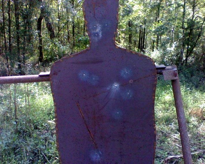

Well, it begins to look like we have a winner.
The first type of rings mentioned in the last prior post were put through the sighting-in process yesterday. First at 9 yards, then 75 yards, and finally at 200yd, all distances verified with a laser rangefinder. A 75yd zero renders a POI 1 foot high at 200yd.
Once sighted-in, the rifle was fired with 25 rounds of 88/71 spamcan light ball military surplus to determine its dispersion at 200yd. Firing was performed from a bench with a standard rear bag placed under the rifle's forend. No effort was made to correct for wind, which was variable at 9:00 O'clock ranging from imperceptible to approximately 15mph.
The dispersion pattern was diagonal, low left to high right, with about 3 inches of vertical and about 6 inches of horizontal. I would consider its accuracy acceptable for a Soviet WWII Sniper rifle being fed military surplus light ball.
More importantly, the rings were rock solid, demonstrating zero evidence of displacement after a shooting session employing 50 rounds. So far, no evidence exists to suggest the recoil screw/lug needs to have any anchor hole drilled in the barrel dovetail (yet).
While less than stellar, the rifle's accuracy would appear to represent a stable platform upon which to do more dedicated load development. This will be done with three separate goals in mind. The first would be to see if the existing 88/71 light ball cartridges' components can be redeveloped with a more accurate charge. The second would be to see if the primed steel cases can be combined with 123gr-125gr projectiles extracted from 7.62x39 TulAmmo steelcase ball/hollow point and modern propellants as a reduced recoil load for my 110lb Granddaughter to shoot. The third would be to find a serious accuracy/hunting load using PPU brass, Hornady '303' caliber 150gr SP Interlocks, good primers, and IMR-4064.

Reregistering the 200yd zero after swapping the scopes/mounts and rebuilding the cheek support turned out to be a lengthy and tedious project. Things turned out to be (probably) very sensitive to parallax with the longer eye relief involved, even with the laser boresighting. But it's done. '188' Spamcan ammo zeroed at 200yd crosses the line of sight at around 70yd, arcs up to about 3"-4" high at 100yd, and drops back down onto the POA at 200yd. The preliminary 200yd group shooting registers at or just under 2MOA. The proper (for me) cheek support height comes out to just about 1" above the comb.

Another Tuesday with my Buddy Doc on the range. I gave him my rifle to shoot, so he can try the cheek rest setup I'm using. His vision issues make things like this extra slow and complex to resolve. He likes it but still feels he needs a considerably higher weld than mine. He also feels my rifle is a better shooter than his. It may be at that, I can't shoot his with the higher weld his cheek rest provides.
I opened up a new spamcan, this time with plant #60 ammo from 1980. Very nice, clean looking ammo, it lacks the silver tip, but is otherwise still 147(-ish)gr Light Ball Russian Surplus. Breaking one down, the charge comes out to precisely 49.1gr, exactly as per published spec. It shoots to the same POI as the plant #188 , but has a round group pattern as opposed to a more vertical string of the 188. Still does about 2MOA. Only fired five of each at 100yd, so this is not statistically relevant.
I also built up 20 rounds of 'managed recoil' loads using 125-ishgr bullets from PMC x39 ammo and 40gr of the TulAmmo source ammo. The bullets are .308 and did not seat firmly in the TulAmmo necks. The first round struck smack in the middle of the 100yd group from the 147gr Surplus, The second round collapsed into the case during feeding and was unusable, the third round was hand chambered and went 'click' when the sear fell. The primer had ignited, but the powder only burned a little of the way; so I now have a bullet stuck in the bore and a mess of unburned powder strewn in the bore and action. I will be addressing that later today.
So much for Tuesday.
