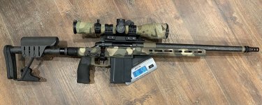

My 7 SAUM build is finished & I’ll finally have time for load development this weekend.
  • Lone Peak Fuzion Mid length action
  • XLR Element 4.0 Magnesium chassis
  • Bartlein 26” 1-8 CF barrel
  • TriggerTech Diamond
  • APA Gen III Fat bastard brake (may also experiment w/ my TBAC Dominus)
  • Leica PRS w/ PRB reticle, in Spuhr mount. (I’ll probably just run this for the NF ELR event in June, and use a lighter optic for hunting)
  • Ckye-Pod
I’ve got a pretty good pile of Berger 190gr LRHTs & 183gr SMKs. I expect to run those over RL26, but I also have quite a bit of H-4831. Biggest issue I’ve had is brass, but I’ve managed to source 100 pieces of ADG, 100 Norma, & 100 R-P.
So here’s my question: Out of curiosity, what are you guys using for seating depth with the 190gr Bergers & the 183gr SMK’s. Knowing I was wanting to shoot the heavier bullets, my smith baked in a pretty good amount of freebore. I believe I’ll still be jumping the 190s at least .150 if they are just barely inside max coal for these MDT mid length mags.
Thoughts? Suggestions?

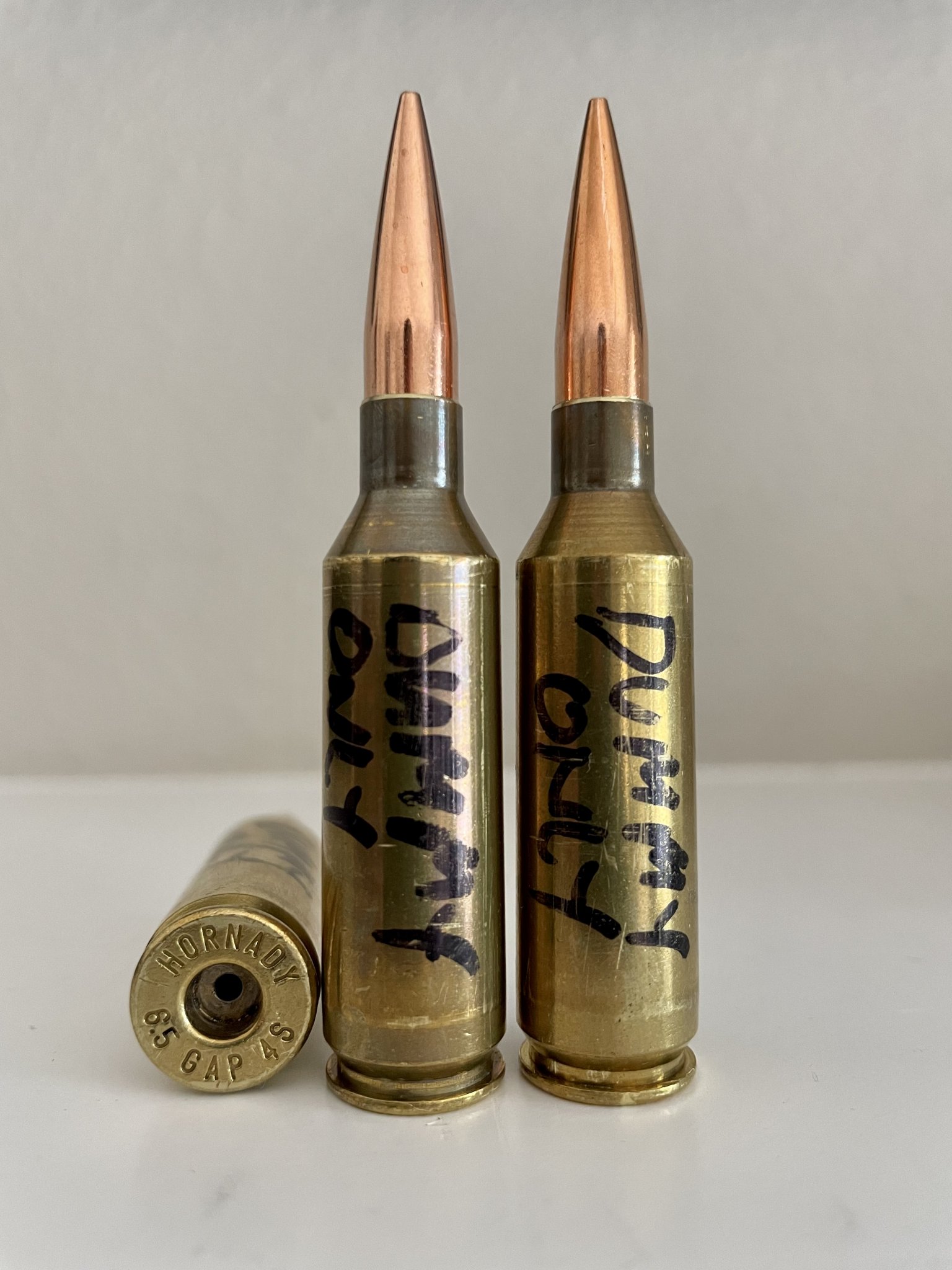

Hit the range for about an hour to check speeds with 168 ABLR and H4831SC and IMR7977.
Gun: M70, 26” 1/8 Brux #5, Sandman-S, round count: 117
Conditions: 09 Jun 22, 54* pissing rain, 100 yd, sea level (ish)
Hdy 1x converted from 6.5 Gap 4S
WLRM
168 ABLR
2.950 .025 jump
1 rd per charge just for baseline

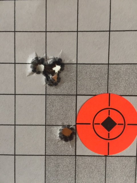

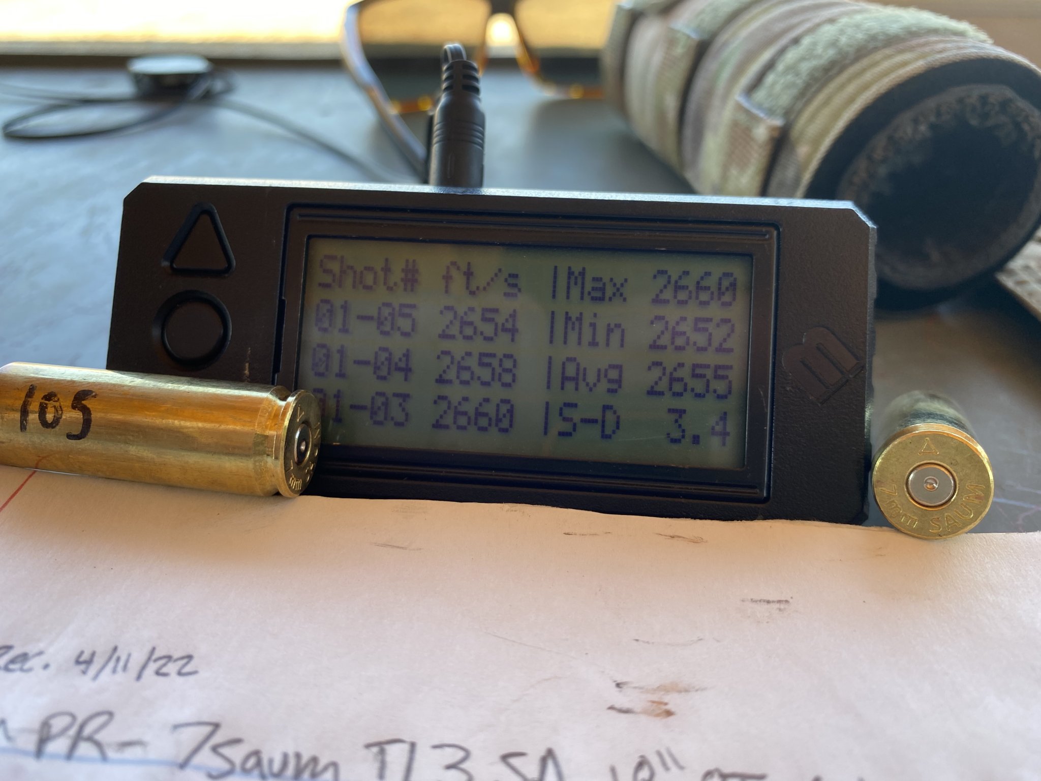

Let‘s find out what this short barrel 7 saum is all about… 18incher… . Loaded 180hyb./H4350 to 57.5gn to start… Hope to get them to 2700 fps…
Update on my 18 inch Saum… 60 rounds down the pipe with 180 hyb/55.8gn H4350/210M/V.Brass. 105 Thou off seated deep into the case. Very short action magazine compatible. Averaging low 2680s now and with very windy conditions the other evening it was very very consistent at 1100 yards.
Right on. If memory serves I think I had 180 hybrids about 100 thou jump also shooting real well in a 26" barrel from a TL3 and mag fed.
