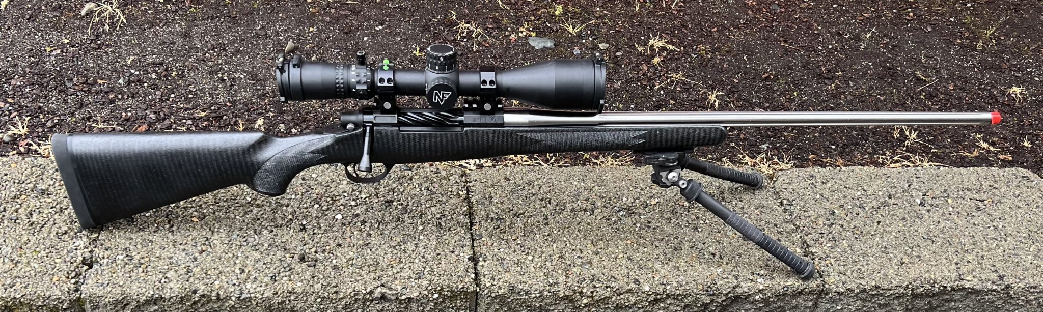

Have more details/pics of the rifle? Would love to see a hunting stick with all up weight in that area. The little bit I've played with rl26, it’s awesome but can mask pressure signs. I’ve had great experience with the saum and rl23 if you can find it. It was a more accurate powder in my rifle, running same speeds (targeting 2950ish with 180’s) for 2 grains less. You'll get more all out speed from rl26 though.
Manners UC Plus stock, Hawkins bdl metal, Bix trigger, Hawkins rings and Seekins bipod rail. 9# even with the Atlas on board.
Barrel is soon to be coated black as soon as the brake gets here hence the rubber cap on the muzzle threads
