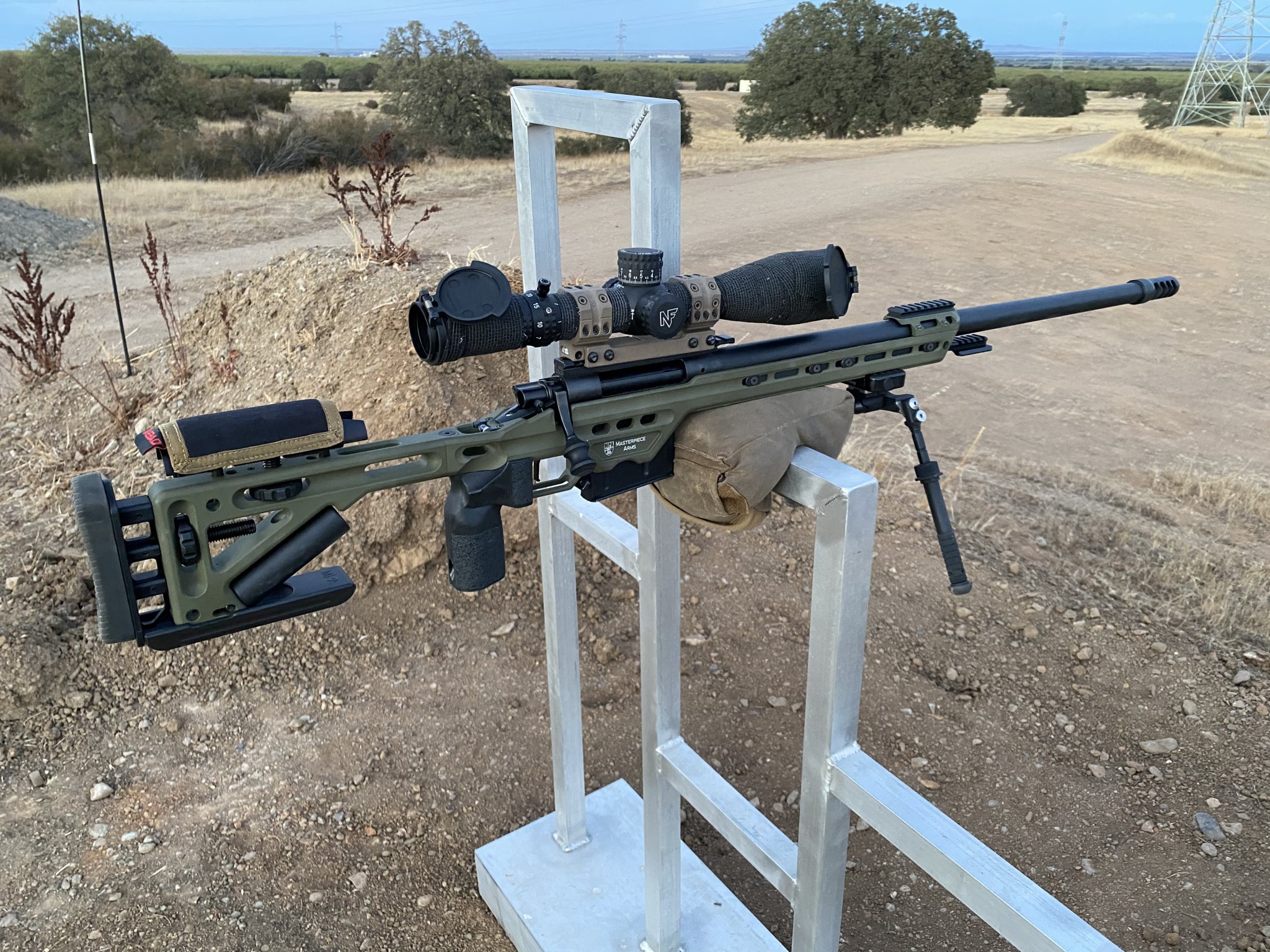

KRG Bravo with Atlas CAL. Nightforce NX8
Curtis Axiom. Accurate Mag. 100 yards. A GREAT day to be at the range. 70 degrees, no wind.

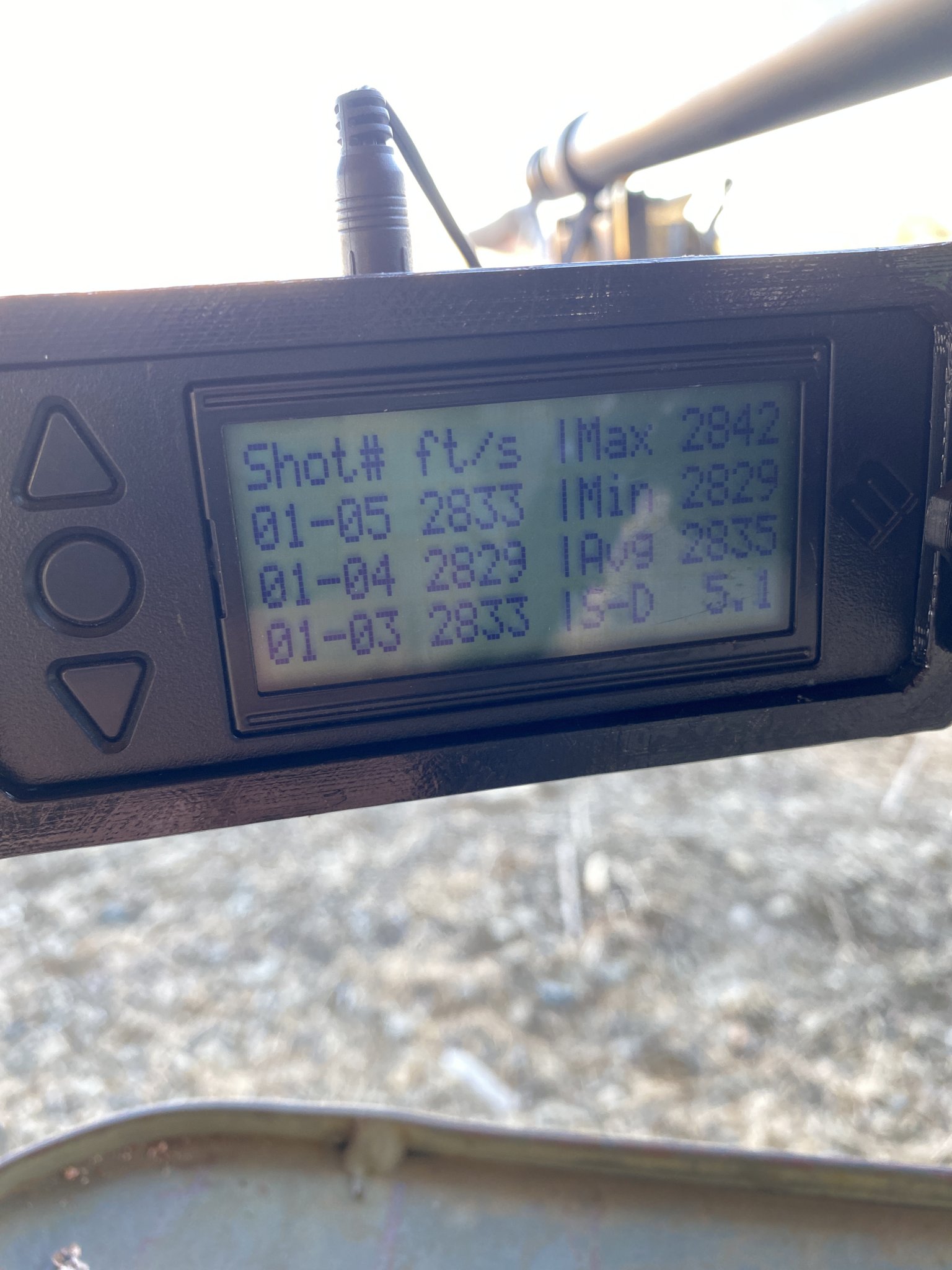

We started at 364 yards and the Magnetospeed.
24" PVA barrel - Curtis Axiom - KRG Bravo - NF NX8 - Gunwerks Brass - RL26 - 59.0gr - CCI Mag LRP - 162gr ELDX - CBTO 2.270
2835 - 2777 - 2815 - 2787 - 2830 - 2830 - 2841.
