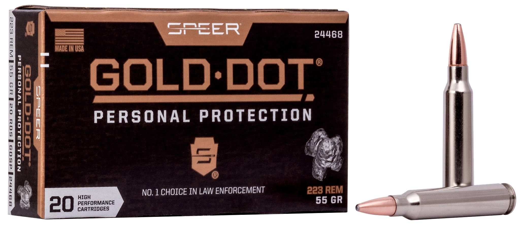

Well, I was gonna load 62gr gold dots as a defense round and thier cheaper since I can get 55gr bulk ammo and both shoot poi closely.
But I'm no wondering if some of the 69 75 or 77 gr surplus stuff would be better suited for both uses?
Can anyone chime in on the performance of the higher gr bulk/surplus ammo.

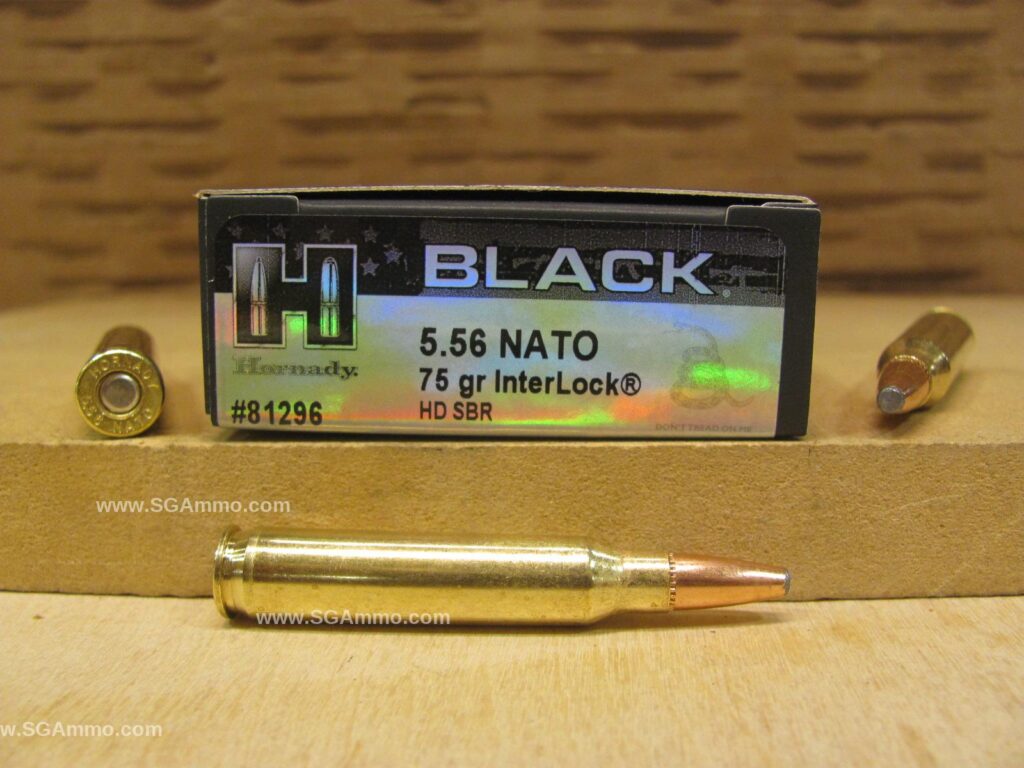

The current hot flavor of the month is the 77 OTMs and SMKs for defensive rounds. Some report the Hornady 75 BTHP does well too.

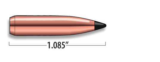

Basically, 62-64 grain bonded "type" bullets, such as Nosler Bonded, or Bear Claw, or etc are better through "barriers" and 77 grains are better at "everything" else. But this is the deciding factor to help close the issue.
77 grain OTM Berger's, etc, are literally HALF the group size as any bonded 62-64 grain, which is not a match bullet. HALF is conservative, its probably more like .5-.7 group for 77 match out of good barrel, and for same barrel using Bonded, you will be lucky to get 1.5" consistently, which is good and fine for what it is.

OMG if you can get 62 grain gold dots at a price you are happy with just use those, excellant choice. Just so happens one of my go to 50 caliber ammo cans has 900 of them in them loaded up and ready to roll.

The 75 gr Hornady can be had for .16 per. It has a canelure version that should increase its terminal ballistics. Hornady is best bang for buck in just about anything now. Yeah Bergers are a superior product. Hornady is not terrible. Not terrible at all. Sierra and Nosler are awful proud of their copper and lead now. Im the world most terrible investor. Thats saying somthing because the last two decades all you had to do is pick any market fund. Lead and copper has treated me well however. I have never regretted a investment in lead and copper. Not once, Its a pretty liquid investment also. They say "buy it cheap and stack it deep". Whats cheap? Its just about always cheap over time. Dont go crazy go into debt but if you have a shooting hobby when you got some cash pick up some projectiles. I like how Hornady offers bulk. If I was buying now it would be that 75. Hornady for rifle projectiles Zero for handgun projectiles. Hey life is tough in the hillbilly ghetto. :)
https://ammoseek.com/reloading/bullets/.224-diameter/Hornady-75grains?ikw=match
