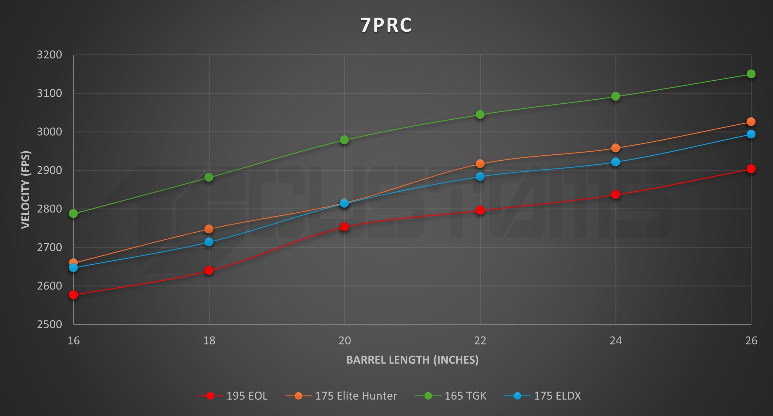

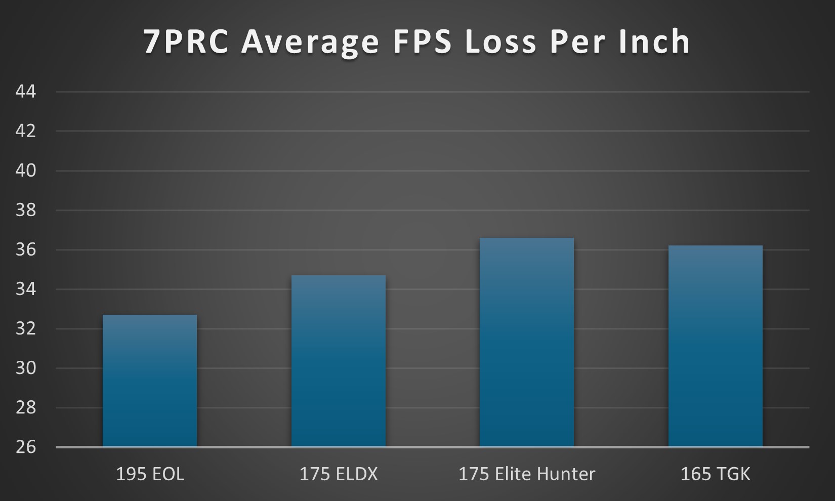

Anyone who is looking for the speed you’re mentioning is doing it already, like with a 7-300prc for example. No need to experiment or make your own die’s, all available and tested by shooter’s that don’t load for the excessive dangerous pressure you’re chasing.
We were discussing the 7 PRC as under performing in velocity.
The 300 -7 mm PRC or other larger case would be one answer to the problem, which some shooters should consider.

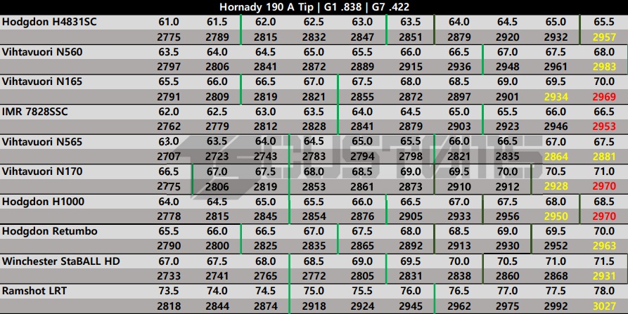

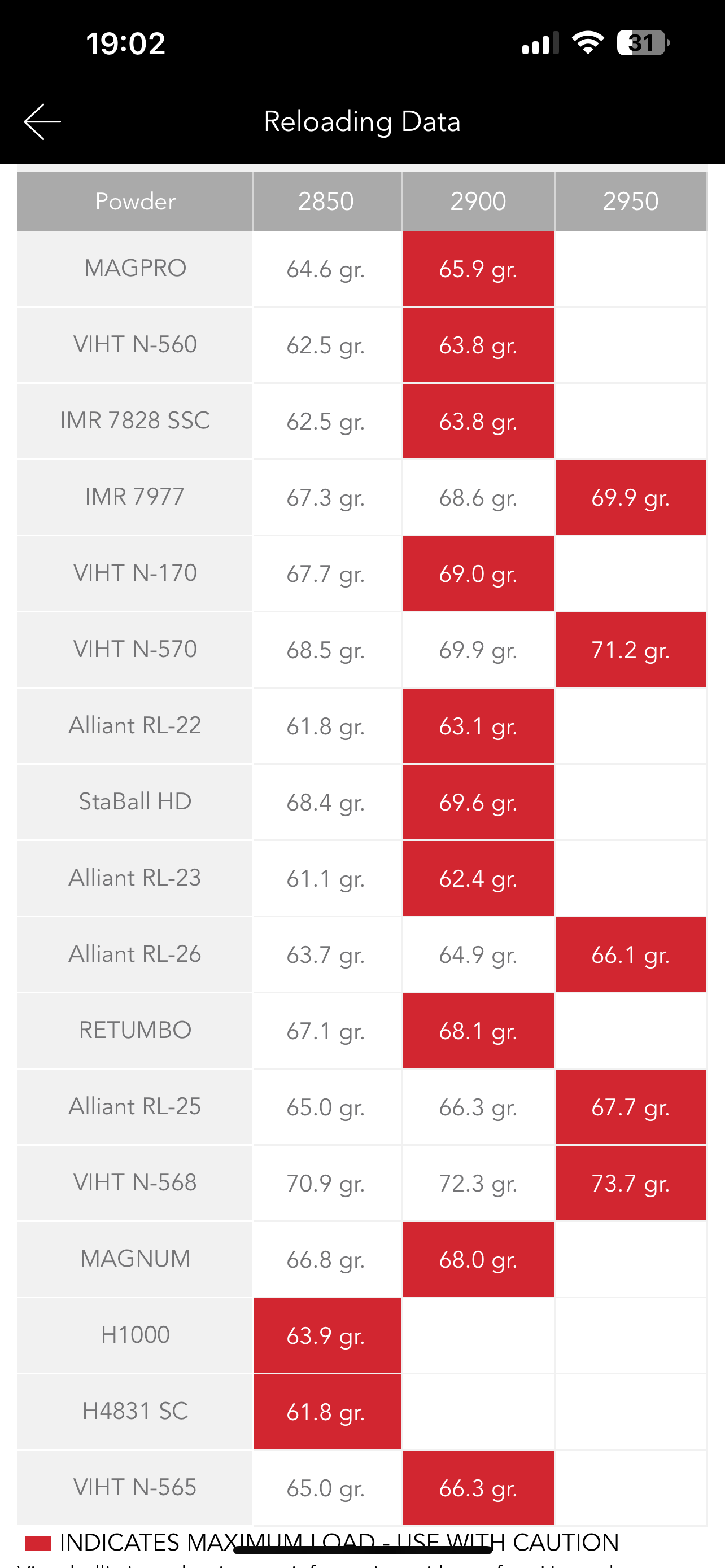

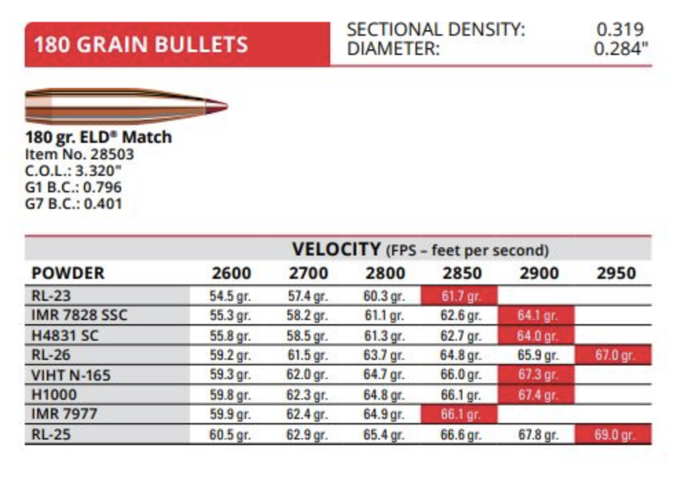

I happen to look at the HODGDON website today and they are also listing the Max H1000 load with a 180 at 64 grains, with a state of pressure of 62,500 or so which is still below the max rated for the cartridge depending upon where you look
My own loads in two different guns are not getting pressure signs at 67.5 grains with a 180 loaded to 3.320 in Horty brass. The one good thing about using that brass is you know it will give up earlier so when I switched to LA PUA later this fall hopefullyI should be in good territory
