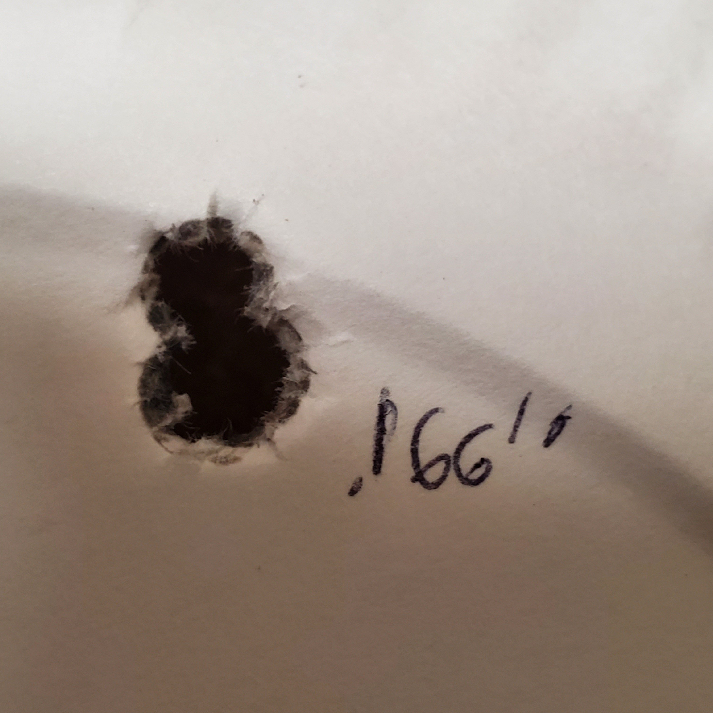

New 6 lb 20" 7mm BC rifle with 170 gr terminal acent 3104 fps ammo .166" group factory ammo, first group shot with this ammo.
Same gun with factory 175 gr fusion tipped 3040 fps turning in several 1/4" 3 shot groups 93° today.
No issues.
The 7mm BC is the real deal. Especially for hunters who do not reload and want a light short rifle with exceptional ballistics...I intend to reload for the 7mm BC.

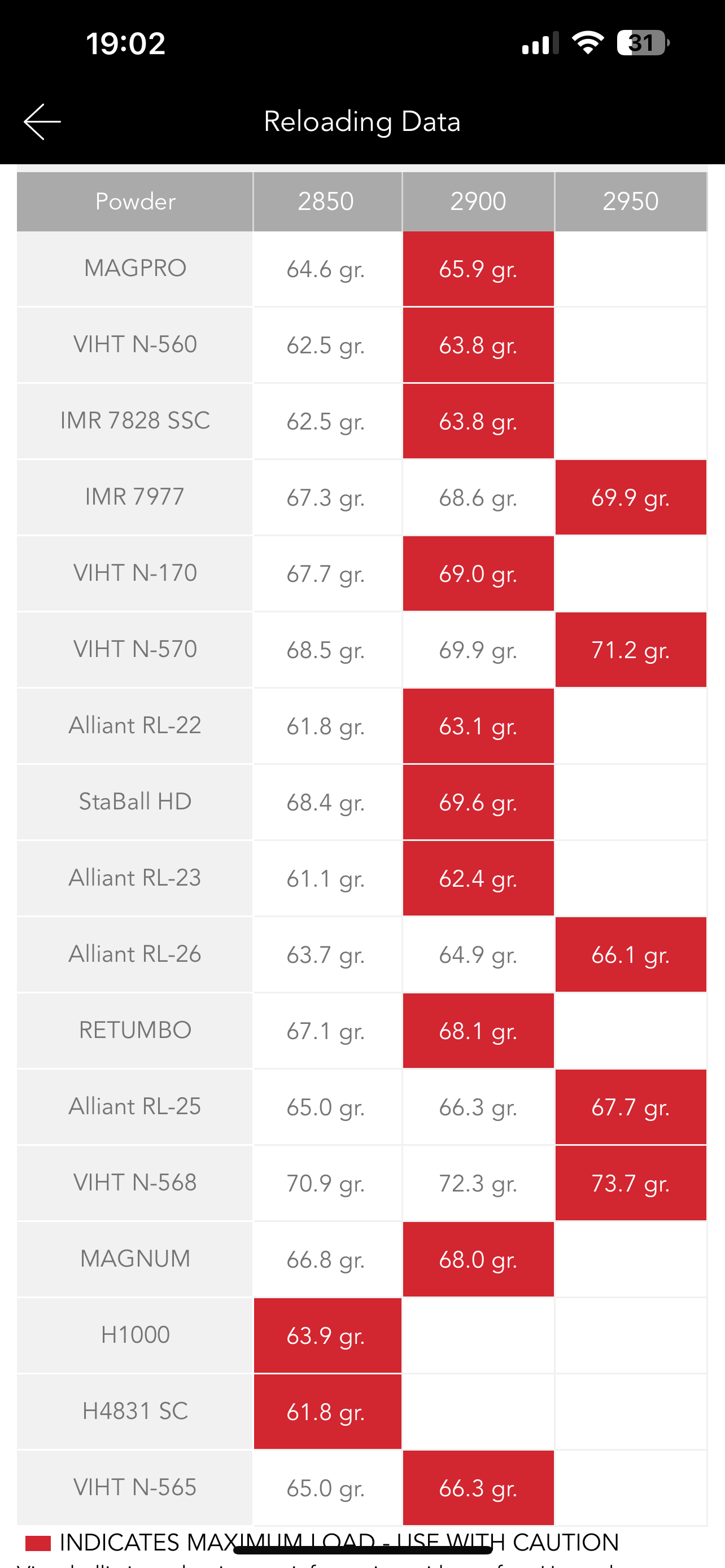

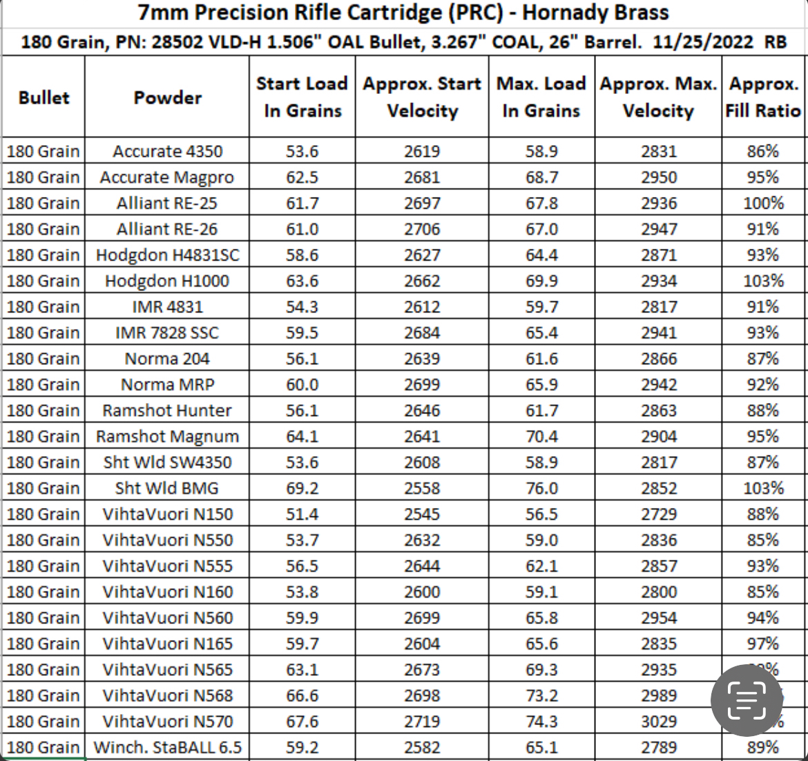

Am I hallucinating or did horny massively reduce their reloading book Max loads? I swear to God the max load for a 180 grain which is what this picture represents was 67.4 grains of H1000 and look at it now

I don’t think so. The 7prc has always had suoer odd book numbers. My first outing was at the hodgdon book max at the time like 64 grains or so but shot 200fps slower than expected. Then I remember looking at Hornady and seeing the same equivalent.
Took a bit of looking around to see everyone was at 67-68 grains of h1000 to achieve the advertised speed of about 3k.
I’ve never seen pressure at these loads but have always wondered what the discrepancy was
Most load data is shot out of 24" test barrels, which were tighter dimensioned then production barrels used by the public in most cases.
They drop the charge weight in manuals cause sometimes you blow primers at max load.
One reason is because the powder burn rate in the new lot varies enough to cause trouble, but still is considered passed as it falls between the fence post pressure variation allowance...but needs a drop in charge weight to reach the average max pressure in the test barrel...so the civilians don't blow primers.

I’m talking about how I am almost positive that the Max published loaded data are falling three gr short in the last six months

Yes I believe they reduced the charges recently as well. I have their reloading data on the app and noticed a change randomly. Someone mentioned that there may have been a change in formulation of certain powders and they reduced stuff across the board to ahead of possible issues with their data.
Im shooting 180gr hybrids with H4831sc and the previous max had been 64.5gr I believe and now it is well below that.
Nothing new. They did the same thing to the 7rem mag. Early reloading data showed higher charge weights compared to recent publishings.
Whether its hype to help sell the newest wiz bang cartridge, or lot variations coming into play, it happens.

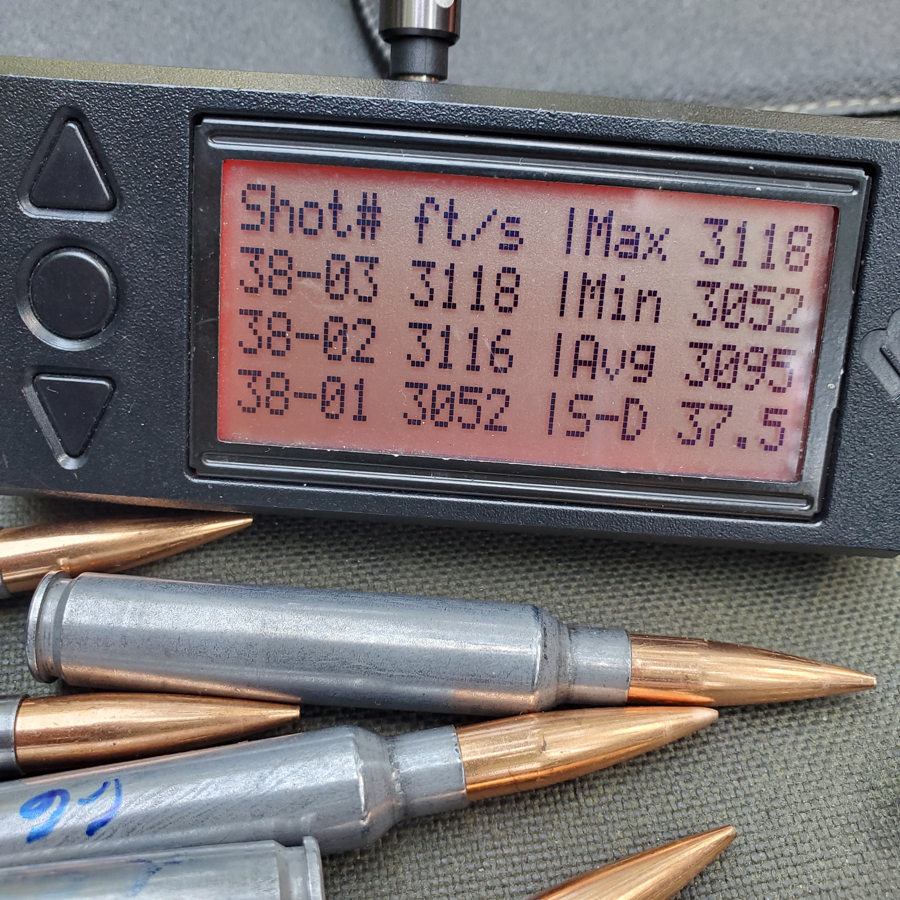

Had some 7 mm 180 gr Berger bullets left over from the old 7mm mag days.
Shot reloads in the 7 mm BC today.
Top velocity in a 20" barrel was 3118 fps for the 180 gr Berger.
Felt one load with a slightly stuff bolt... and will consider 3075 fps max for this powder.
But 3050 fps is easily attained with 180 gr Berger with possibilities of excellent hunting accuracy in the 3050 to 3075 fps area.

With velocities and load data posted for the 180 gr Berger first up and got to 3100 fps in the 20" barrel....3050 fps is a good load for this powder and the 180 gr Berger, bullet holes touching.
Run your ballistics calculator on the 180 gr Berger at 3118 at 2000 ft elevation and 93° impressive for a 6 lb rifle and a 20" barrel.
I will not baby this 7mm BC, I'm shooting the piss out of it.
At 93° I shot a 12 shot string with no barrel cooling, just one shot after another... to see what it does, no heavy bolt lift, easy extraction, on a hot barrel, on a hot day.
