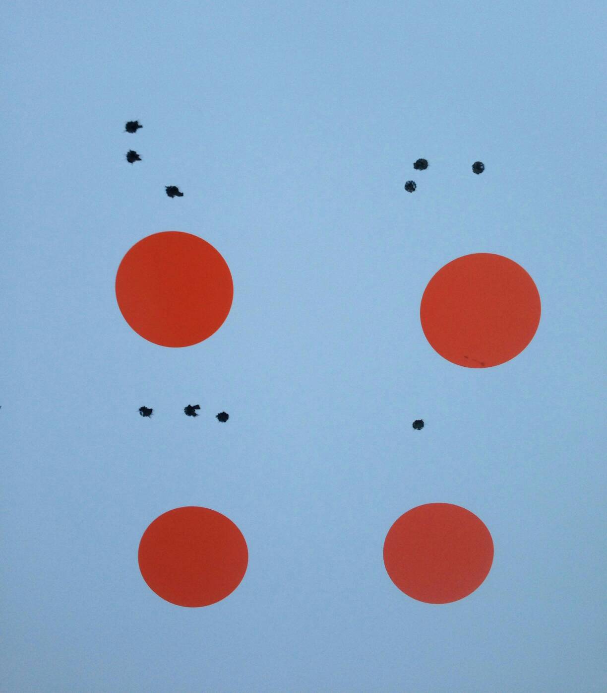

I love the 7RM, Im not running mine very hot at the moment but here is 3 groups at 500, the dots are 3". 180gr berger vld hunters.
Sent from my Nexus 7 using Tapatalk
