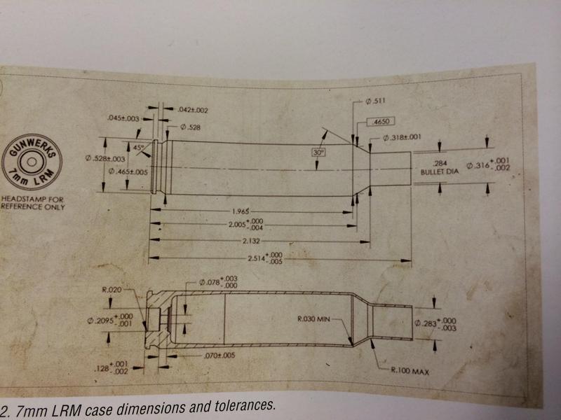

Already exists, and has existed for quite a while. Hornady has been making brass for it for several years.
It's called the 7mmLRM.
7mm LRM (Long Action) and 7mm PRC (Short Action) would not be the same.

Dave, will the 300 PRC need to be ran from a CIP length mag w Hornady factory ammo?
The 7mm LRM is actually a bit shorter than the .300 PRC. They are both LA cartridges.
My assumption was that the 300/6.5 PRC were the same but not according to the specs I saw. I was looking at the 6.5 PRC. So is the LRM and 300 PRC long action? and the 6.5 PRC short action?
7 LRM - COAL 2.514"
6.5 PRC COAL 2.030"
300 PRC - COAL 2.580"

Don't let the numbers confuse you.
Those lengths are the case length not the COAL.
The COAL includes a seated bullet.
But yes, the 6.5 is, ostensibly a short action cartridges, it is, more or less, a SAAMI version of the 6.5 short action magnum.
The 7 and .300 are long action cartridges.
