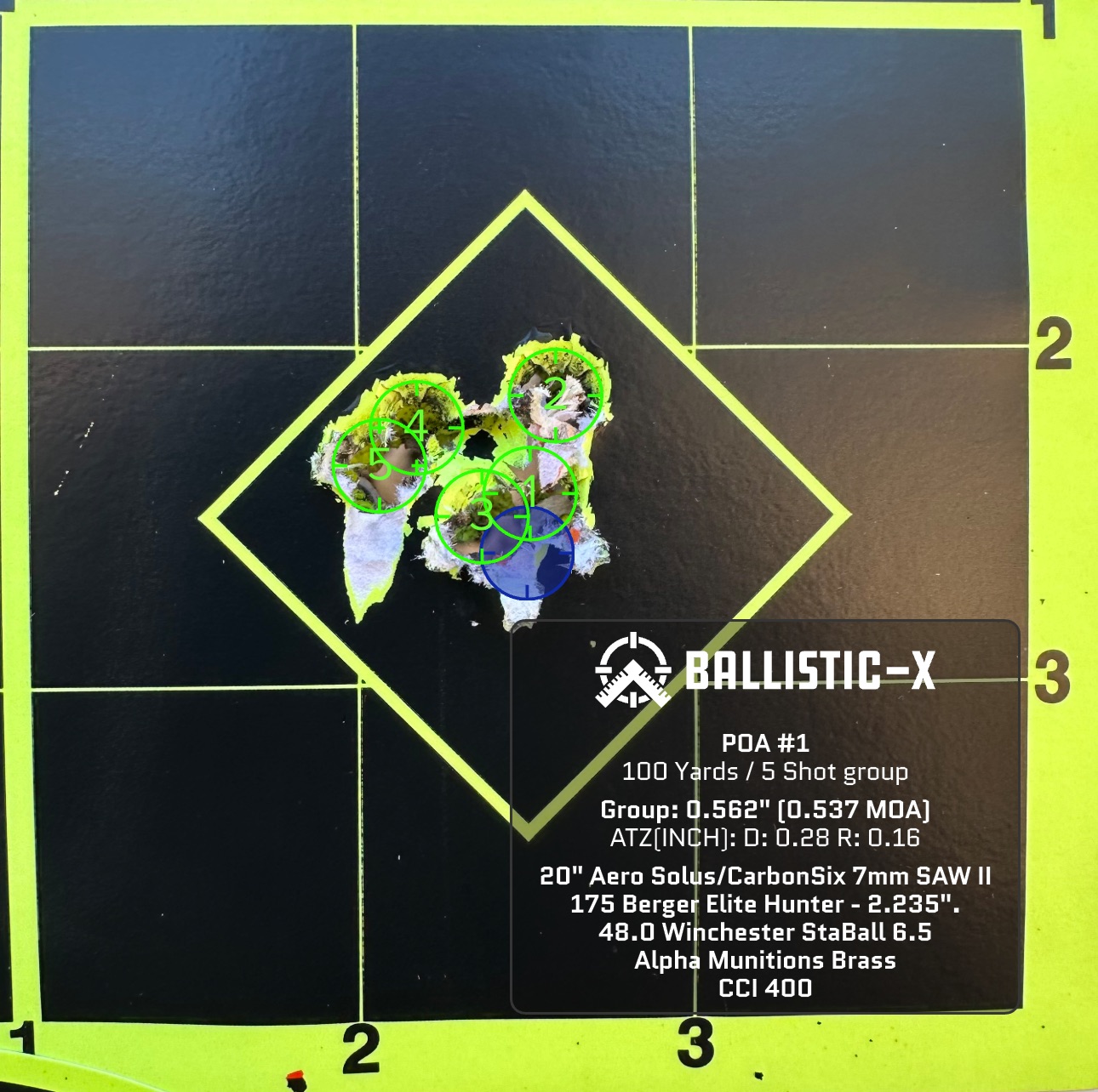

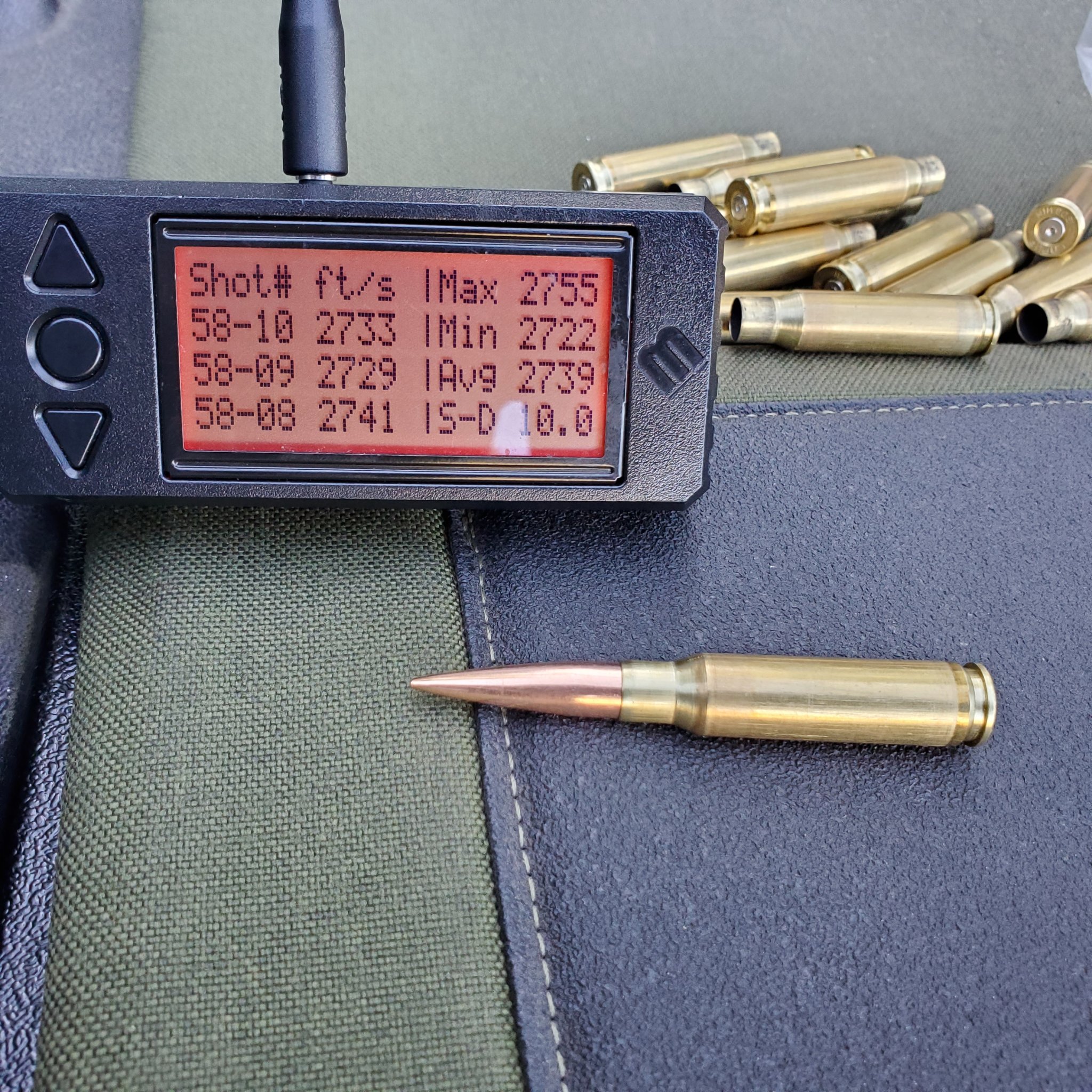

Just loaded up 100 of my 175 Berger Elite Hunters in some 2x fired Alpha SRP brass. Running CCI 400's and 48.0gr of StaBall 6.5. It's what shot the best in my my Saw II barrel that CarbonSix had to send me. During load development it shot a 0.562" 5-shot group, which is exponentially better than the last barrel that wouldn't even dip below 1 MOA, so we'll see if she gets better as it finishes breaking-in. Barrel only has 50 rounds down it so far. It seems to have stabilized for the most part with ES/SD numbers, but does occasionally have a fast shot, so we'll see.
Here was the best group last session... This load is moving along at 2,748 FPS MV from a 20" barrel, and had a 20 FPS ES, and 7.7 SD.
Reactions: HMRamateur

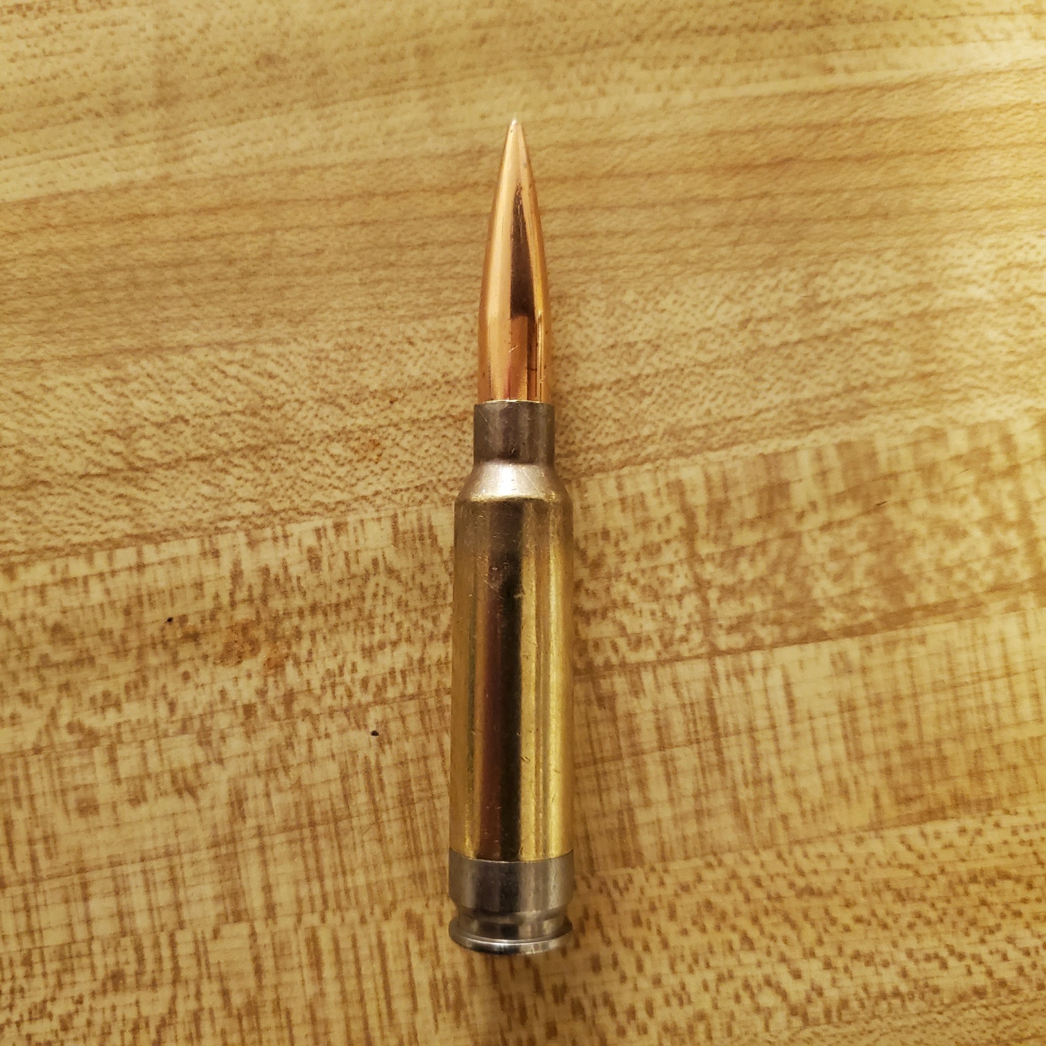

Why would you do a 7mm SAW when you can run a 7 mm Fury hybrid case and really get some velocity improvements...with up to 80,000 psi on tap.
Here is a 180 gr Berger in a 6.8X 51 hybrid case. More capacity and much higher pressures than the 7 SAW so one can really achieve those magnum velocities in reality... if ya want.
All ya need is the reamer.
Or your standard fast twist 7mm-08 with hybrid cases and your factory dies will smoke the 7 SAW in velocity...change nothing but the cases.

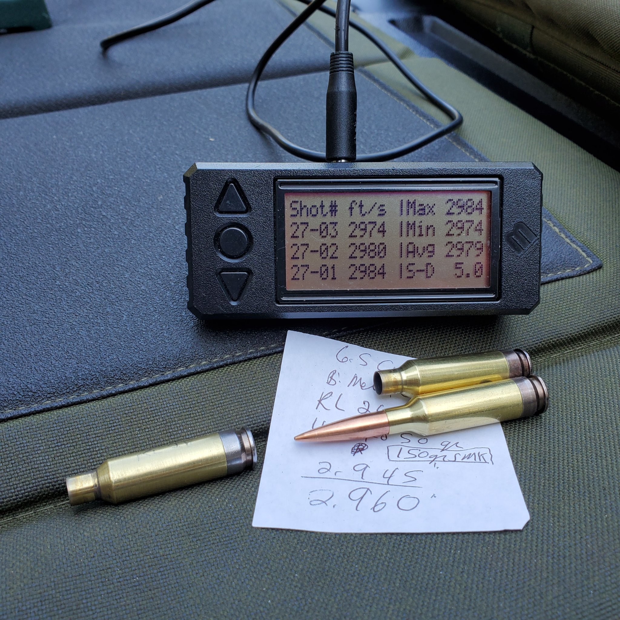

Like 6.5 CM 150 gr SMK at 3000 fps, or 140 gr at 3100 fps in a factory chambered rifle with your dies...nothing to change but going to the hybrid case...works on 7mm-08 too.
Just another concept to consider with no changes to your existing factory chamber, or dies.

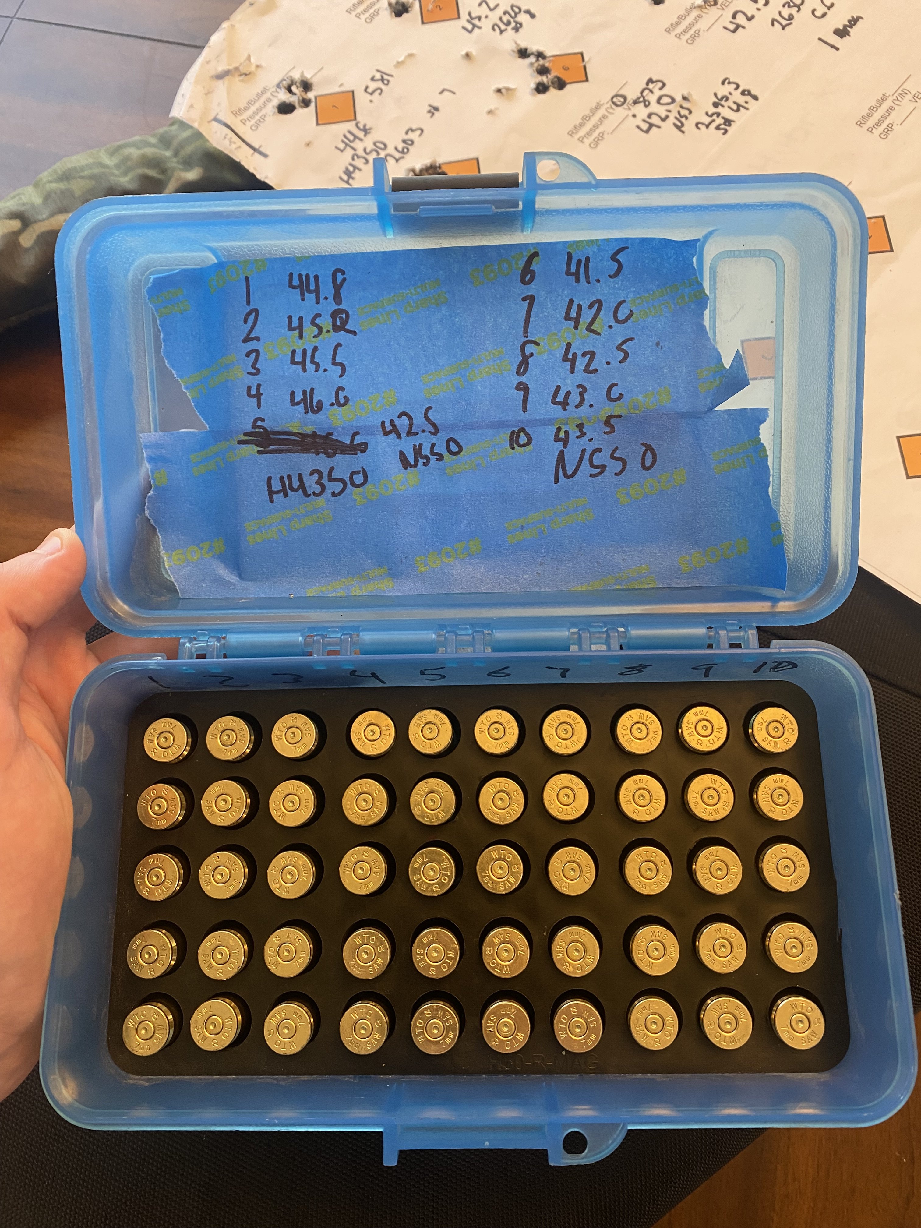

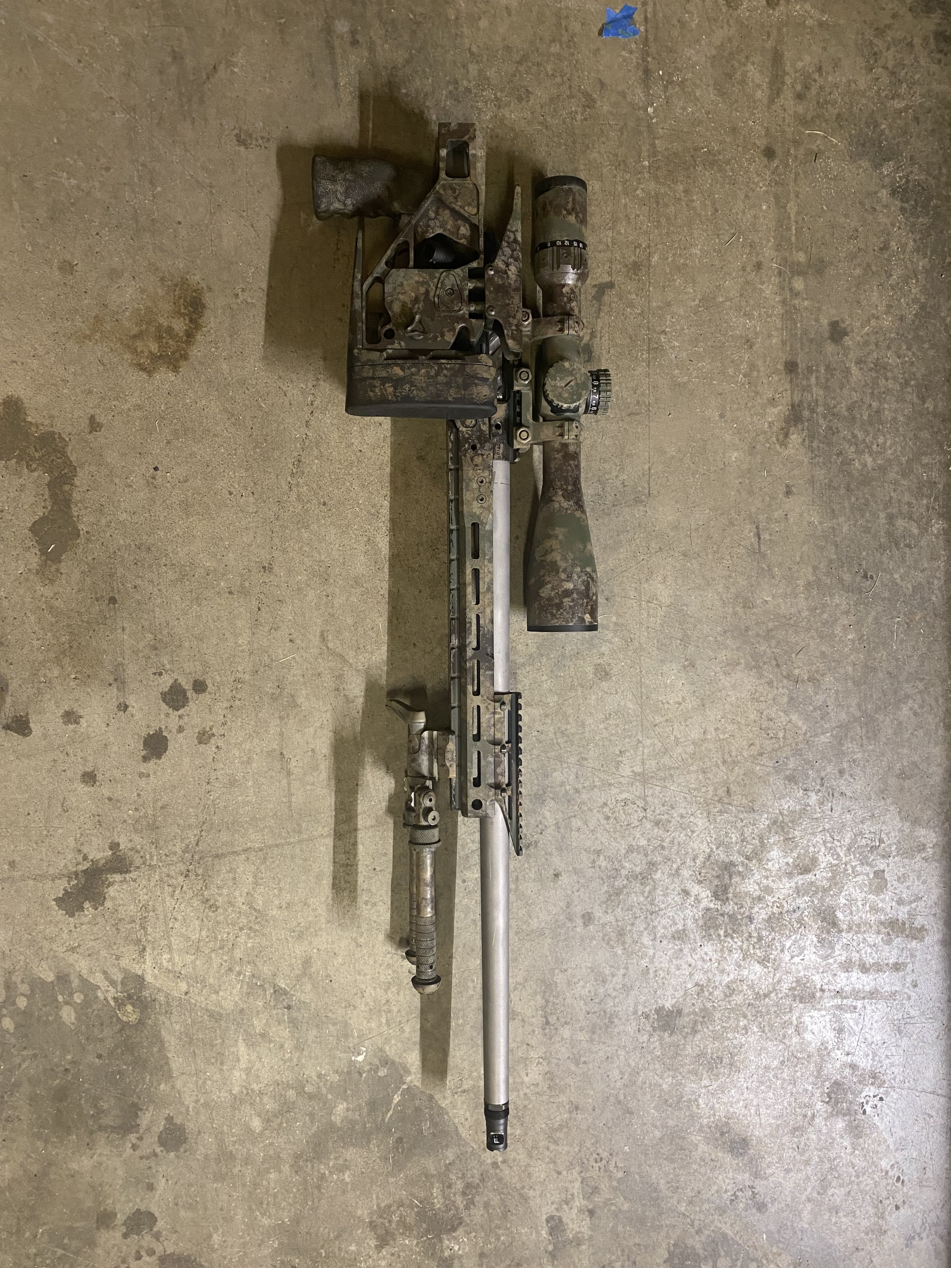

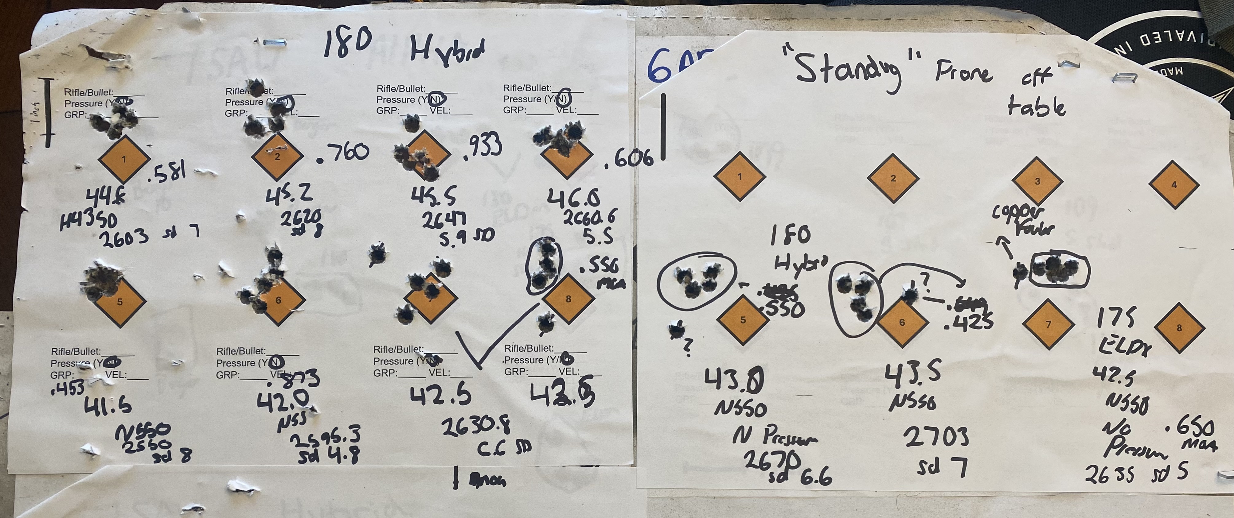

Tested H4350 and N550, rem 7 1/2 primers alpha brass. I have to shoot off a table standing where I shoot at 100 yards so I am counting those fliers as me not following through and I caught myself not checking my level and not executing the fundamentals properly. Loaded up 30 of those ELDX and took them out to 1100 yards no problem, 20mph wind today and I had no issues connecting on a 2/3 IPSC every time. I’m a believer in the 7SAW.
No heavy bolt lift or anything but the Seekins PH3 has dual ejectors and they seem to be snake biting regardless of charge on every cartridge I have (quick change barrel. I have 308, 6.5 and the 7 SAW). Also this happened over the course of about 18 minutes today, it was 98 degrees out. Straight jacket armory PH3 pre fit, SAW II reamer.
