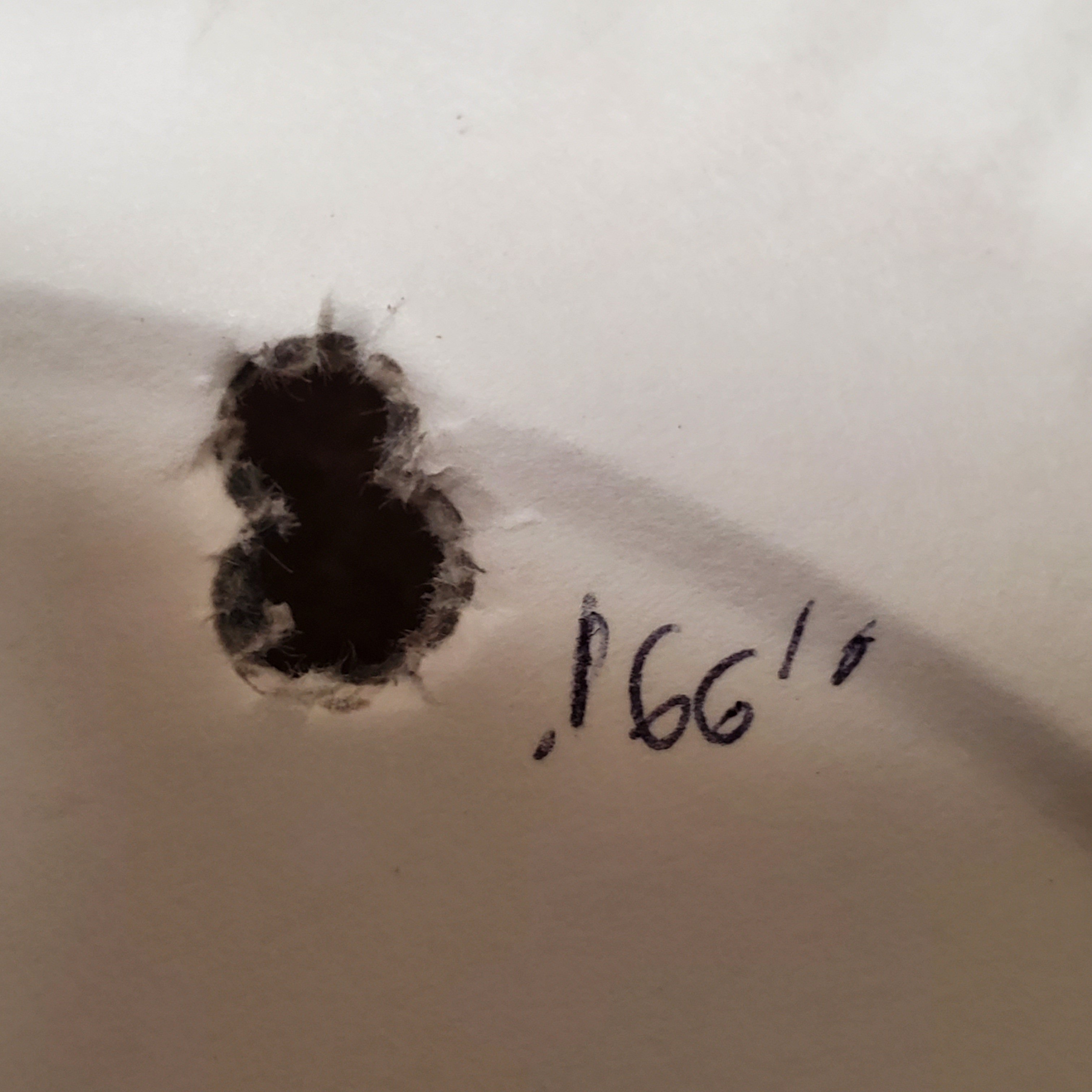

New rifle, 6 lb 7mm BC, 20" barrel shooting Federal factory ammo 170 gr terminal acent 3104 fps .166" group, no cleaning, no barrel break-in and this group shot after a box of 175 gr, the barrel still hot.
And the 175 gr tipped fusion from Federal was shooting 3040 fps with several 3 shot groups 1/4" or less.
Shot 20 rds in a row no waiting for barrel to cool.
An excellent hunting choice IMO, ...short light, powerful and accurate for at least 3 shots...but hung in there for 12 fast rounds.

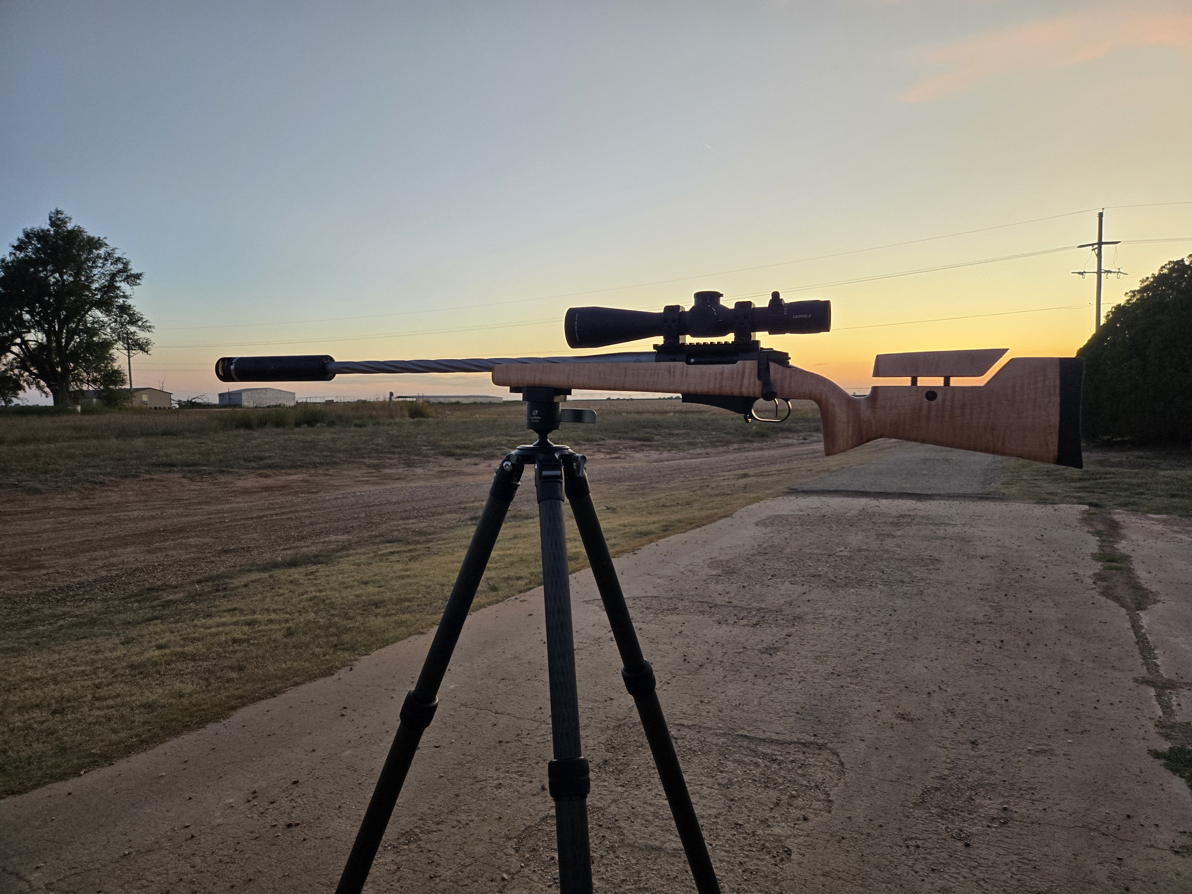

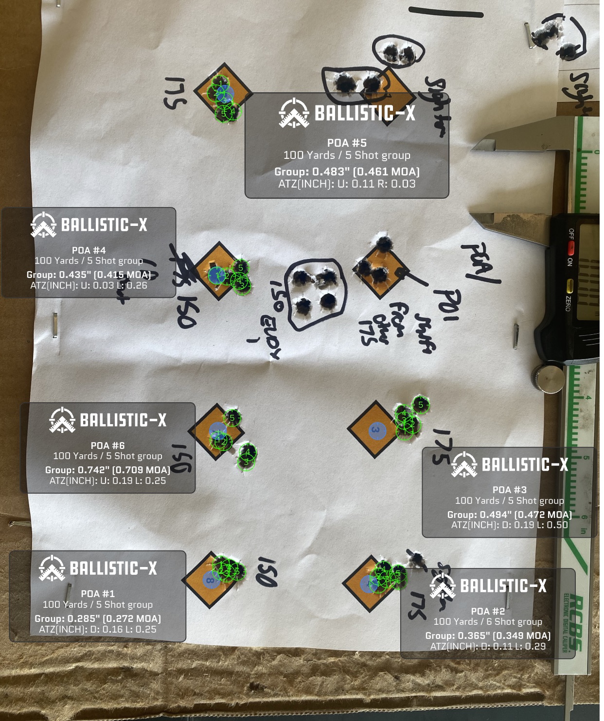

43.5 of N550 with rem 7 1/2 at 2.940 in alpha brass for the 175 ELDX, 43.5 of varget with CCI 250 at 2.900 in hybrid cases for the 150 ELDX, I could probably get away with 44-44.5 of varget but I also feel like that might upset the bullet, I’ve found with the hybrid cases once you get up high the bullets start to get upset and throw flyers.
150 ELDX was 2950 sd of 10.7 and the 175’s were 2750 sd 6.2 over 20 shots. Again shot standing off a table. Shooting out to 1200 today and they did very well l, very happy with this cartridge and the Straight Jacket barrel. Recoil impulse feels like my 6.5 barrel since I shoot both with a can.
Reactions: 806guns and st1650

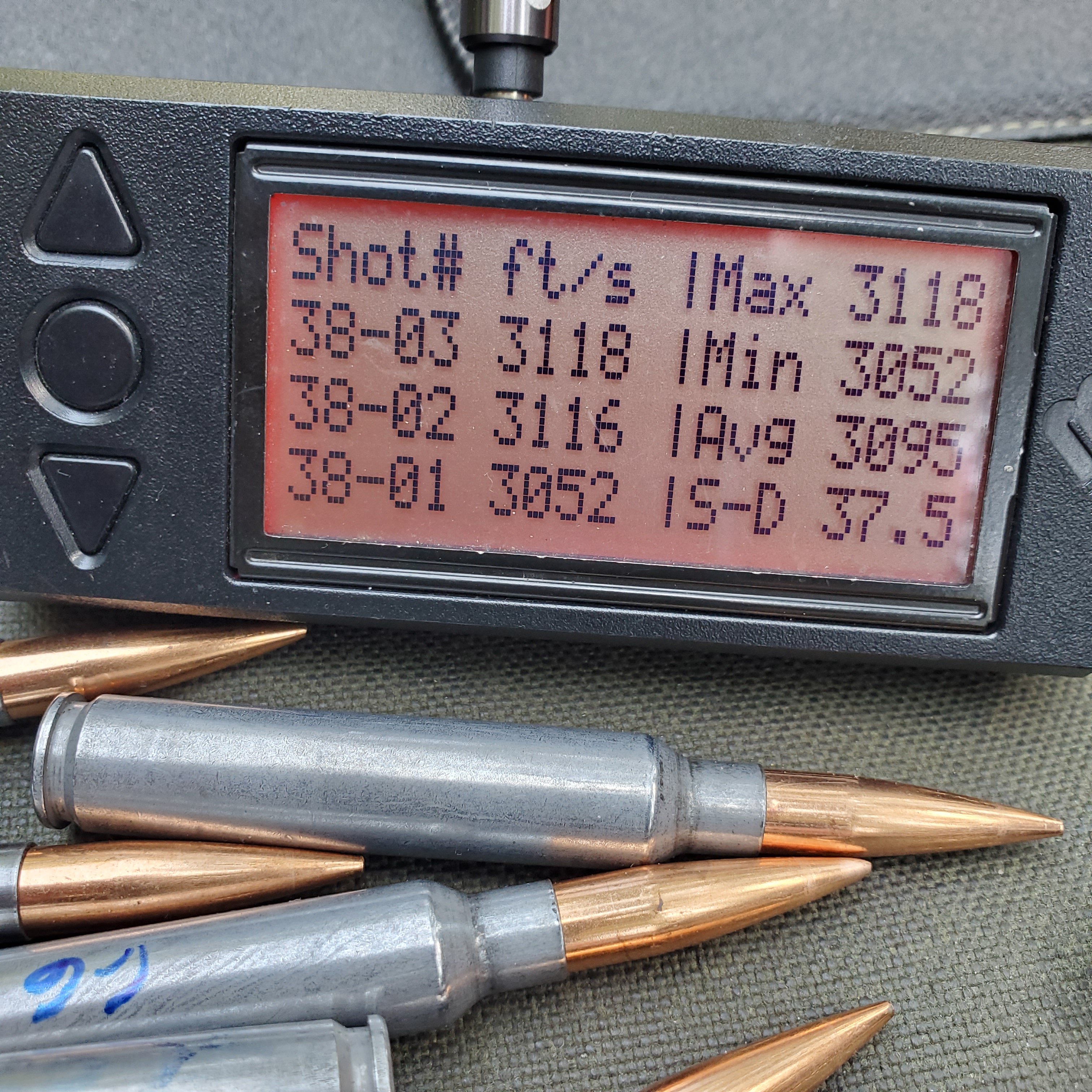

Reloading the 7mm BC 20" barrel 180 gr Berger max velocity was 3118 fps in 6 lb carbon fiber rifle. The good area for this powder is 3050 to 3075 fps area.
