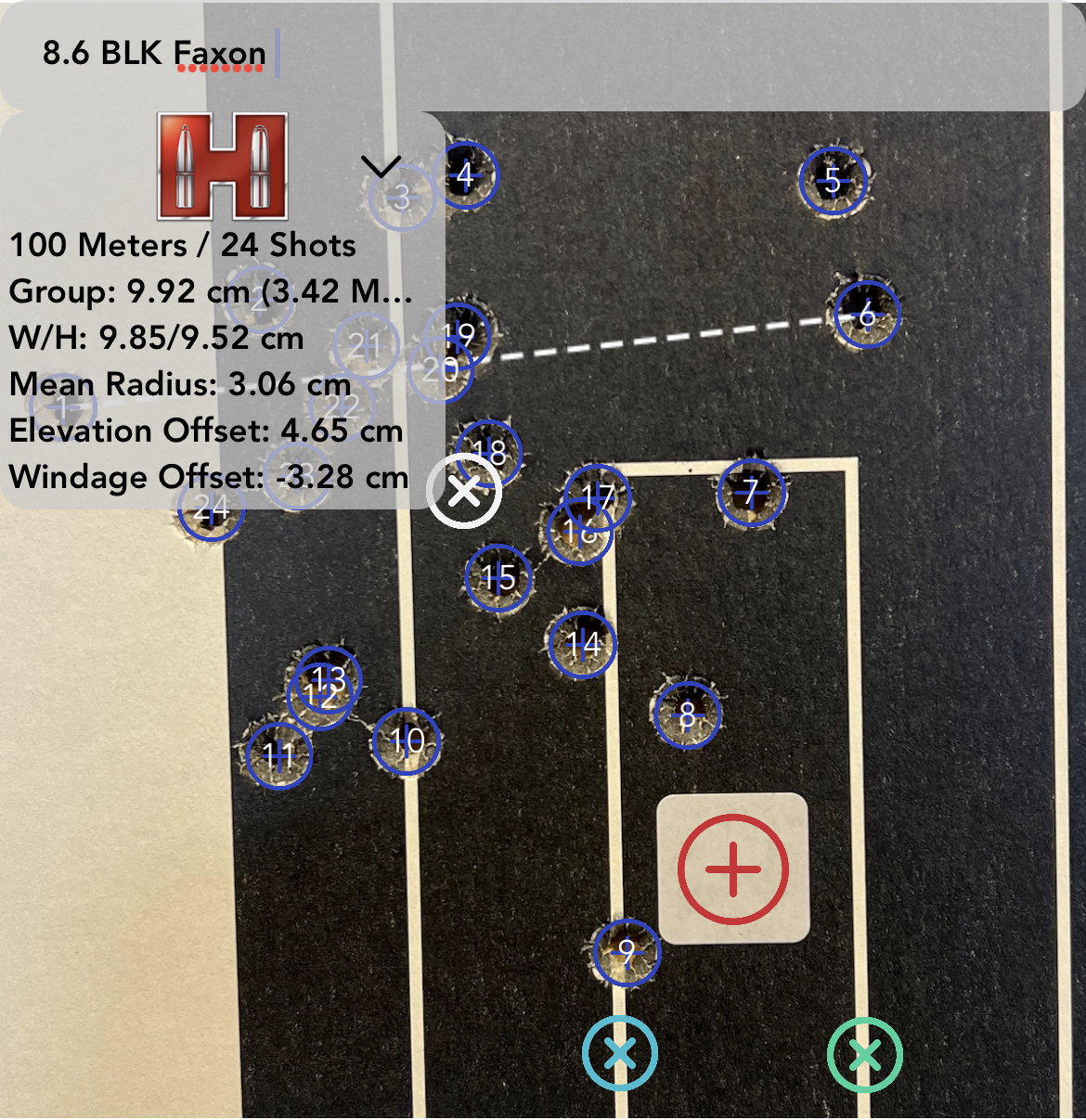

Yes, typical Faxon 3 twist, mine was maybe worse...chunks of metal were torn off the rifling. Appeared fuzzy looking down the bore, ran a patch through it, and it was brown with slivers and small pieces of metal from the bore...So I lapped it before I shot it.. it still had chunks of metal missing in the beginning by the chamber, but was better toward the muzzle.
It all sounds very familiar. There are parts of the barrel that looks even worse than in the pictures I posted.

Your first two pic's are damage to the rifling from when the button was pulled thru. Button rifling with these really fast twist I feel will always be an issue. Button rifling displaces the material it doesn't remove the material. Depending on the spec of the button and the material as it will always change they might be pulling a .341" to .342" button size for the groove down the barrel in order to end up with a .338" groove size. Like a snake swallowing a mouse. The steel will expand and spring back where we physically cut the grooves. Those edges of the lands is what we call tearing/tore. It could be a soft spot or a hard spot in the material and with that really fast twist and the conventional rifling it's tearing/breaking chunks out of the edges.
When we cut rifle the barrels we are only cutting like .0001" per pass. Basically shaving.
Also that hard edge of conventional rifling isn't going to help with the button process. That hard sharp edge is going to take a beating.
Your 3rd picture those are bore reamer marks (assuming they are reaming the bores before pulling the button thru as some shops/gun makers to save time and money will go from drilling the blank to just pulling a button thru but those look like bore reamer marks) on the lands and in the grooves. Again button rifling displaces material and the rougher that finish is from the bore reamer... the button is just going to push them down into the grooves as well.
Again the rougher bore/grooves like that and any damage to the edges of the lands.... means the bullets will take more of a beating/get damaged done to them and then the really fast twist rate isn't going to help anything at all either. Accuracy will suffer and bullets blowing up will be another.
That hard edge of conventional rifling will also leave a burr on the sides of the bullets. It will look like a flag sticking up on the side of the jacket. I've seen those burrs as big as a 1/32" of an inch and that will affect the bc of the bullet and affect the flight of the bullet as well.

For the fun of it I tried shooting a statistically representative grouping with the barrel from Faxon.
I don’t know what people manage to shoot with 8.6BLK @100 meter? There is not much information to find regarding expected precision with 8.6BLK looking at the web. But this group is absolutely useless;
That group’s not going to get many likes on “the gram,” but every one of those hits would kill a hog or deer at that range.
This group is identical to my experience. I have spent two days at the range trying to zero my 12” Faxon bolt rifle. My groups were so bad, I changed my scope and made sure everything was aligned. I shot 6, 3rd groups. I had a spread between 4-10”. I thought the gun was Crocked I have calls going out to Faxon and gorilla to try and figure what is going on.
